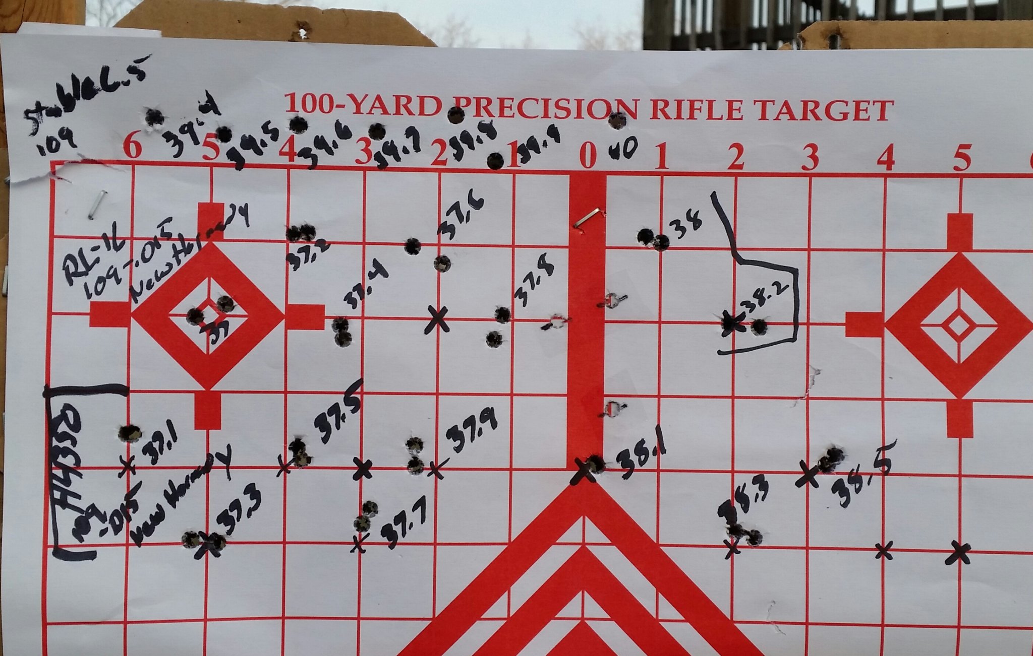

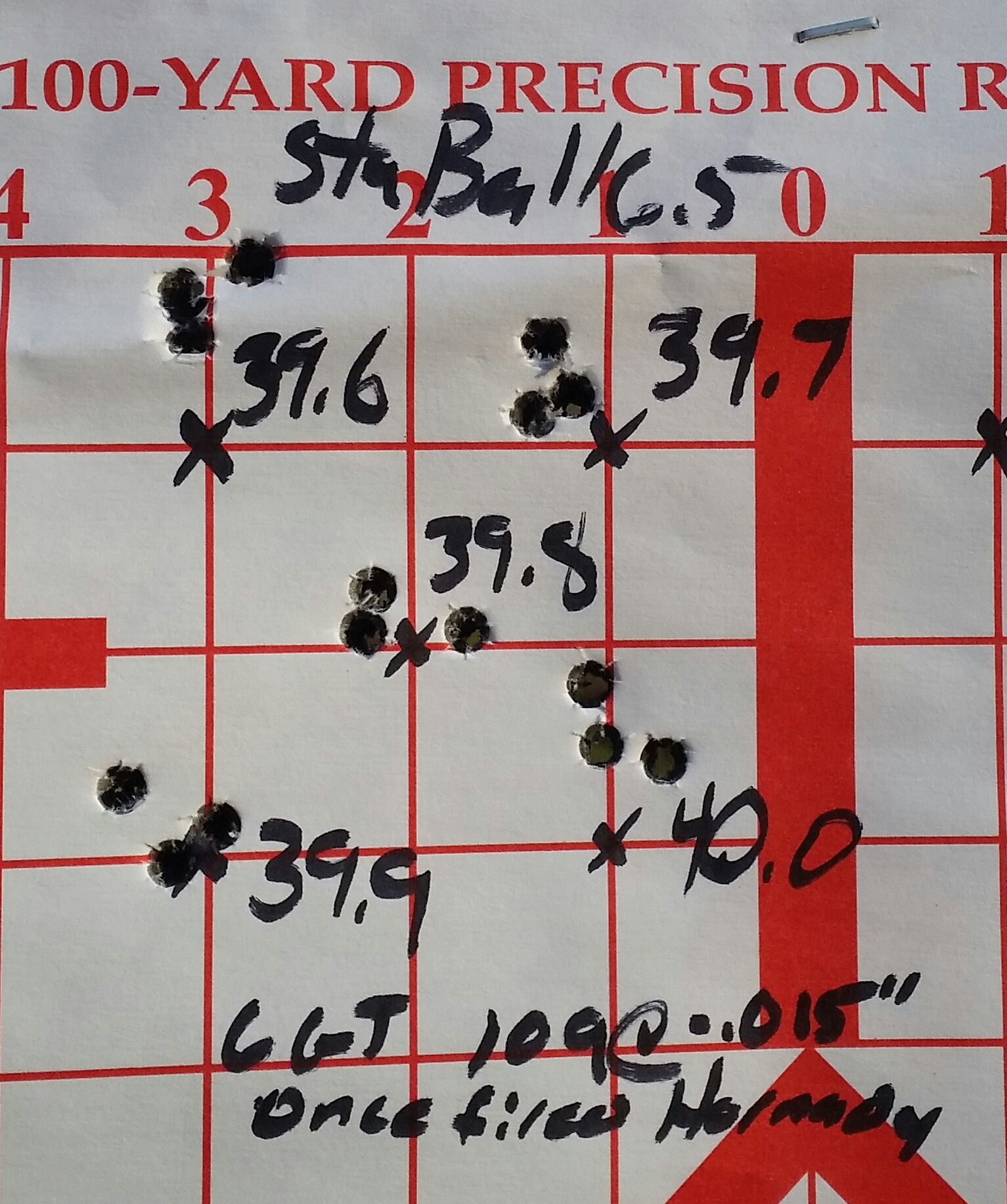

For sure. I was really skeptical about StaBall but I'm pleasantly surprised how it shoots. I hope it continues to shoot well and pan out to a larger node of accuracy bc I ordered a Redding BR-30 and I'm going to mount it on my 650. I'm interested to see if I can get a load that consistently shoots 3/8's out of thrown loads on a progressive. I'd also like to nail down a 6mm bullet feeder solution.

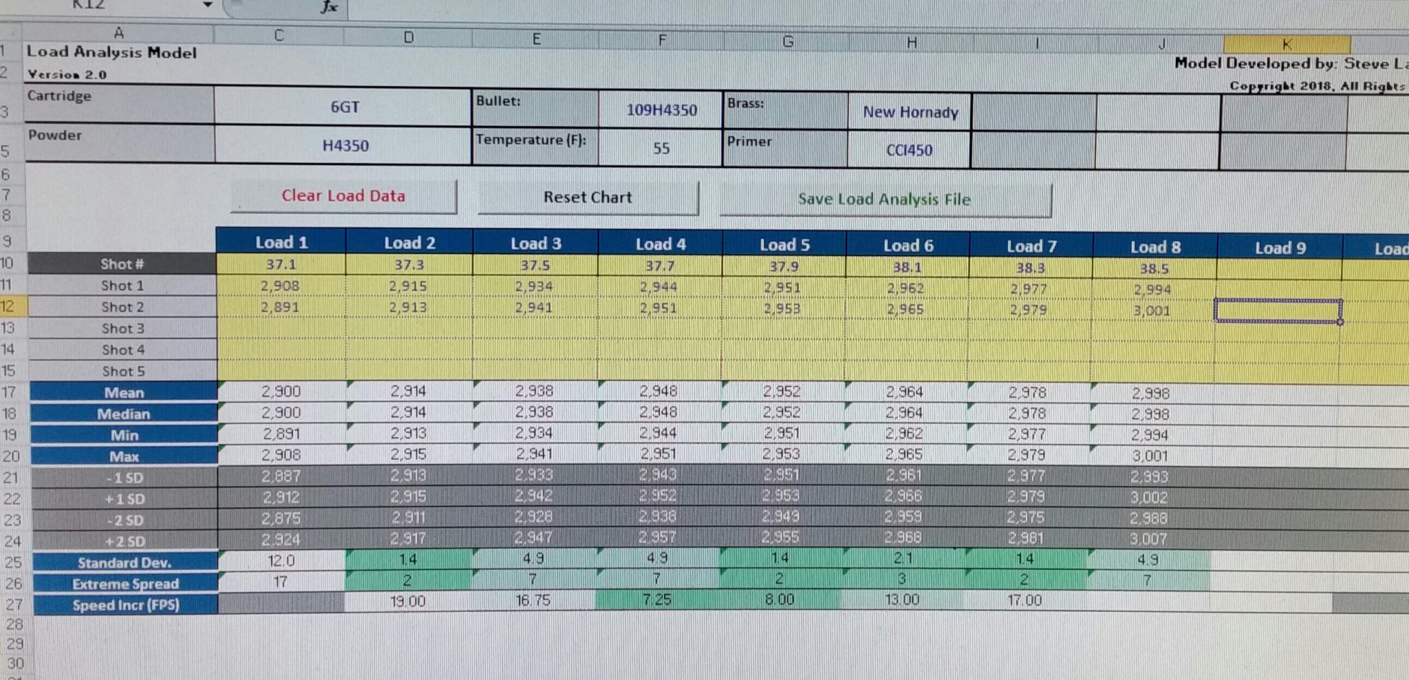

I definitely think this cartridge will shoot, it's just will it shoot under a wide range of conditions. I'm really surprised at the drama caused by shooting 4350 in it. It even proves to shoot well with it using Alpha brass. I guess people seem to think it's too finicky a cartridge to use a wider range of powders. I'm not sure that's the case.

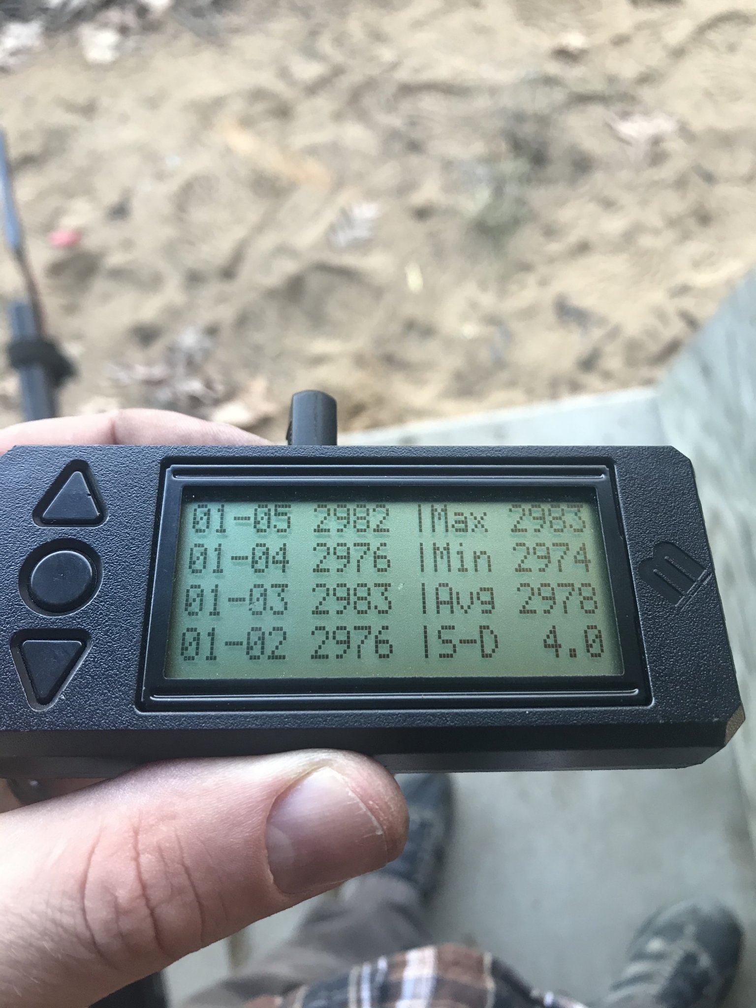

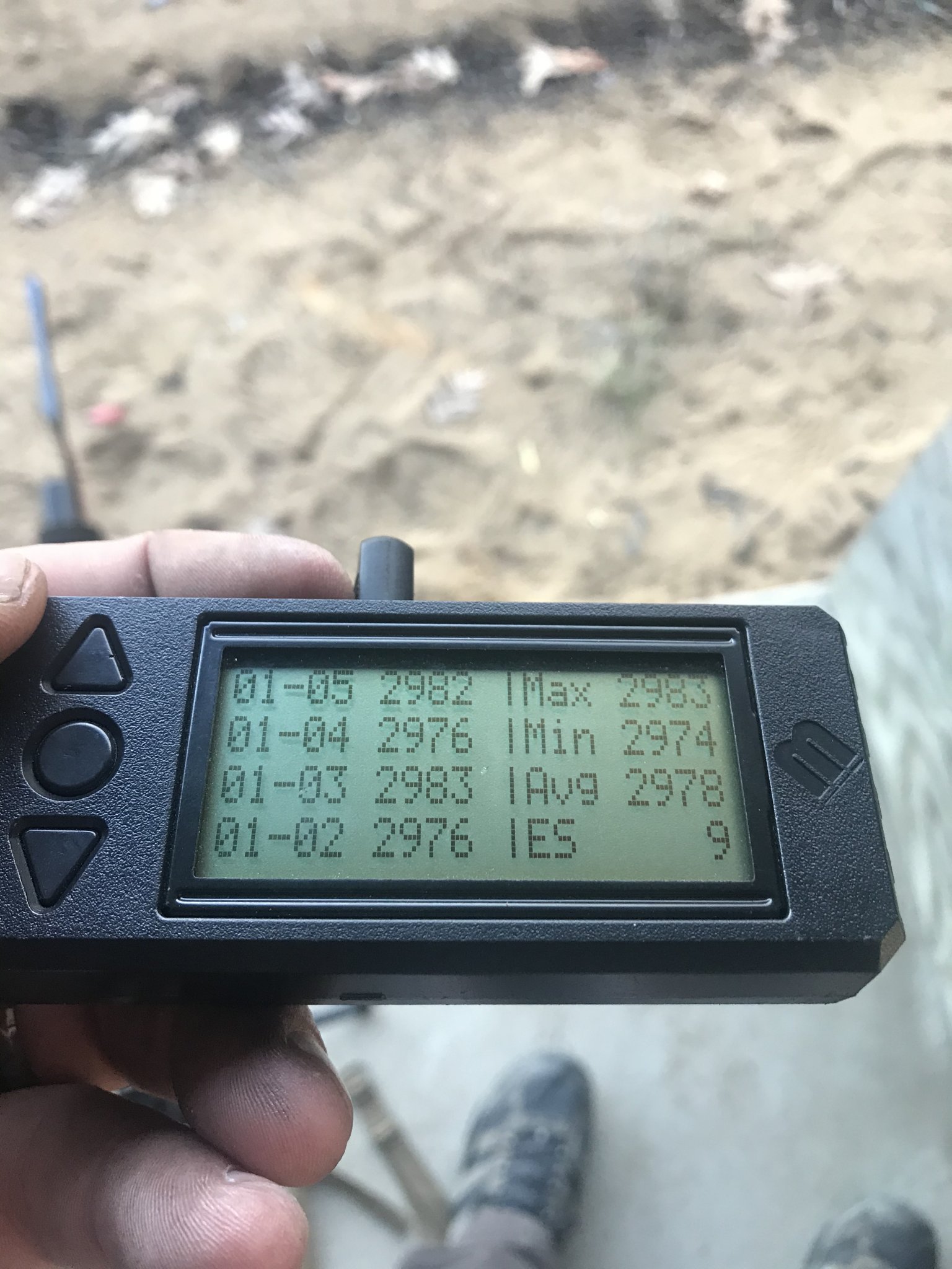

So I went out today and put another 40 rounds on the GT. Have exactly 100 rounds down the barrel. Shot 5 round groups of Varget every tenth of a grain from 34.4-34.9 with Berger 105 Hybrids, Hornady brass, and CCI 450 primers. Every single string grouped well and had single digit SD’s. The last group, 34.9 started to see a little bit of sticky bolt.
34.6 seems to be the sweet spot.

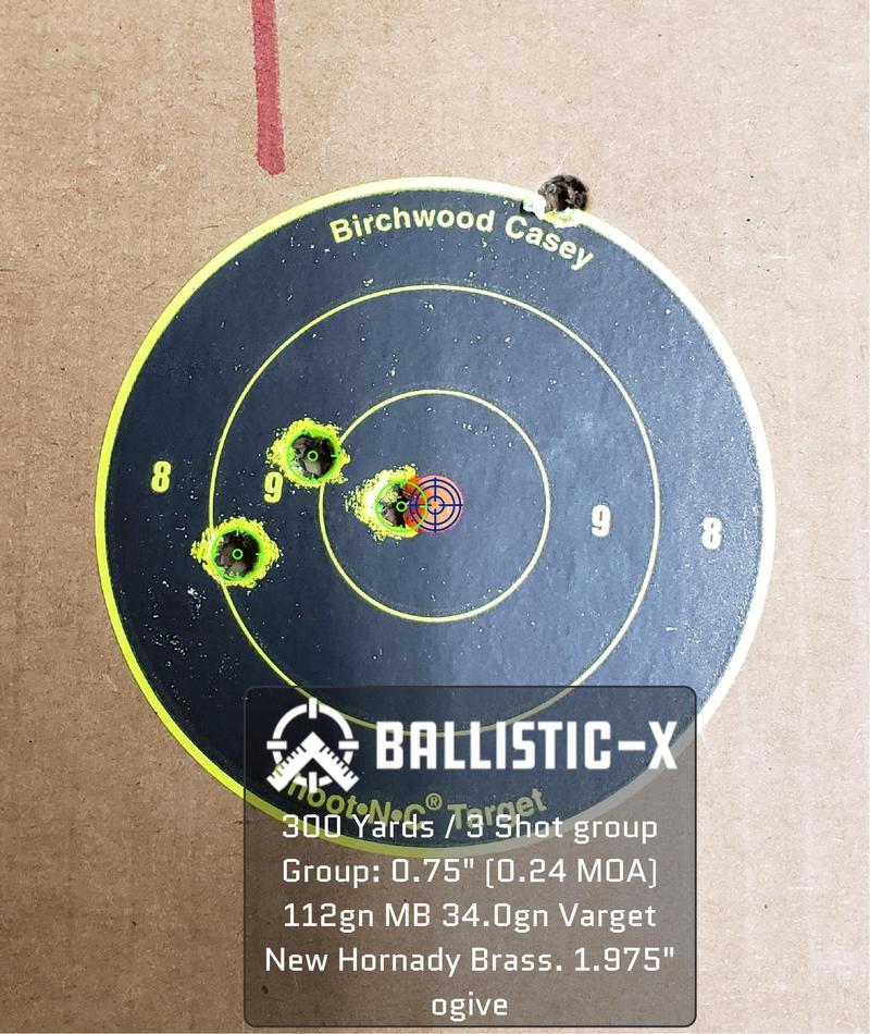

Did an accuracy test @ 1515 rounds this past Saturday. With a lil more throat erosion, I gave the DTACs another shot and found a nice load I will verify next range session.
112s are still hammering for me.

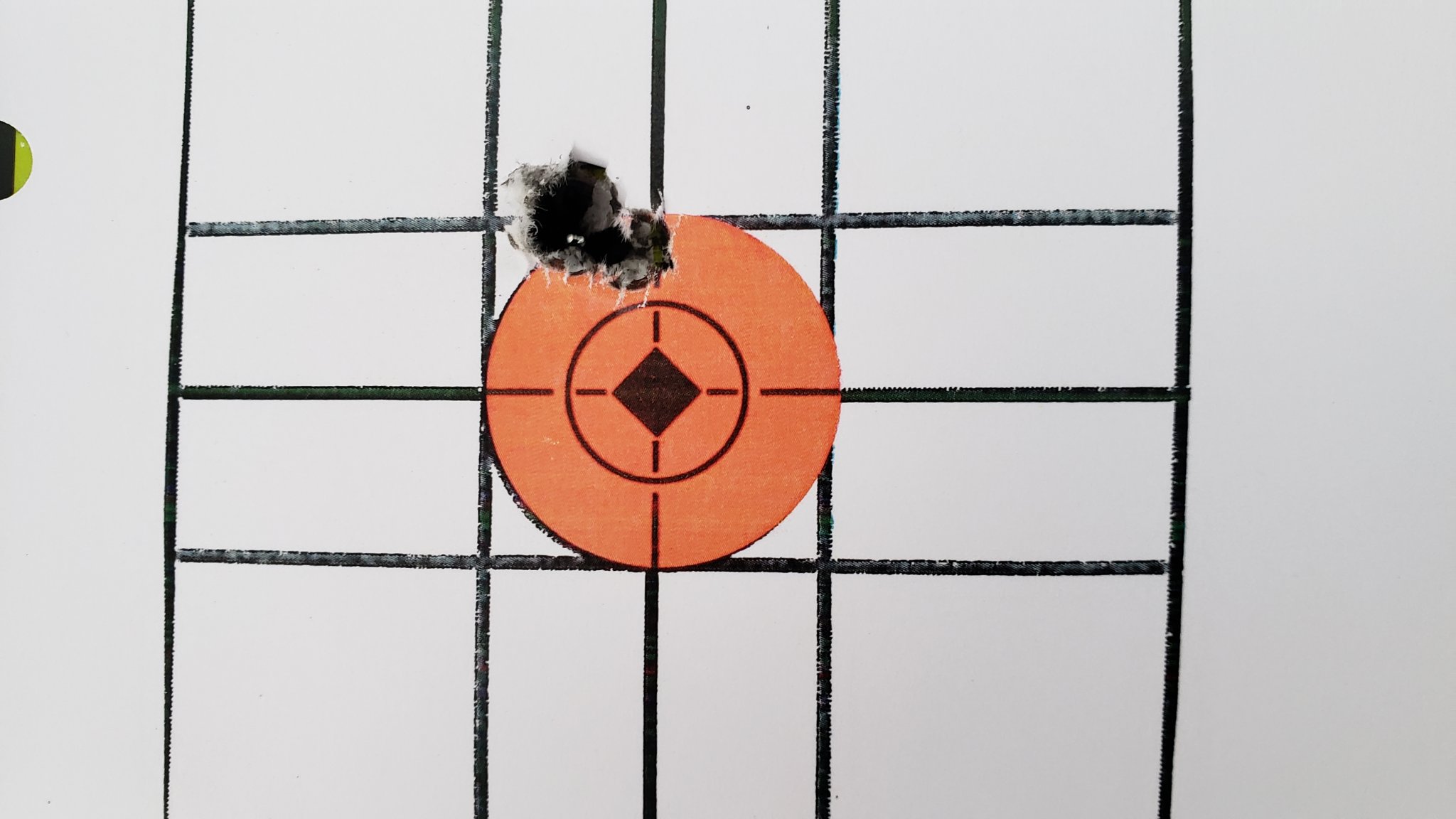

Fired 3, wind picked up. Dialed in .1 left, fired two more.
4 more of the same load above.

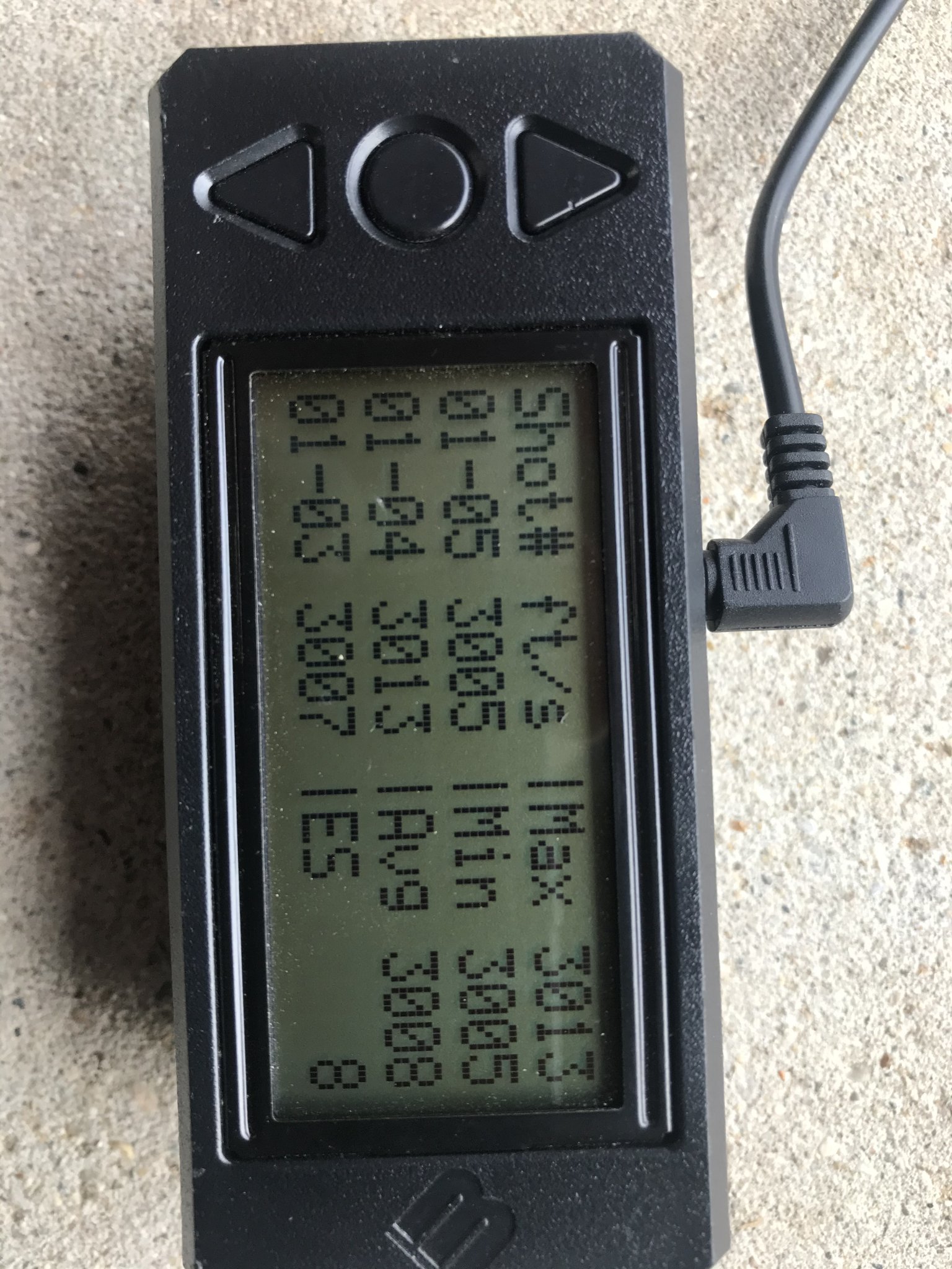

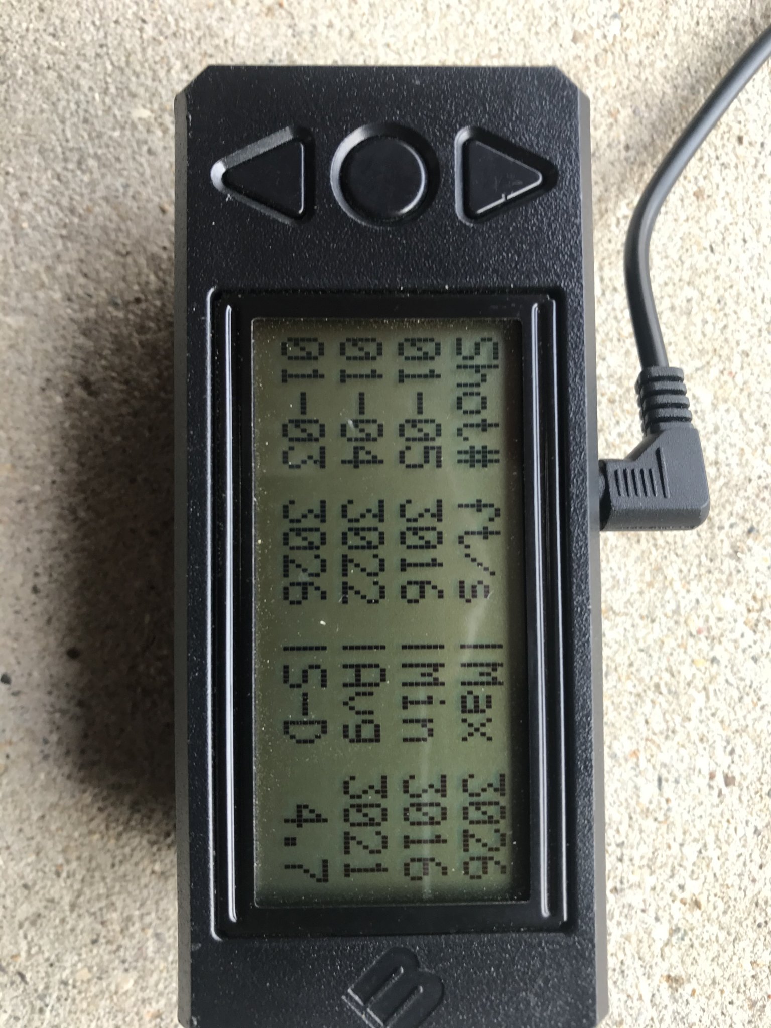

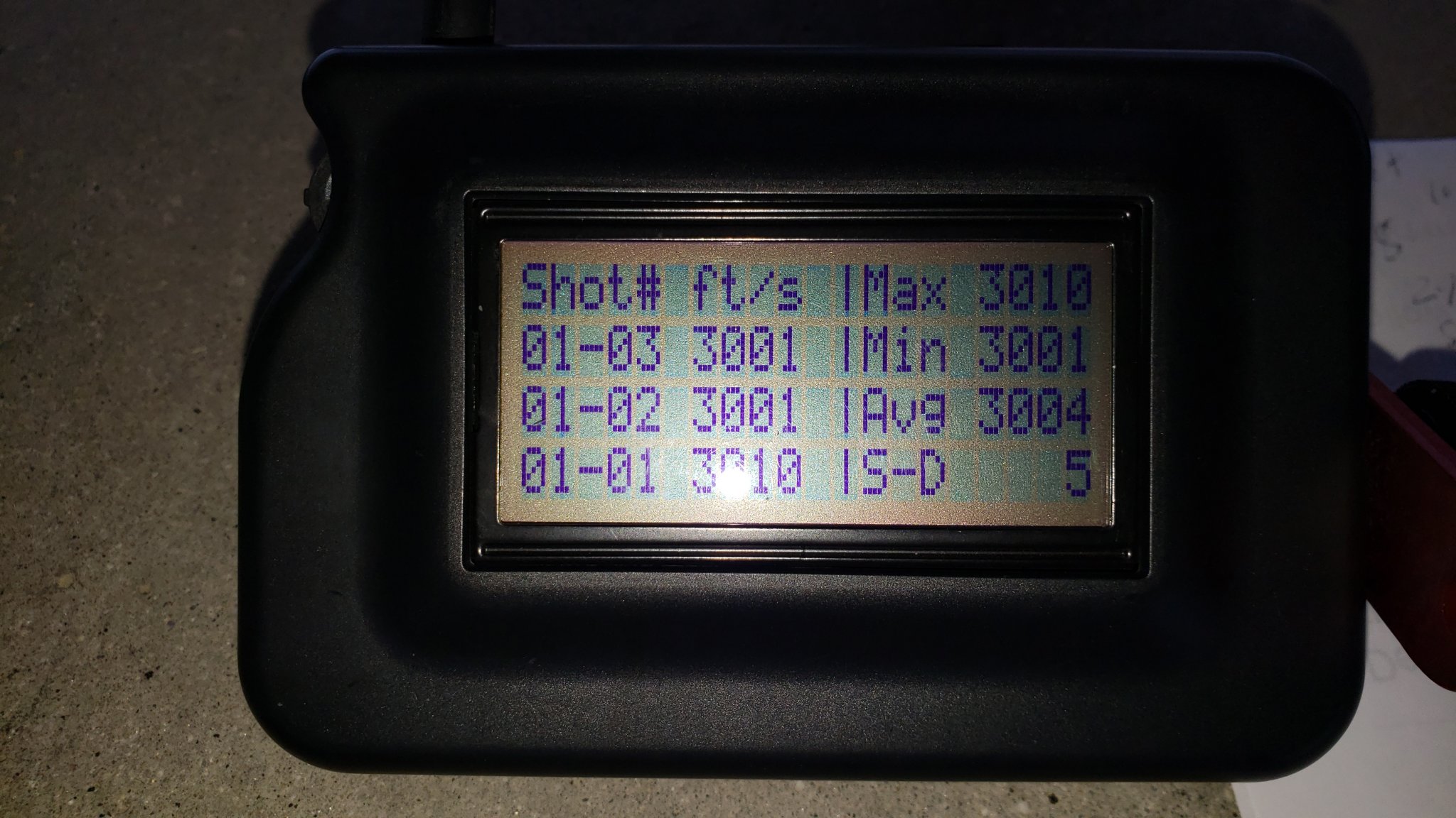

Did some load work today with the 110 A-Tips with Varget and RL16. Found a decent load at 37.8 RL16 that gave me an average speed of 3022 with a 6.4 SD but it seems Varget is more consistent.
This is 34.6 grains of Varget which is the same load the 105 hybrids like. Little slower but was much more consistent across .5 grain.
