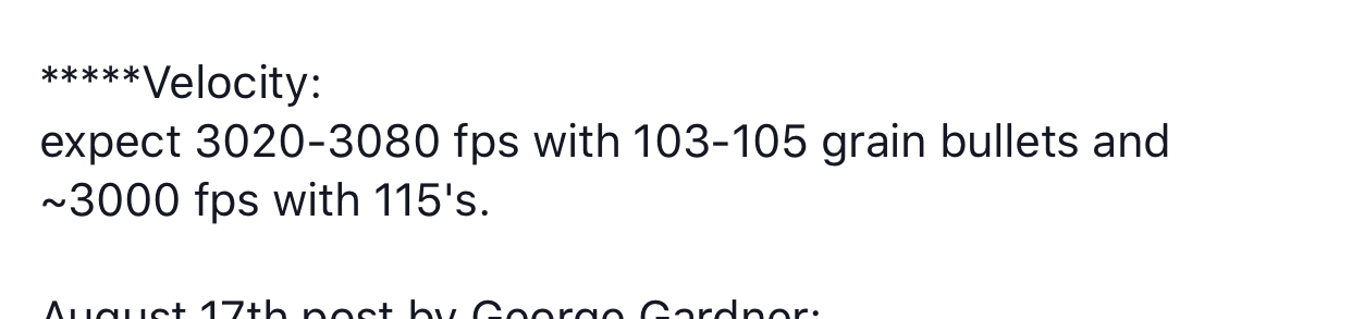

So, from here and FB, it looks like most are getting dasher speeds with 2 more grains of varget.
Is anyone seeing 3050-3100 with a 105 hybrid and no pressure?
I have a GT reamer, but seeing everyone running at dasher speed is making me reconsider.
I’m already setup for dasher and have no issues feeding in my AI with mag kits.

No, the GT is designed to reach 2950 with 105s with varget whIle keeping pressure moderate, unlike the dasher. And fix feeding issues, IE No mag kits that require special feed lip tinkering to run 100%
I agree with @LawnMM And I think folks are starting to see the trend of speeds. There's always going to be someone shooting a Dasher at 3000+fps and there is always going to be someone getting 3000rds out of a 6BR going 2900fps. But the mainstream of folks won't. I'm with verdugo and others. I just want to do what I'm doing with my Dasher, but in an AI platform without mag kits. I shoot 35grs 4350 in a Dasher. That pushes 105's at 2910fps. If I can push 105's at 2950 with less pressure or no compressing 4350 in the case in an AI I'll be happy. I expect 1800 - 2000.
I know of one shooter that is running atips above 3k and two who were 3040ish with 105's. But they are not out yhete telling everyone across FB land. I ran into them last half of this season and their dope matched what they were saying. The 2950 w/ 105's came 2nd hand from George by one of these fellows. It wasn't that the GT couldn't be exploited for more velocity, but it was to be the dasher without the BS that comes with it.
