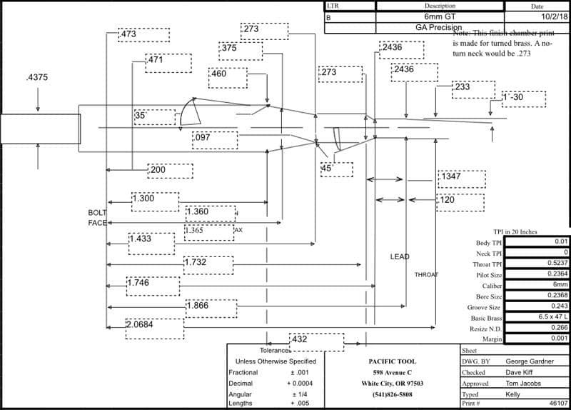

Here’s the reamer specs for length and such:
I started with Dtac's but moved to 109's because I was having constant fliers. I know my bullets are good as they shoot fine in my creedmoor. I'll revisit them when the weather is warmer just in case it's a cold weather stability issue... I'm using a 7.5 twist so that shouldn't be an issue. Don't I've seen stranger things happen.
In that diagram it looks like 1.746 from the case mouth to the flash hole but doesn't give a measurement from there to the case head. I use the lee case length gauge trimmers so I will have to order a custom one for 6gt since they don't offer it yet.
those measurements are from the bolt face not the flash hole...im pretty sure you need to be looking at the 1.732 im pretty sure thats the neck length of the reamer

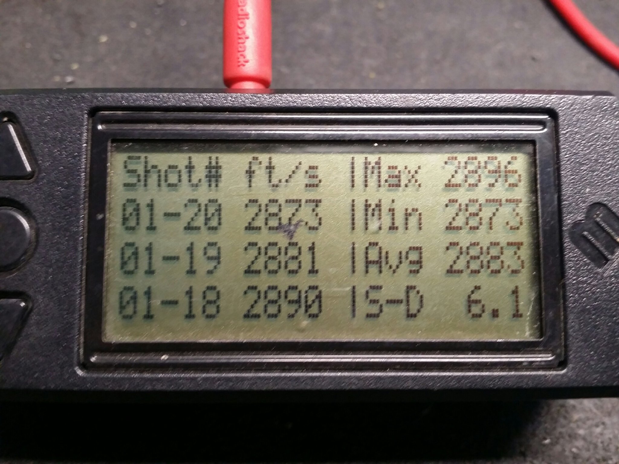

Another data point for folks.
Rifle is a 7.5 twist Benchmark at 24 inches. Currently 425 rounds on the barrel.
115 RDF
450 primer
Hornady brass
My initial goal was to throw charges, but I do not want to be at the top end of the pressure range. I put 150 rounds through the barrel using MR200PP. I stopped at 2900 fps with the 115s. Results were not great ao I quit. May have been different if I went up in the powder charge, but I did not.
The following pics are all RE16.
I ended up at 37.6 grains and 2885.
115 RDF with .040 jump.
Note: I have 2 pieces of brass with 40 firings on them. They still have good primer seartng pressure. They were annealed every 5 to 6 loadings and trimmed 3 times...

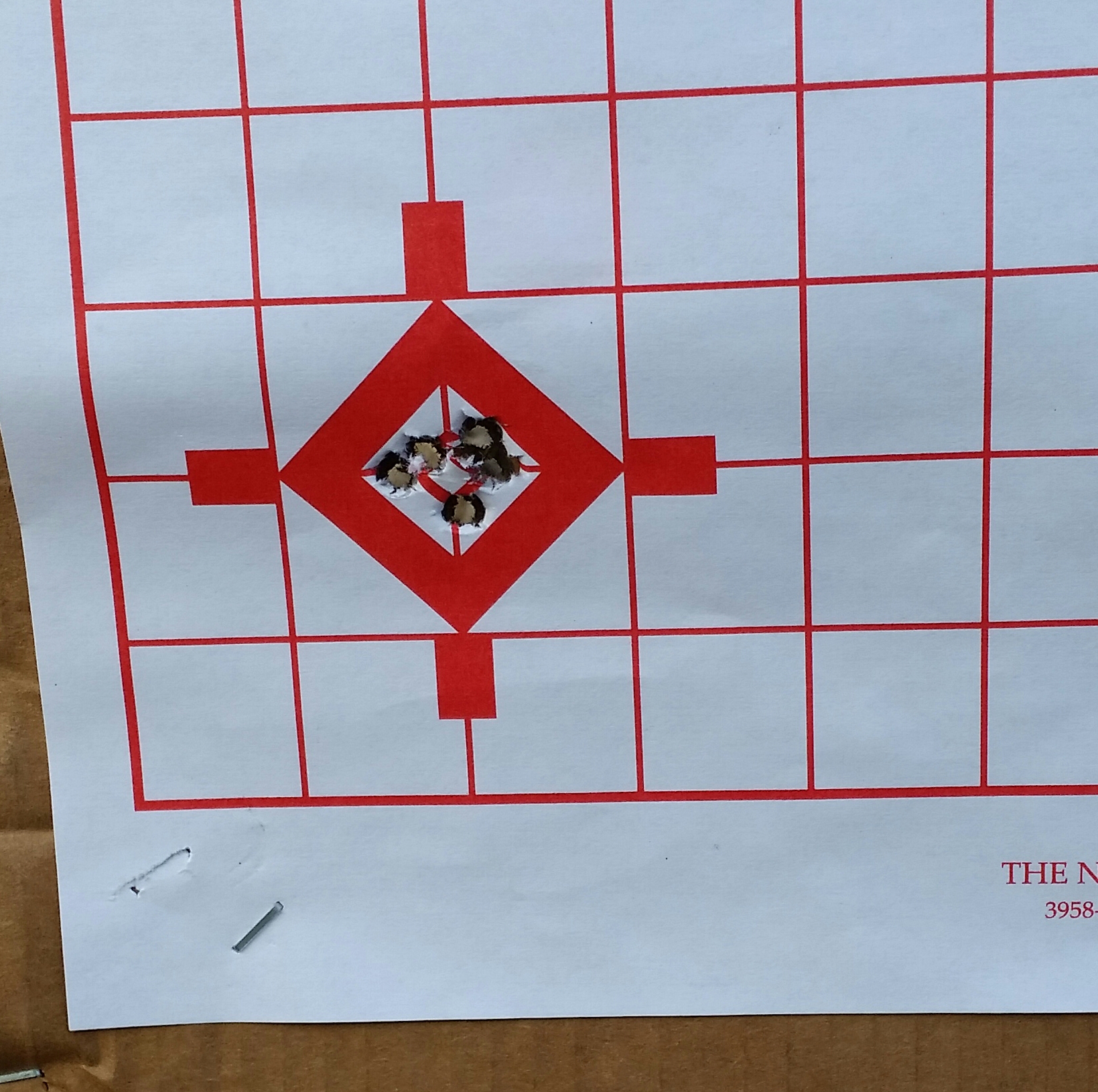

Picture of the ladder, it was 40 degrees and these were single rounds at 360 yrda.
Second picture is 685 yards. 2 inch black
3rd is 1015 yrds. That is 8 of the 10. The other 2 were 1 hole at 100 to confirm zero.
4th is a 20 round string for reference.

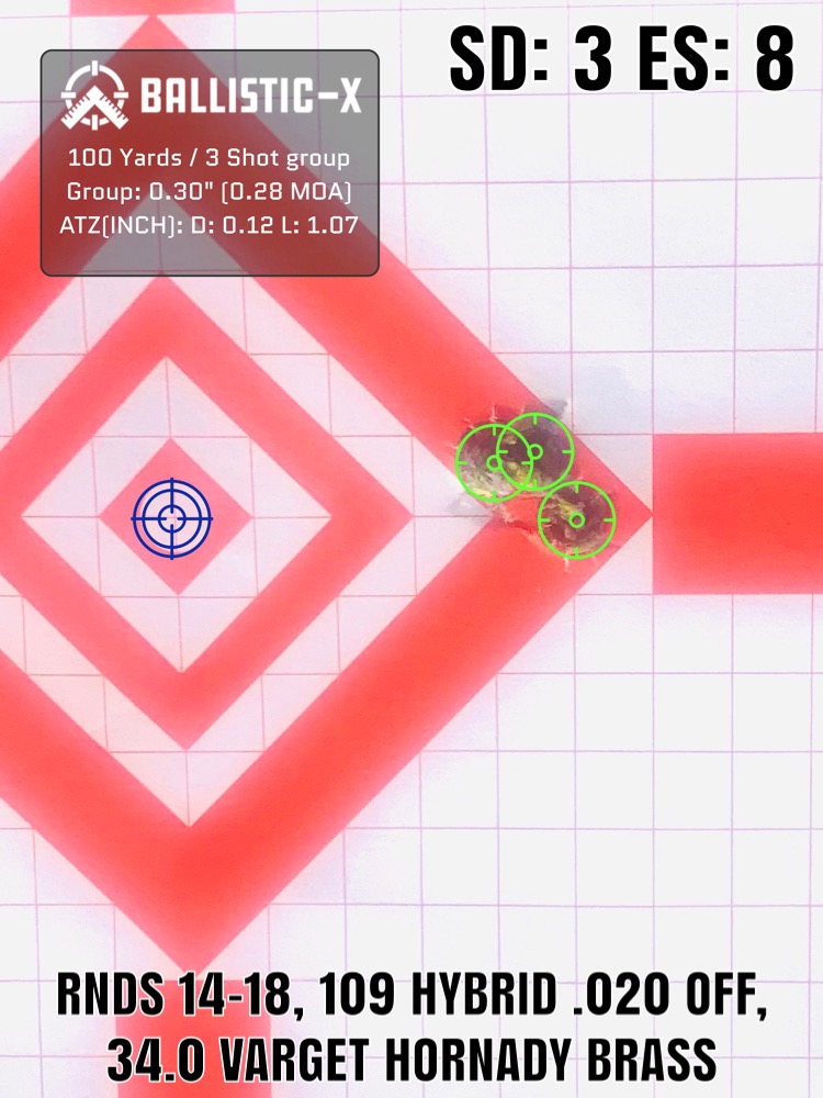

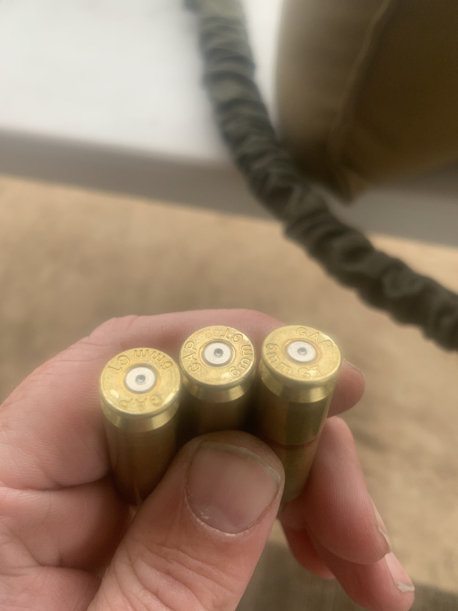

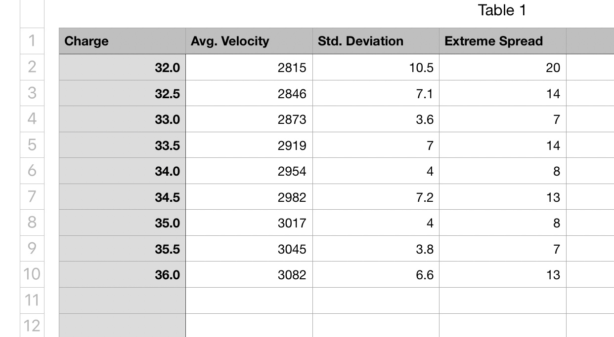

Velocity testing only. Will shoot groups this weekend to go along.
Hornady once fired. Necks were uniformed prior to first firing. 198 rnds on barrel prior to starting.
3 shots each charge over magnetospeed.
109 hybrids jumped .020
Loaded with fx120 v3 auto trickler to within .002 gr
Varget
Starting seeing ejector swipes (see pic) at 36.0.
Temp: 58
Light drizzle rain
Humidity: 82%

Looking good. I'm still in the infancy of reloading but snagged 60 rounds worth of pre-rolls from Clay's shop here in OK. Hoping to foul it in and get some magnetospeed numbers while I work out just what kind of reloading set up I want (and where the hell it's all gonna fit in our 1920s craftsman).
Looks good. I have 109s, varget, hornady brass and dies sitting in my reloading room waiting for my barrel. I was hoping for a comfy 2950 and it seems like it will be possible! What primers?
Also just FYI, I shot the first 198 rnds with 34.0 varget. It started out at 2915 or so. I chrono’d it before a match last week at 94rnds.
So, it sped up between 94-198 to 2954. Which is to be expected.
