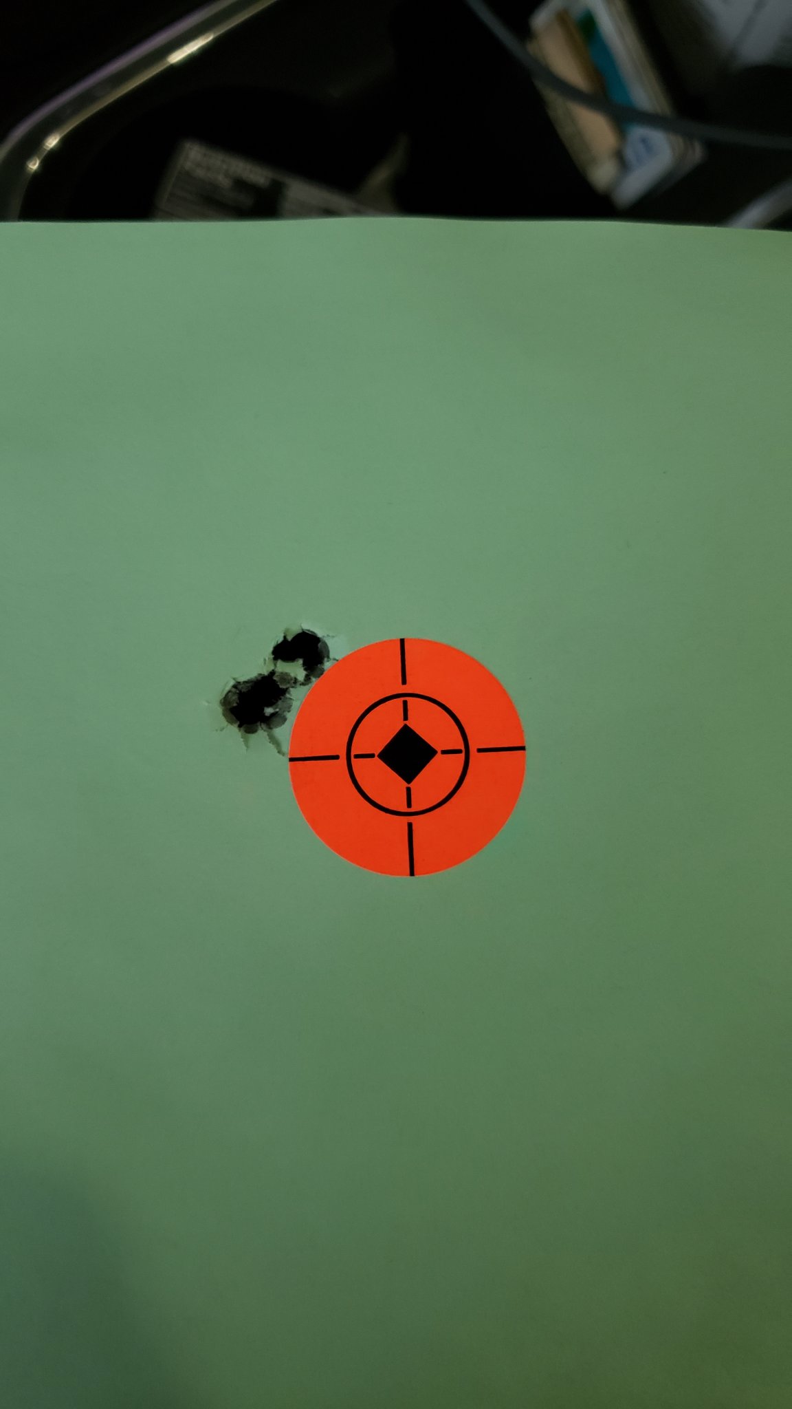

So just got out and ran some more rounds down my GT. 34.5 Varget and 105 Hybrids. This is barely 60 rounds down the pipe and I fully expect the barrel to speed up a bit but had zero pressure signs so far.
Nice. So when barrel speeds up you could easily get 3050 avg if not more. How was accuracy?
Pretty good so far. I plan on working up a load with A-Tips after I shoot these last 40 hybrids. Got a box of 105’s to kinda warm up with cause I’ve herd from a few that you need to get the barrel settled a bit before really working up a load. But so far these are looking really good

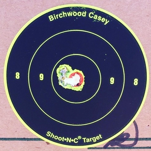

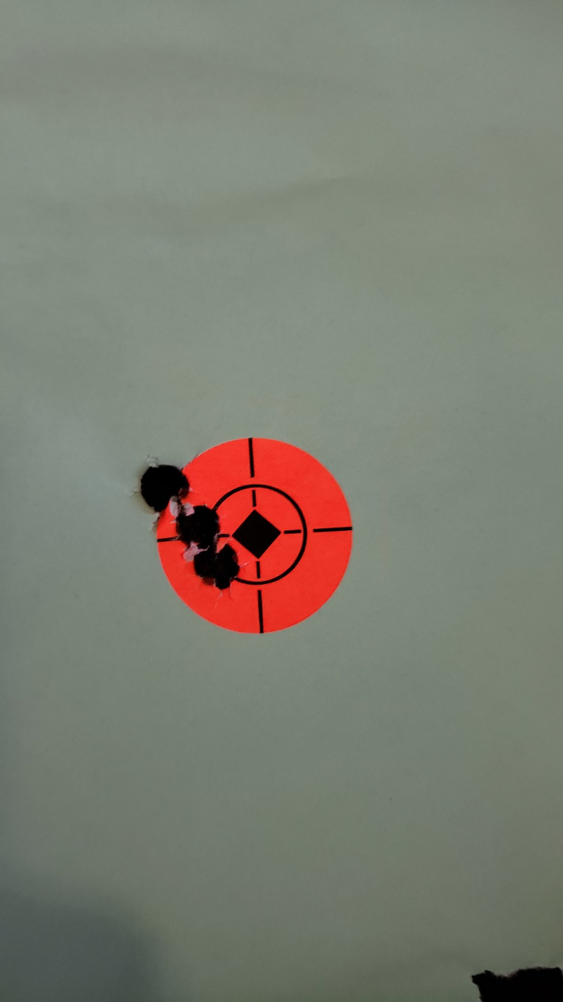

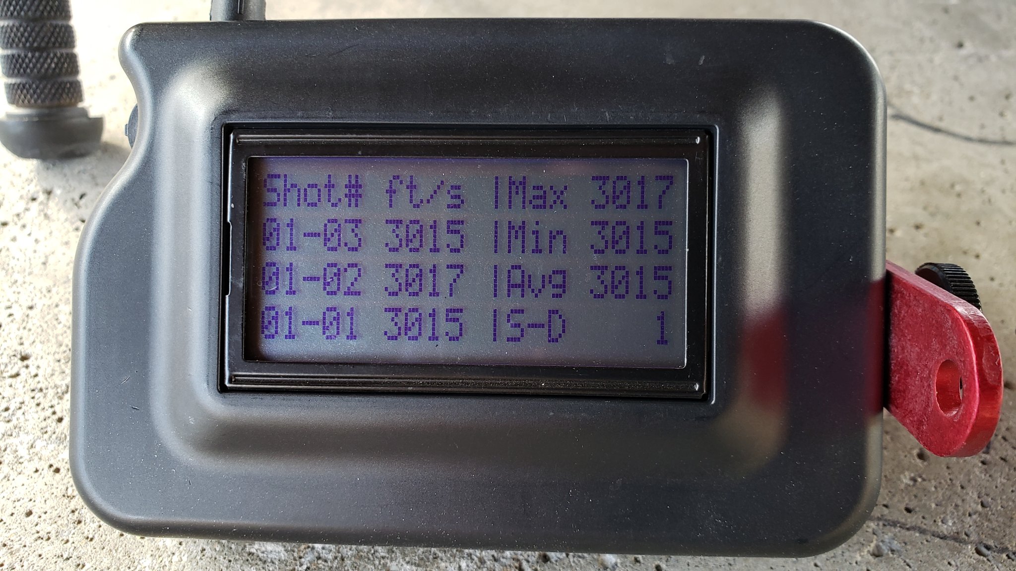

My load info.
Tempest action
Proof barrel 7.5 twist. 27 inches
Hornady brass
Cci br4
H4350 37
Berger 105 30 off.
3015 SD 1
200 yard groups.

as far as your 3 shot 1fps SD...it means nothing...go shoot 50 rounds over the chrony and then talk about your SDs.
I’ve been chasing SDs and ESs for a long time and I’ve NEVER had a 40-50 shot sample under 20-25fps...but I had several 5 shot 0 SD groups and a couple 10shot groups at 1fps and 2fps in a 6.5x47 but over a large sample ALWAYS in the low to high 20s.
