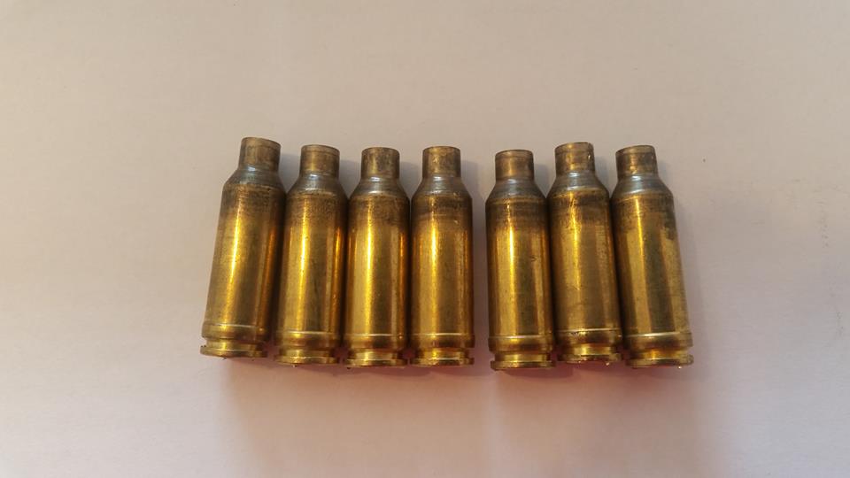

Below the photo is what Whitley posted years ago about the 6mmAR. I had good luck with N540 but it is expensive, 8208 worked with 95gr bullets and produced some of the best velocity. The burn rate of 8208 is a little faster than 4895. RL15 and Varget are very close in burn rate. I have used both in several cartridges and the charges can almost be interchanged but always start lower. I agree with some of the others Varget and RL15 are bulky and limit max charge. That is one reason I have been using more N540.
When working up loads you need to watch the base of the brass carefully, if the brass shows a ring about .050 above the groove back off. Grendel brass is very thin and very unforgiving, it will rupture if pushed too hard. Photo below shows brass on the verge of rupturing.
