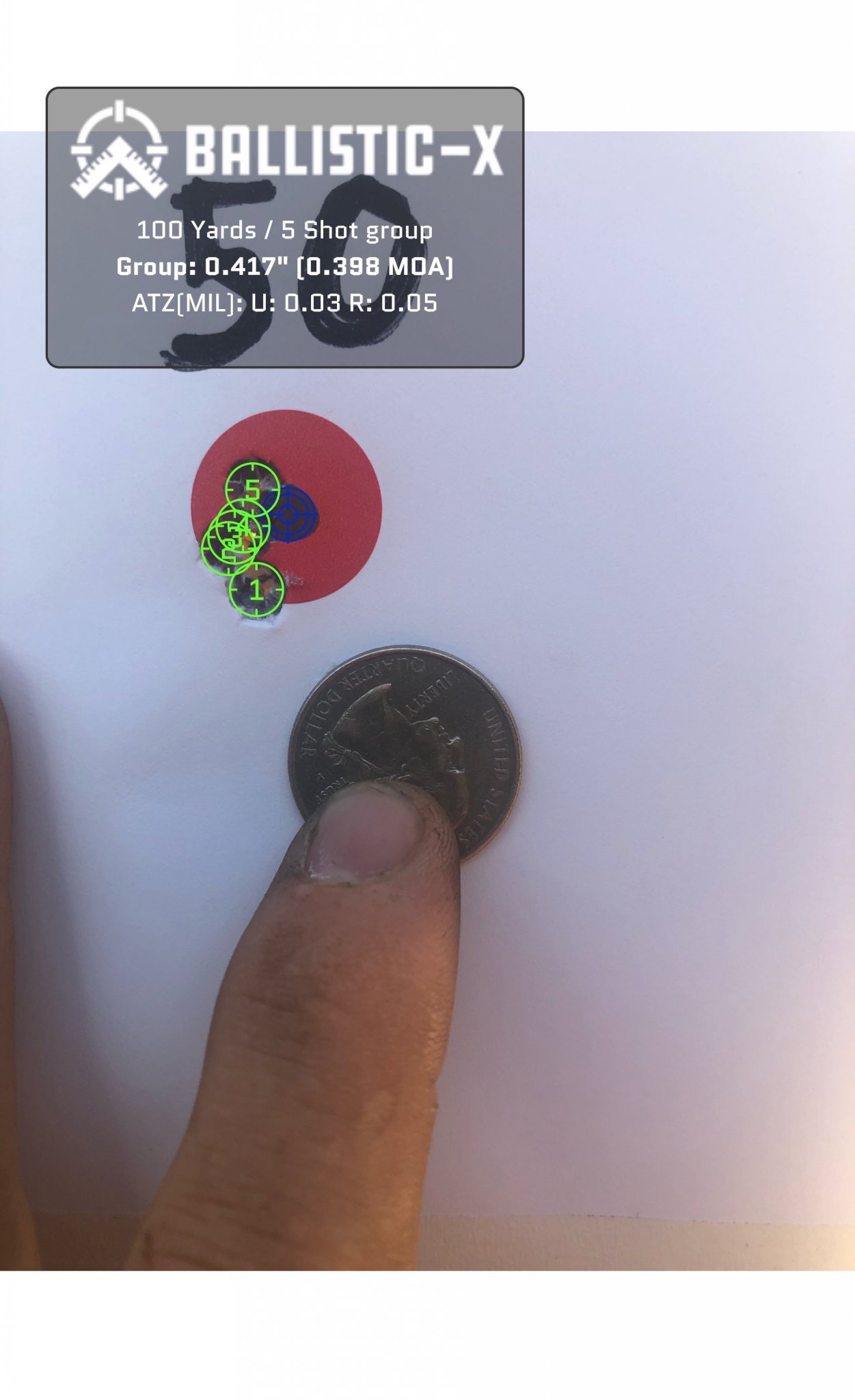

If you decide to try lighter bullets, AR Comp works great. 5 shot groups at 100 yards with 80 grain Bergers and AR Comp

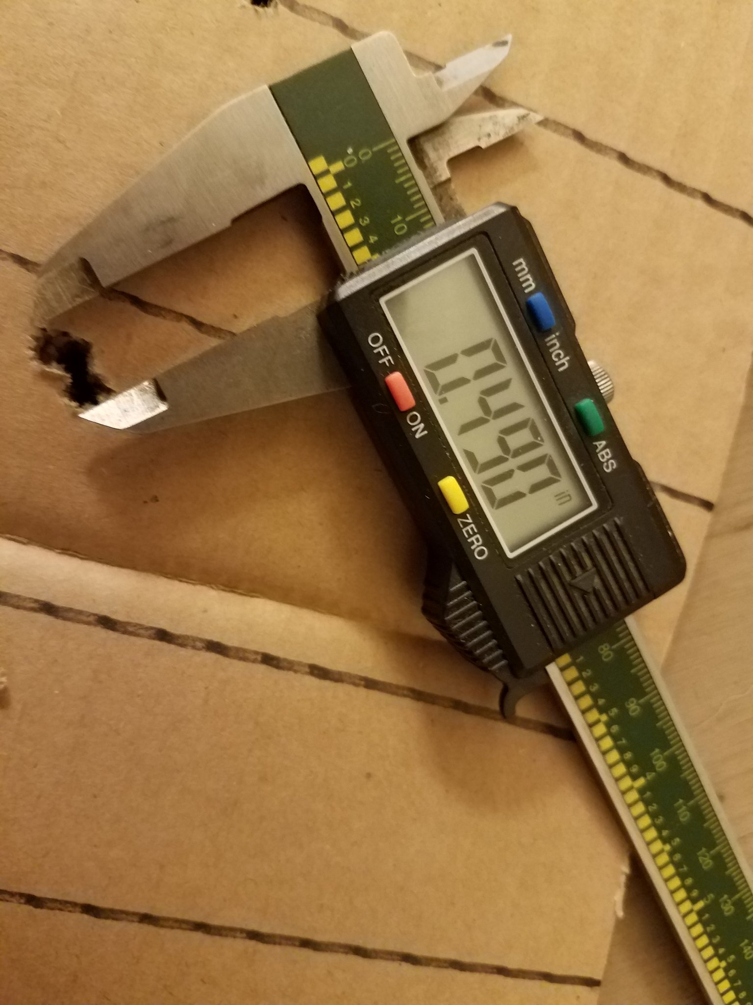

Caliper zeroed at 0.243:

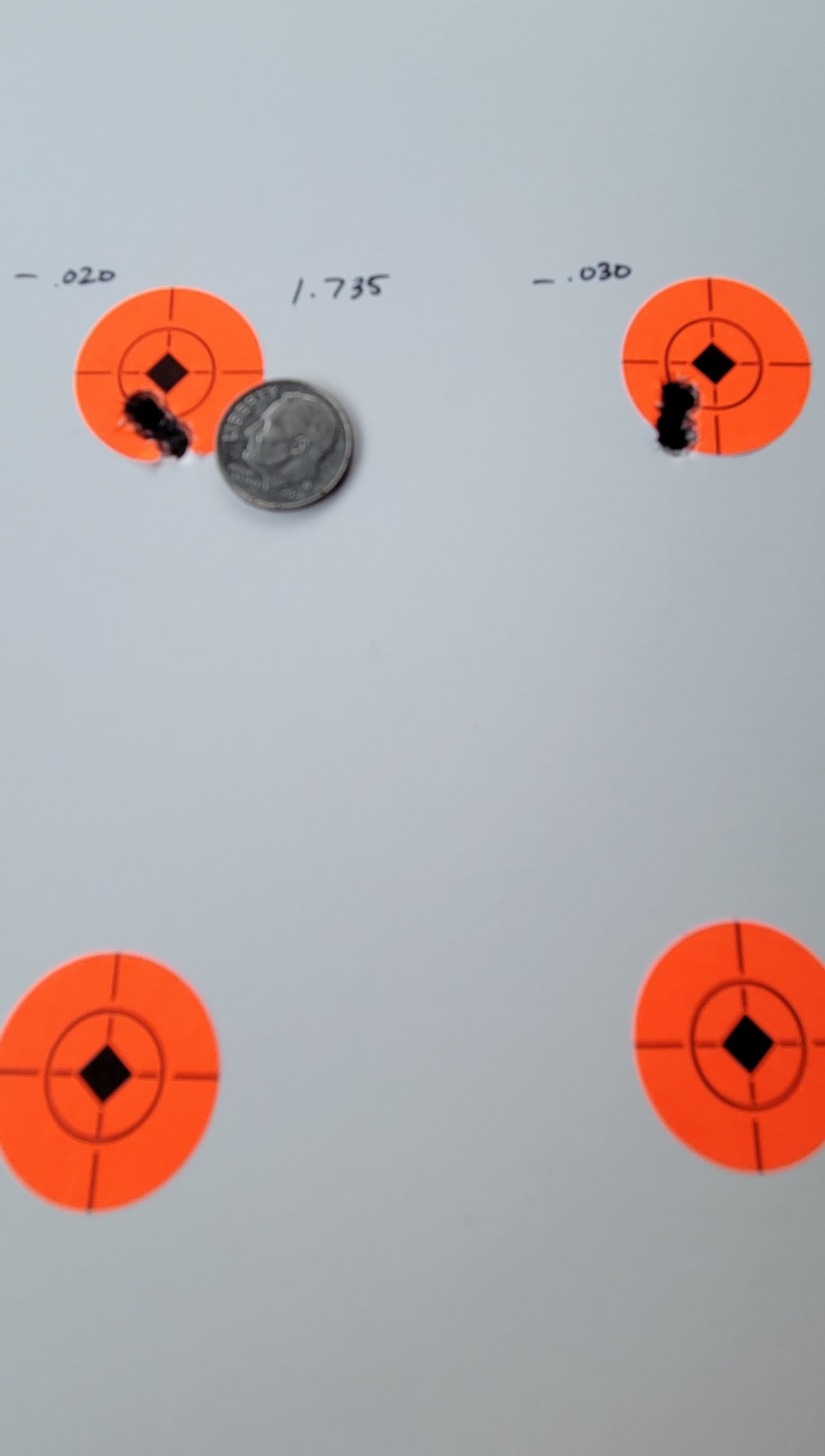

Ok, I tested today 105 gr BT Targets and 105 gr Hybrids. Left column Hybrids, right column BT Targets. 29.5/29.8/30.2 charge weights for both bullets. Seating depth- 10thau off the lands for Hybrids and 5 thau for BT Targets.
Additional factor- trigger. I have 650grams trigger and I believe at least 4 times my flinching contributed to the opening up a group. Nonetheless, BT Targets outperformed today the Hybrids.
I personally have never had hybrids shoot as well for me that close to the lands, try .020-.030

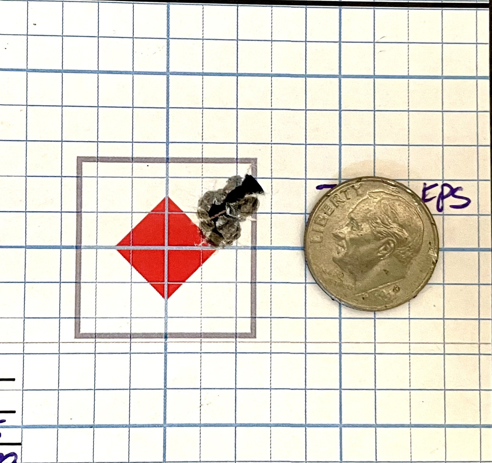

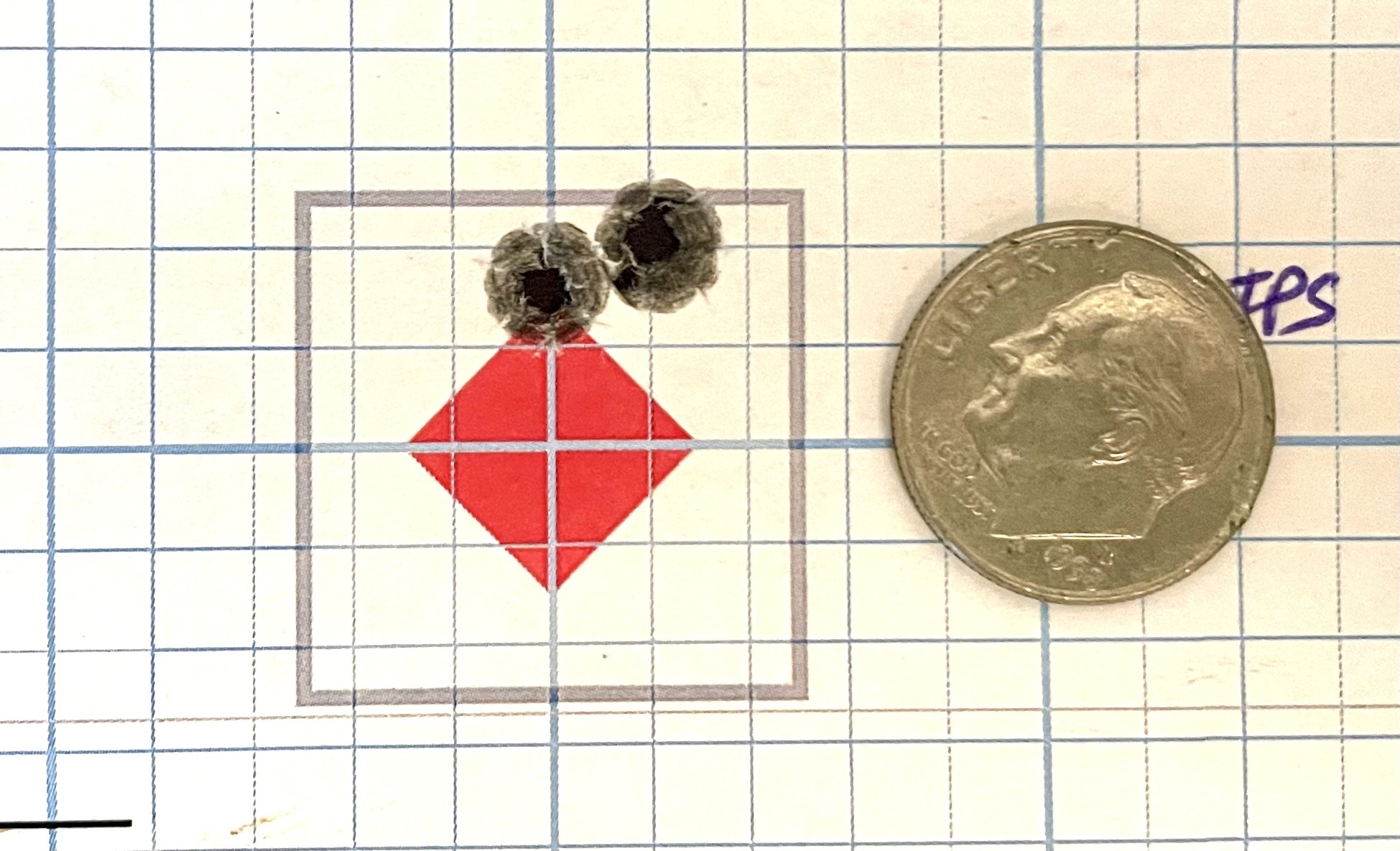

Ok, I tested two distinct processes of brass prep. First batch was annealed and sized using forster bushing bump die+ carbide expander mandrel 21c. Second batch was not annealed, FL sized without a rod, then carbide expander mandrel 21c. Surprisingly, the second batch was giving me a really sticky bolt (what's wrong with FL sizing die???). Both batches trimmed to the length, chamf/deb, the same powder charge, the same seating depth, same bullet.
A little guessing game for you guys: first batch - 5 shots, second batch 10 shots. which column represents the first batch?
Am I understanding this correctly - each target is a single shot (not a group)?

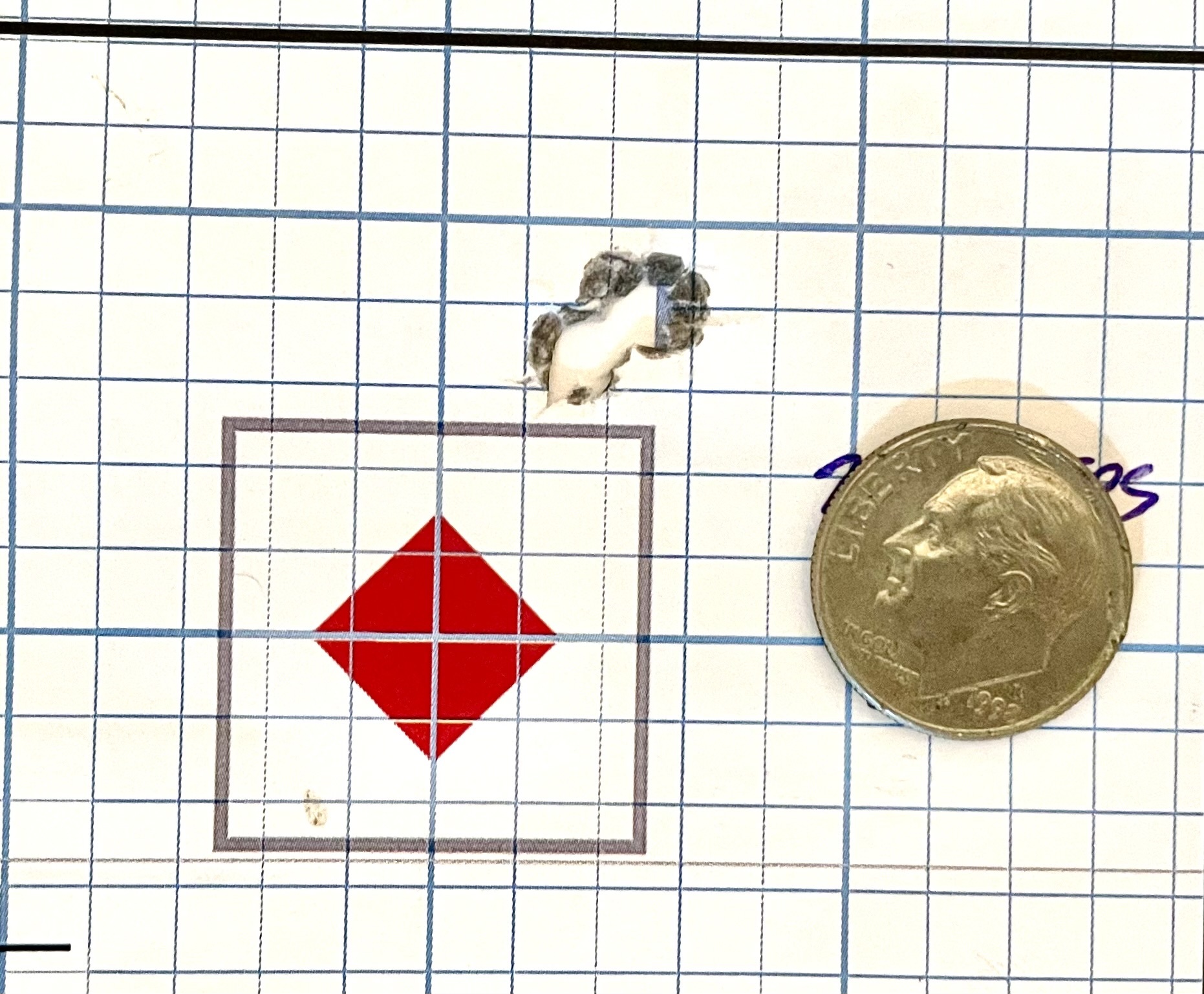

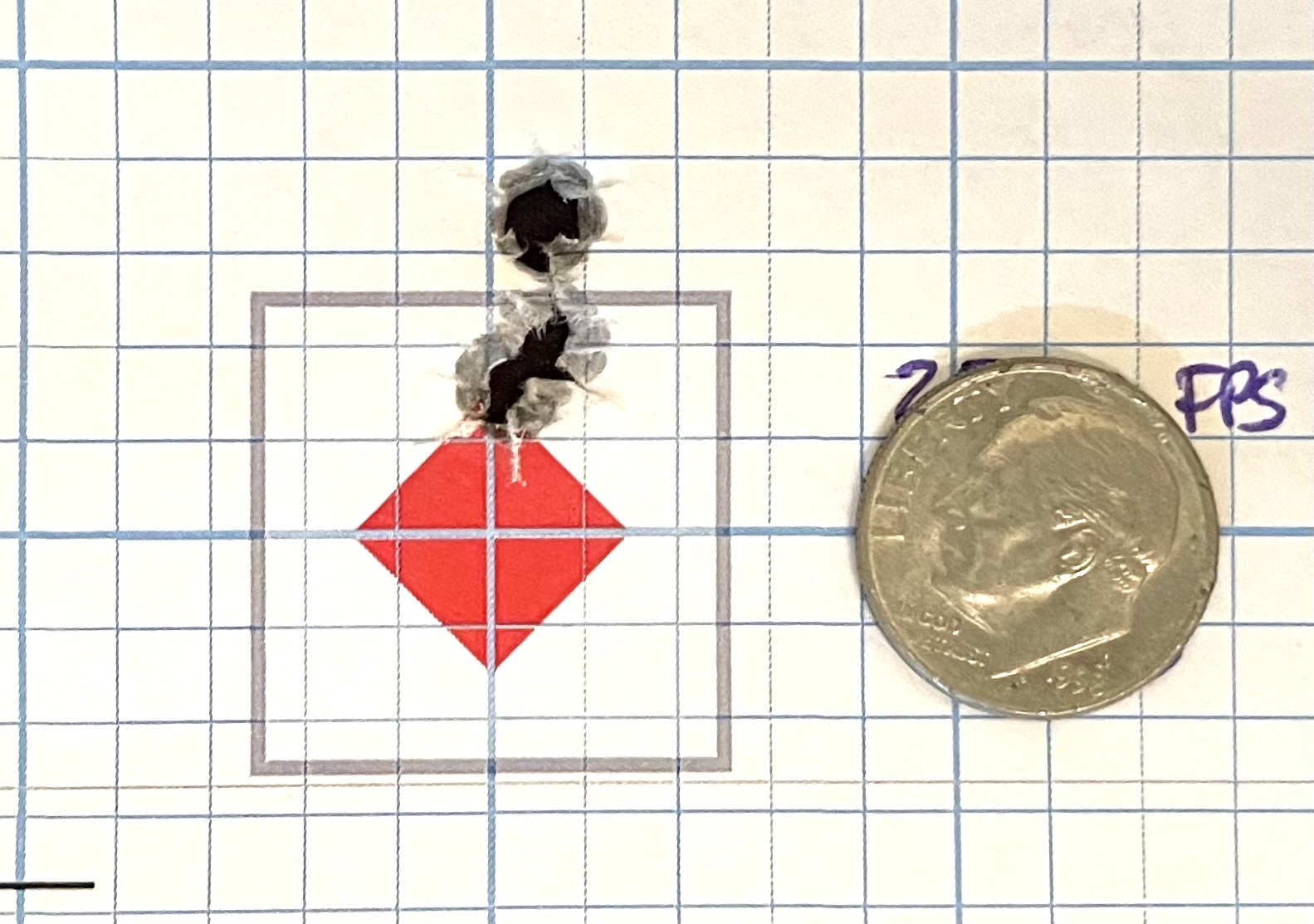

6mmBR Norma
Peterson Brass - FL Sized .265” Bushing
Annealed every time
Shooters World Precision Rifle
30.0 gr - 2700 FPS (26” 4 groove)
CCI BR Primers
Barnes 112 MatchBurners
Jump window is .04” - .06” off the lands.
Shoots in the .3’s - .4’s inside that jump window for me, any closer or further out and it opens up significantly.
Edit to add 10-3-21
Same load as up top. Was shooting for some SD #’s to compare mandrel to bushing methods...

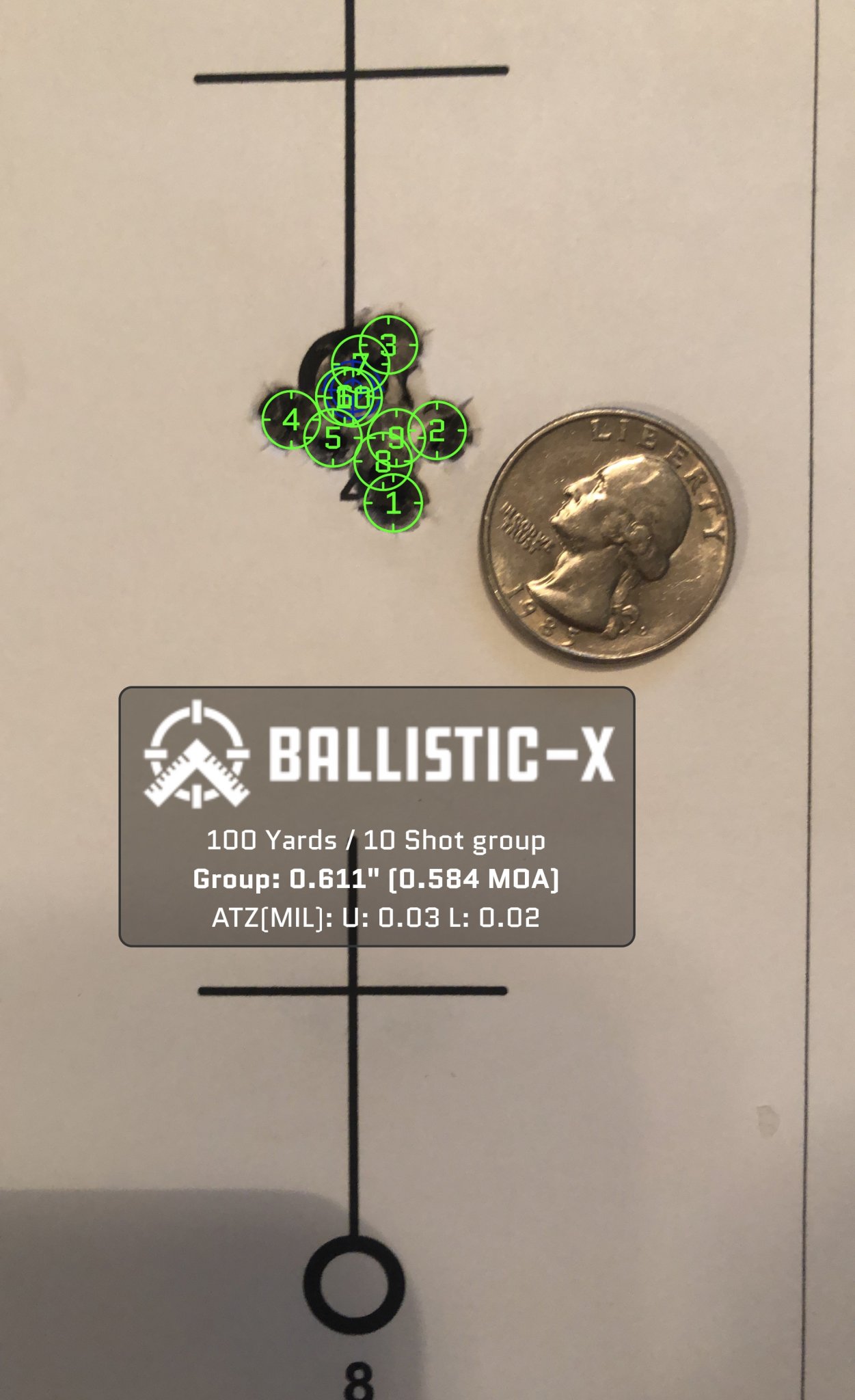

And someone asked me about why I always put a quarter next to the group. It’s a 1” reference for the Ballistic-X app.
