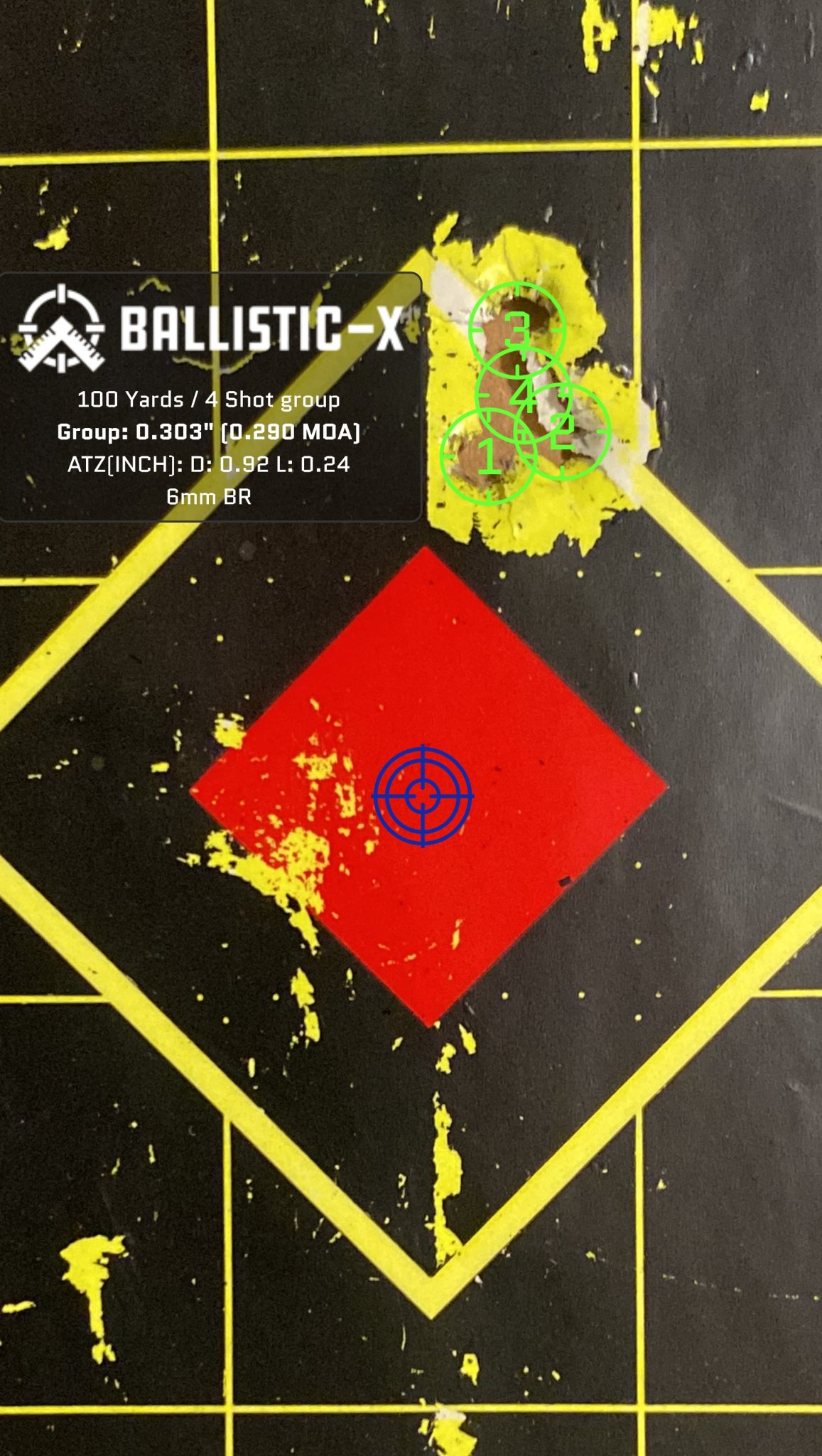

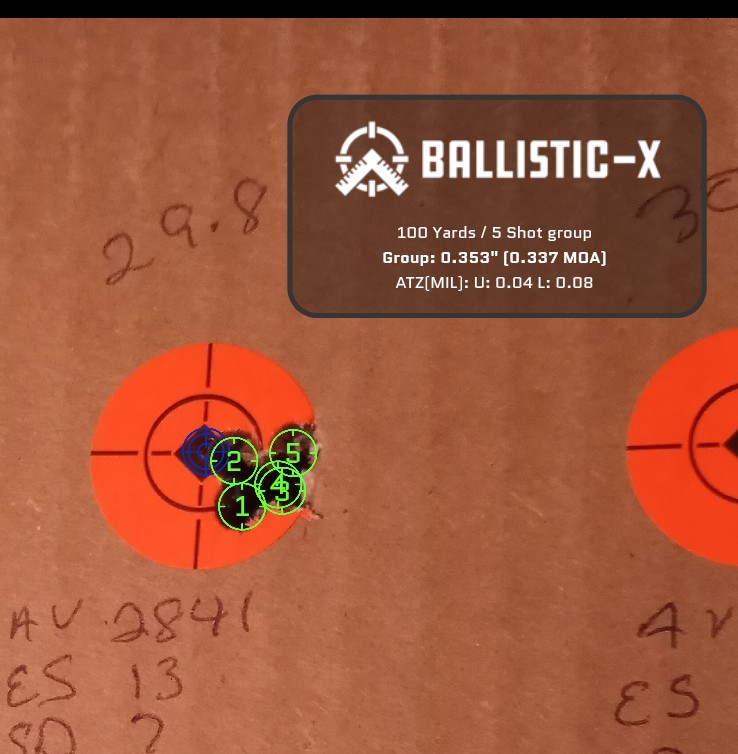

First two five round groups out of my new 6BR at 100 yards and then one group at 410 yards. It took two rounds to get dialed in and then fired these. I would like to bring the spreads down a little, but it's definitely showing promise.
Varget
CCI 450
Lapua Brass
-.020"
Hawk Hill 26"
936ft

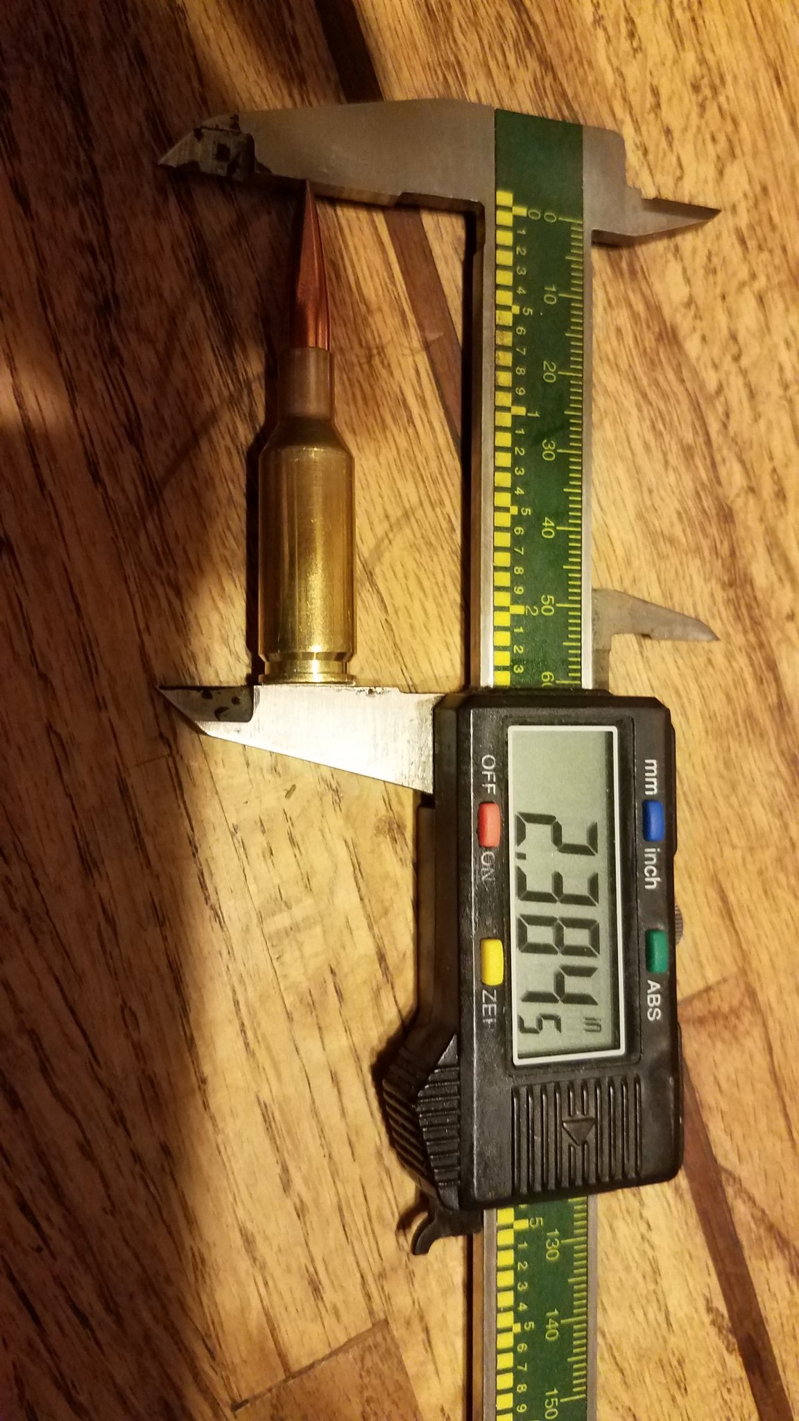

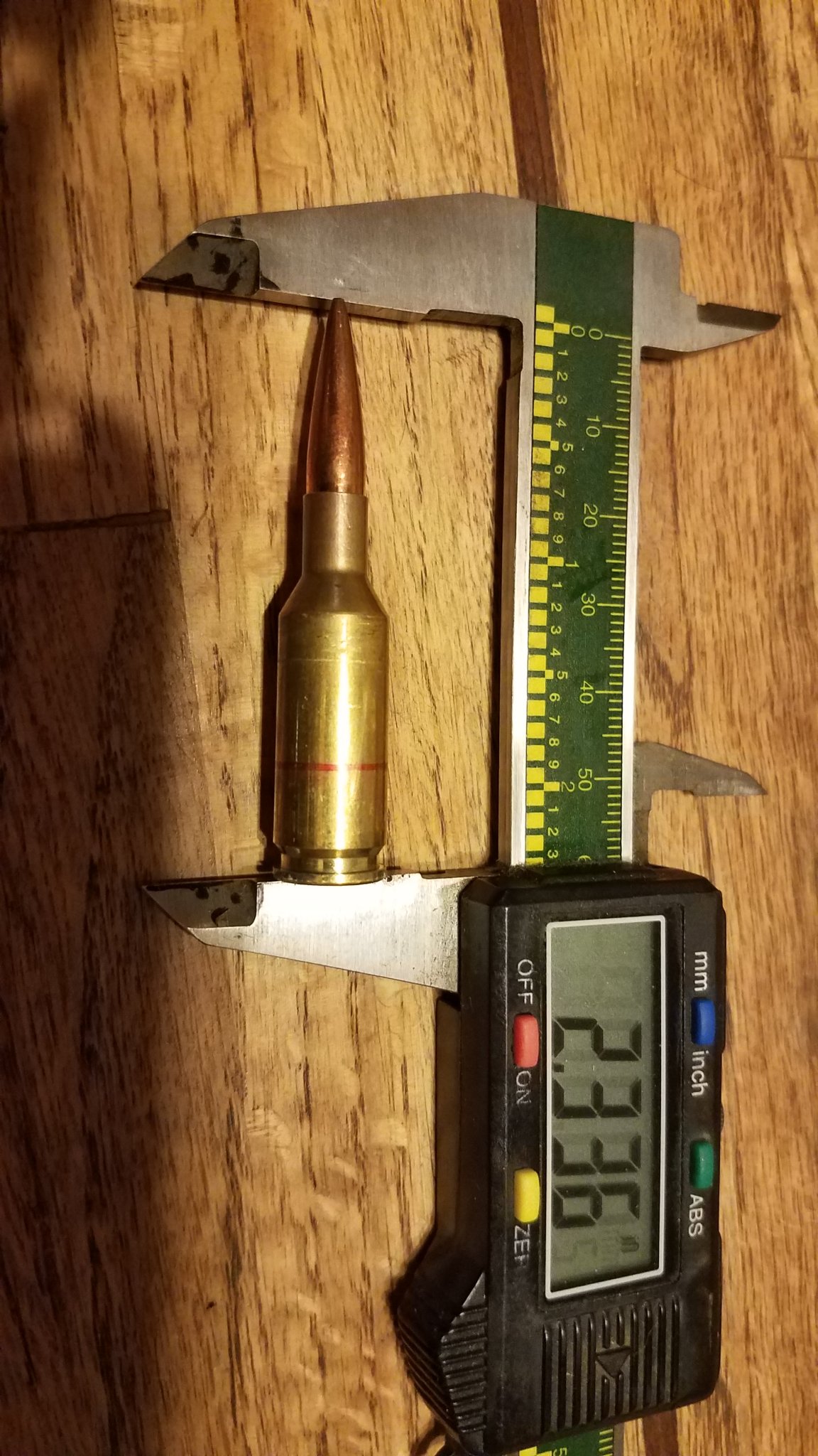

Anyone running a nearly new CBI prefit ?
If so I'd appreciate knowing what bullets you are running and the CBTO is. Thank you
