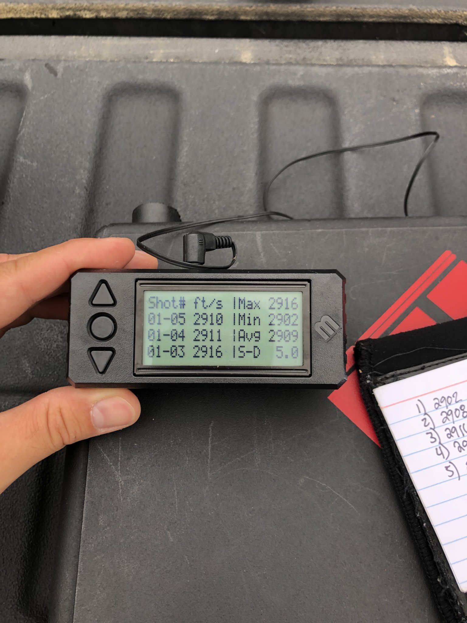

Out of my AI AX 26” Win Tac 6BR 30.4grs Varget, BR4’s, 105gr Berger HT, 1.645 CBTO moving at 2910fps have been absolutely money
29.8grs was 2850fps over 6rds with SD 4.2 ES 10

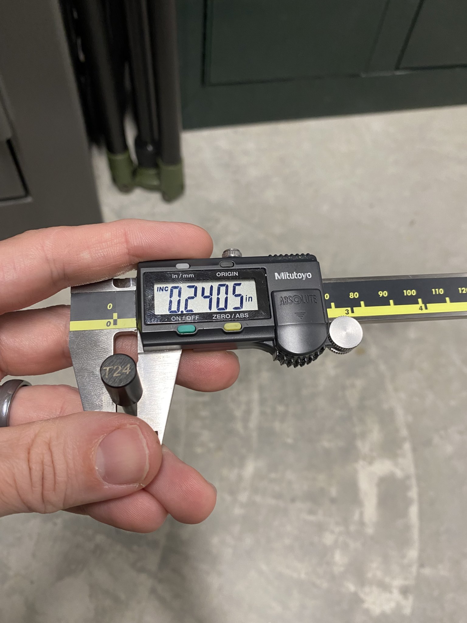

Question as I want to get this correct. I'm going to use the SAC modular die for reloading 6BR using Lapua brass, Berger 105s and possibly Hornady 108s. While I have bushings for the SAC, I want to add a mandrel to the process. Since the OD of both bullets are .2430, I assume I go -.002 and should buy a .2410 to get the right neck tension? TIA.
Yes, pending brass spring back. I usually see 2,5K neck tension when using a turning mandrel (.241) and checking with a - pin gage.
Generally, a 'turning mandrel' will be 2K under nominal bullet diameter, and an 'expander mandrel' 1K under.

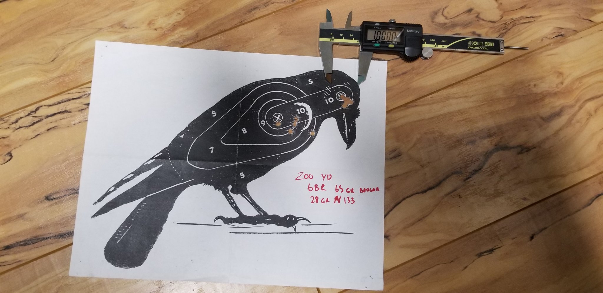

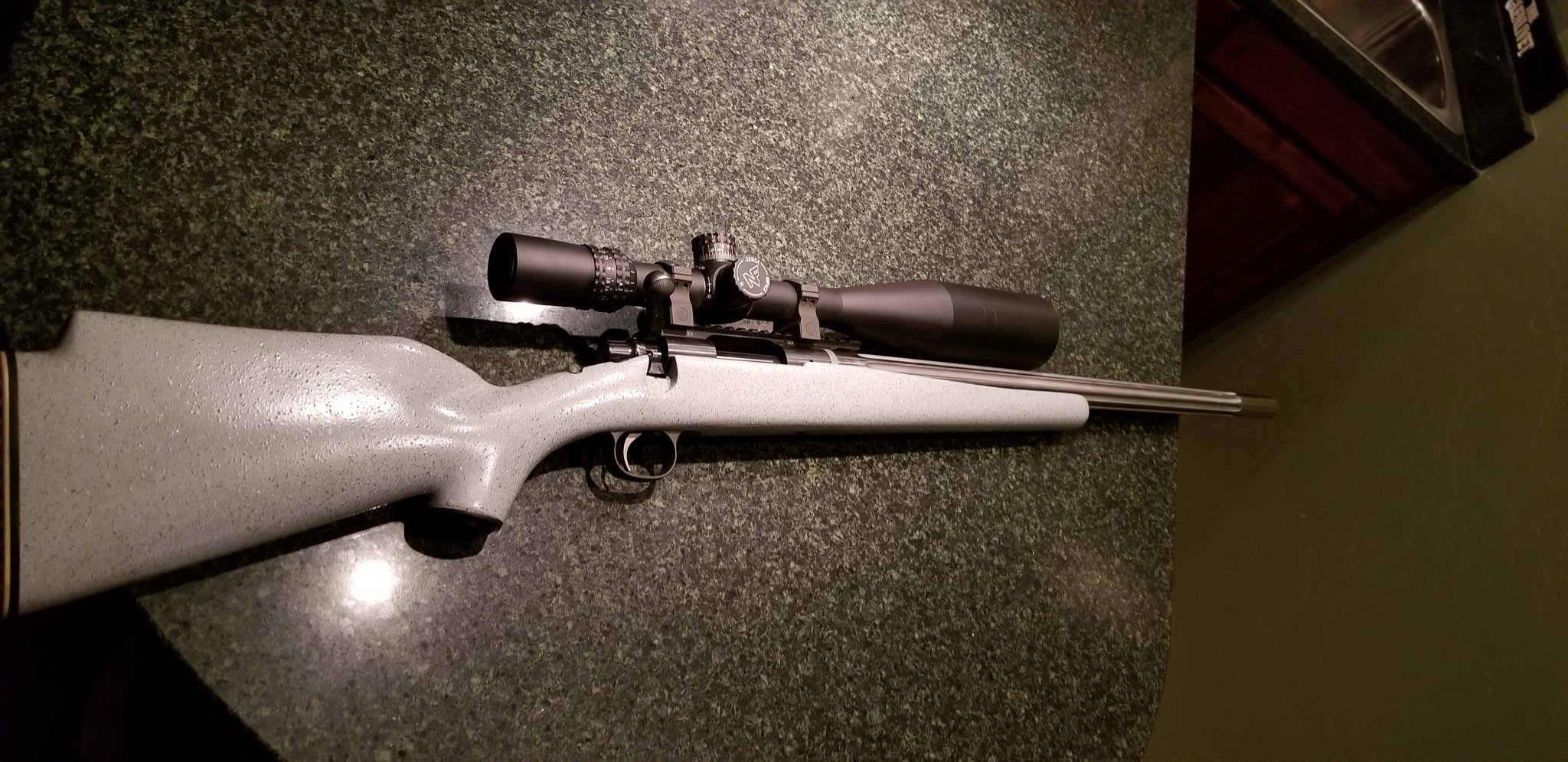

Been shooting an old 6 BR I bought from an old bench rest shooter. just a rem 700 SA with a heavy Krieger barrel that was shot out when i bought it and i have put over 2000 rounds through it, probably has over 6000 through it. Throat and first 5 inches of bore look like a dried up mud lake fire cracked to hell and no rifling. been shooting berger 68 flat bases its whole life and i switched it up to some 65 berger boat tails and 70 sierra blitzkings and it made my jaw drop. gun is funny it has some character, stock is cracked in bout 3 places, the bubble level he super glued to the stock is bout a half a bubble off, it wont start shooting good till the barrel gets hot hot hot. like 20 rounds in. its ate molly coated bullets its whole life. ive only cleaned the barrel 3 times in 2000 rounds because it will shoot like absolute booty hole for about half the year after a cleaning. eats about 50 bullets a week every Wednesday in a local shooting club benchrest match and still wins quite a few shoots. i have shot the same 100 brass for about 20 reloads, neck size only and have only full length sized once to bump the shoulder. have never annealed the brass, and have only split one case. havent even had trim for the last 2 years it just stays the same length.
Great story , good to see the old rig still hanging in there . Interesting that you mainly neck size , what brand neck die do you use ? Thanks
A testament to the BR. Do everything you can do wrong, and it’ll still shoot ok sometimes maybe.
