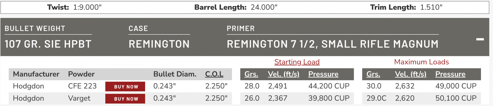

Hoping for a mild, inexpensive practice load, I have done a little testing with CFE223 - which I have a lot of, sitting unused for a couple of years - and 105gr Barnes Match Burners - which I got a pile of cheap:
30.2gr CFE-223
1x-fired Alpha brass, (AMP-annealed, trimmed to 1.550")
CCI-450
105gr Barnes Match Burner (seated 0.060" off lands)
28" Bartlein 5R 1:7.5" twist barrel
Five-shot 100-yard shots average ~3/8" with the occasional 1/4" 5-shot nice one. I saw 2-3" of vertical at 540 yards on paintd plate, viewed through 36x scope (no mirage). Three shots at 400 stacked on the painted plate. I'll do a paper-target test at some point.
Temperature: 45 F. (Temp sensitive powder...?)
Shots in velocity test: 18 (LabRadar)
Avg: 2683​
Hi: : 2697​
Lo : 2664​
ES. : 33​
SD. : 8.2​
Note: this is aggregate of two different "lots" (loaded a day apart) of this load. First nine ES=27, second nine loaded/fired a day later (same temp) ES=20. These are not the "single digit ES" bragging numbers I see here so often, but when I look at my 6.5CM and 6BR aggregate numbers - thousands of rounds for former, hundreds for latter - 30 and under AGGREGATE ES is fine with me. I can find plenty of 5-shot single-digit-ES sequences, but they don't show the real spreads over time. The 6BR, with Varget, is ~25 ES so far (~200 rounds after brass/barrel breakin).
CFE223 is slightly slower-burning than Varget and 30.0 is the top of Hodgdon's published load, so I should be able to get substantially higher velocity. Maybe I'll mess with that later.

Fantastic information. Thanks for sharing. I’m surprised at the slow velocity it was producing, especially with your 28”.
My observed velocity is in line with Hodgdon's published data, taking barrel length and perhaps ambient temperature into consideration. Considering temperature... the ammo becoming cold-soaked over the course of testing may have had some effect on ES... as I recall, a couple of buddies showed up while I was puttering with notes and such, so it took longer than one might expect to fire a relatively few rounds. It will be interesting to test with warmer temps.
Note the low "maximum" pressure in the screen shot from Hodgdon's site. I also included Varget for comparison. It's pretty common knowledge that 30.0 grains of Varget is the "golden" charge for 6BR, and the table below shows 29.0 as max (and it's compressed, with the SHORT listed COL of 2.250 inches). My point is that, based on common knowledge with Varget, I could theoretically add another full grain of slightly-slower-burning CFE223 and still be safe. Time will tell on that.
