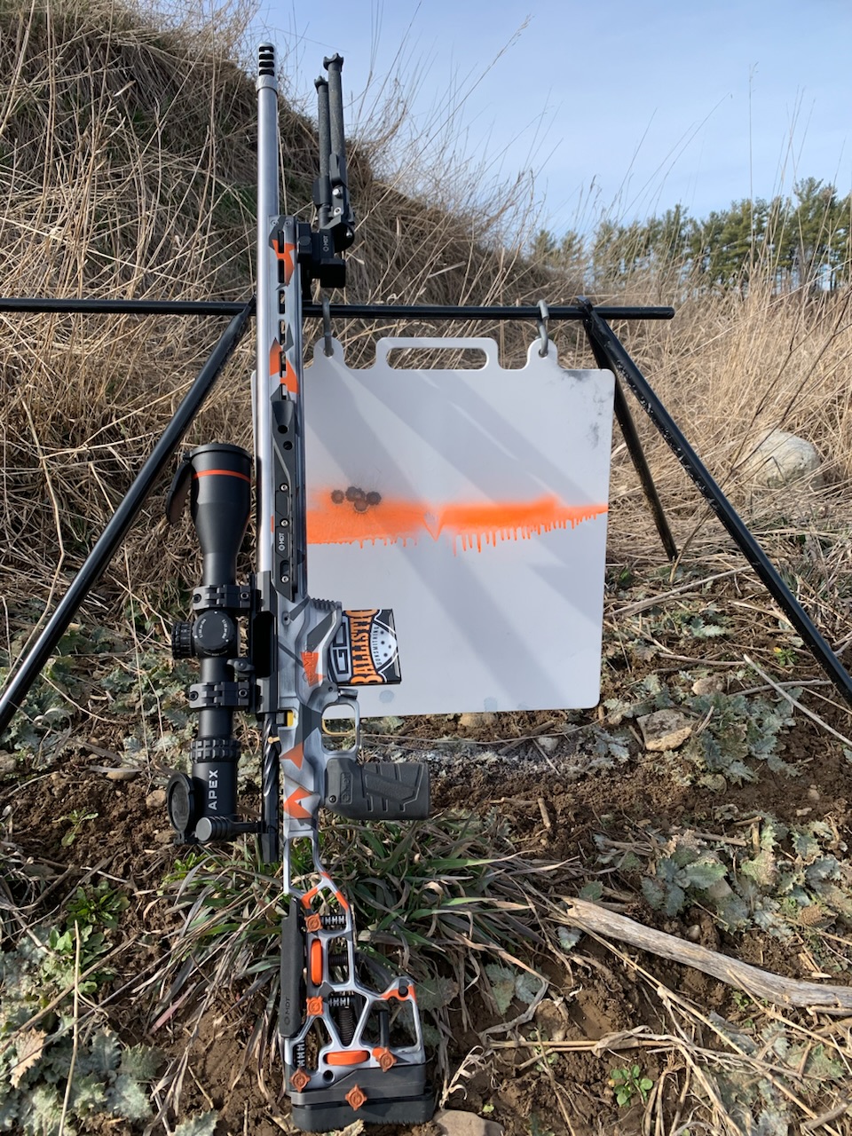

While today was not the day to shoot for groups, it was a good day to practice in the wind. Hahah. 41F and 17MPH sustained with 25-30MPH gusts.
I wanted to test 105 Hybrids/Varget in this PVA Bartlein 1:7.5 6BR barrel. Its 0.113" FB. Ive shot 105's in my previous 6BR barrels but never in this one. Loaded up 1x Lapua, 30gr Varget and 105 Hybrids just barely kissing the lands... Shot them at 200yd in this crazy wind.
Honestly, for as windy as it was I was surprised how well they shot at 200.. Yes, I got a gust that blew at one out of the group on every group, but 4 shots all measured 1/4moa or less. Gonna load up 50rd or so to test at 500-700yd on the next calm day. I also have 2000 Lapua 105 Scenar L's coming to play with.
These are all 5 shot groups shot at 200yd, I only measured 4 shots on each group.. I left out the 1 shot in each group that got blown out of the group by the wind. No development is needed with how well its shooting. Will post up results at 500-700yd with this load on the next calm day.

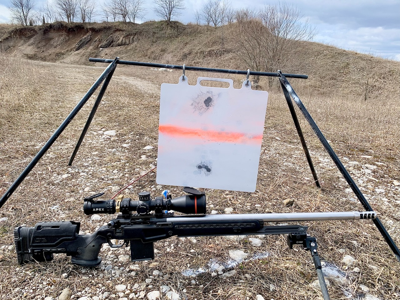

Another windy ass day but a little warmer... 49F and Sunny with a switching 12-15Mph wind. Shot the same load as yesterday but at 300, 600 and 636yd today..
28" Bartlein 1:7.5 HV
PVA Chambered 0.113fb
30gr Varget
105 Hybrids
1xLapua
Just kissing lands

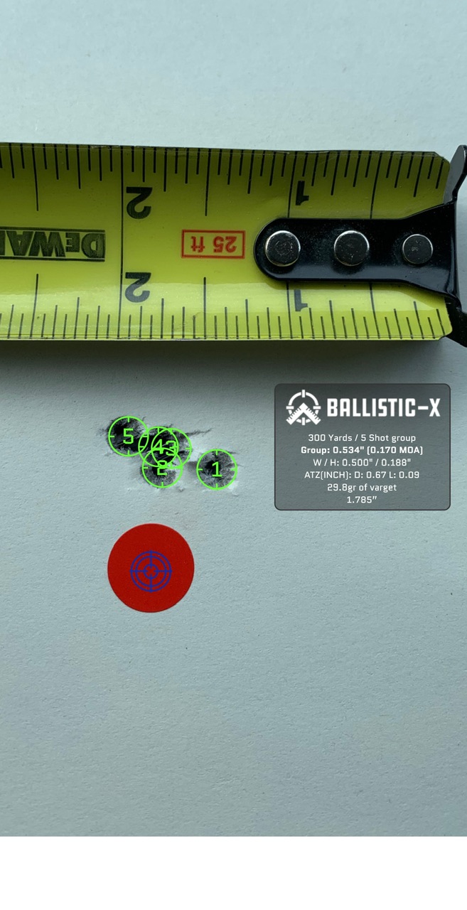

For how windy it was and it kept switching directions, I was surprised with these results today. Very happy with them with ZERO load development but thats typical with 6BR. It shoots everything I throw at it! lol

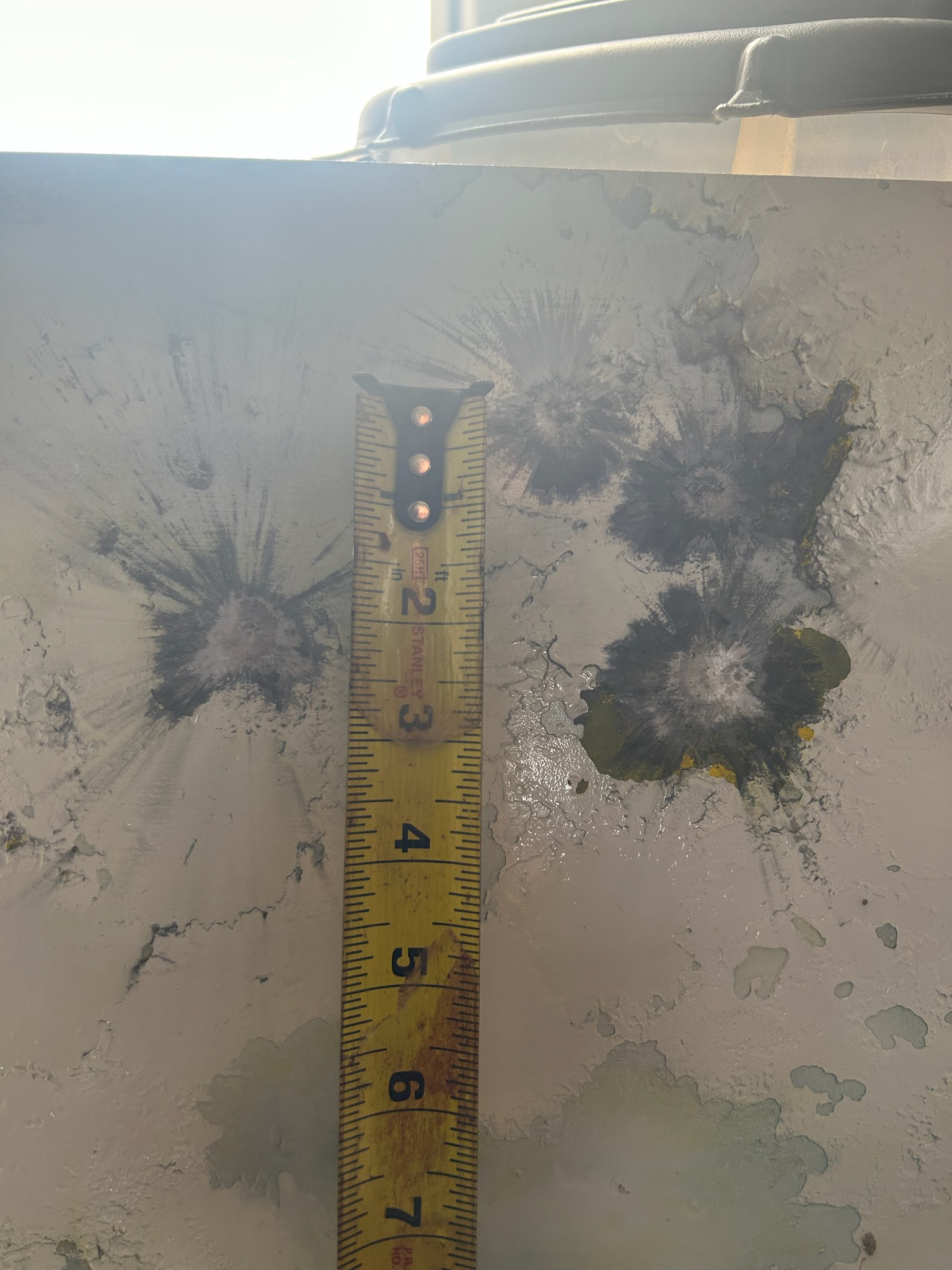

636yd.... Just under 3" 5 Shots
Lapua brass
105 Berger Hybrid
Varget 30.2 grains
BR4 primers
2823 fps
ES 3

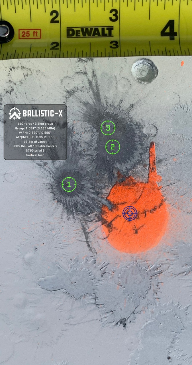

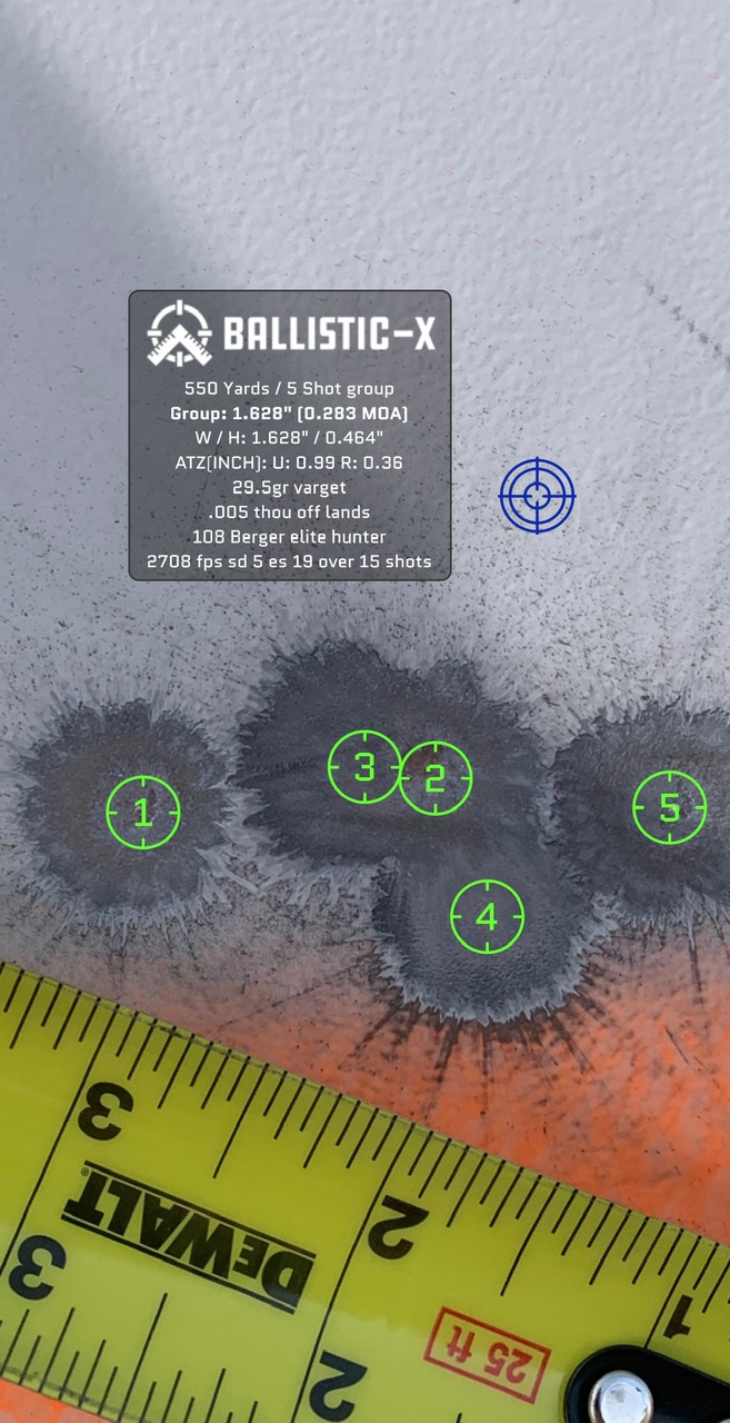

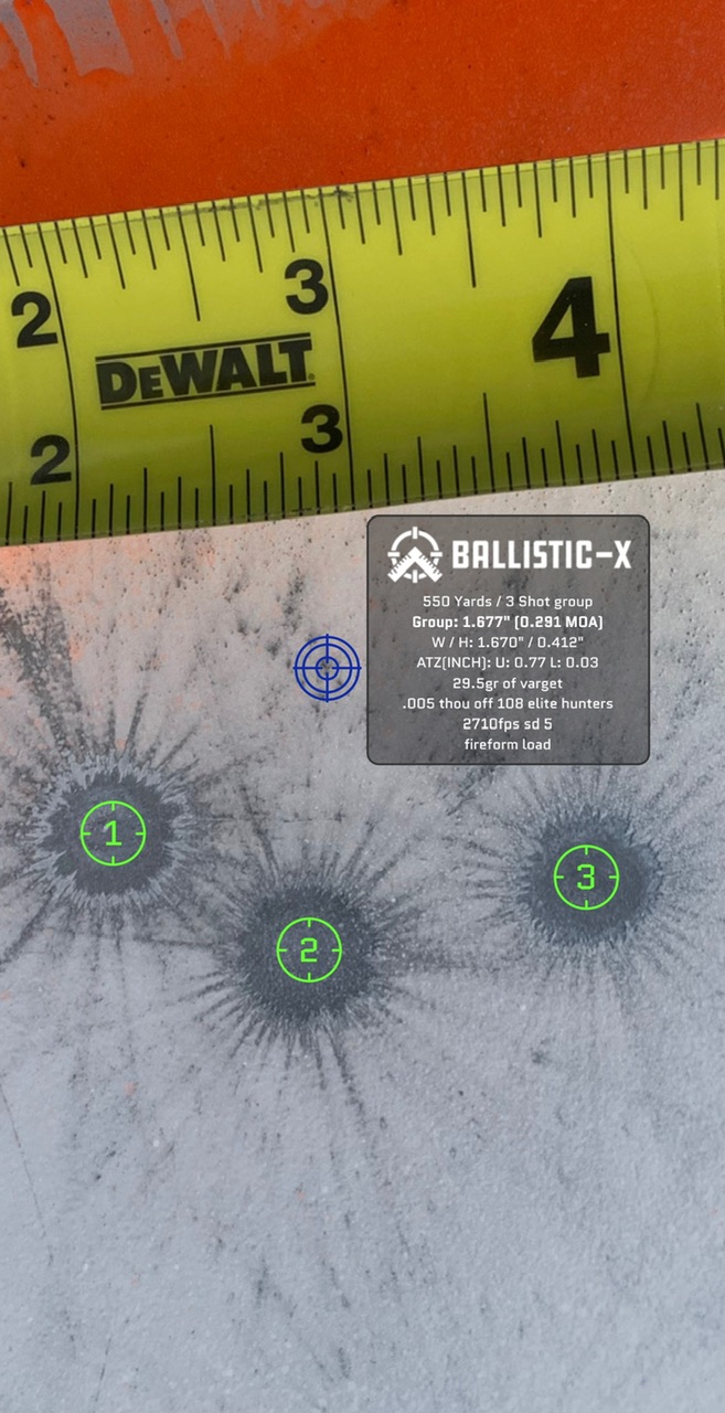

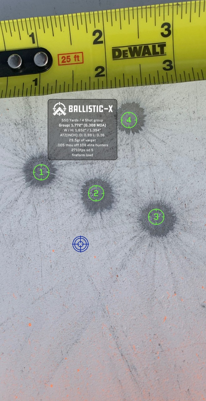

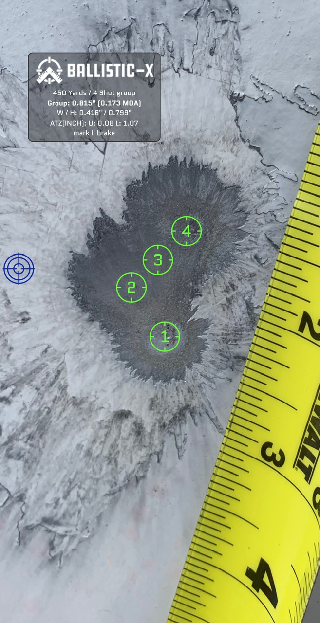

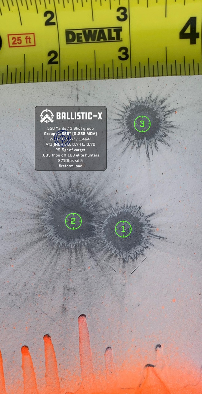

Here is an example of the fire forming loads and barrel break in of the new BRA barrel from 2 days ago and that was also a random load, with a powder I haven’t used in a bra, with a bullet I don’t have experience with seated .005 thou off. So you can see both the bra and br are extremely easy

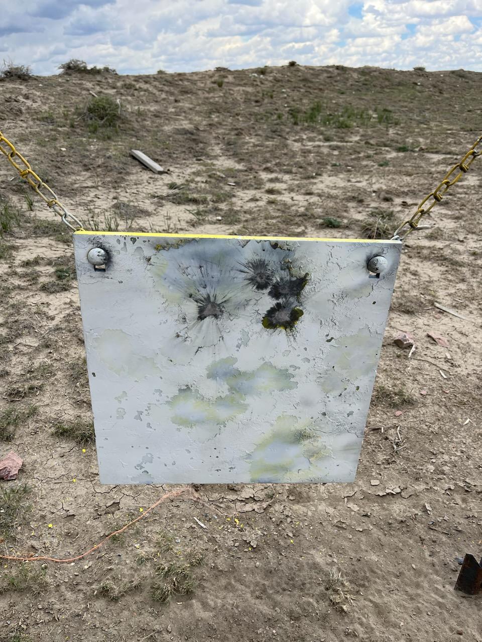

This is 980 yards with strong 12-20 gusts.
Once I found my wind ( 2 mills) I was on target and only had 4 rounds left. Not too bad on the vertical string and I'll take the horizontal as it was definitely the wind.

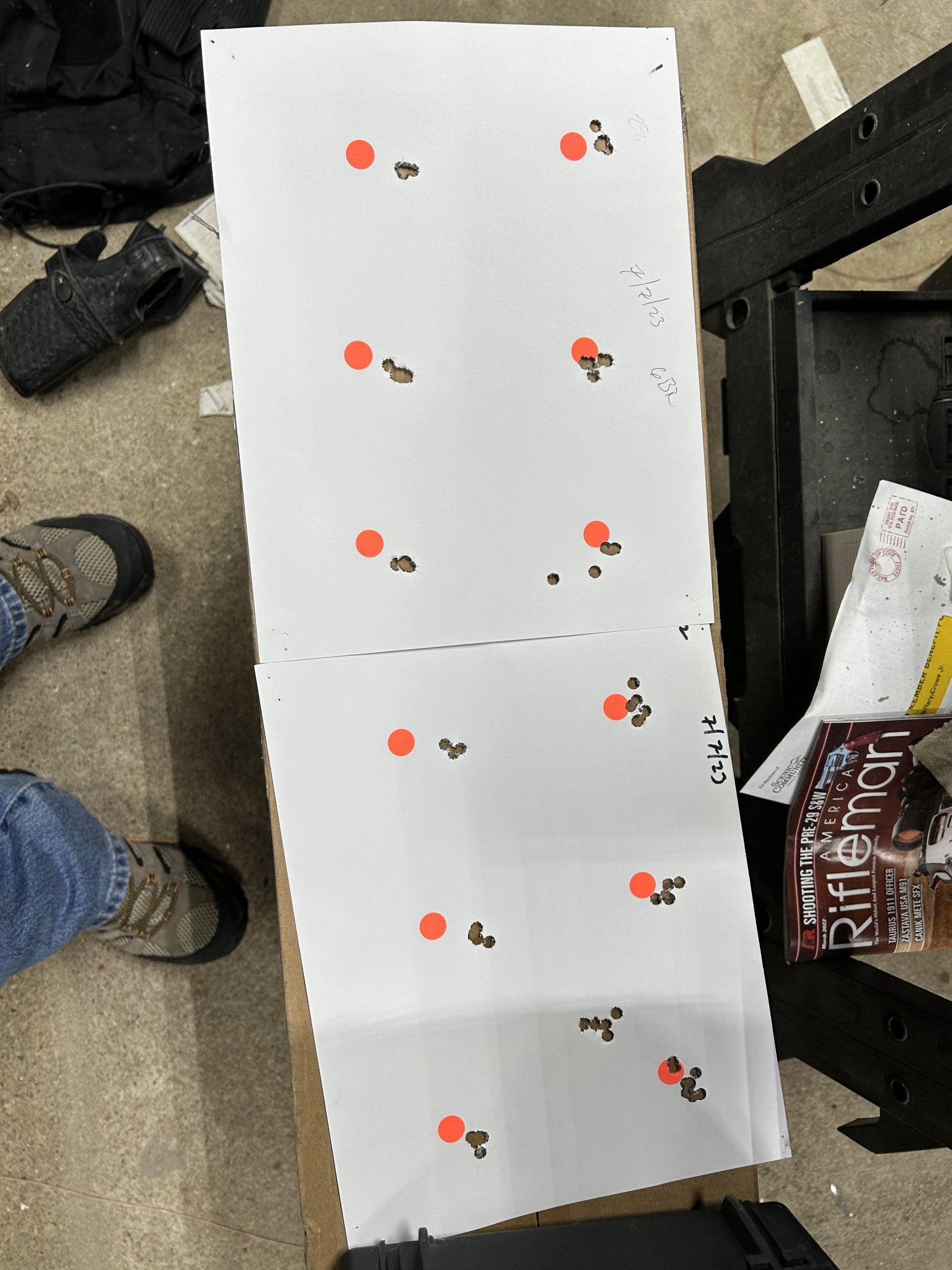

From left to right top row 29.2 29.4 29.6 29.8 30.0. All with 105 Berger Barrel is a strightjacket 1-7.5 21”. Suppressor is a TB ultra 9. Bottom row same except 4 rounds not 5. Now the fun part. Bottom right is 1 round of each and all in the same hole. So which one would you start with.
