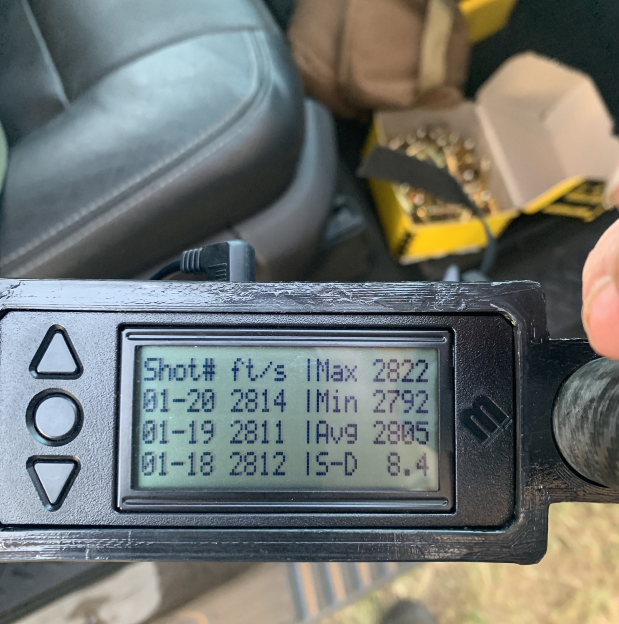

I've been playing with 200 pcs of Alpha brass and have been underwhelmed. Running 105s, I have a node at 2920 (31.6 IMR 4166 / 31.4 Varget). It won't shoot the heavy 6mms though. At 2810 with 112 Matchburners, I'm running slightly sticky bolt with 31.4 Varget (this is my low low node with Lapua) . Seems like it's ok for the 105s, but won't handle the 110+ bullets. Lapua is just the easy button. No issues, and you can find hydroformed brass for ~$150/100 vs Alpha at $115.

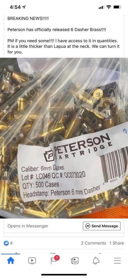

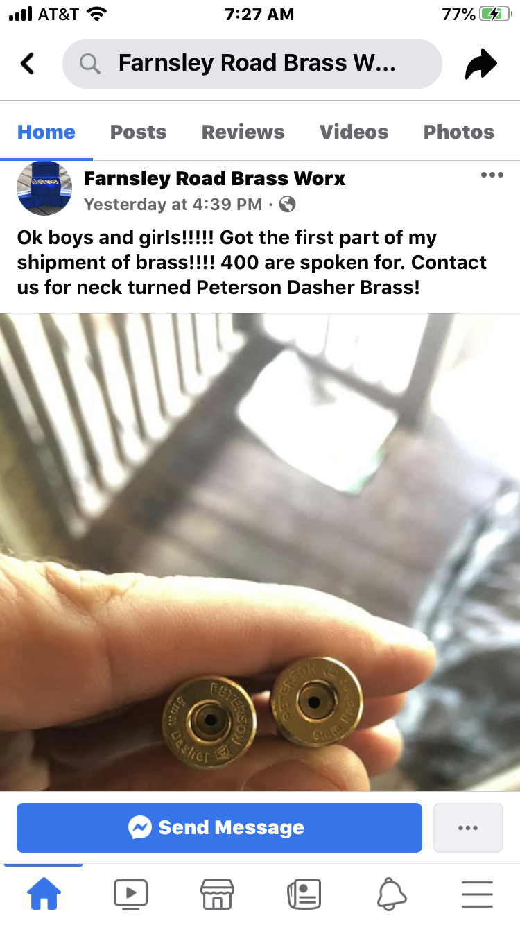

Got my Peterson in. They are about .0135-.014 neck. Loaded round is .270 and I have a .272 chamber. I have IDOD neck turner, so I’m going to turn them to .012 for .005 neck clearance.
Gonna do 20 to make sure I don’t have the issues I had with alpha dasher. Then gonna load up 200 and use the RO mover clinic this weekend to get my new dasher barrel sped up.
Reactions: CV_Ag
So they have the same loaded OD as the Alpha.
