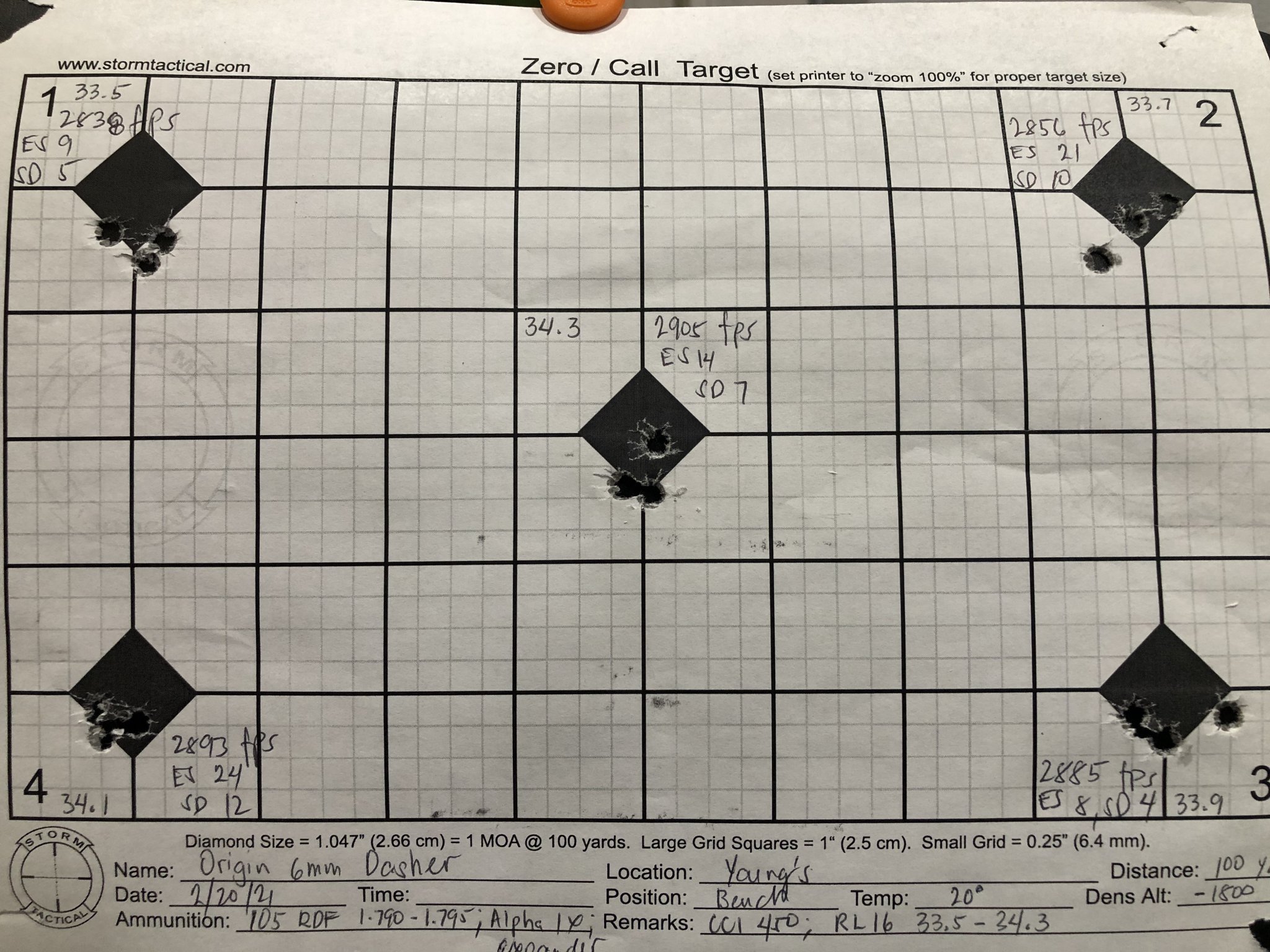

Promising results with 105 Rdf and RL16. I also tried H4350 but rifle didn’t like it. I only fired 3 shots per load to conserve primers. Pulled 3rd shot on grp 3 but vertical still looks good (4 out of 5 groups would have been sub half moa). I’ll will load 33.9, 34, and 34.1 gr next trip.
Reactions: MarshallDodge
