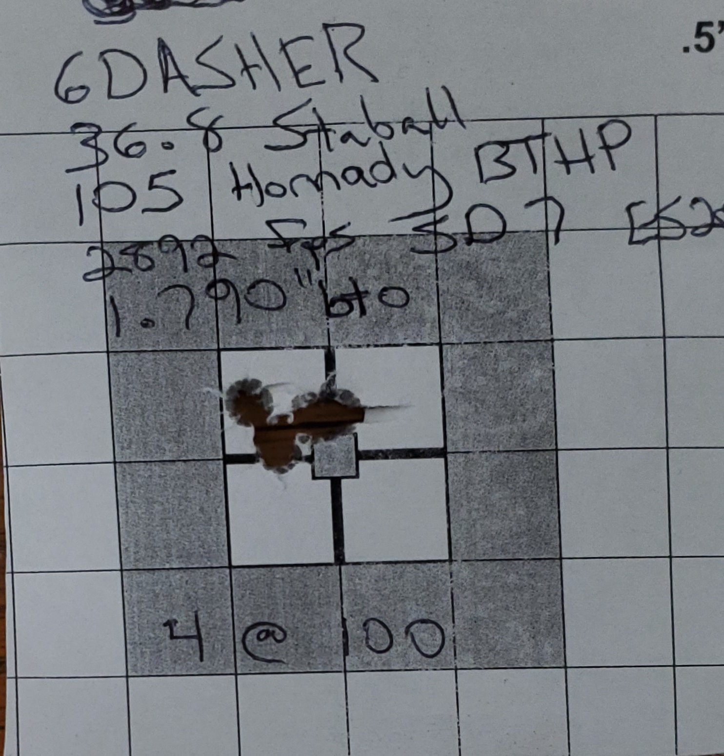

More staball testing info
Tested 36.8gr of 6.5 staball behind the 115 dtac again today. It's about 25-30 degrees warmer today than last test. Speed was 2857 on the first test @ .015 off
Test today was @ .005 off the lands and had groups 1/2in or less every time. Todays avg speed was 2868 fps everytime for 3x 5 shot groups. First 5 shots had an sd of 9
Second 5 had an sd of 7(1 flier that was 15fps slower or I'd had sd of 2 and es of 6)
Numbers aren't bad, not varget numbers, BUT!!!.....I POWDER DROPPED ALL THESE CHARGES ON A STOCK RCBS POWDER DUMP!!!
My varget load definitely shoots a little better than this one, but I think unless I'm going to a really far range you will never see it. Well, I wont, but that's because I suck. ?? Going to get my 550 fired up next week
I know this is going to get a bunch of hate...

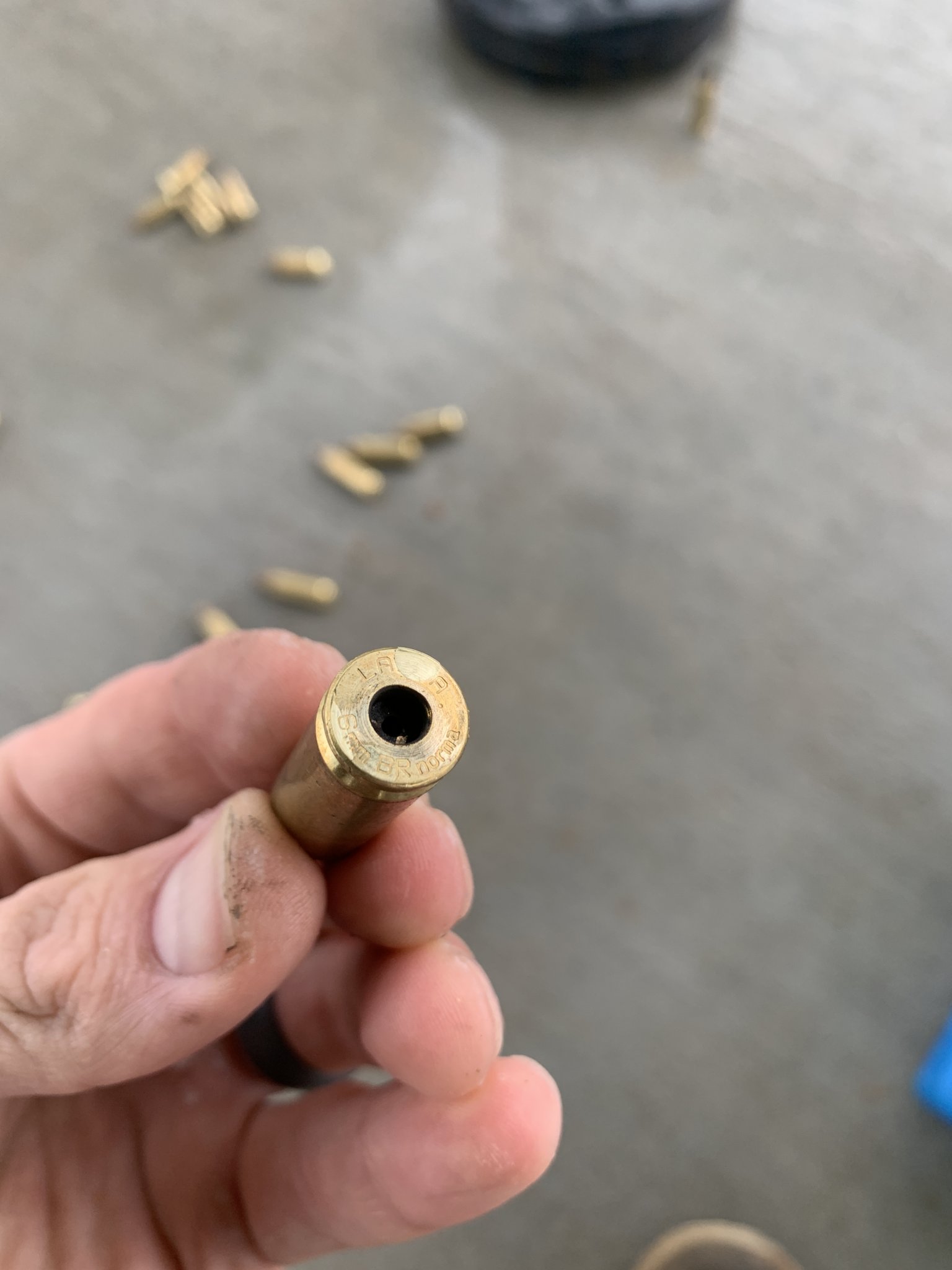

I ran 29.7gr AR Comp & 105 hybrids at the finale, somewhere around 2925 FPS, and it worked fine but I occasionally had some sticky bolt lift. Didn’t think much of it until I tried it in the rain a couple of days ago and blew primers and locked up my bolt. Back to Varget I go!

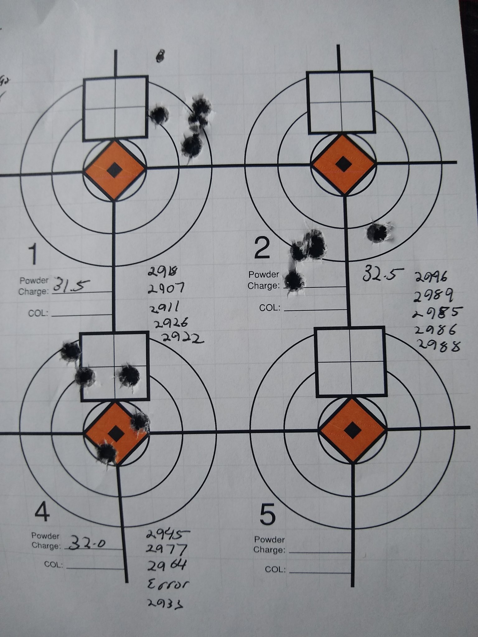

29.75" 7twist brux
112gr match burner
Xbr 8208
Some ok groups on a new barrel. I'm stunned though by my 32.5 load.
Not the best group, but an SD of 4 @ 2987fps. Slight ejector swipe.

Thanks for posting and sharing load details, more people in the discussion is always good. If you don't mind I'll share a bit of constructive feedback since it seems like you're just getting familiar with the Dasher.
XBR is a faster powder, and a 112 is a heavier bullet relatively speaking. Both of those contribute to pressure, so they're not an ideal combo, you need to back charge weight off more than you would if you're running a slower powder like Varget. Even your 31.5 load sounds hot to me. My experience has been that I'd run about 1gr less XBR than Varget, and with a heavier bullet like a 112 I'd take probably another 0.5 to 1gr of powder out compared to a 105 With a 105gr bullet my personal max is 32.0-32.5 Varget. If I had to run XBR and a 112 I'd probably be around 30gr charge weight, and Quickload still puts that at close to 60k PSI. This conservative approach is for the purpose of having a gun that runs smoothly and reliably at PRS matches. Yes you can go faster, but there's a benefit to reliable easy function over speed.
Second, I would place WAY less importance on that SD number, until you're looking at groups that are all really good. Then you can use SD to help pick which one is the best.
Third, and the thing that jumped out at me is that those groups are terrible for a Dasher. Like really, really bad to the point where I would throw away a barrel if it shot like that. I'm assuming you shoot capably, so what those groups tell me is that the barrel does not like that powder/bullet combo in that area at all. Normal load development should look like some groups at 1/3 MOA, most at 1/2 MOA, a couple ugly ones at 3/4 MOA.
If you have Varget, I'd try that in the range of 31 - 31.5gr. If you want to stick with XBR I'd see what results you get in the window of 30-31gr.
If you still get groups that are 3/4 MOA or worse, it might be time to try a different bullet.

This was what I wanted to say but didn’t know how to not sound rude. My first thought was, “is that 100 yards?!”
I was thinking it was a 300-500 yard group. Dasher is SO much more capable than those groups. I would follow what Sheldon said. I’m only saying this to reiterate it so you’re not thinking he was the only one trying to pull your leg or something. Back to the bench.
