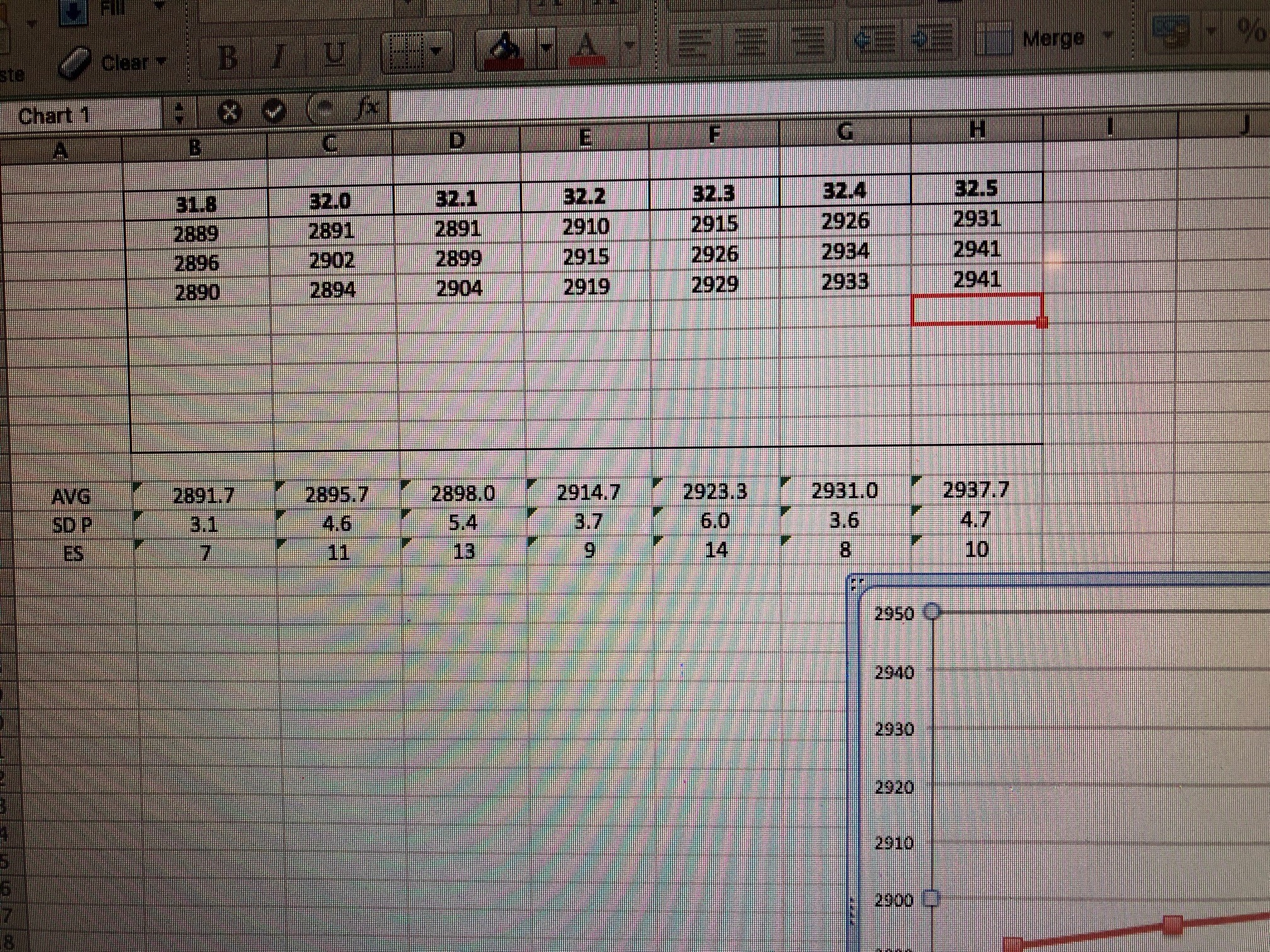

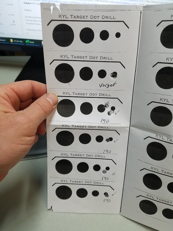

I took a huge gamble and bought 8 lbs of VV N140 to have as back up or replace my Varget load with no testing or good online data. Fortunately I think it worked out. I duplicated my Varget load but it had a little more bolt lift however this powder is very temperature stable.
Traditional load:
- Hawk Hill 26" barrel by Ryan Hunt (1000ish rounds). 32.6 grains of Varget with Lapua brass and a 105 Berger Hybrid Target. Typically around 2960 fps but today's average was 2945 at 68 degrees.
VV N140
31 gr = 2807 fps
31.5 gr = 2889 fps
31.8 gr = 2887 fps (?)
32.0 gr = 2906 fps
32.2 gr = 2918
32.4 gr = 2941
32.5 gr = 2943
32.5 gr = 2948
32.6 gr = 2959
I did a temperature stability test by placing three rounds of N140 at 32.5 grains and my Varget load of 32.6, both average 2945 fps, in the freezer for an hour.
Varget (2906, 2933, 2934) avg = 2924, ES 28. Average velocity difference from 68 deg to 30 deg is 17 fps.
N140 (2918, 2923, 2939) avg = 2930, ES 21. Average velocity difference from 68 deg to 30 deg is 15 fps.

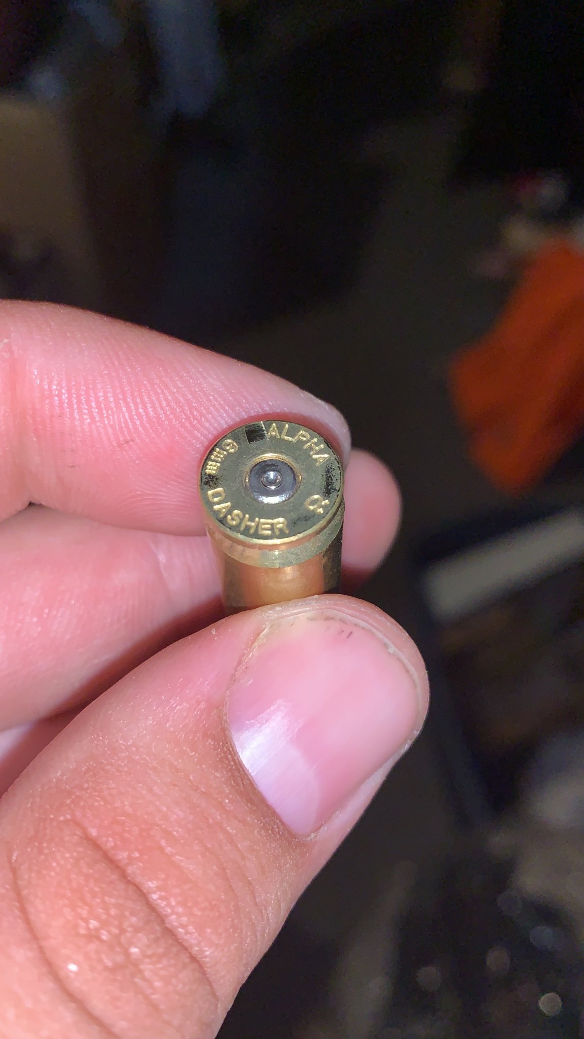

Question for you guys running alpha brass. I might be mis-remembering, but I thought I read here that you should lube the necks on virgin Alpha. Is this the case, and what would be the benefit? I just ran a quick pressure test and it showed pressure ~ 50 fps slower, and ~ 1 grain less than my current lapua load. Not too concerned, but figured I'd ask.
I just got 200 pcs and did a quick pressure test.
Barrel specs:
26" Bartlein 5R, RH gain twist (I'm a lefty) 1:8-7.3, .140 freebore and ~675 rounds down barrel. Freshly cleaned for test. 10 foulers shot prior to testing.
My current load is:
Lapua brass
112 MB
32.3 IMR 4166
CCI 450s
~ 2875 fps
My work up with Alpha brass went from 30.9 to 32.5 in .2gr incraments with CCI 450s and IMR 4166
I ran an expander through all necks, chamfered, and deburred.
30.9 - 2801
31.1 - 2817
31.3 - 2829 (faint ejector mark)
31.5 - 2831 (eject mark & sticky bolt)
31.7 - 2848 (ejector mark, semi sticky bolt)
at this point I stopped the test
I figure I will finish loaded new Alpha with 105s to get them once fired and revisit this test after

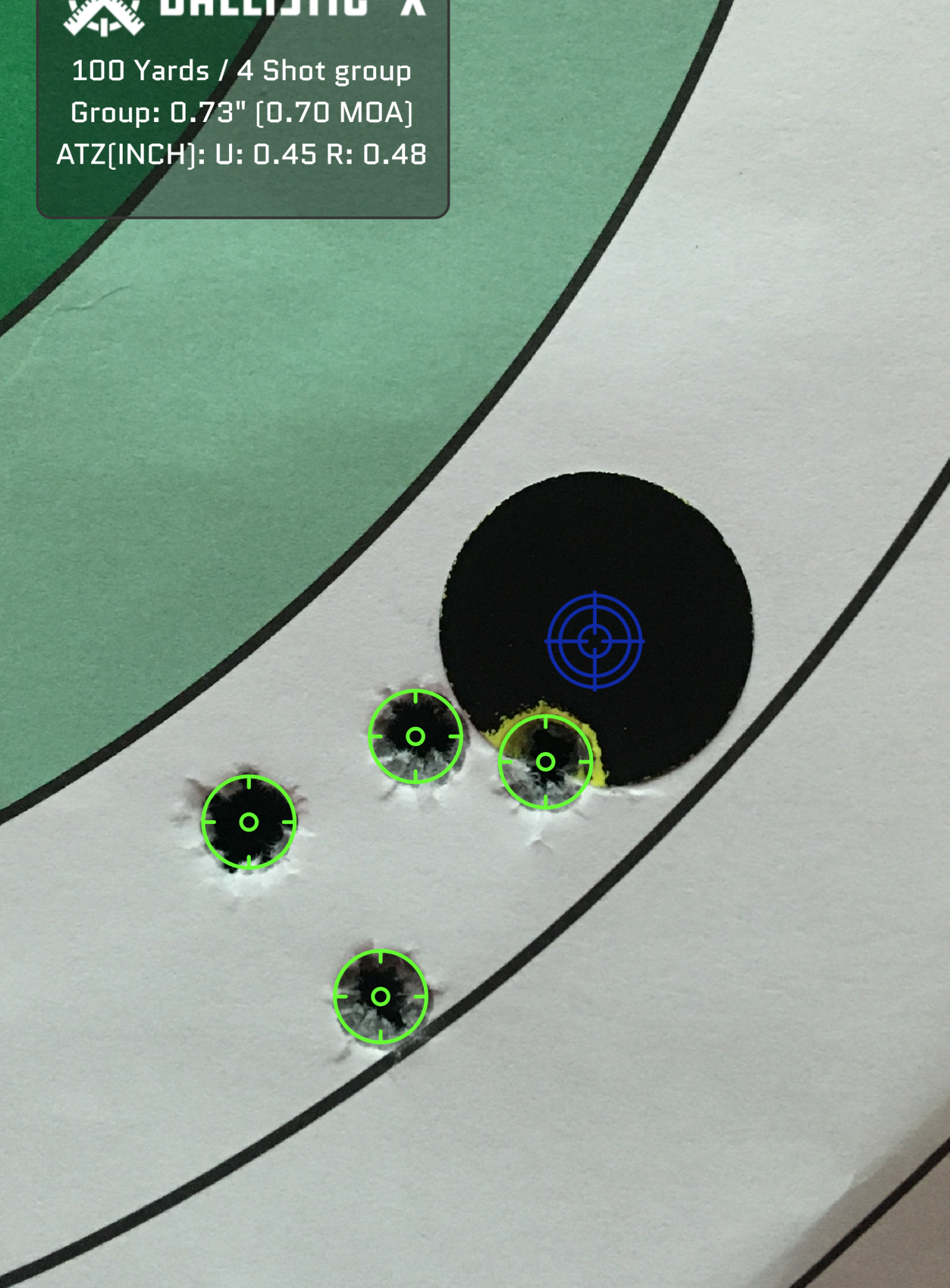

Interesting results from the 109 Hybrids this weekend for me:
- 26" MTU contour, 1:7.5", 4 groove IBI barrel
- 6 Dasher, .104" FB/.274 Neck
- 31.6gr Varget
- Lapua fire formed brass
- CCI 450
I was planning on doing a jump test, using the same powder charge I use for my Hornady 108's. I started at .020" off and was hoping to work back to .100" off with .020" increments, however, at 31.6gr/.020" off I was at 2965 ft/s and had a sticky bolt on 1/5 rounds (not where I want to be).
Gonna try a modified ladder at 30.5 - 31.5 gr to get a ballpark speed out of these things and try another jump test this weekend.
Josh
Reactions: CV_Ag

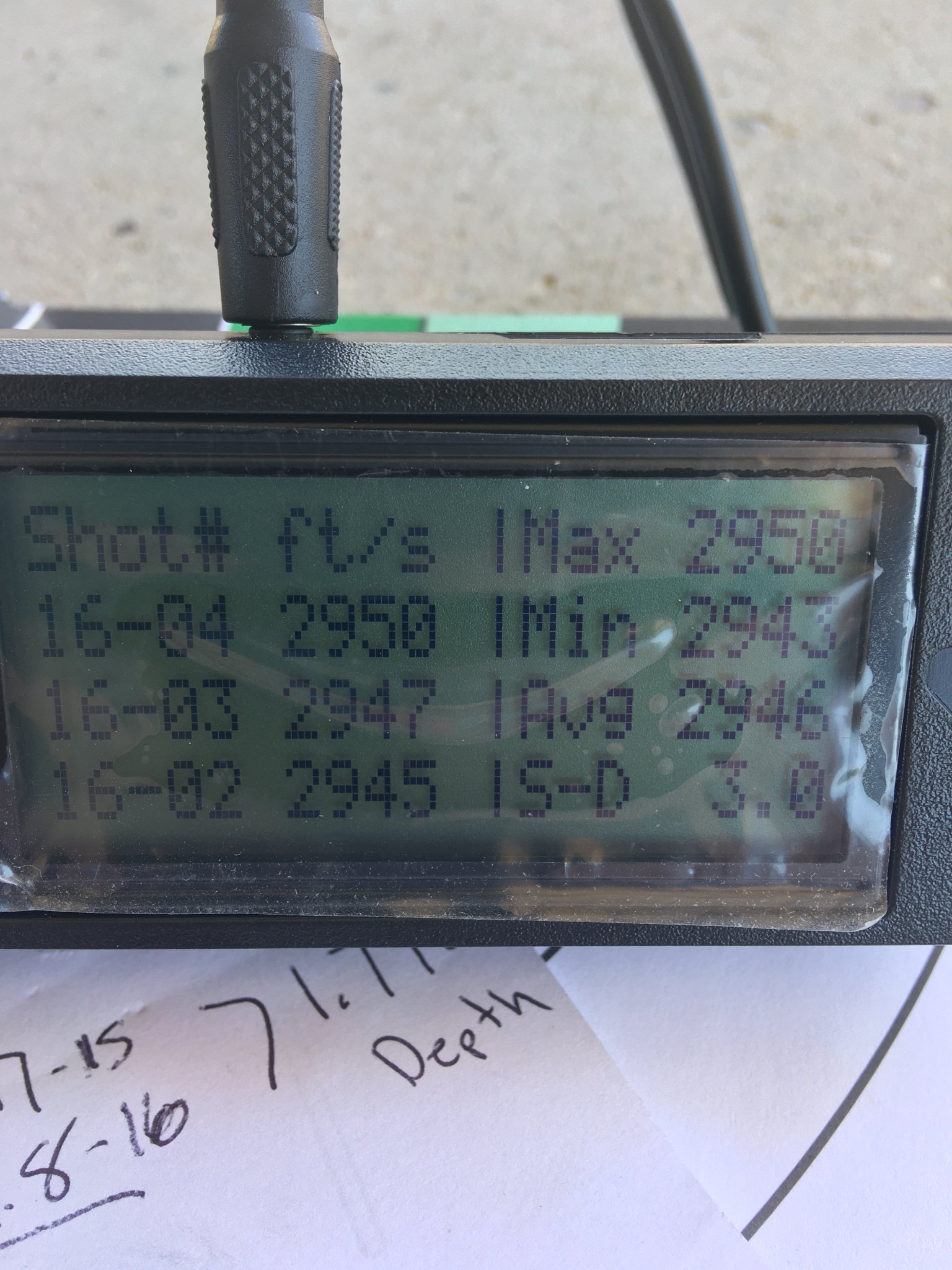

A follow up to my post above, took 10 cases of Alpha, shot two 5 shot tests at 31.8, 32 grains of Varget, CCi 450. berger 105 Hybrid, speed was 2935 on the 32 grain groups, accuracy was very good for me and this CBI barrel. maybe slight sticky extraction on some 32 grain cases. Cases were prepped with inside/outside deburr and run thru neck mandrel to set tension at 1.5 thou. when loaded neck clearance 2 thou or just a bit more. .272 reamer.
second loading and firing of the 10 cases today. 32 of Varget again, speed up at 2946, accuracy very good, at 300 yards under .4 Moa. still a couple sticky cases. going to do some powder changing and test further.

anyone have much experience with Alpha brass? 31.8 Varget 105 Hybrids showed pressure signs and heavy bolt lift today. Cases has been loaded 3x. Didnt show pressure sign @ 2nd firing.
Do you have any marks on the case head, I had a similar issue but it was due to bumping the shoulder to far and allowing the case to slam into the bolt face.
Okay, That’s a little weird that it happened on the third firing and nothing before, so that sorta rules out a brass prep issue unless something magically changed. I ended up contacting alpha directly with what I was experiencing and send them over a whole bunch of measurements to compare to their numbers. In my case it seemed that I bumped the shoulder back .004 instead of .002 which caused just enough movement to be an issue.

I am officially a fan of the Dasher kool-aid! I spent the last couple months fireforming 500 pieces of brass and finally got around to some load development.
This is actually a 4 round group at 100 yards with 32.0gr of Varget(Magneto didn't register the first shot). You can also see the SD's and velocity's of my small ladder test.
Berger 105 Hybrid
0.060" off the lands
CCI 450
1x fired Lapua BR brass
0.002" Shoulder bump
.267 bushing in Redding S die (Expander ball removed, did not run a mandrel thru either)

Did you do any seating depth testing to get to .060 off the lands?
