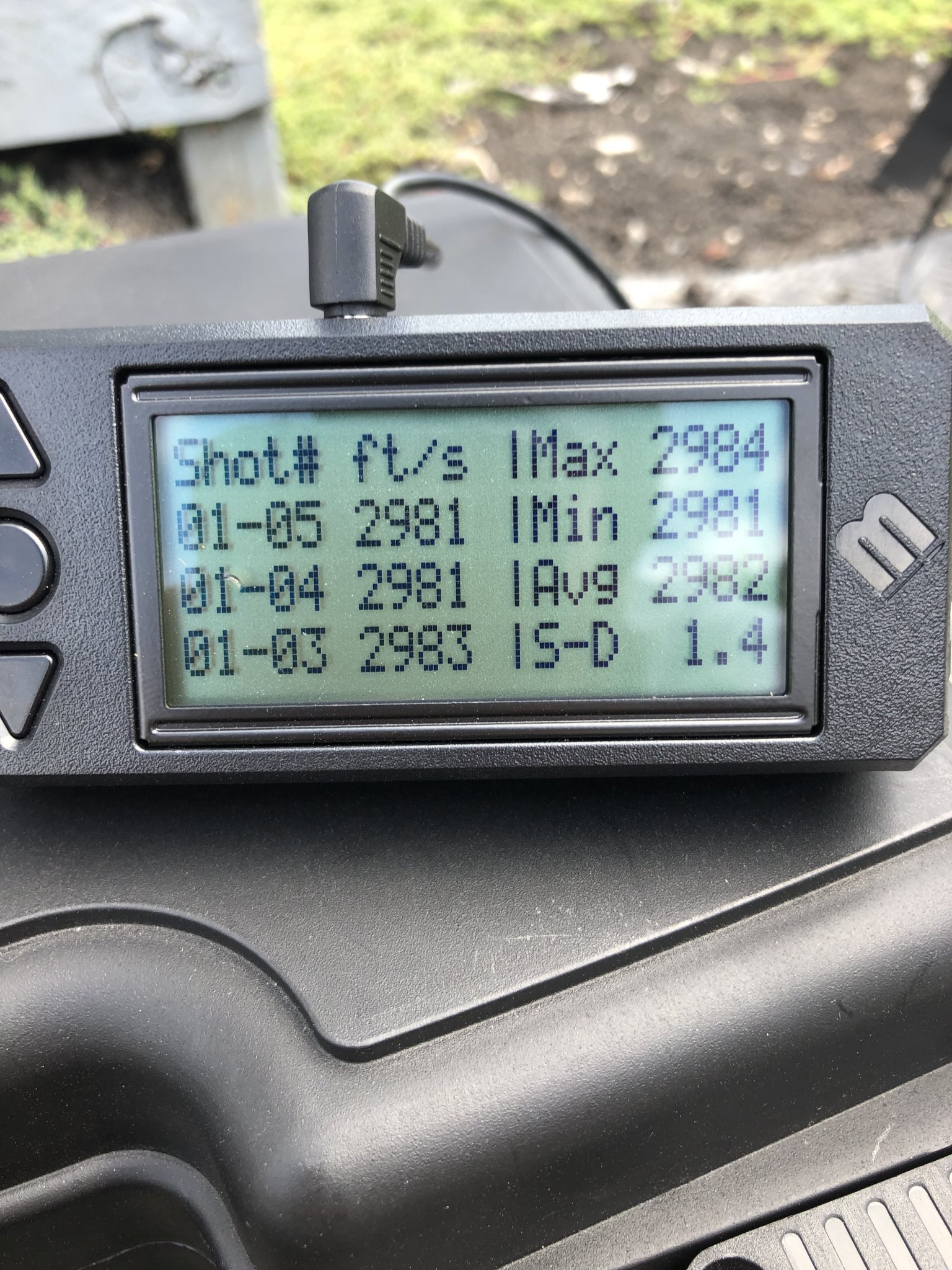

105 Hybrids
32.2 Varget
2982
Cci 450
26” Krieger
.020 jump
Faster than I was looking for. Started with 32.6 but that put me close to 3020 FPS. Would’ve had to back down to 31.8 to get close to the popular 2960 node but repeated 32.2 testing gave great SDs and less than 1” of vertical at 500 yards so it’s what I landed on.

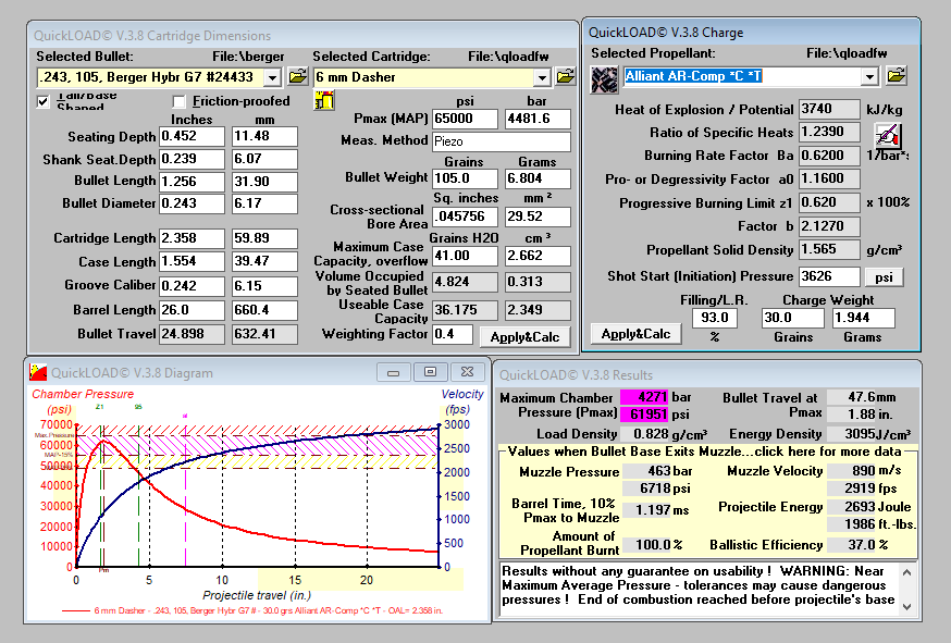

Just tried AR Comp with the Dasher, and it appears to have a lot of potential. It definitely is beating Varget in terms of ES/SD.

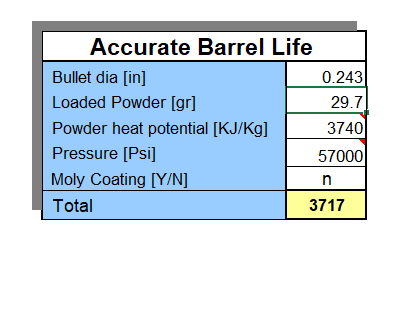

I have been kicking around trying AR Comp too, look at the bottom right number of this pic, unheard of, which makes me think AR comp even better in 6BRA
View attachment 7176374,

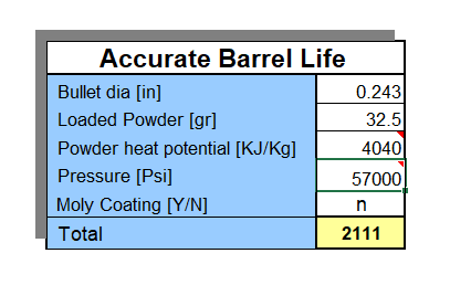

And with a case capacity of 41.2, a 28” tube, and 29.7 gr, which is the 1.279 node @ 2920, the barre life calculator says 3600+ rounds.
Reactions: 702lineman
Seems pretty wild if this is even close to accurate barrel life wise.
AR Comp @ 2920 FPS
Varget @ 2950 FPS
