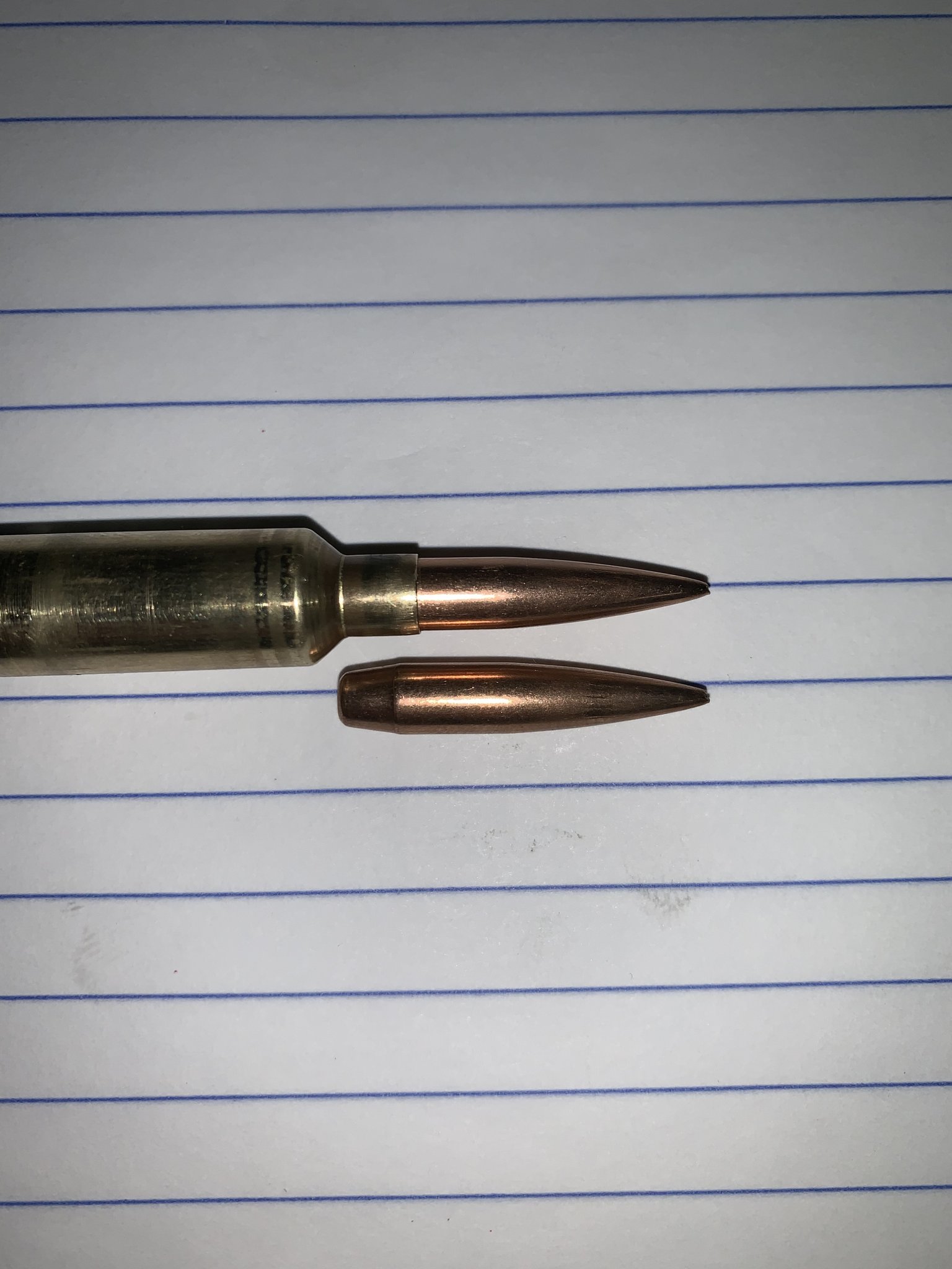

That’s the same FB I have. Is the boat/bearing surface junction on any of the bullets you tried below the shoulder/neck junction on the brass?
Yes. The 108's for sure are seated quite far into the case and I could snap a quick picture if you'd like? Playing around with the 110 SMK's and 105 RDF's, I had them all seated pretty deep.
In saying that, I am getting really good speeds out of my Dasher now and I jump the 108's 0.030" for pretty consistent groups :)
If it works it works. I was just curious since it has such a short neck. What are your speeds now?

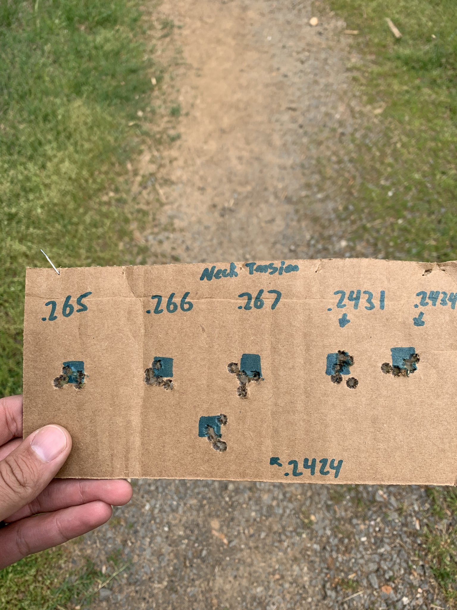

I’ve had an interesting venture so far with my dashers load development. I’ll post this here in hopes it helps save someone else time and barrel life.
I am 400 rounds in now, including 100 rounds from a match.
I could not get this thing to group at 100 to save my life, SDs were very good, but groups were shit. With both 105 hybrids and 112s, see picture.
To save a lot of picture uploading take my word for it that groups were like this among 4 different powders, two bullets and every seating depth imaginable.
I thought there was something wrong with the thing, and my gunsmith thought there might be too. But I had a match coming up and said what the hell, the SDs are good, I’ll just fireform this hydro brass and at the very least I’ll have fireformed brass by the end of the match. Well, I took first place in the match. Did not expect that. But just goes to show 100 yard groups aren’t everything.
In talking with my buddy after the match about how shitty this thing shoots, he said try neck tension and that his dasher liked more than usual. I’d never needed to do anything but the standard .0015 to .002, so I went home and loaded up a string with various neck tensions with every bushing and mandrel I had available. Pic below.
Interesting....some definite improvement there. However the added neck tension brought my pressures up too much and my primers were very very cratered, to the point they were starting to extrude into the firing pin hole. (Load was 32.4 of H4895 at 3000fps) So I decided the final task would be to go and revisit lower nodes I’d seen show up in testing before.
And here we are..

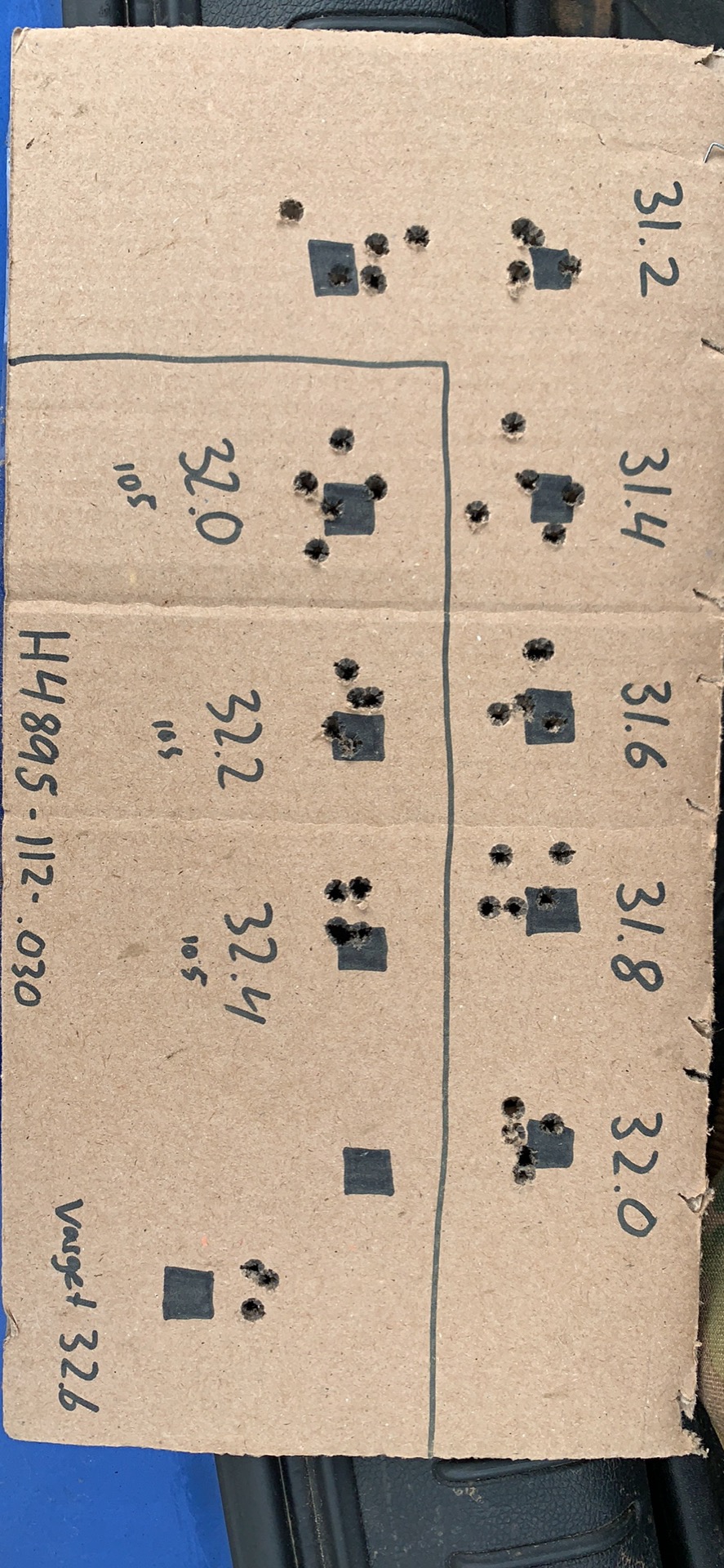

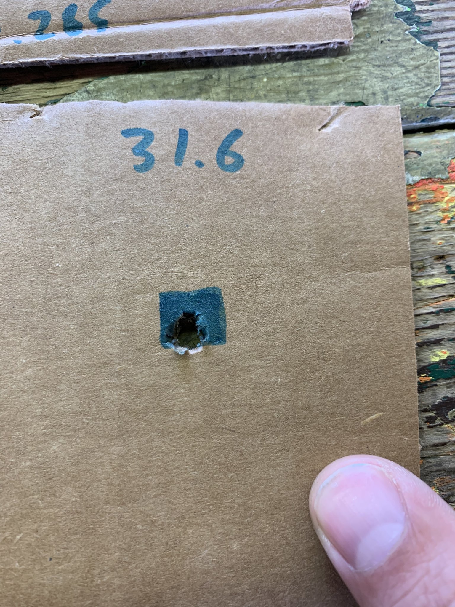

112gr Barnes Match Burner
31.6gr H4895
.015 off the lands
.265 neck bushing
2886fps SD: 2.6
Yes, that is 5 shots.
105 Hybrid
31.4gr H4895
.015 off the lands
.265 neck bushing
2951fps SD: 2.0

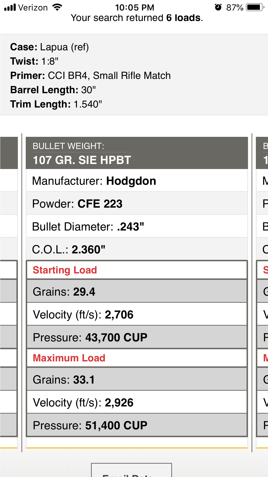

Wondering if anyone can help me on freebore and OAL measurements and seating depth on dasher. I’ve been through all 6 pages here and some others and I see a lot of “.010 jump” and such but not many base to ogive figures.
I’m new to dasher but not to reloading by any means. I’m measuring for seating depth using a hornady OAL tool and planned to run 105 jlk but not sure it’s going to work.
I have a Robert gradous 6 dasher barrel for my AI I picked up recently on here supposedly low round count.
Here is measured OAL for 3 bullets
105 JLK 1.892”
107 smk 1.855”
115 dtac 1.918”
Is this even close to normal?
Picture of 105 jlk attached, no way can I run even a .050 jump and have reasonable bearing surface in neck. Are there really freebore that long guys are using? Do I just load it where I want it and not care what jump is?
105 JLK 1.892”
107 smk 1.855”
115 dtac 1.918”
Picture of 105 jlk attached, no way can I run even a .050 jump and have reasonable bearing surface in neck. Are there really freebore that long guys are using? Do I just load it where I want it and not care what jump is? View attachment 7120034
