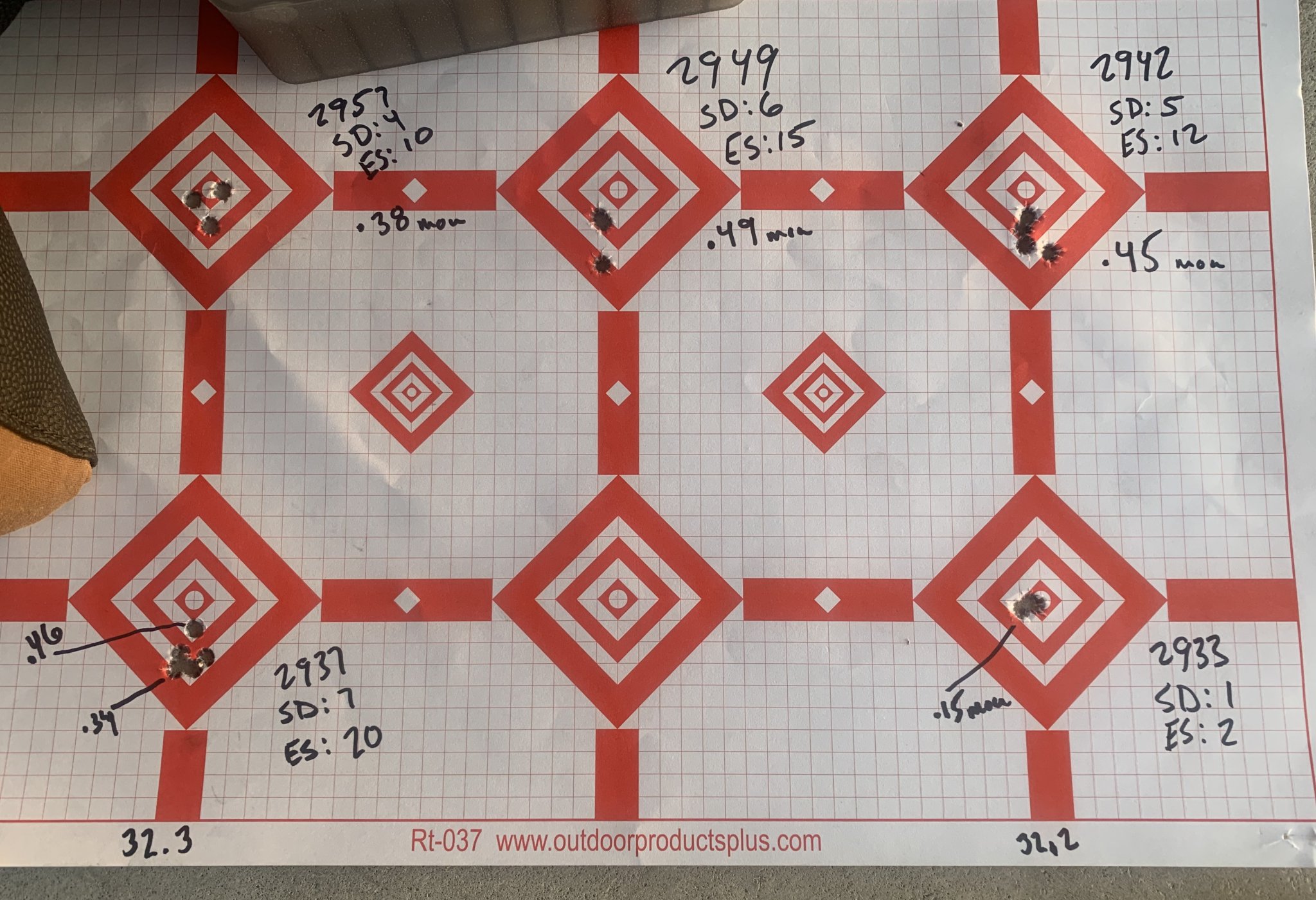

Ran through a .266 bushing and chamfered mouths. I should have uniformed primer pockets I guess. A lot of them were extremely tight compared to lapua.
My barrel likes 32.6 with lapua and runs around 2960.
32.6 runs 2958 in alpha and no pressure signs.
Apparently my barrel likes 32.2 with alpha brass. I just loaded up 8 rnds 32.2 as zero ammo. Turns out it likes it (of course ?). So I did 3 on paper and 5 over magneto.
The rest are 3 or 5 on paper (3 if it wasn’t looking like sub .4 group) and 5 over magneto.
I’m pretty sure 32.3 was my fault on the high round. It was shot number 4 and I’m not the best at shooting groups.

I finally got a chance to try staball today. Looks promising I think. Let me be clear to what I'm after here. I'm wanting to run this in my dillon 550 for practice ammo and local club match ammo(515 yards). I plan on using varget still for bigger matches.
My varget load
32.5 varget
Lapua 6 dasher .130 fb
Cci 450
115 dtac
1.795 bto .005 off lands
2820 fps sd of 2 and es of 9
I used the satterlee method for this load development and worked great.

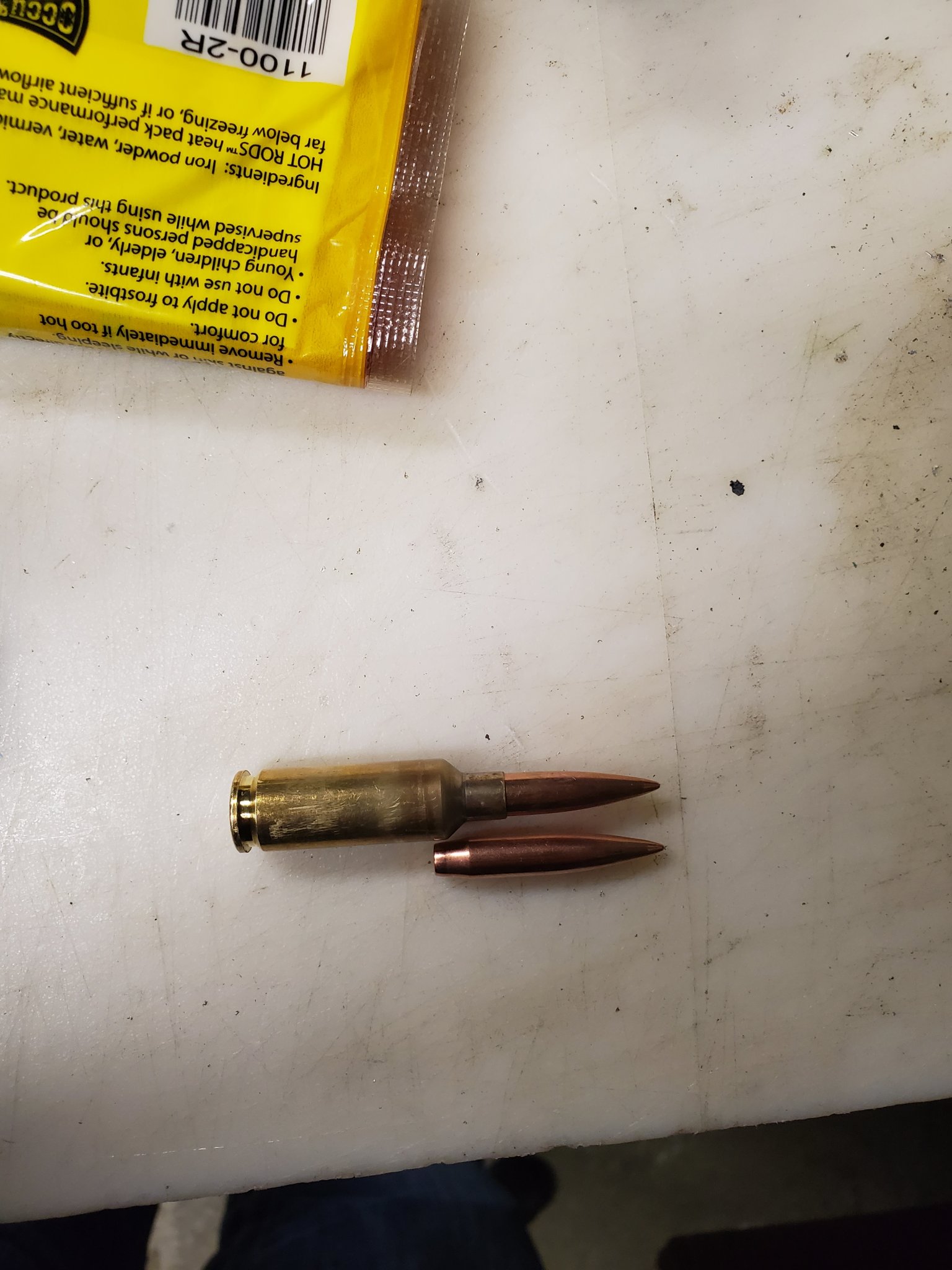

So I'm border line crunching powder with 32.7 of Varget in Alpha Brass loaded to 1.743" to the O-Give which is 0.030 off the lands.
Edit:. This is for 105 Hybrids in a 0.120" free bore chamber.
We'll see how it goes at testing but will probably have to shoot for a lower node.
Seat the bullet farther out. Is this the ocw?
If this is virgin brass I'd blow it out to your chamber before I'd freak out also. I'd say you could lower the charge .1 or .2 and still be in the node.
If not CRUNCH IT.
