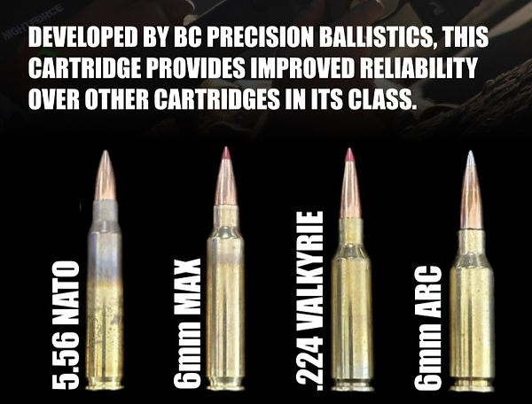

So he said that he and other competitors have experienced the following problems with 6mm ARC:
* Seized gas tubes from carbon fouling
* Broken extractors
* Cracked or sheared bolt lugs
* Feeding issues

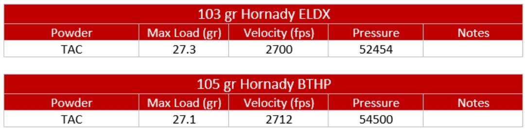

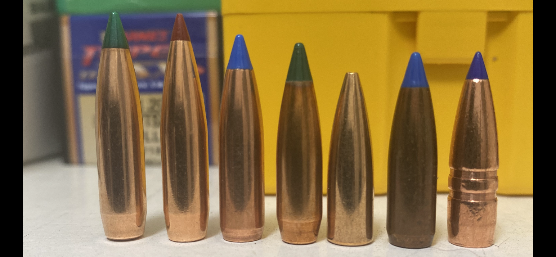

I actually worked up a .257 based on the .224Valkyrie case that produces 2600fps from 110gr ELD-x & 110gr GameChangers , 2800+ fps with 100gr Nosler BT & Partitions and 2900+fps with Speer 87gr TNTs & HotCores and Sierra’s 90gr Bltitzking projectiles… this is the most consistent cartridge that I’ve ever worked with by providing single digit SDs across a large range of powders… all data was derived from three 20” X-Caliber barrels. JGS made the reamer with an elongated throat. .250 GLX (Goldilox) …. The word compromise is something that most shooters don’t want to hear but the fact is we’re adapting a cartridge to an old platform…. Very much improved platform but “OLD” nevertheless. Goldilox = BEST Compromise!!!

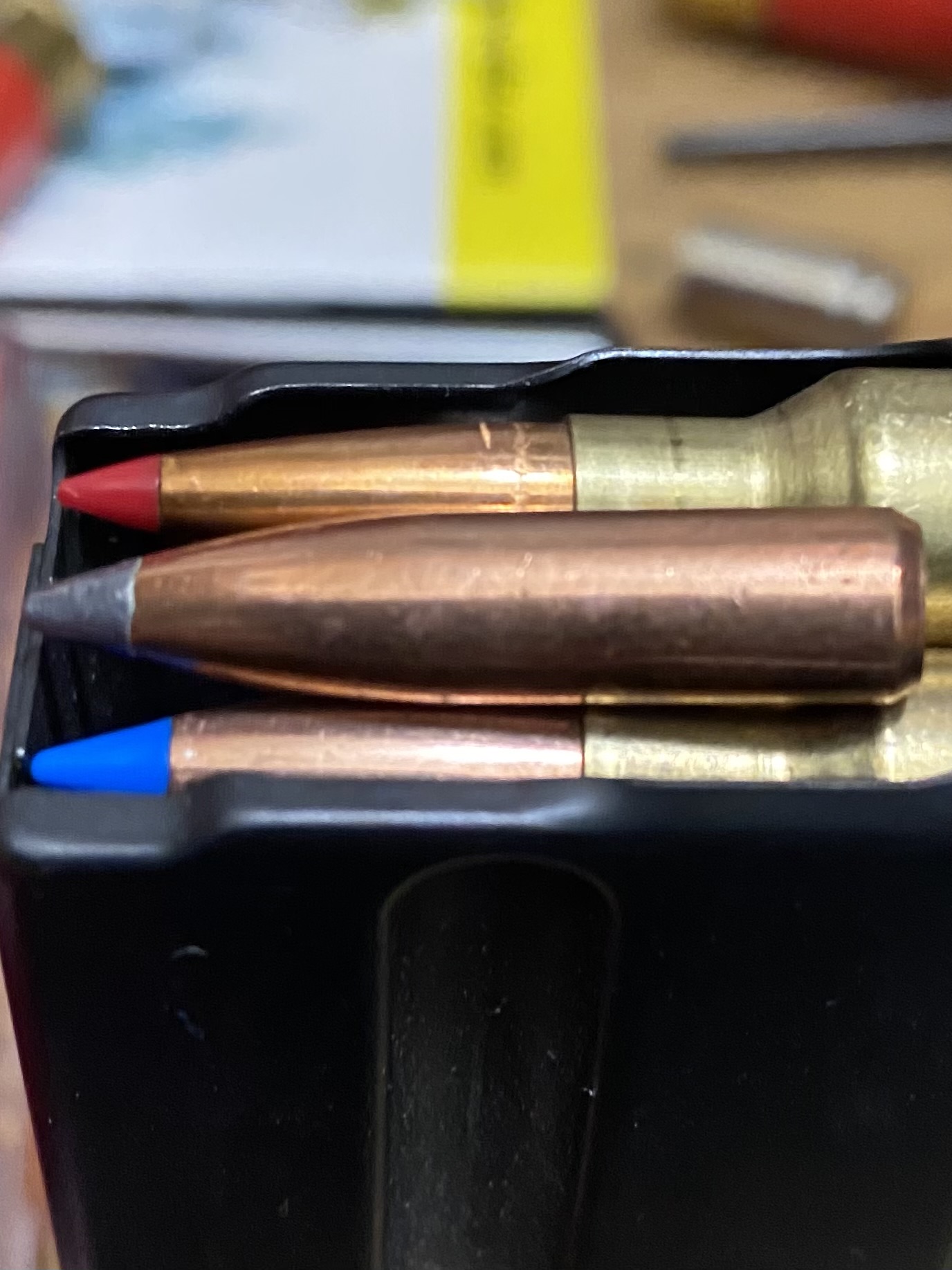

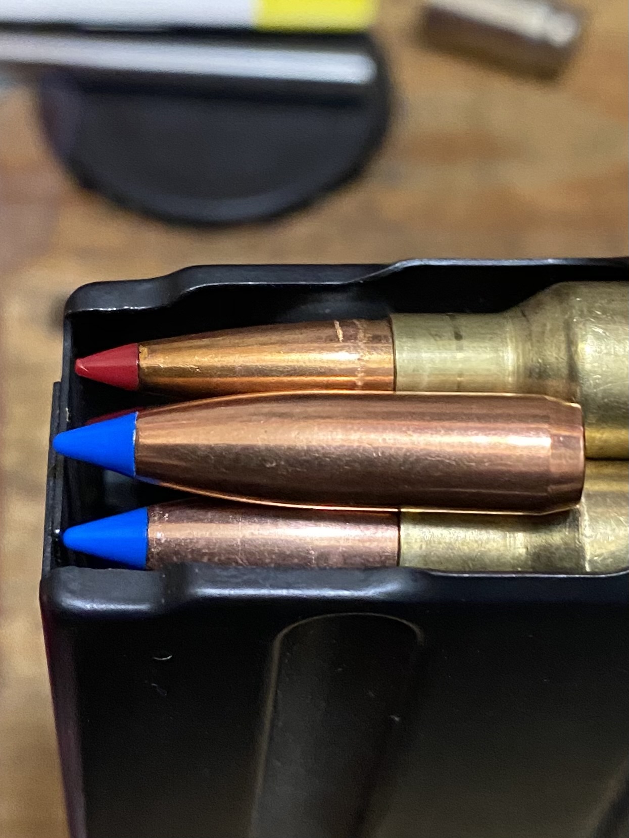

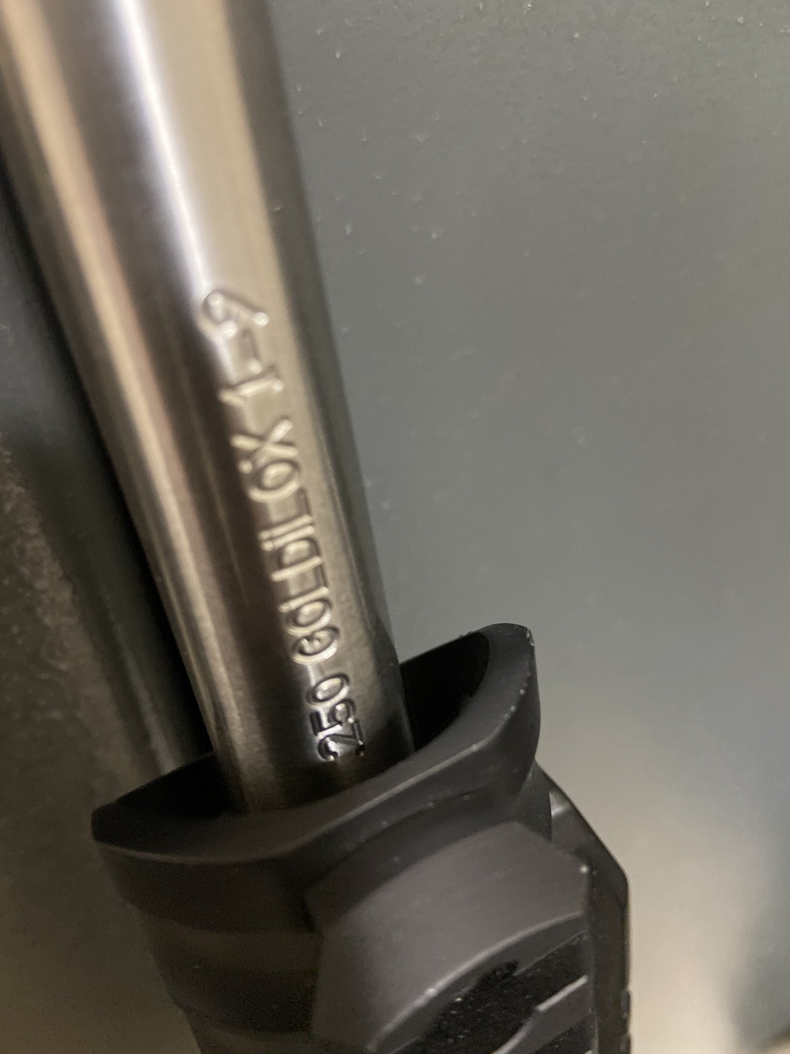

From initial 6 ARC impressions I got from people, the early (maybe still?) Hornady factory loads were really dirty. That could easily explain clogged gas systems.
It also seems like 6 ARC prefers longer gas systems, but many barrel manufacturers are treating them like 5.56. Some like Wilson even using mid-length for an 18” 6 ARC barrel. Though apparently they’ve upped it to an intermediate length, but they still seems short.
Perhaps the extra force on the BCG with the short-for-cartridge gas systems is causing premature bolt wear (in addition to the bolt lug issues possible with this case head diameter when not using good quality bolts.
Sadly this was the same issue with the .224 Valkyrie…. I hope that they will not make the same mistake with the .22ARC because it uses powders in the 4350 burn range…. Slower burn rate on a small bore diameter barrel absolutely will affect your dwell time in comparison with powders used for 5.56 platforms … I still believe that the industry doesn’t understand how the AR15 works….

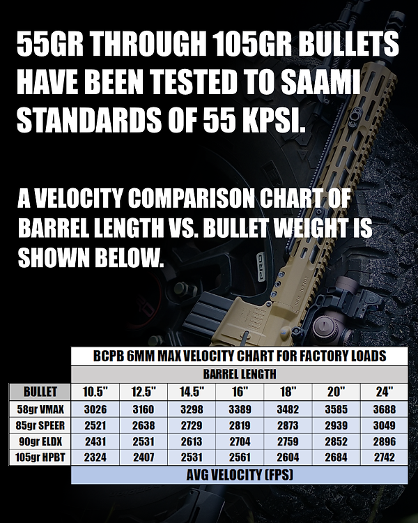

I don't have the gas system specs but he mentions at the end of the video that for this cartridge there is nothing special that needs to be done for reliability it's just like a normal AR. Then he shoots some full auto
Still only beats 6x45 20 In barrel by 100fps withb24 in barrel don't see the purpose

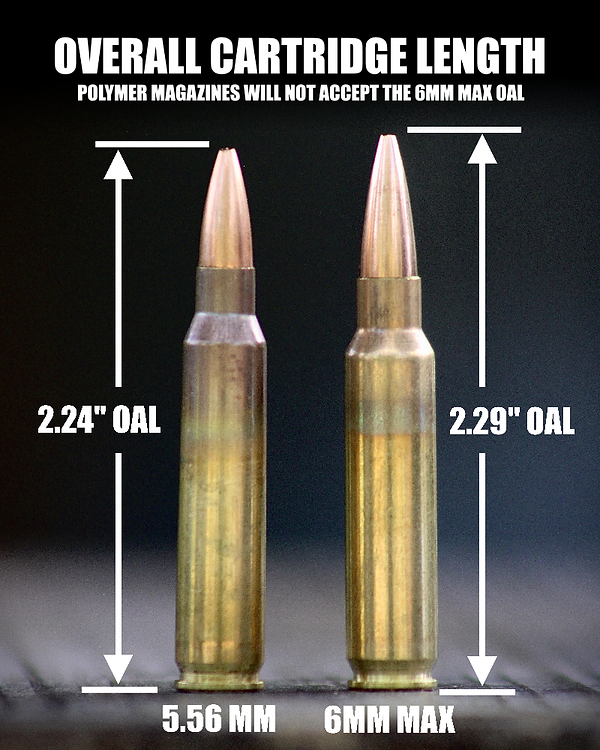

My immediate thought on this 6MAX is why the neck is so long?
Trim that neck down by a 1/3 or more, seat the projectile .05” lower and now it fits standard polymer 5.56 mags.
Or am I missing something?

Likely creates case capacity issues with larger bullets. That's my guess.
Would .05” really affect the fps that much? I’m guessing 50fps at most.
And please, this is an honest question. In no way trying to be a jackass or argue. I’m genuinely trying to learn before I experiment and accidentally blow off some digits 🤣🤣🤣

Yeah no worries! It could absolutely affect things, especially with a hot or compressed load. It's not about the fps but the case pressure which can change drastically with seating depth. I've experienced this first hand where just a few thousandths can lead to pressure signs. And part of it is you WANT a longer COAL and less of a jump to the lands. There's also neck tension which is influenced by neck length to a certain degree.

So what mags are available to run a 2.29" OAL round in an off the shelf lower? Seems like if you don't have that available to you then you're stuck using lighter/lower BC projectiles and/or running the heavies slower due to the lost case capacity, thereby giving up any benefits.
ETA: It's stated in the article, duh, haha
However, to gain additional performance in 6mm MAX, the designers chose to use the already-available .350 Legend magazine design, which provides for a slightly longer 2.30" COAL and uses follower and feed-lip geometry already designed for the case body.
Can anyone with 350L AR mags confirm this OAL is doable?

I might have a Wilson Combat modified 350L Lancer mag. If so I'll get some measurements for viability. I could/can get 18rnds of 350L in those mags too.
