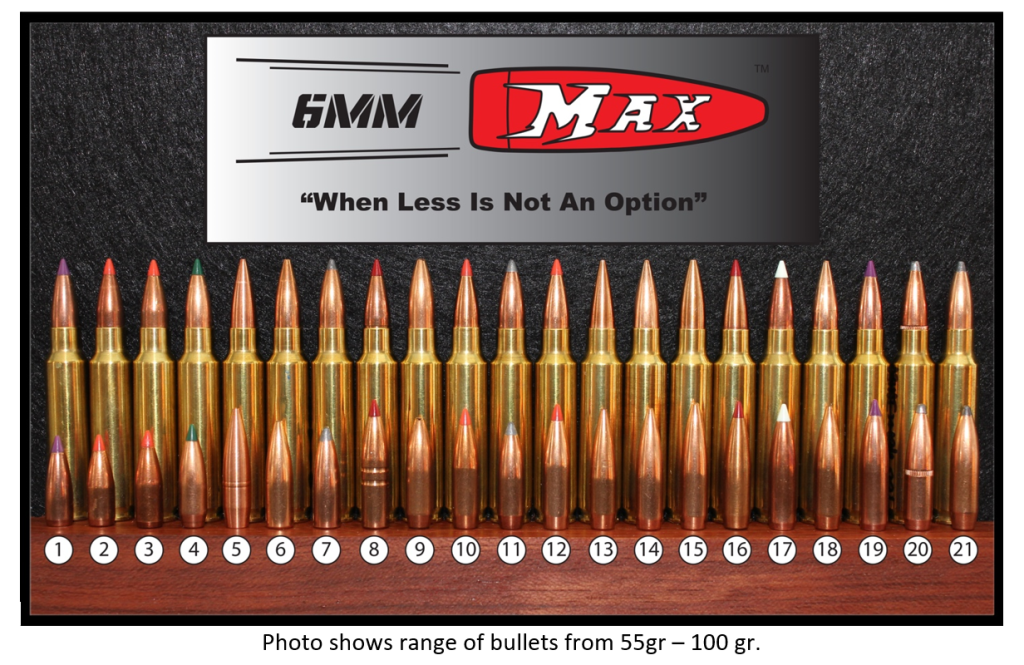

Test Barrel: Bartlein 24” Twist: 1/8 Tested to SAMMI Standards in Socorro, NM at EMRTC.
#21 - 100gr Sierra SBT BC listed as .496. Sierra site lists .419 for that velocity bracket. I checked manufacturer listed BCs of other bullets on this table and they seem on par, except #21. Must be an error. Also, running some of these bullets on 4DOF app (With the right BCs) I'm finding approx 1.8-2 mil less drop at 900yds than the 77SMK 5.56.
I noticed the same.

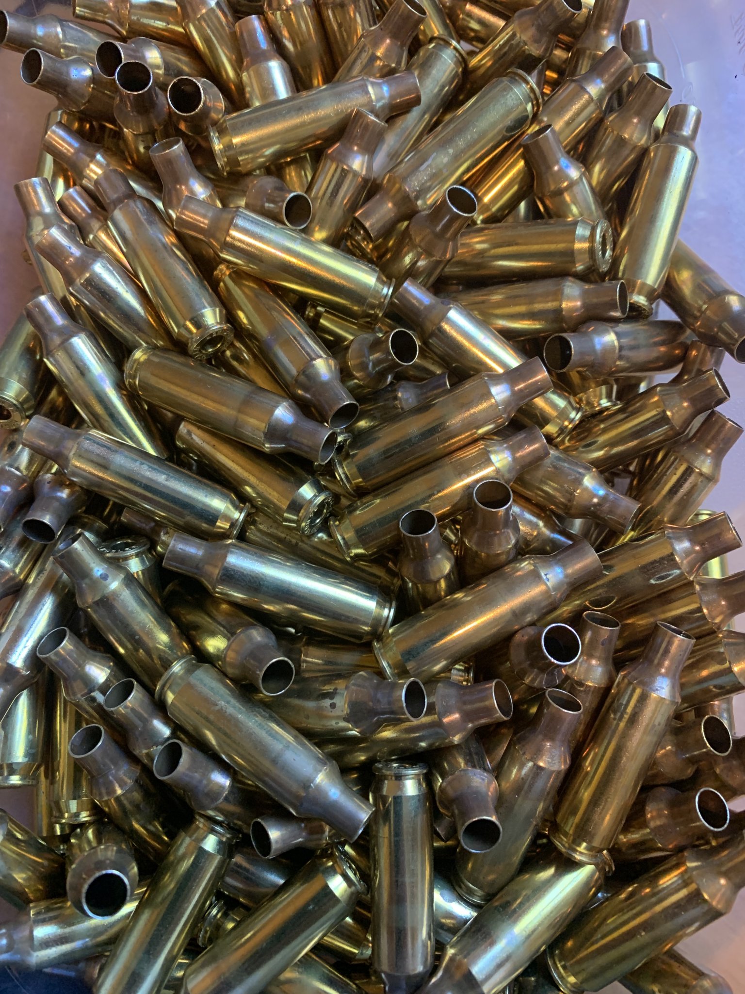

This is 24 Nosler formed to 224 Valkyrie, running 5.56 bolt. Has 32.7 h20 once fire formed using 69RMR's
Wildcat I'm working on now uses 400 Legend brass, .422 bolt/ .441 body. 224 for 77-90 gr with 37.3 h20 case cap. Winter project.
I bet Nosler brass holds up better than Federal.
Good to know on rebated performance. Bolt thrust will be what it is regardless of the head diameter, but smaller case heads of course allow for more lug root material.
That 400 Legend will be nice to wildcat off of since there isn’t a neck process done to the brass yet, and its body is slightly larger than 6.8 SPC, though it has the .422” head. 400 Legend is .422/.440 whereas 6.8 SPC is .422/.421.

I was one of the first to get on the 6x47L bandwagon. Earlier today when I was cleaning the garage I saw one of my ladder test targets at 320Y using Berger hybrid 105gr which has three shots touching. I do ladders in .1 grain increments so the difference between them is .3 grain for all three shots!
Still have the brass with tight primer pockets and some have over 25 firings on them.
