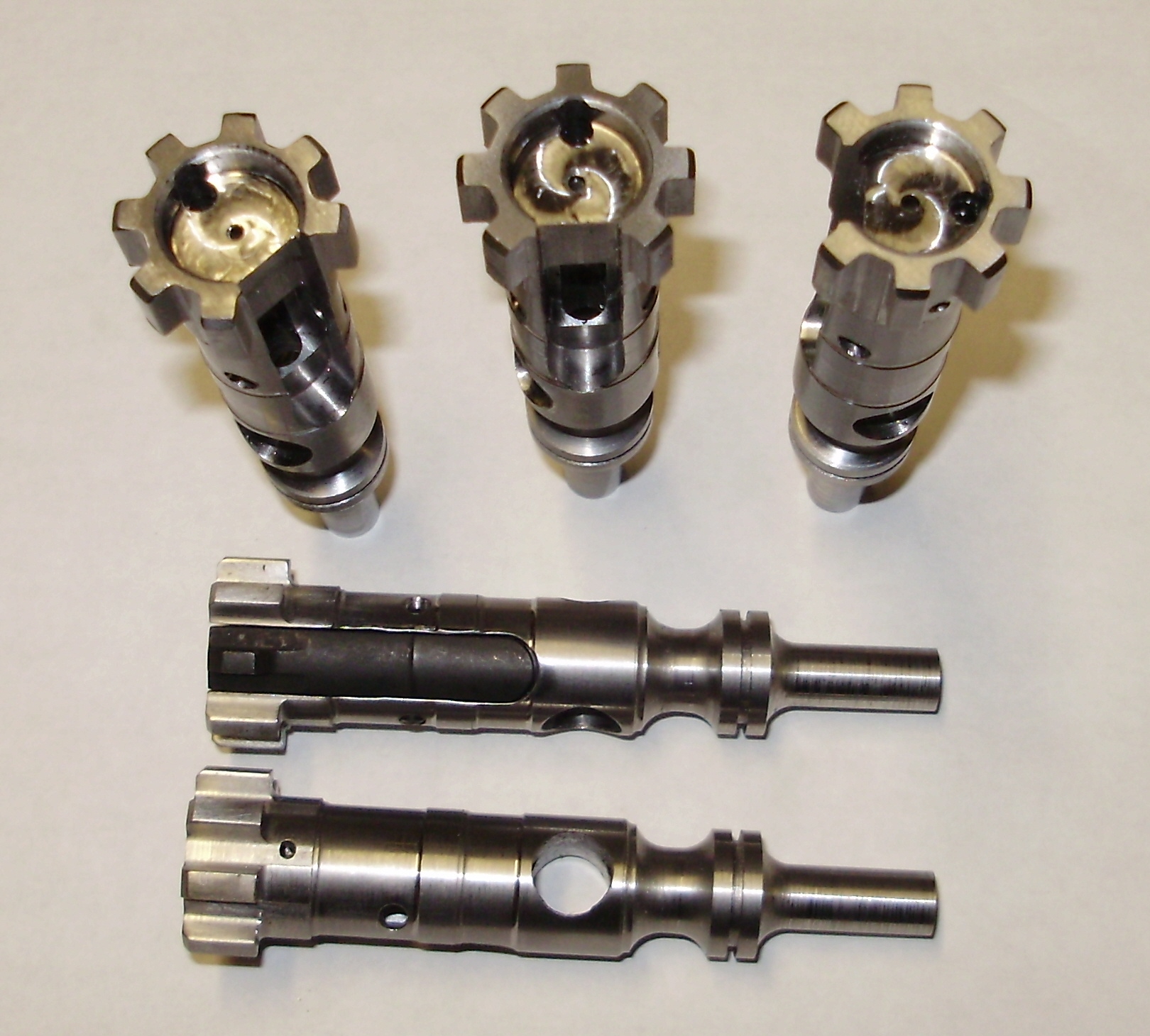

Not really. To figure the strength of a bolt you multiply the width of the lugs by the length behind the recess of the bolt face (x). Then draw an angle from the recess at each side of the lug to the top middle front of the bolt between the lugs. Measure the thickness of the web between the lugs and multiply that by the length of the 2 angles(Y). add X and Y together and multiply the yield strength of the material (apx 160,000 psi) for 158 and 9310. Then multiply that by 7 for the number of lugs.
Then to figure the trust of the cartridge figure the area in the diameter of the rim and multiply that by the PSI at maximum pressure.
The Grendel has much more area so the thrust will be much higher. That and the fact the web is thinner between the lugs makes the Grendel bolts much weaker than a 5.56 bolt.
In the firearm industry there should be a 2:1 safety factor engineered into every part. Meaning it should be twice as strong as the maximum pressure used. The Grendel and 7.62x39 barely have a 1:1 ratio.

The dimensions of the bolt are critical, but only part of the equation here. You've got the bolt's strength, hardness, and the force being placed on the bolt.
The 5.56 NATO is a max 60ksi round, while the SAAMI Spec Grendel is a max 52ksi round. This results in a significant difference in your force on the bolt.
Your assumption of a FoS (Factor of Safety) of 2 for the 5.56 bolts is incorrect. The 5.56 NATO like the Grendel, 458 SOCOM, BEOWOLF, etc... were developed for a platform that wasn't initially designed for such higher powered rounds. The AR15 was initially designed for a .22 caliber round operating at roughly 50ksi. But I digress....
The bolts for all of these rounds achieve a FoS of 1, which has proven to be sufficient when supplemented with properly selected high quality materials and proper manufacturing processes.
9310 and Carpenter steel are both high quality, strong materials that are made stronger through heat treating. (see increasing yield strength) However, the metals can be heat treated to a increased strength where they become hard and brittle. This will make the material more susceptible to stress fractures from the impact of the rounds thrust. Stress fractures are your bolts worse nightmare. A small stress fracture will spread at an exponential rate. The 90 degree edges of the bolt lugs make the lugs the most susceptible area of the bolt. As you understand this, you begin to understand heat treating to be the art that it is.
Now let's look at the Grendel(actually originally the Beowolf) Bolt again from a true overall viewpoint. The Grendel was always intended for the AR15 platform, thus all the factors we've discussed above were balanced to fit within the parameters of the AR15. When you understand all of this you begin to understand the fine engineering job that is the final Grendel Bolt.
The Grendel Bolt design was proofed at 60+ksi. Per the design the Grendel can be fired at the pressures of the 5.56 NATO, as some people do. This is where you've seen bolts break as the Grendel Bolt won't sustain continuous operations at 55+ksi. Eventually material fatigue sets in and you get stress fractures.

I know very well the difference in yield strength and tensile(ultimate) strength. I'm assuming your a Mechanical Engineer Undergrad Student or another discipline of Engineer. You clearly understand the basics of materials and statics, but lack an understanding of design.
Actually you can make it stronger(raise the strength of the material) if you heat treat it for an extended of time. However, when you do this the material becomes to hard and ductile. When a material becomes ductile, its yield strength becomes its ultimate strength, as it will not longer yield before break, it just breaks when you exceed the material's yield/ultimate strength.
You can not make a material weaker through heat treating, you can fail to heat treat the material enough to reach the optimal strength. You can get away with not quite heat treating the bolt enough. However, over heat treating a bolt has proven to be catastrophic.
Your initial assumption is incorrect. The 7.62x39 bolt isn't any different than a 5.56 bolt except more material has been removed. The Grendel(Beowolf) bolt is different from the 5.56 bolt in other critical dimensions as part of designing to make the bolt stronger.

The only way to increase strength is by not removing as much material from the finished product. Show me where the Grendel bolt has more material than a AR15 5.56 bolt.
I'm not a engineering student, I machine AR15 bolts all day, every day and I did modify the bolt design to make them stronger. A guy called not 10 minutes ago looking for bolts because he and his brother broke bolts in the last 2 months.

...I'm not a engineering student, I machine AR15 bolts all day, every day and I did modify the bolt design to make them stronger...
Well that's a scary thought.
And "I did modify the bolt design to make them stronger"?????
The only way to increase strength is by not removing as much material from the finished product. Show me where the Grendel bolt has more material than a AR15 5.56 bolt...

Look at the 2 photos posted above. You can clearly see there is no additional material around the lugs of the Grendel bolt. It looks just like the 7.62x39 and 5.56 bolts. Why? because they use the same broaching tool to cut the lugs. Same design, same square corners.
Anyone with a caliper can measure and compare the bolts in 5 minutes and understand nothing was changed in the design except that the Grendel bolts have a .135" deep recess removing more material. That does not make it stronger.
The way I posted to calculate strength is engineering 101...first year. Even though that was 30 years ago it's such a simple thing we don't forget. X x Y x Yield. There is no voodoo to make metal stronger than what Carpenter gives as MAX yield. The thing that could make bolts stronger is a radius at the root of the lugs, it adds attachment strength. Or the recess could be made shallower if the extractors would work and the chambers were cut to match for headspace.
Now look at these bolts. Notice the radius at the root of the lugs that is absent on the Grendel bolt. X on these bolts include 50% of the radius on each side increasing the strength 28% It increases the X and the thickness of the web at the same time.

I have broken bolts in 5.56 AR15's. I have never broken a bolt in a Grendel, and I've been shooting an AA Grendel barrel/bolt combo since 2009. Granted, I don't run my Grendel in tortuous high volume sessions training for 3-gun like I do 5.56's, but with the pressure constraints and metallurgy, I'm confident the Grendel bolt will hold up well. AA's QC is totally different than any other manufacturer I know of, to include regular destructive testing.
Yield strength bolts using 160,000 psi yield
Remington 700 308 bolt =32856 PSI
A mil spec 5.56 or 6.8 bolt=10805
Grendel with a .135 recess=9518
ARP 5.56 or 6.8 superbolt =12506
Thrust produced by cartridges
5.56=6337@58kpsi-
6.8=7692@55kpsi-
Grendel=7978@52kpsi-
