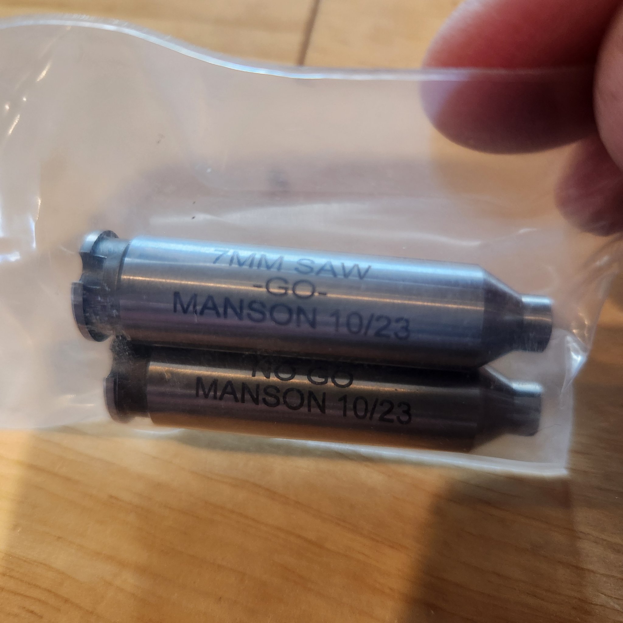

I now have a set of go no/go gauges if anyone needs to borrow them let me know!

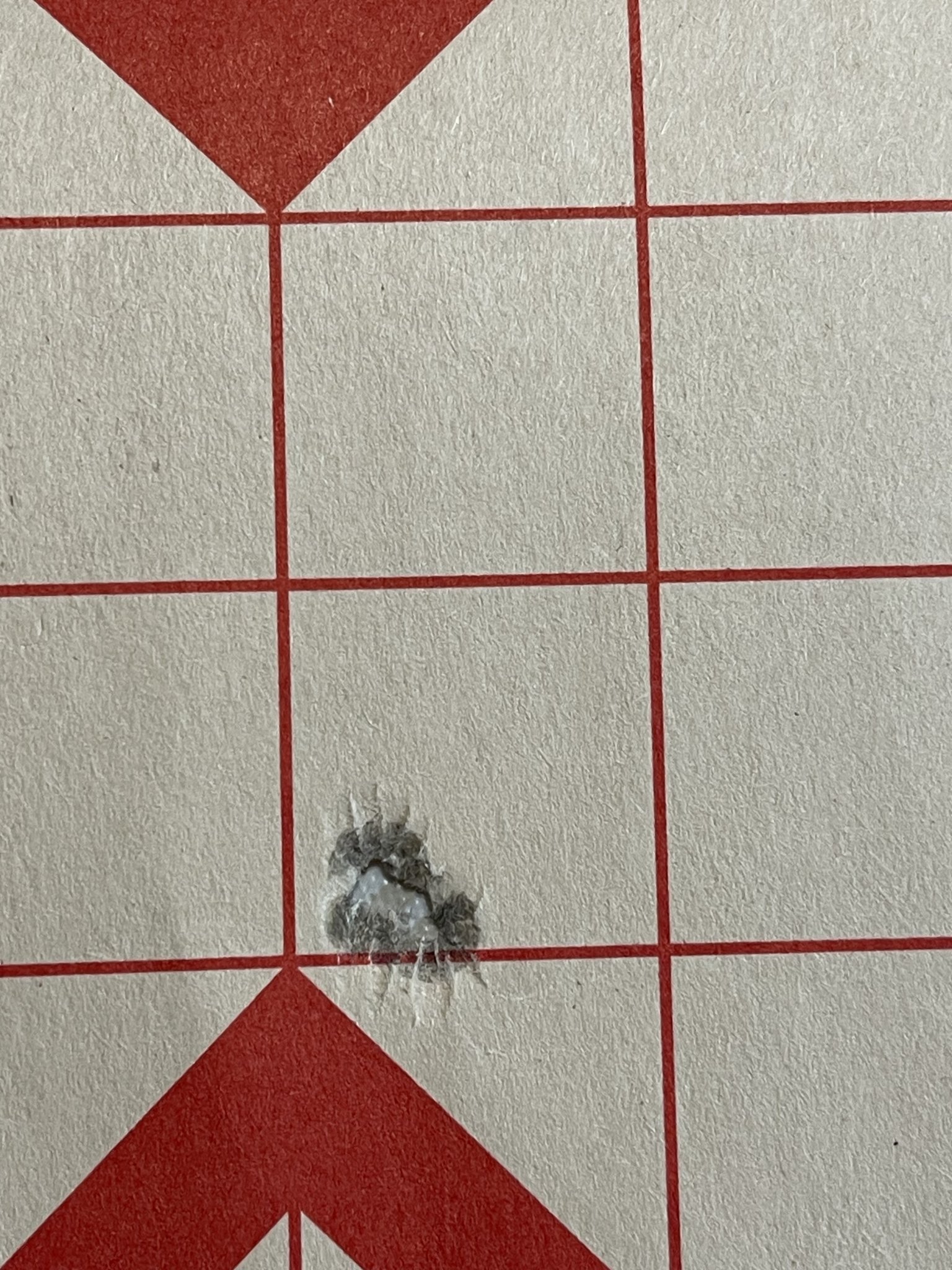

I got out this last weekend with some Hammer Bullets for the first time. I was shooting the 145 gr HHTs. So far I am really impressed. The most consistent bullet I think I've ever used, and definitely outperforms all other copper monolithics. I'm primarily interested in hunting, so I've been focused on bonded and monolithic bullets.
I started out with a really mild load at 39 grains of Varget and went up to 40. Think I'll test up to 41 grains this weekend.

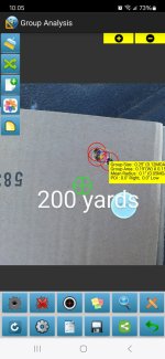

For groups, the best have been the Berger 168 gr CH and now Hammer 145 gr HHT. Everything but the Nosler 168 gr ABLR and Swift Scirocco shot at least 1.5" or better. Most shot 1" or better.
I like trying out lots of different stuff, so I have a couple of powders and primers that I switch around to see if I can get everything to shoot well.
Right out of the gate, without anything special, the Hammer's really work well. And you are right, at the bottom of my ladder at 39.0 grs, I had one bullet of the three set .1" deeper, as I was surprised how far back I had to set my seating stem. I didn't want to pull the bullet and start fresh as I was at the bottom of my powder charge and I was mostly interested in bullet speed & pressure. Still shot a clover leaf. So very jump insensitive.

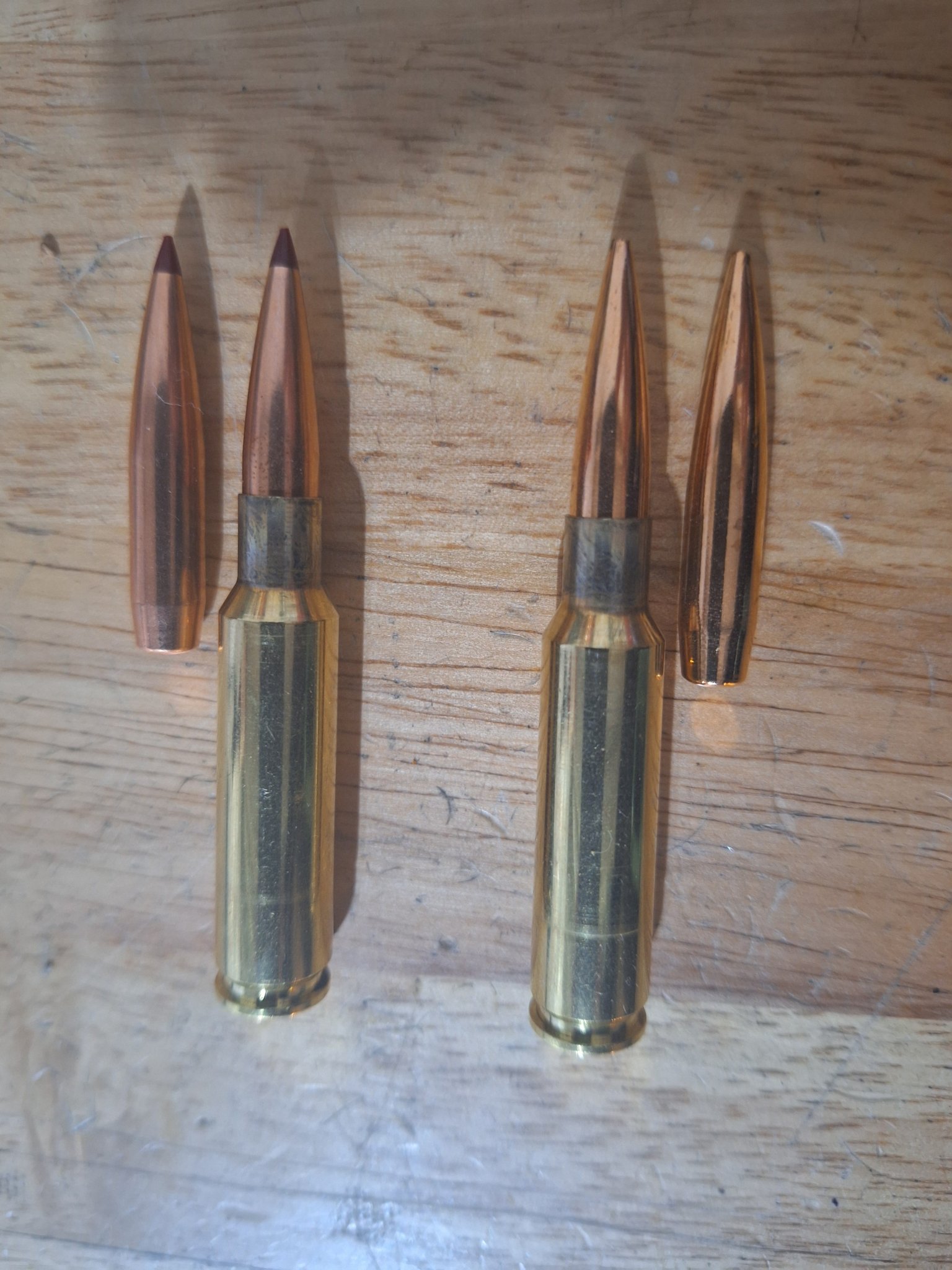

Anyone have photos of 168, 175, or 180 grain bergers next to the 7 SAW case - at max magazine length (2.96 ish) or seated at the lands? Trying to see how far back the bullet pressure ring is relative to the case neck. Thanks!
This is 180 ELD-M and 180 Hybrid both at 2.96xx
Not a great picture, but you get the idea

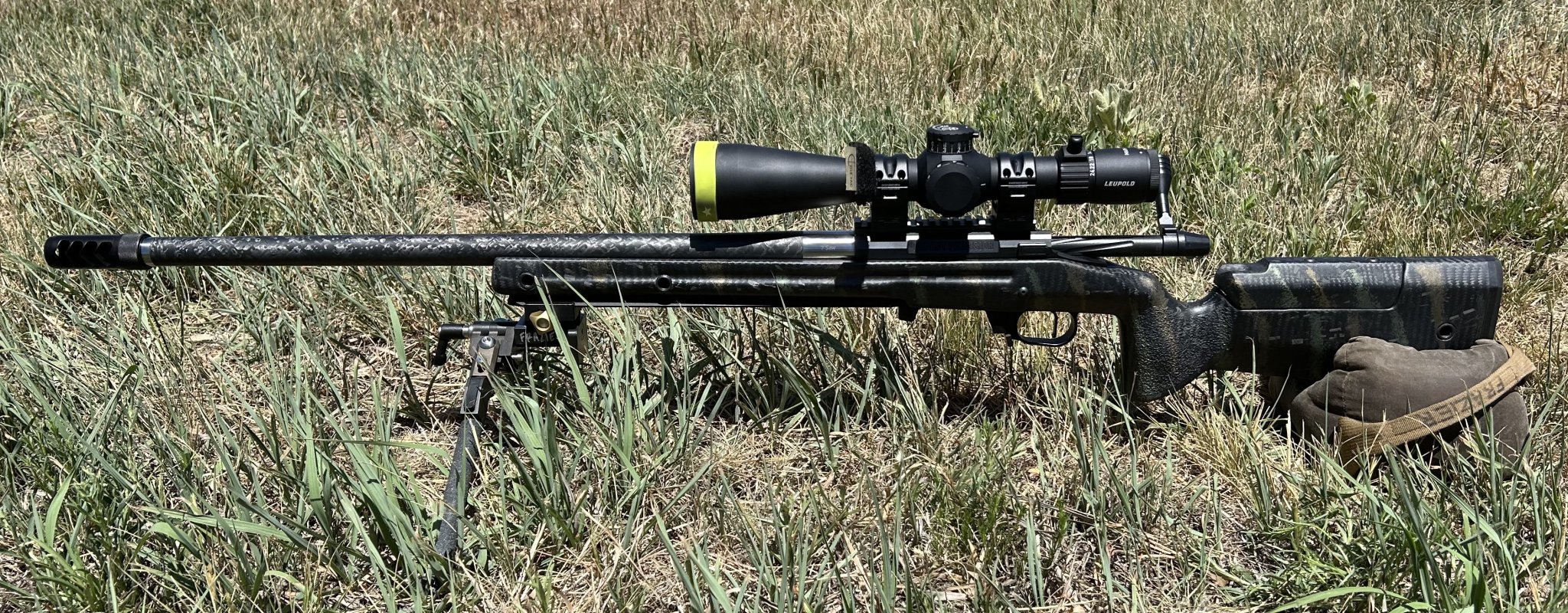

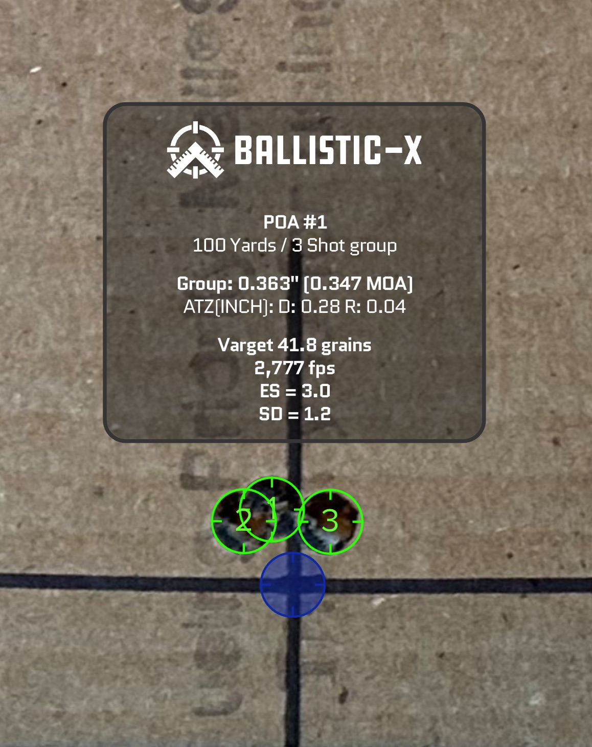

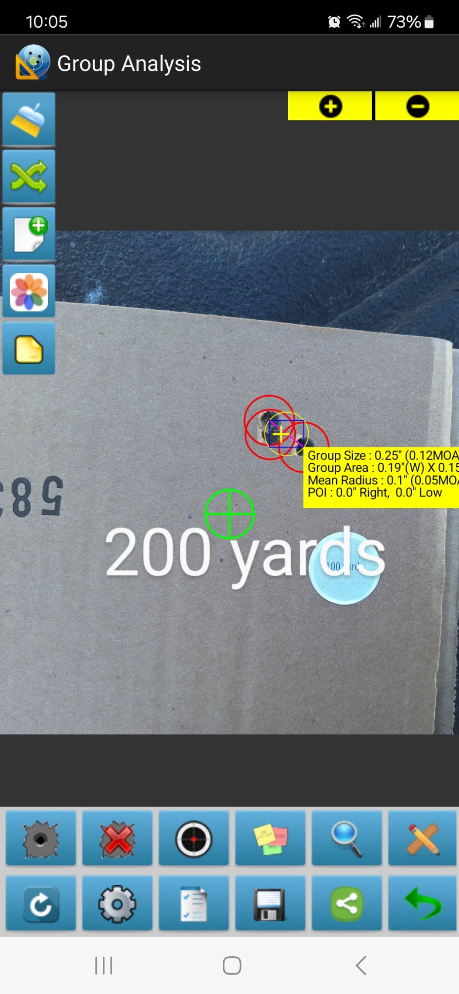

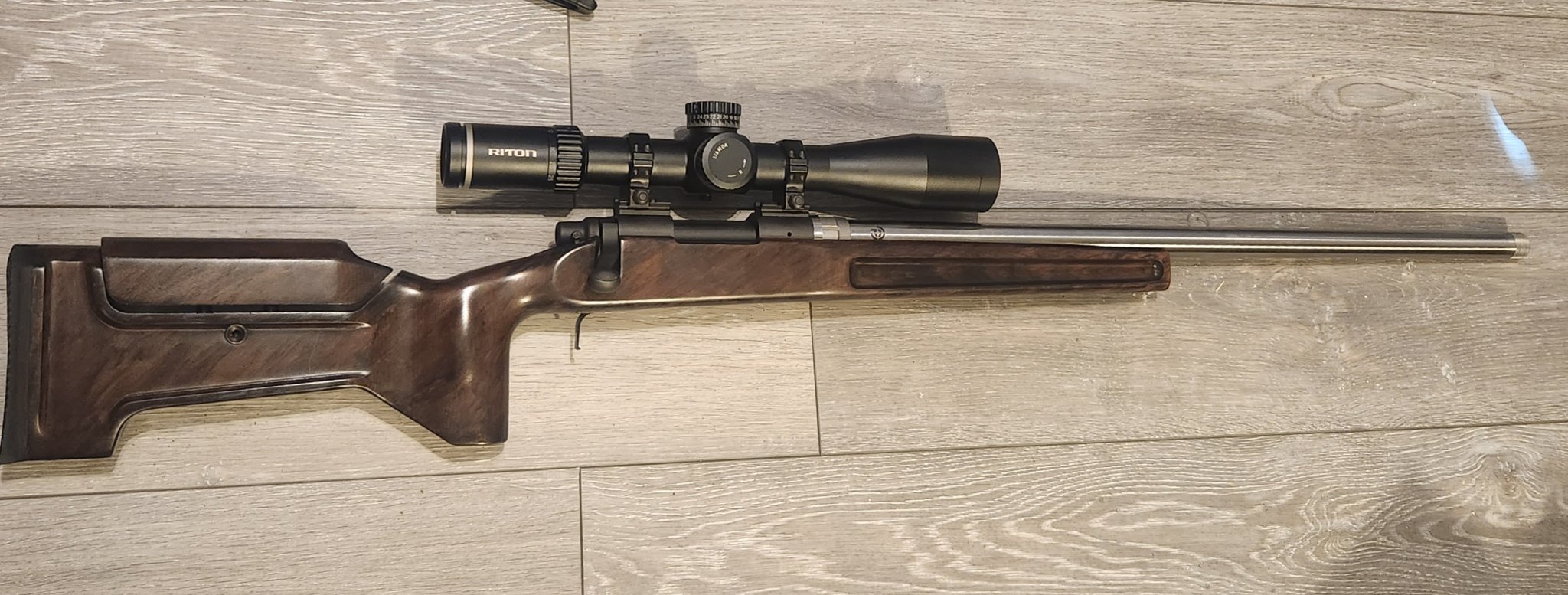

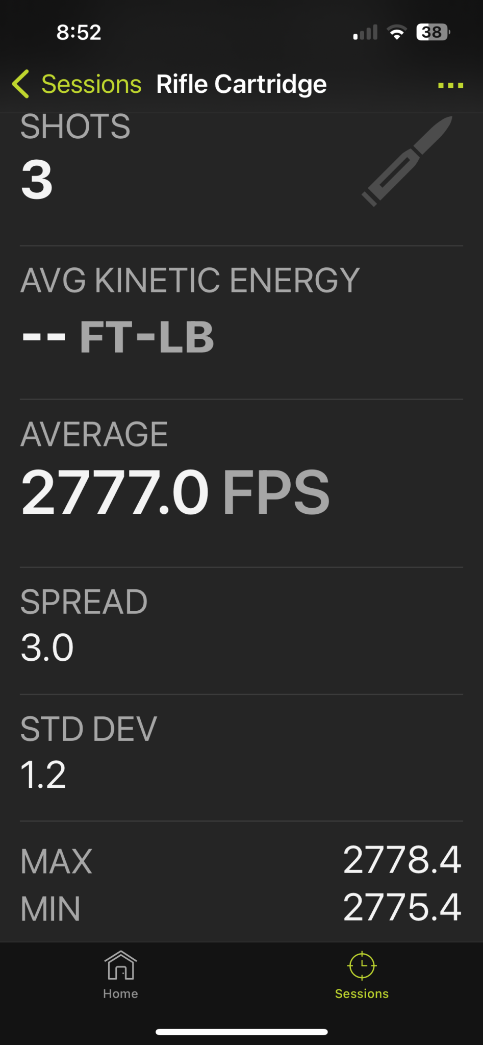

Got the Proof carbon barrel back from Preece Precision and didn't take long to find a good starting load. Alpha brass with 41.8 grains of Varget pushing a 162 grain ELD-M at 2,777 fps with an ES of 3.0 and SD of 1.2 with less than 50 rounds down the pipe. Once this barrel breaks in and speeds up it should be a shooter.
