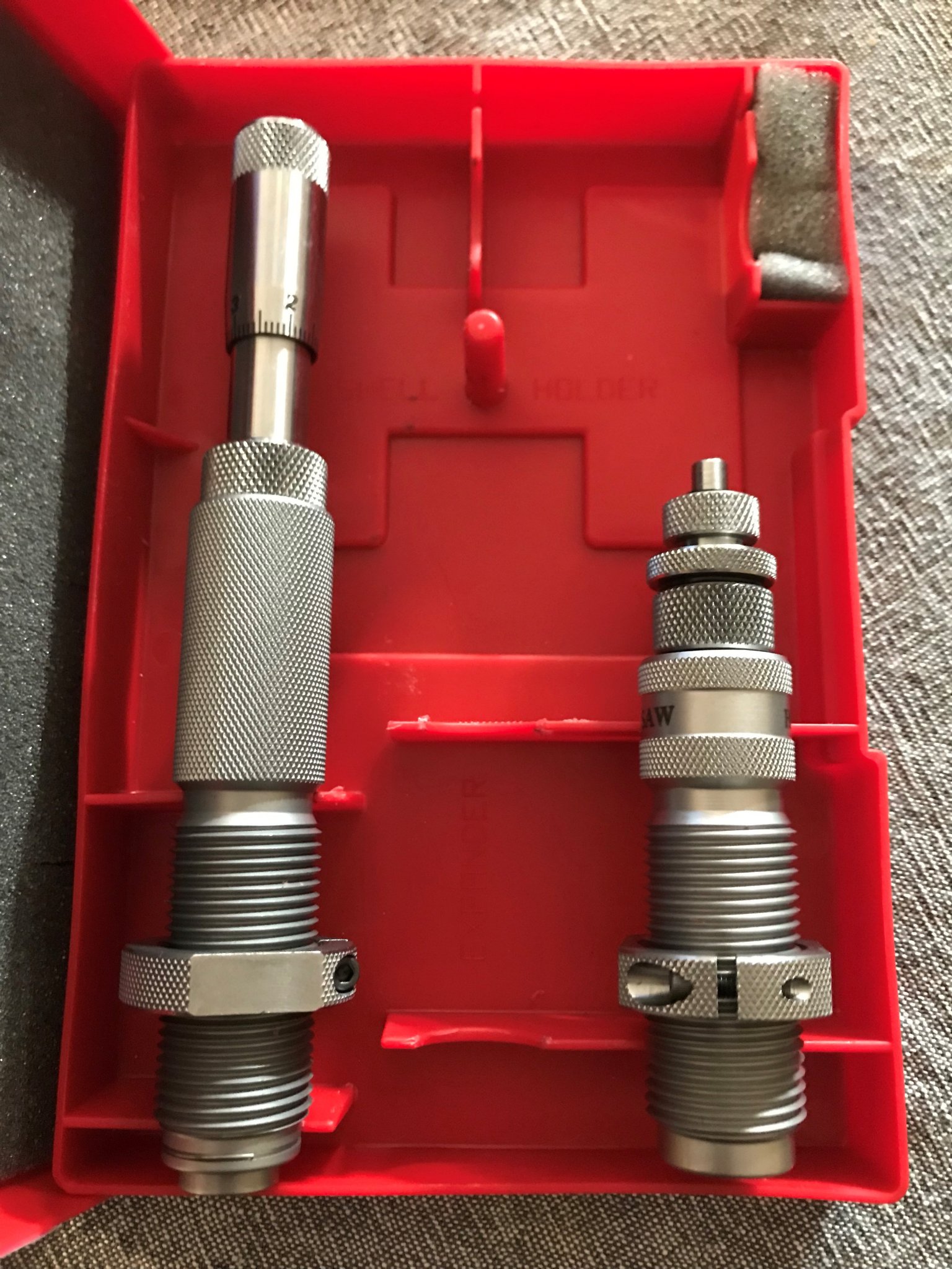

I prefer the hornady dies to the redding dies I have. Do the reddings you ordered have a micrometer seater?
These are the hornady dies. My redding dies didn't have the micrometer seater but I found the sizing was inconsistent, particularly with the necks. I may just have a shit set though.

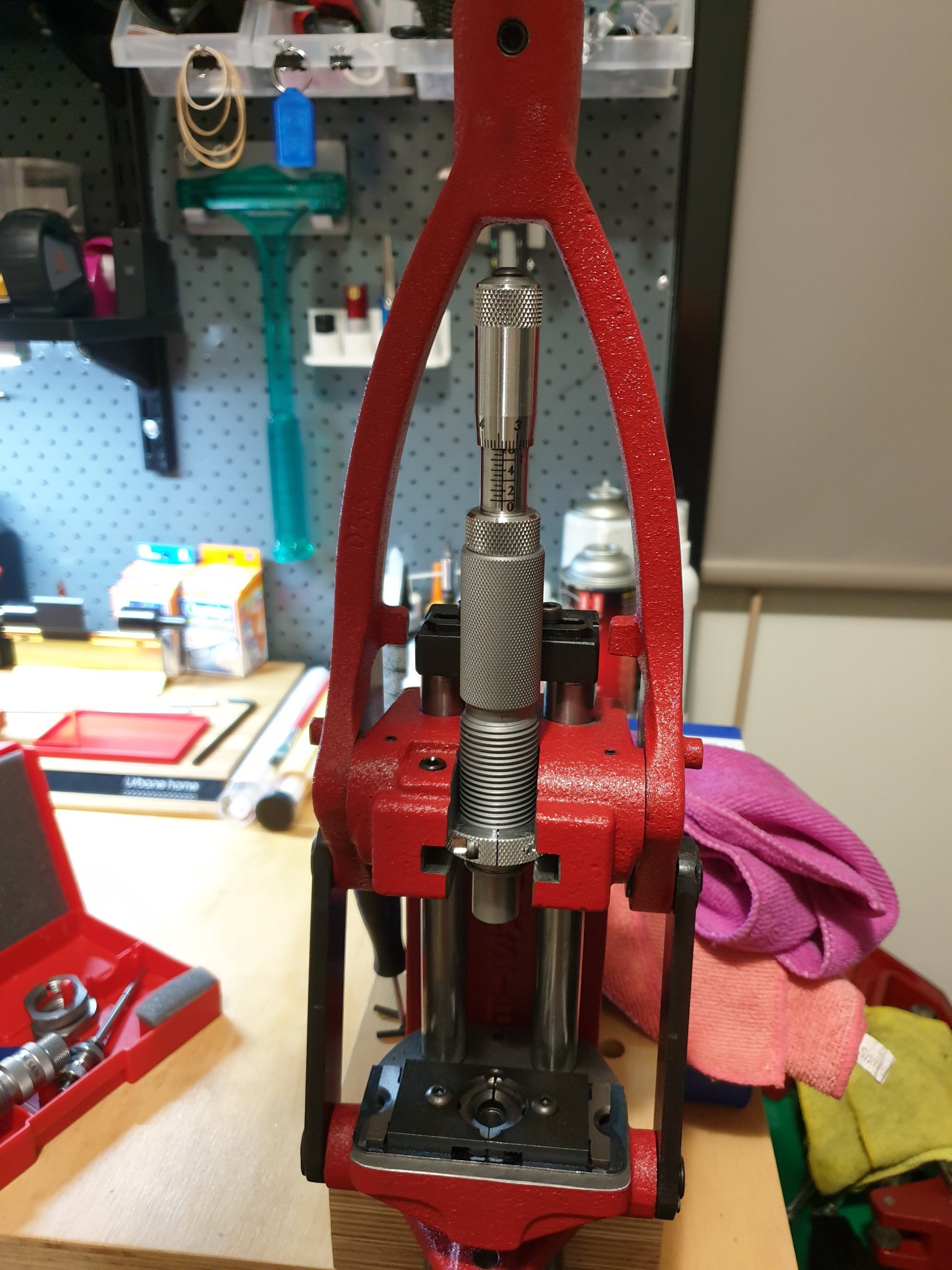

I'm using a COAX press , that's why I posed the question about 7/08 seating dies as the Hornady seater will not work with the yoke on my COAX , Redding makes a micrometer seater and I have them for a couple other cartridges but I find the Forester is much more repeatable and user friendly!. What are the opinions on the Whidden Dies in a COAX press?
Whidden in coax here. Just switched to coax recently dont actually know that I've seated any 7SAW yet
Hey mate,
What won't work exactly. Mine works? 7mmSaw Hornady Seater. I'm guessing older Coax presses have a smaller yoke or something do they?

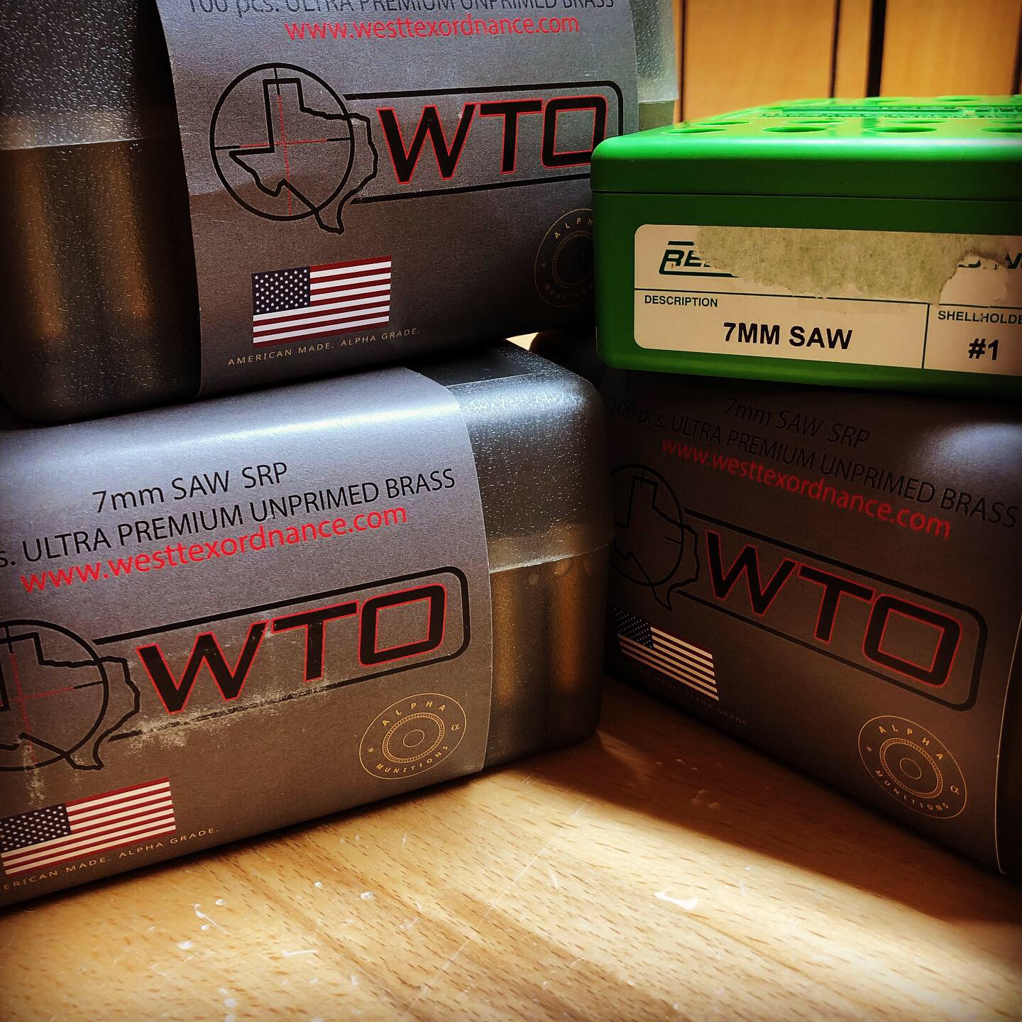

Got my dies and brass today!! Can’t wait to get this build done!! West Texas Ordnance is awesome!

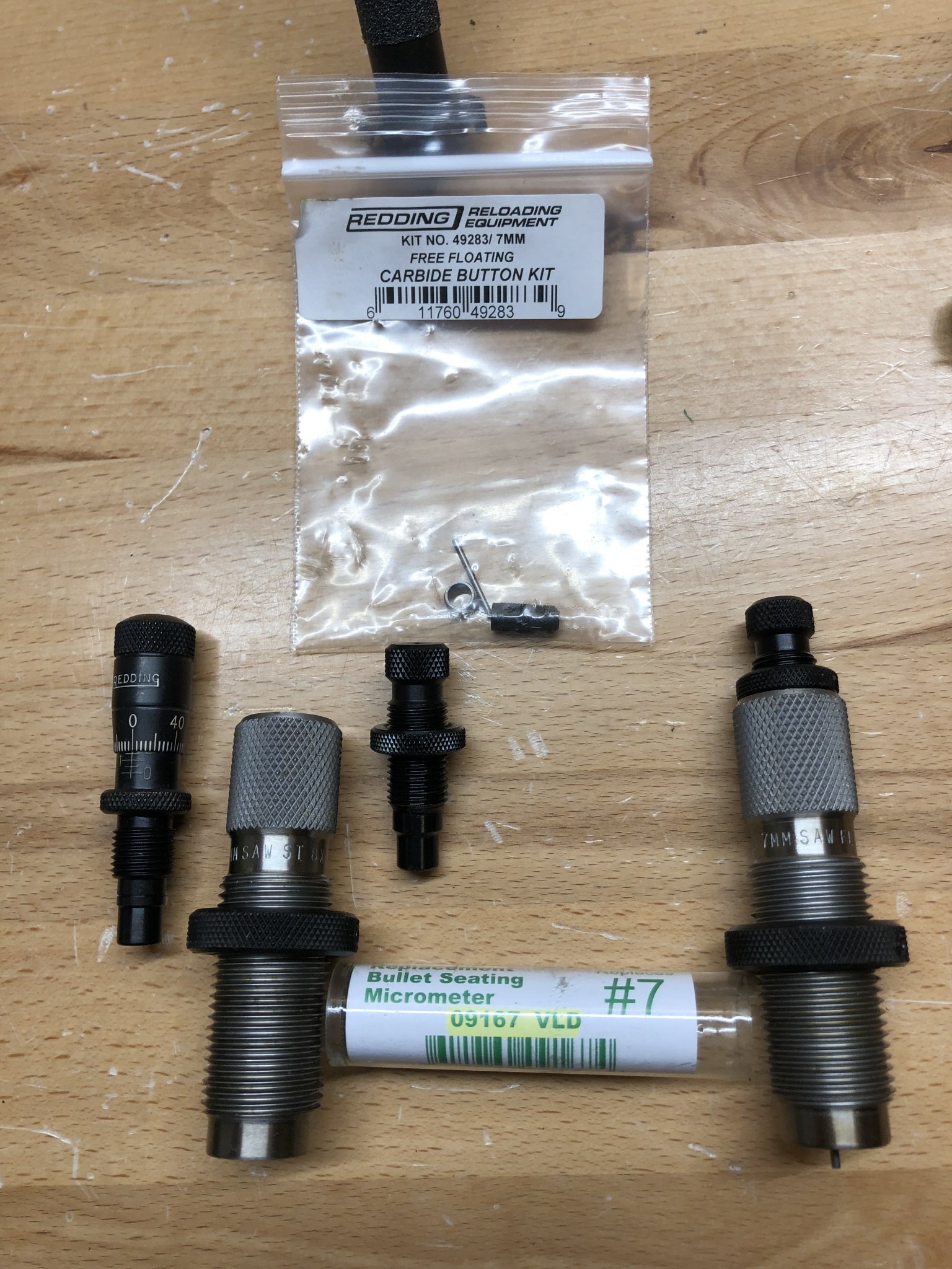

mustang, the brass looks nice, can you post some pics of the Redding Dies please!. I spoke to Clayton yesterday to let him know my Bartlein should ship next week and got a nice estimate for his brake and barrel install along with some reciever mods for the SAWII chambering. Clayton said all dies offered are very consistent with no noticeable run-out, only slight variences between them for case sizing dimensions. I'm leaning towards the Reddings since the VLD stem is included . When the rifle is completed I plan on the Berger 175 Hunter Elites as my first choice.
Reactions: mustang-cars
Here you go. The Redding comes with the standard seating stem and the VLD micrometer stem. No floating sleeve though. The sizing due comes with the standard expander ball and a free floating carbide ball. Extra pic of the brass just because:)

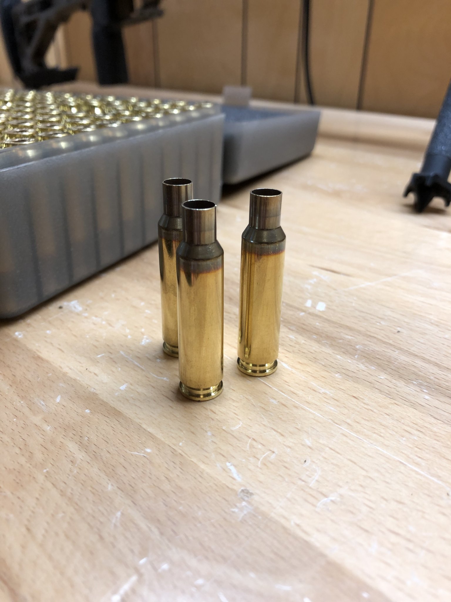

MAJOR 7SAW CHAMBER TROUBLE HERE
I built a saw with 2 barrels over summer and am using the holiday to finally break it in but I'm stuck.
Reamer from WTO to my Smith.
500 alpha brass from WTO
New neck is .312.
With bullet seated is.313.
I CAN'T EVEN GET NEW BRASS IN THE CHAMBER.
I forced one with a rubber hammer and it came out .310.
What is going on. I assumed Clayton's alpha brass and type 1 chamber was a no neck turn combination.
