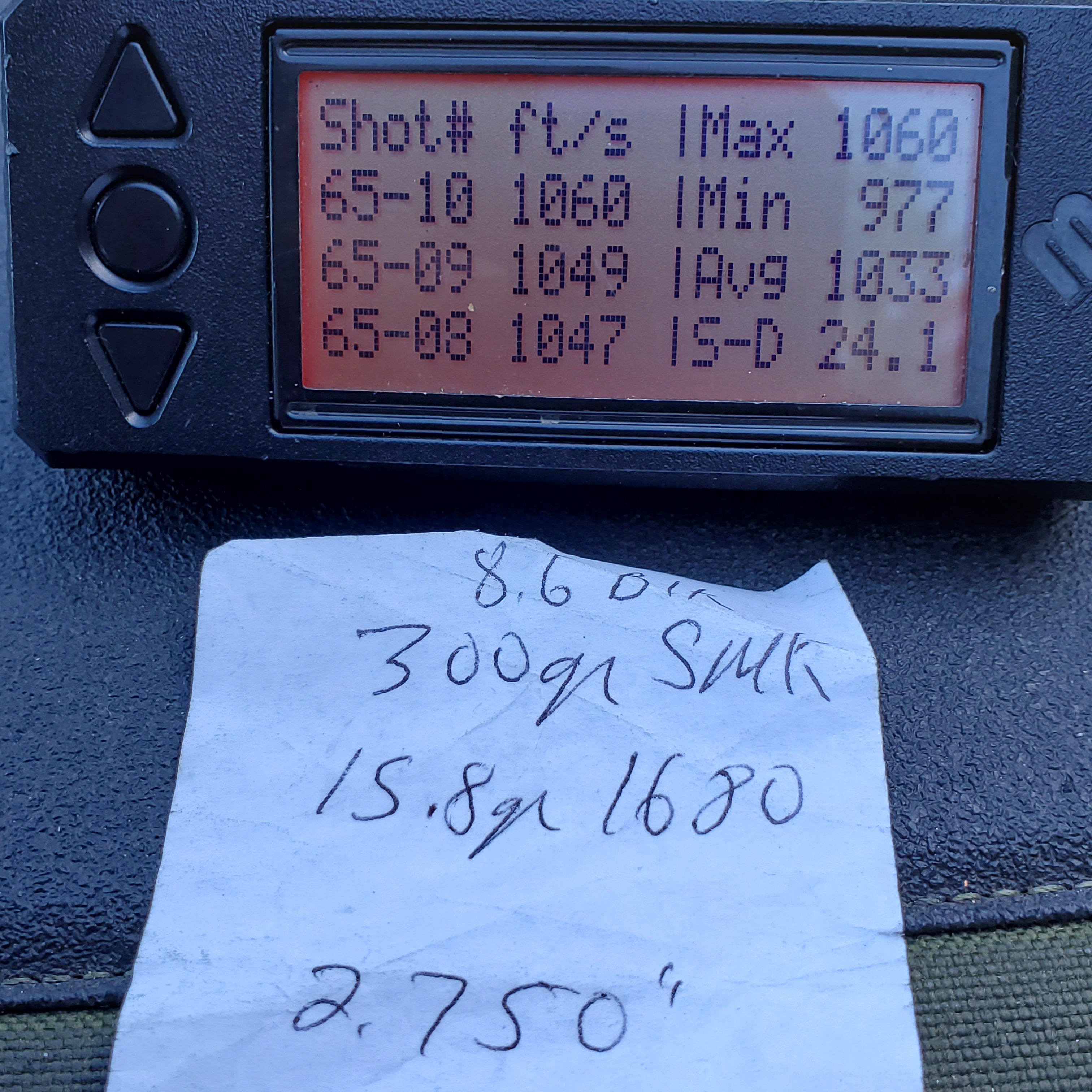

Depends on the twist rate. A 3 twist is limiting. My 3 twist could not take the same loads as my 6.5 twist with copper bullets...the 3 twist reached max with 2.5 grs Less powder with copper bullets...but it was a rough early Faxon 3 twist, also inaccurate.
I have not tried the 124 gr hammer in 8.6 blkout.
I use a bolt gun 6.5 twist with a 24" barrel, dropped the Faxon 8.6 blkout 3 twist is now a 375 Raptor with a 20" barrel.

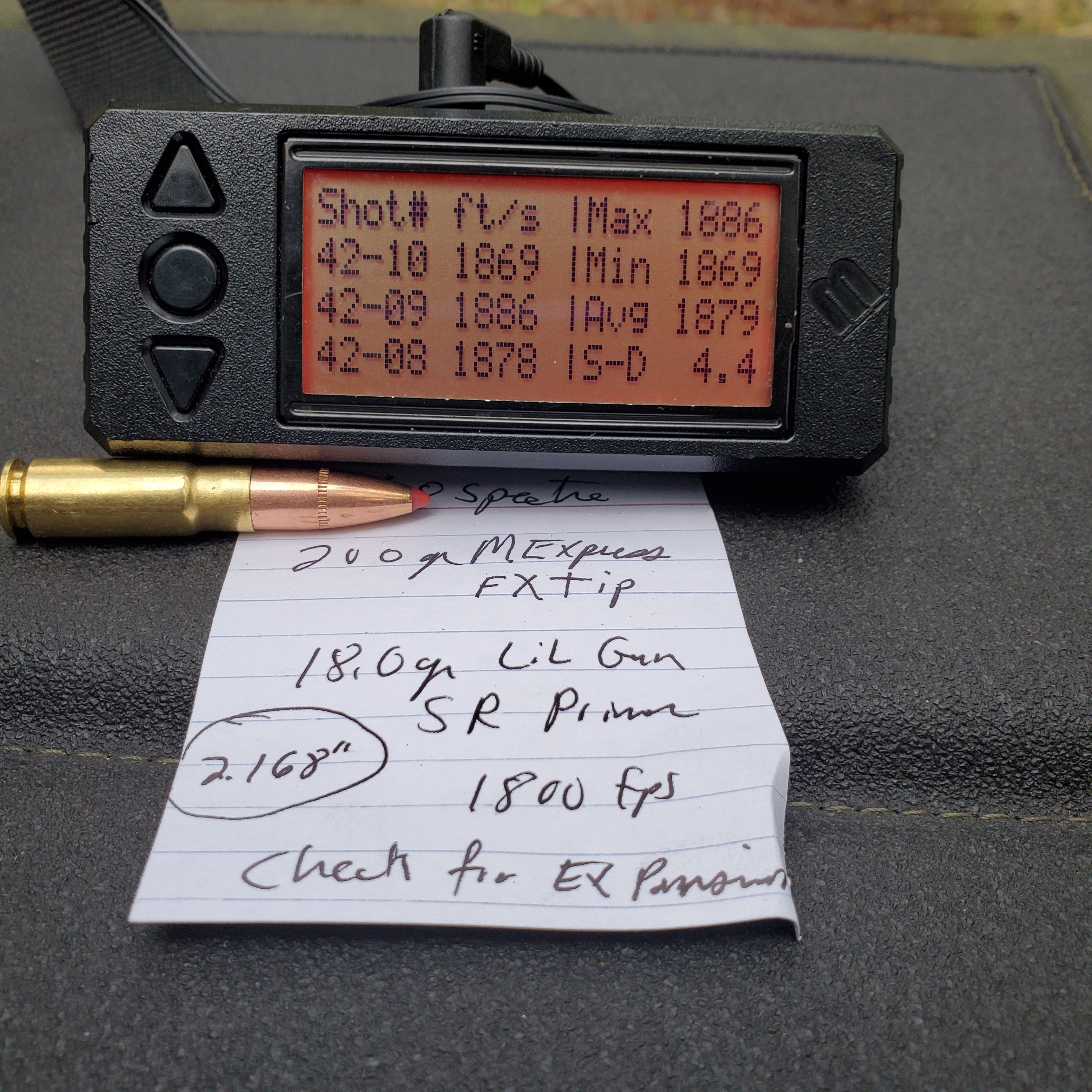

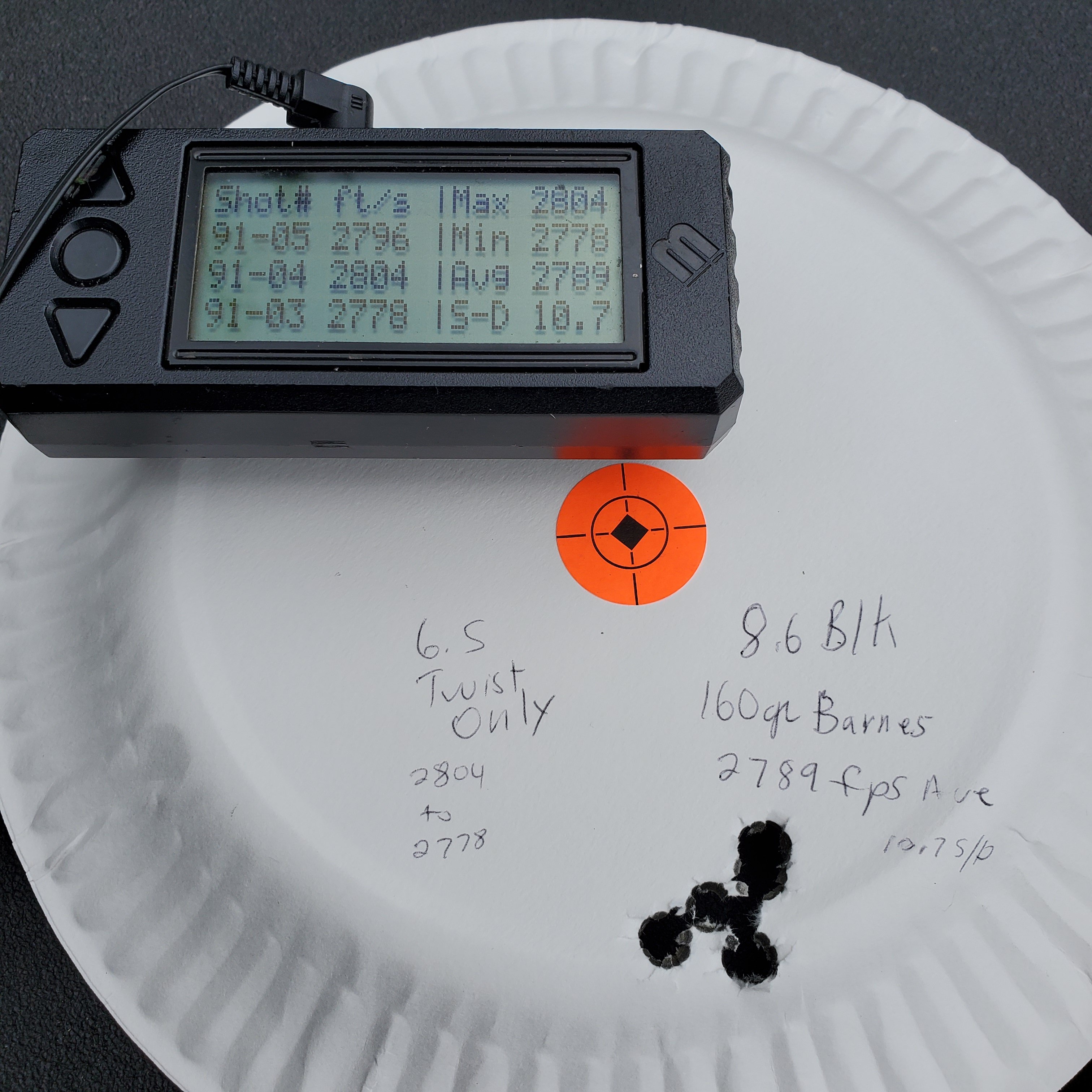

My 8.6 blkout with 6.5 twist and hybrid cases shoots Barnes 160 gr at 2800 fps 200 Speer at 2600 fps.
The 350 Maker at 1800 fps with no blow up in 6.5 twist.
300 gr SMK at almost 2000 fps.
The little Maker 165 gr high velocity is for the 338 Spectre and limited ro 2100 fps but ive shot them to 2300 in the 338 ARC imp.
I haven't pushed it to 2800 in the 8.6 blk as it may come apart copper or not.

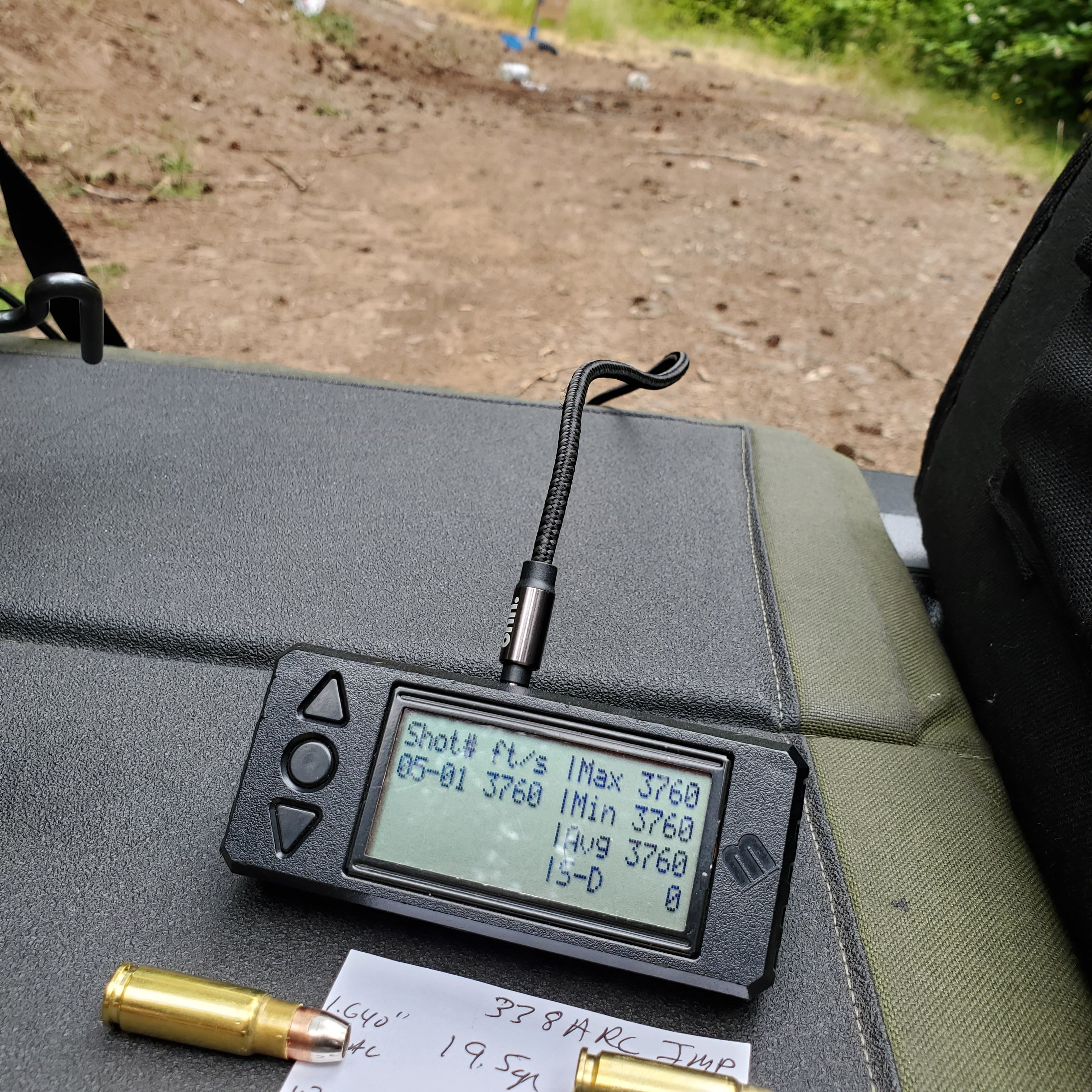

But I also load the worlds fastest 338 ARC improved at over 3700 fps.16" AR 15 6.5 twist.
The 338 ARC imp 16" AR 15 is about as good as a heavy AR 10, 8.6 blk 3 twist, in a 12" barrel and will actually shoot many bullets faster, especially jacketed lead.
These light bullets go fast but have limited range...unlike a 160 gr tipped Barnes at 2800 fps.
What bullet was this?
I guessing on the bullet....you mean, the little AR 15 338 ARC Imp running over 3700 fps... the bullet is a 9mm 50 grain copper, re-machine in a lathe collet to .338"... also used in AR 15 9 mm 16" at 2640 fps, and high velocity 358 win loads.

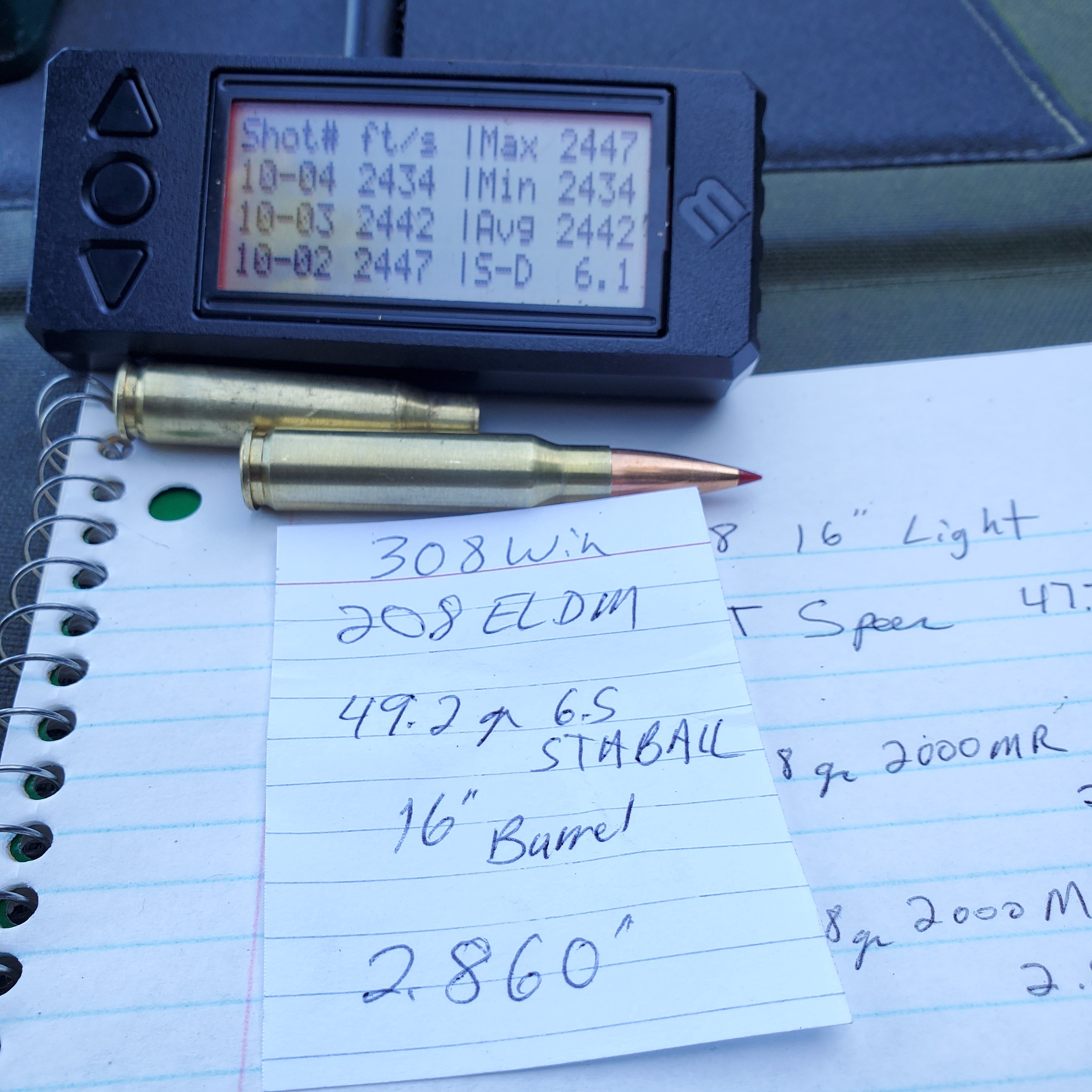

I built a 6 lb 308 AR 10 16" barrel, titanium, carbon fiber, magnesium upper.
It's lighter than my AR 15s.
It does 2442 fps with 208 ELDM.
Beats carrying a heavy AR 10 in 8.6 Blkout for range and potential killing power.
155 gr 2875 fps with Sierra Palma.
168 ELDM, 2756 fps.
308 sub moa, cheap to shoot, huge variety of bullets, magazines, etc.
The 8.6 Blk is mainly a sub gun...thats why most buy it...it has little range potential with supers and the 3 twist. Poor BCs at low velocity.
I increased it super potential with 6.5 twist running 200 grs to 2600 fps in 24" bolt gun.
High velocity kills alot better for general use.
The standard 308 put more energy on target with supers, cause it has more powder capacity and new bullets with good BC for any reasonable range for hunting hog or other game.

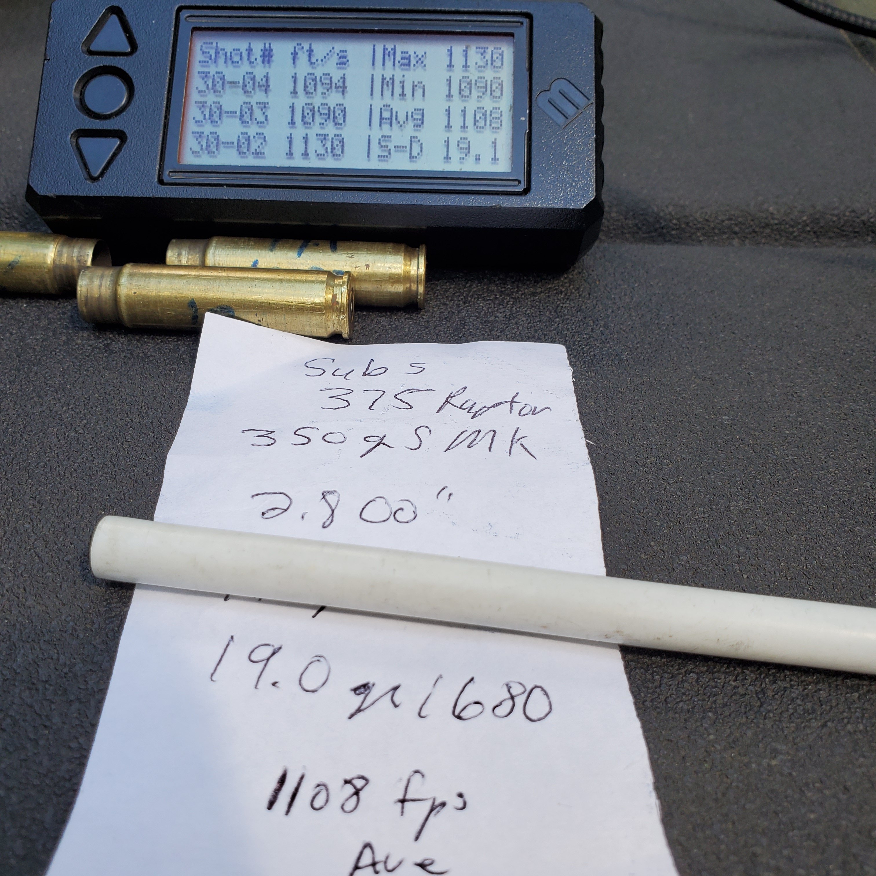

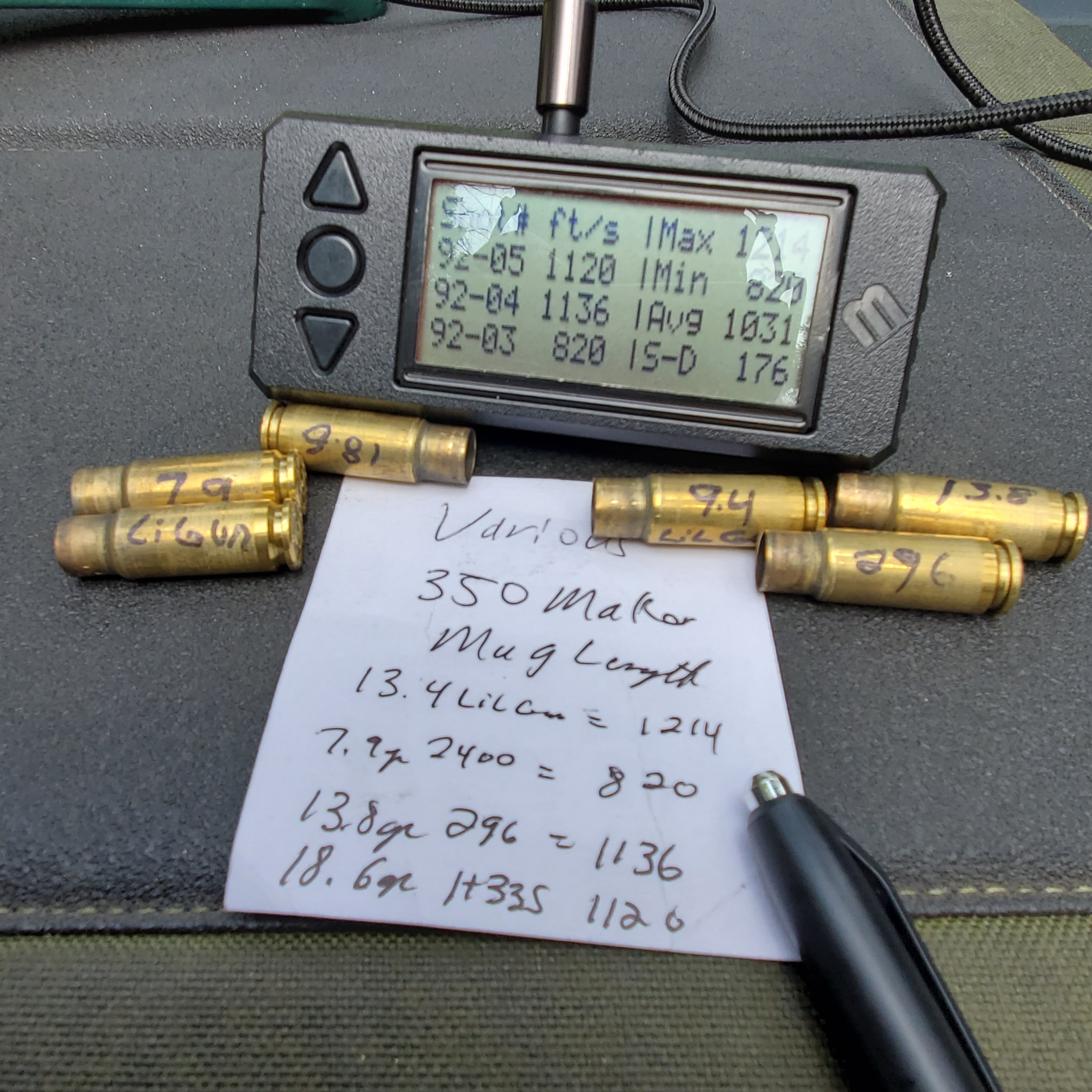

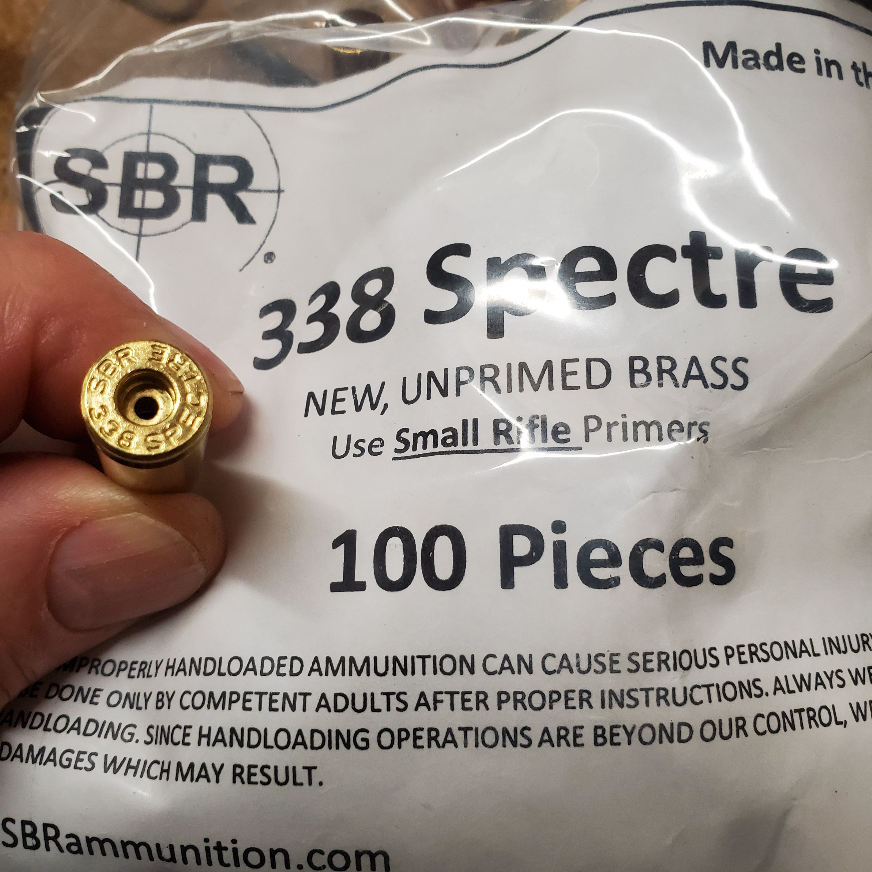

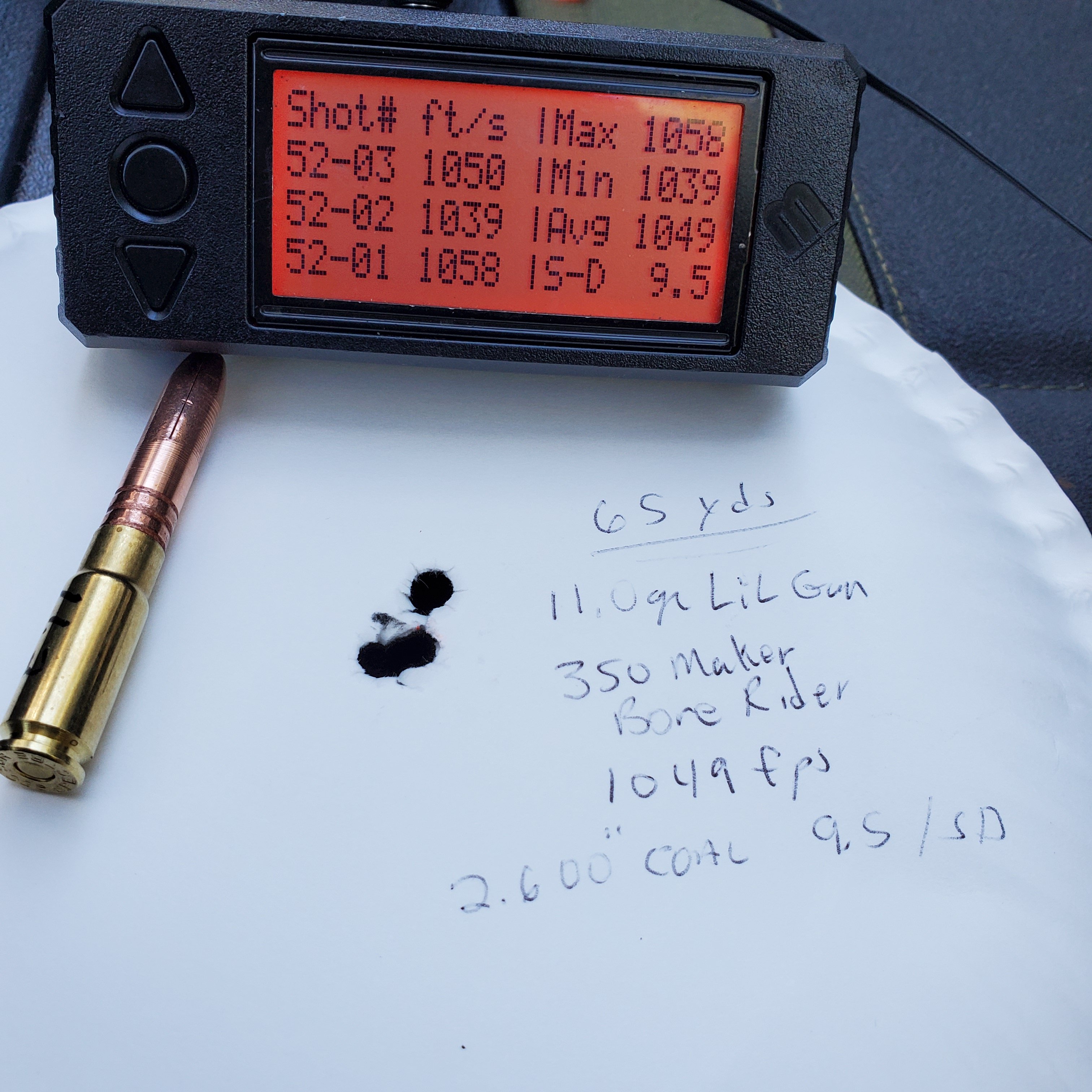

Here is the real reason for the "350 gr Maker bore rider bullet", was to add some caee capacity to the 338 Spectre cartridge,
Because he was shooting a bolt gun and didn't care about AR 15 mag length.
So it only too 3 grains off the bullet but allowed the 350 gr to be seated out to 2.6" adding case capacity to the tiny 338 Spectre.

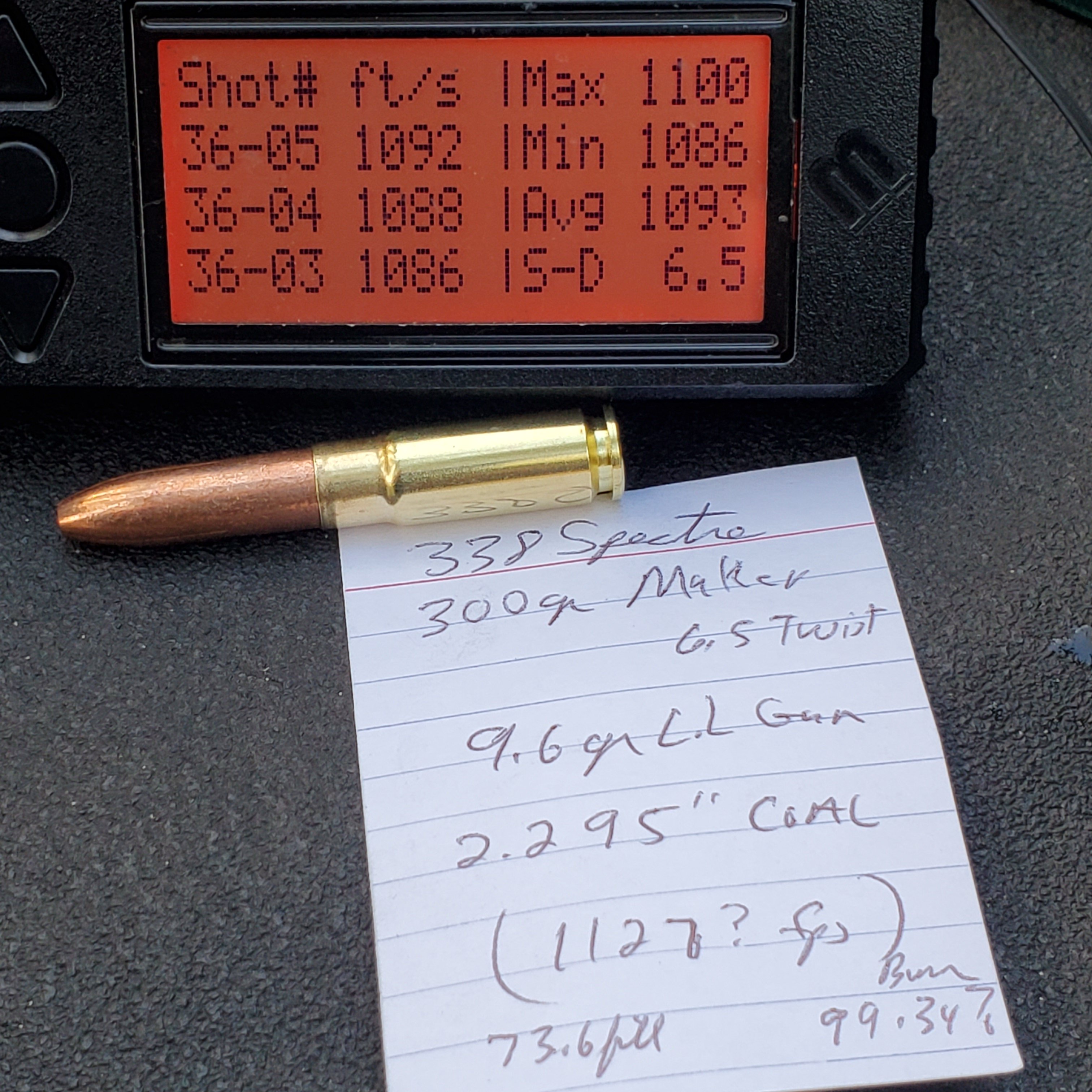

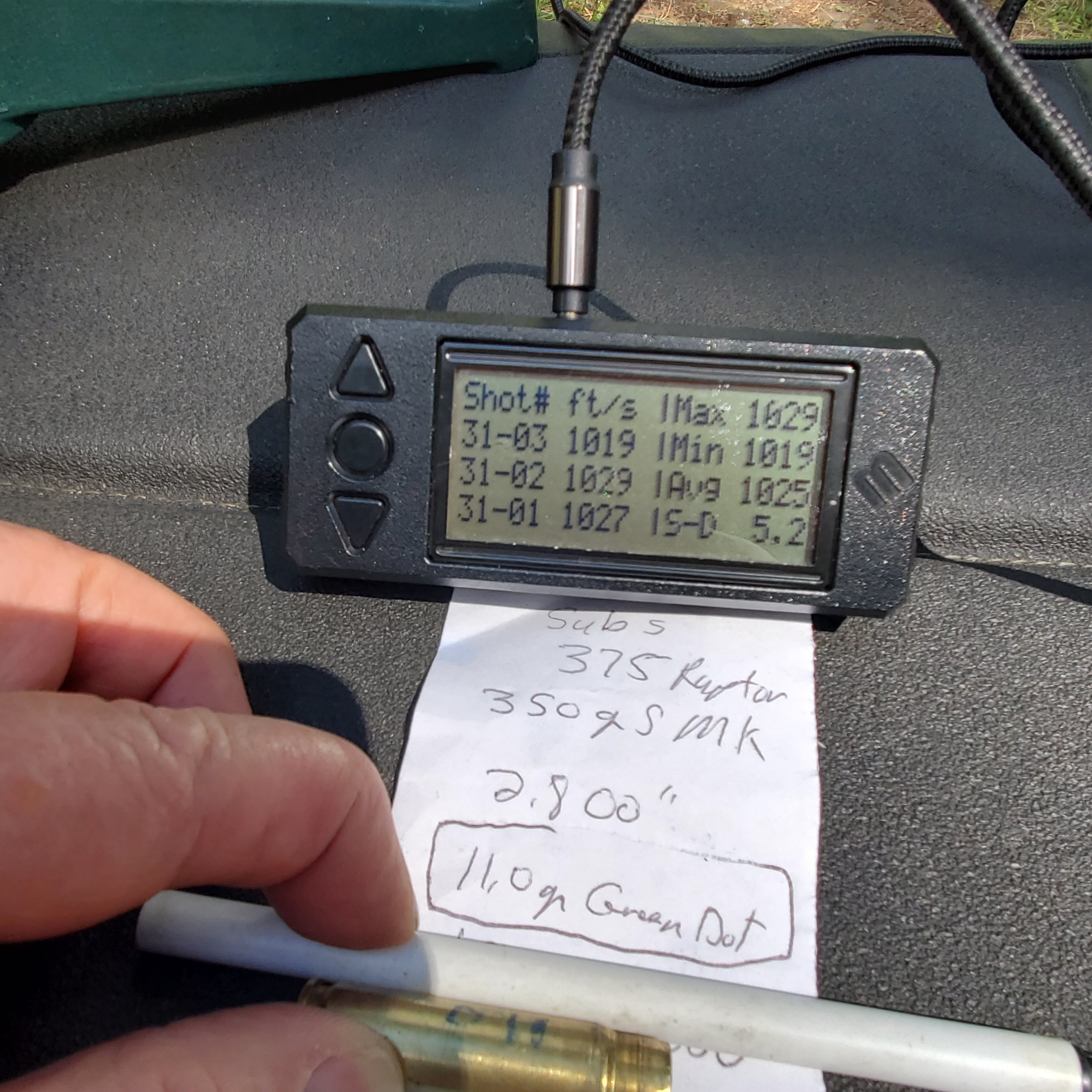

11.0 grs LilGun was the best at 1049 fps
10.5 grs of LilGun was good S/Ds but wasted too many getting on target, and the resulting 3 shot group was a little larger...
11.5 gr was top velocity load at 1114 fps probably too close to breaking the sound barrier.
This load data could be used in 338 ARC ...If the 8 twist will stablize the long 350 gr bullet, and one can seat it out to 2.600"
With out seating it out the top velocity was 873 with a few loads tried.
Just playing with it not hunting.

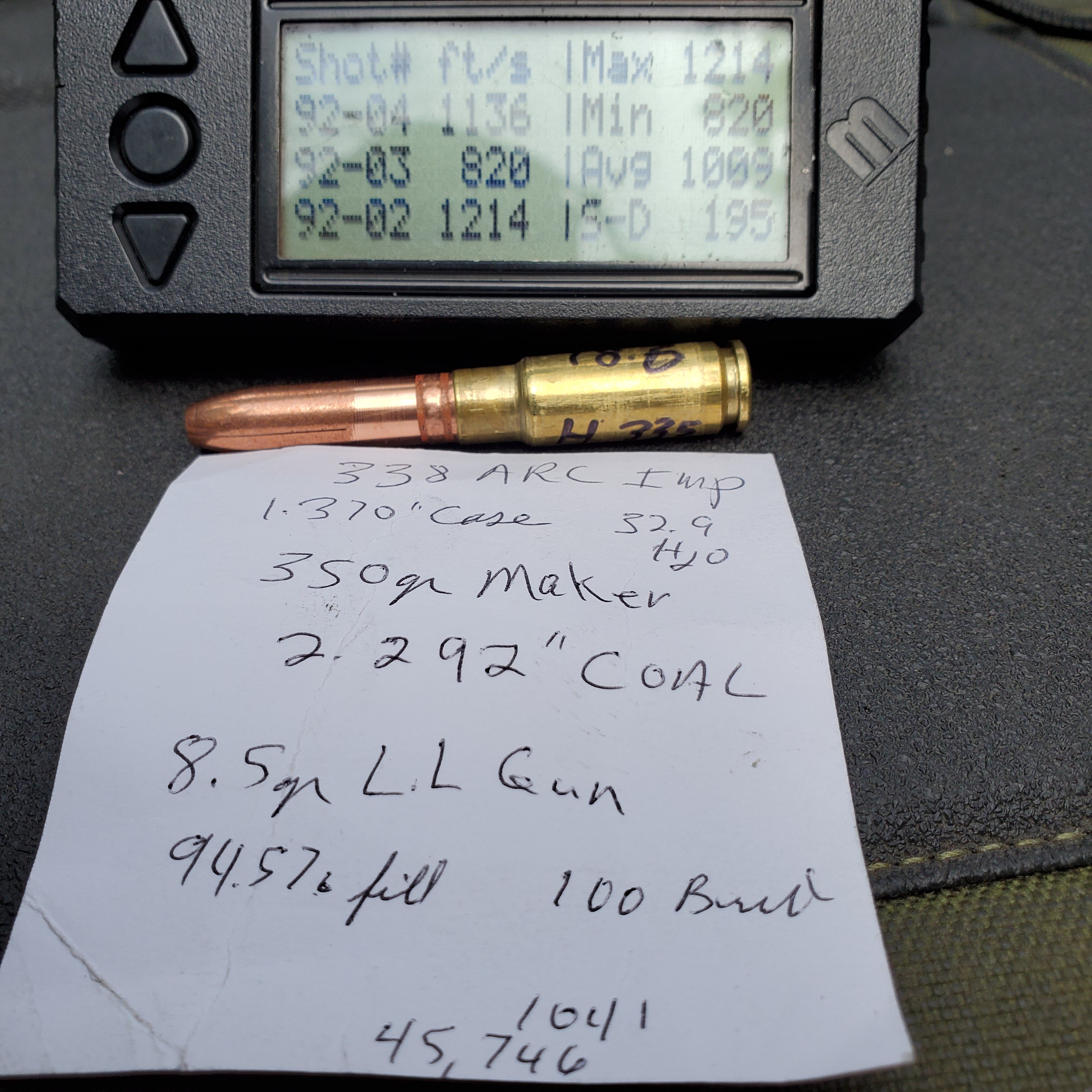

Do you think that an unmodified Rex 350gr bullet would fit a normal 338ARC prefit at 2.500-2.600 in a normal chamber ?
I’m about to order a 12.5in barrel for a dedicated subsonic bolt gun off a ARC CDG action but I can’t get over the fact that the 8.6BLK case is way too big for good consistent ignition and we don’t have any good bulky powder in the N110 burn range.
I have a spare Grendel bolt head for my action so I wouldn’t be too hard to sell my alpha 86 brass I previously bought and go with the 338 arc for the “cheap” factory ammo for plinking and just shoot the Rex 350 loaded at max AICS coal.
Quick load gives me 1111FPS at 2.500 with 10.5gr N110 and that’s a 99% case fill and 50K psi. In my experience with long range subsonic this is a way more optimal configuration than the 55% burn you’d get with 86BLK.

The 6 or 6.5 twist is the way to go with the 338 ARC.
If you are running a bolt gun you can extend the throat for longer COAL to give the 350 gr Maker more powder capacity and close to 100% case fill. The 350 is a lot of bullet for the 338 ARC ...but if throsted or bore riders incorporated you can run it to 1200 fps if ya want...putting more energy on target that the 3 twist 8.6 blkout cause it's limited to 1050 fps max or it may come apart before it reaches the target.

If running the blackout in super mode with 6.5 twist barrels….does it become accurate?
Yes, for me changing from the 3 twist to the 6.5 twist made a huge difference in accuracy and higher velocities.
Plus you can run every bullet even cheap jacked lead as fast as the case will allow without fear of the bullet blowing up and destroying your muzzle devices.

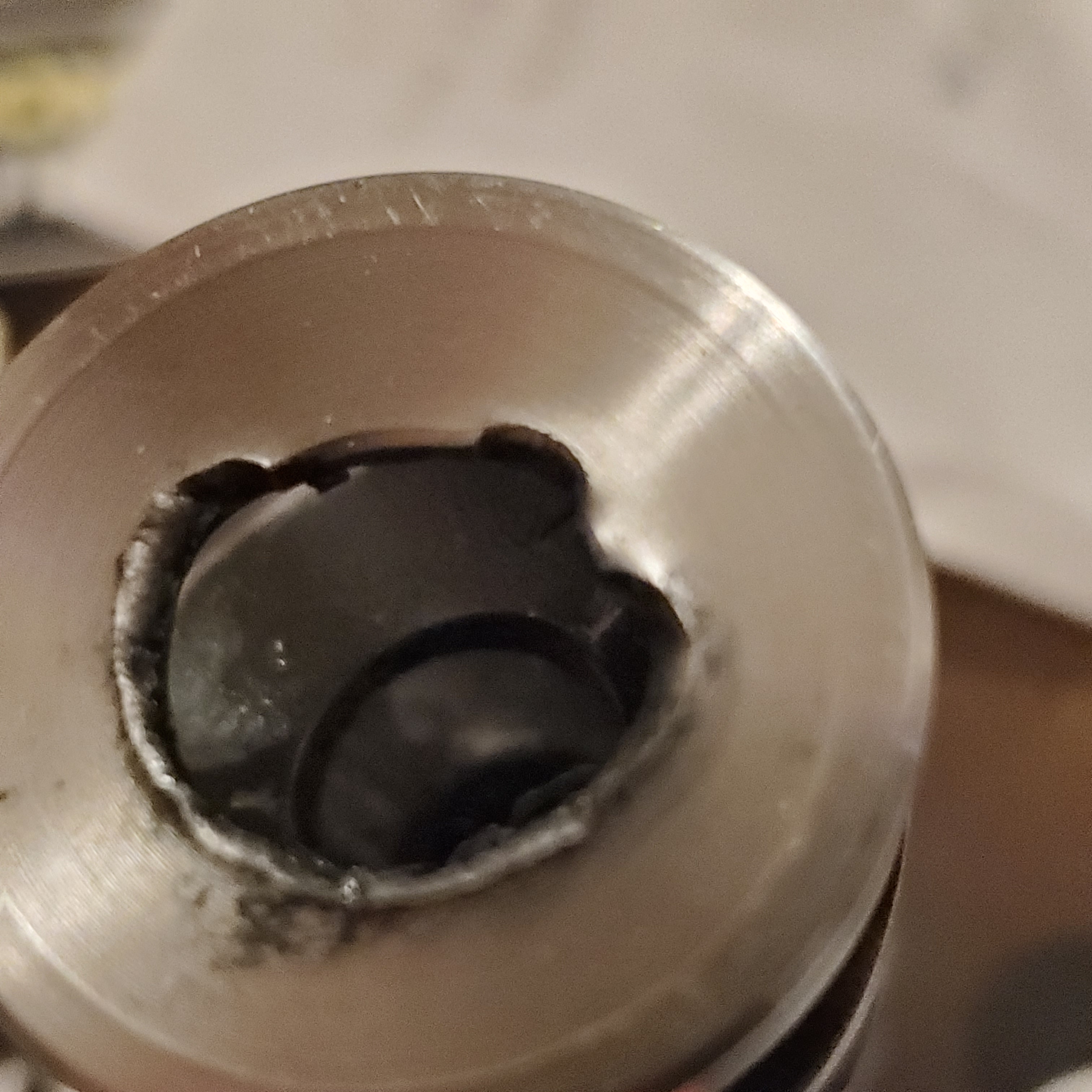

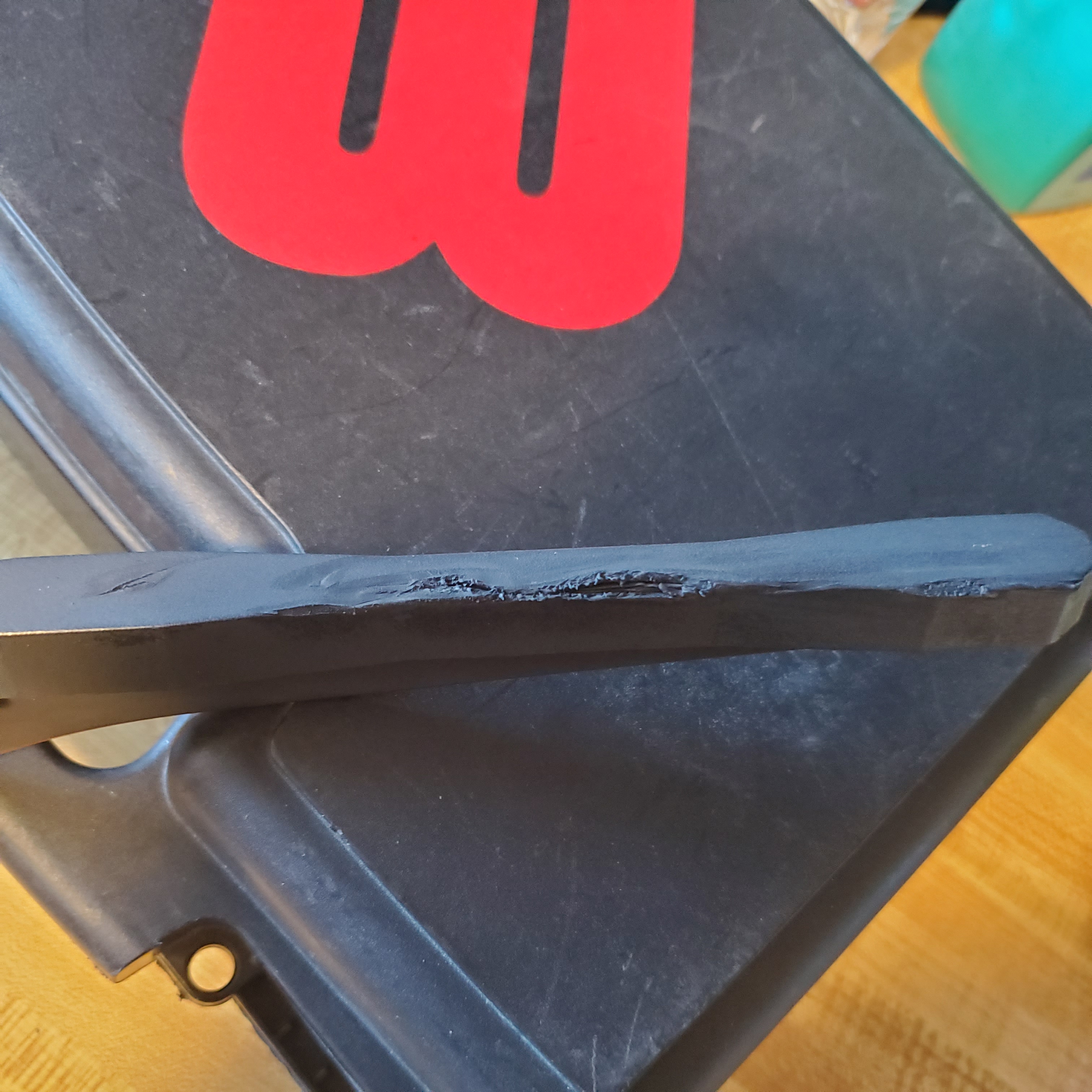

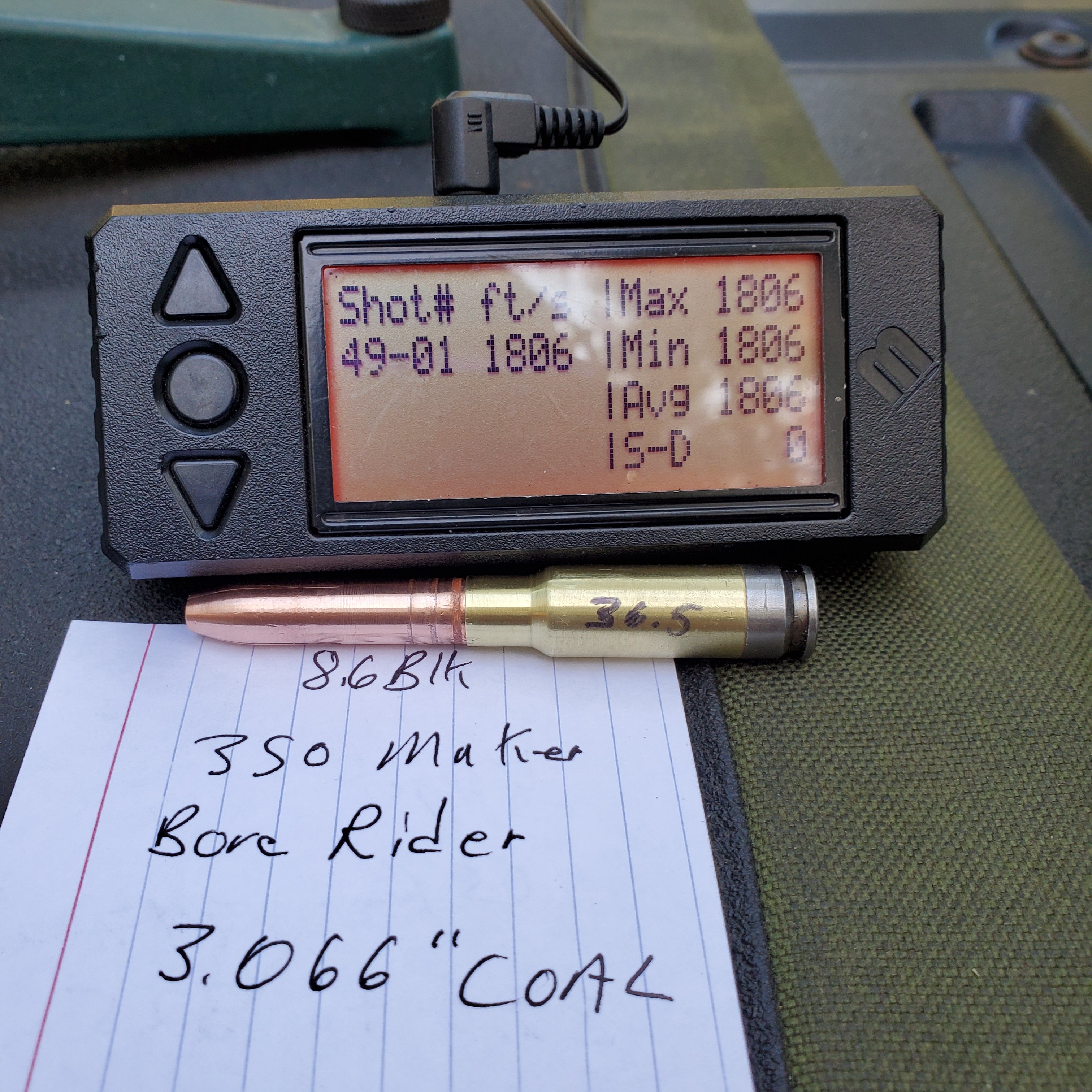

The 350 Maker will not be limited to 1050 fps max as with the 3 twist...

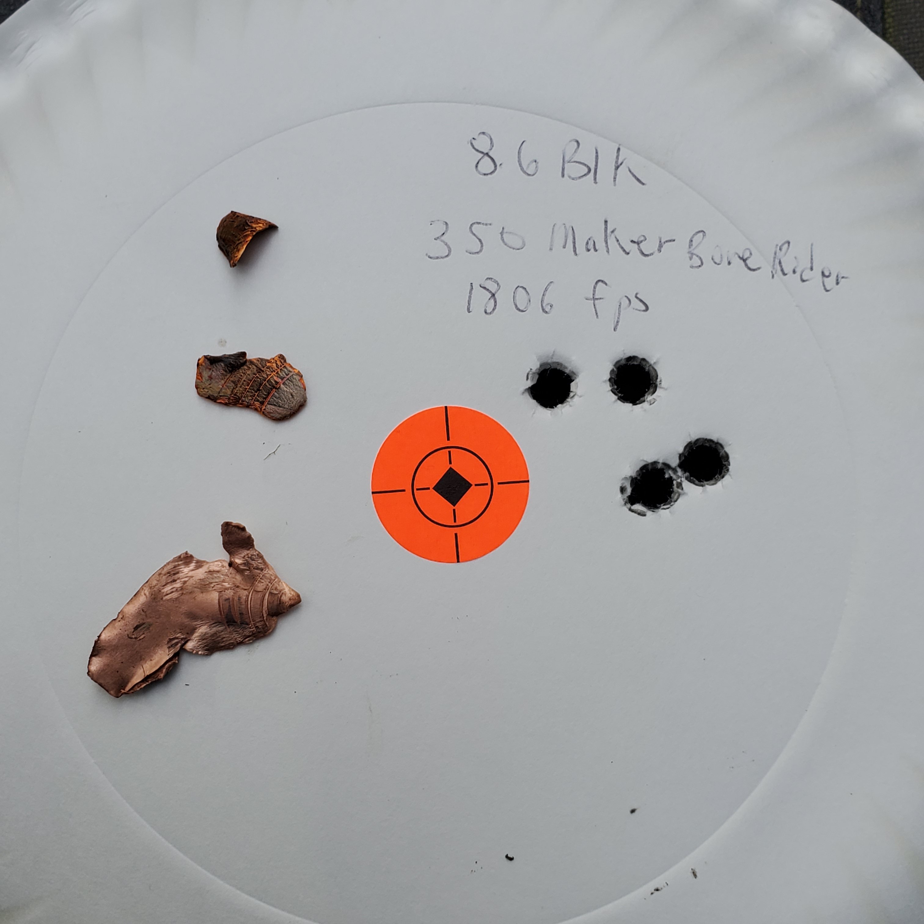

Here the 350 Maker hits 1800 fps in a 6.5 twist barrel and doesn't blow up inside the muzzle device but gets to the target.
Large bullet fragments found in the dirt...
If you ran a can in a 3 twist you should limit the 350 maker to around 900 to 950 fps to make sure it doesn't destroy your silencer.
With the 6.5 twist double the velocity no problem, and go from 700 ft/lbs at 950 fps to over 2500 ft/ lbs at 1800 fps ...if ya want, and better accuracy.

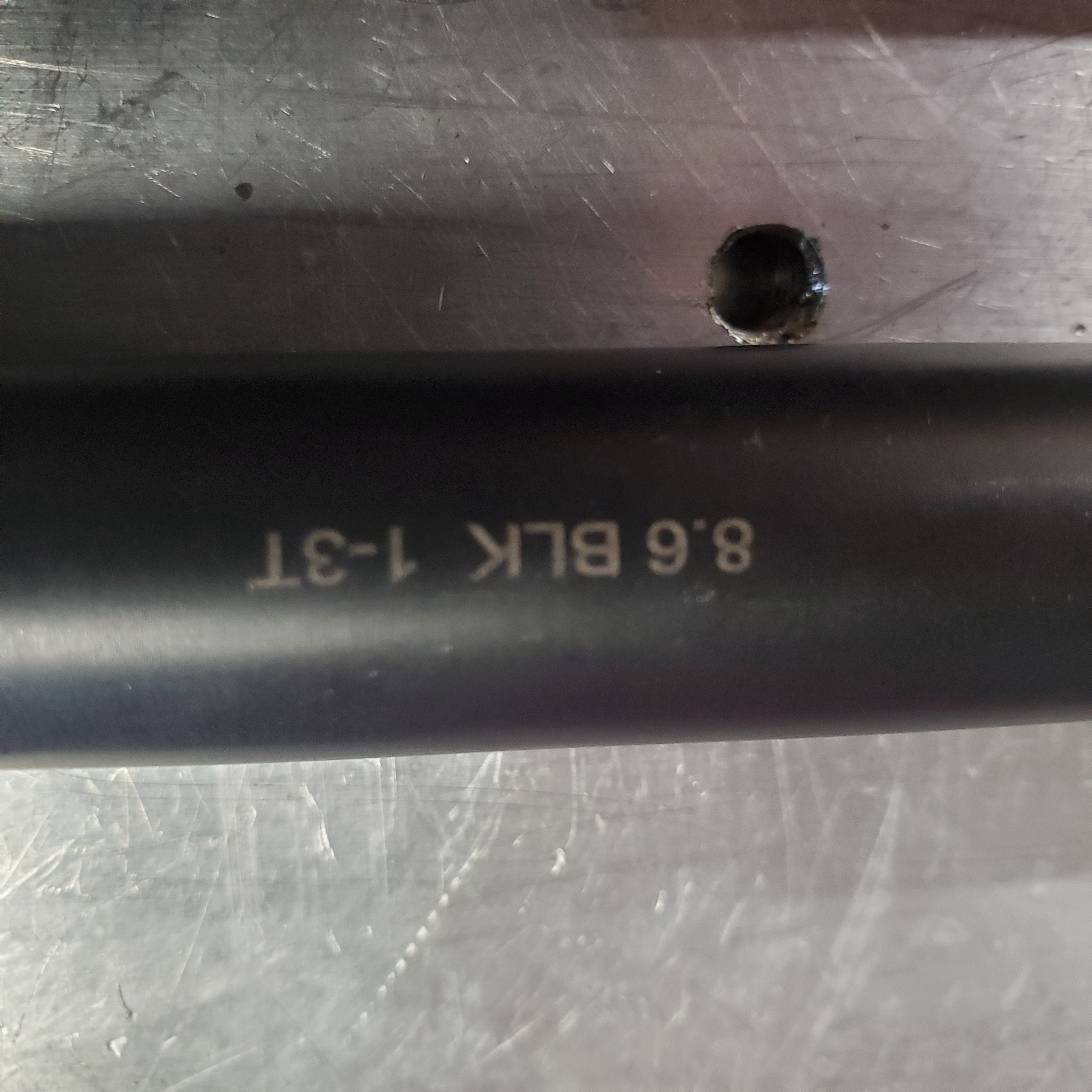

Yeah the 3tw was retarded. Never again.
Yes it was a bad idea ...plus an expensive lesson for me...my curiosity was actually a dangerous endeavor with the 3 twist.
The ridiculous 3 twist barrel was taken off and scrapped as a really bad idea..which I kinda suppected all along....but I had to try it, to find out for myself.
...But "never again!"...I totally agree with that statement.
