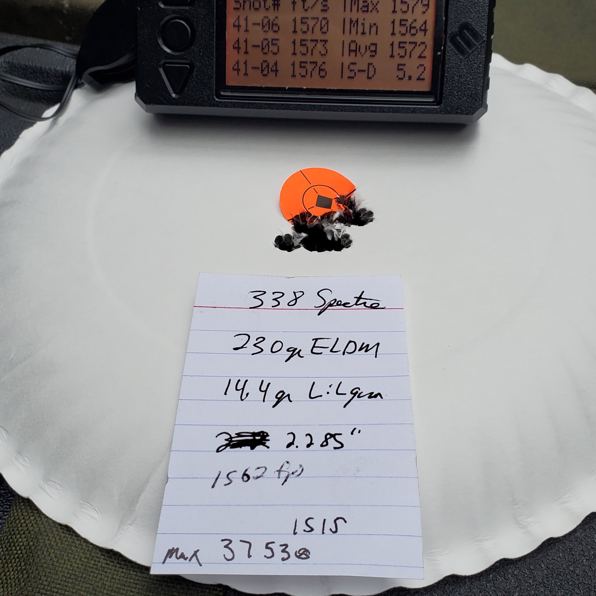

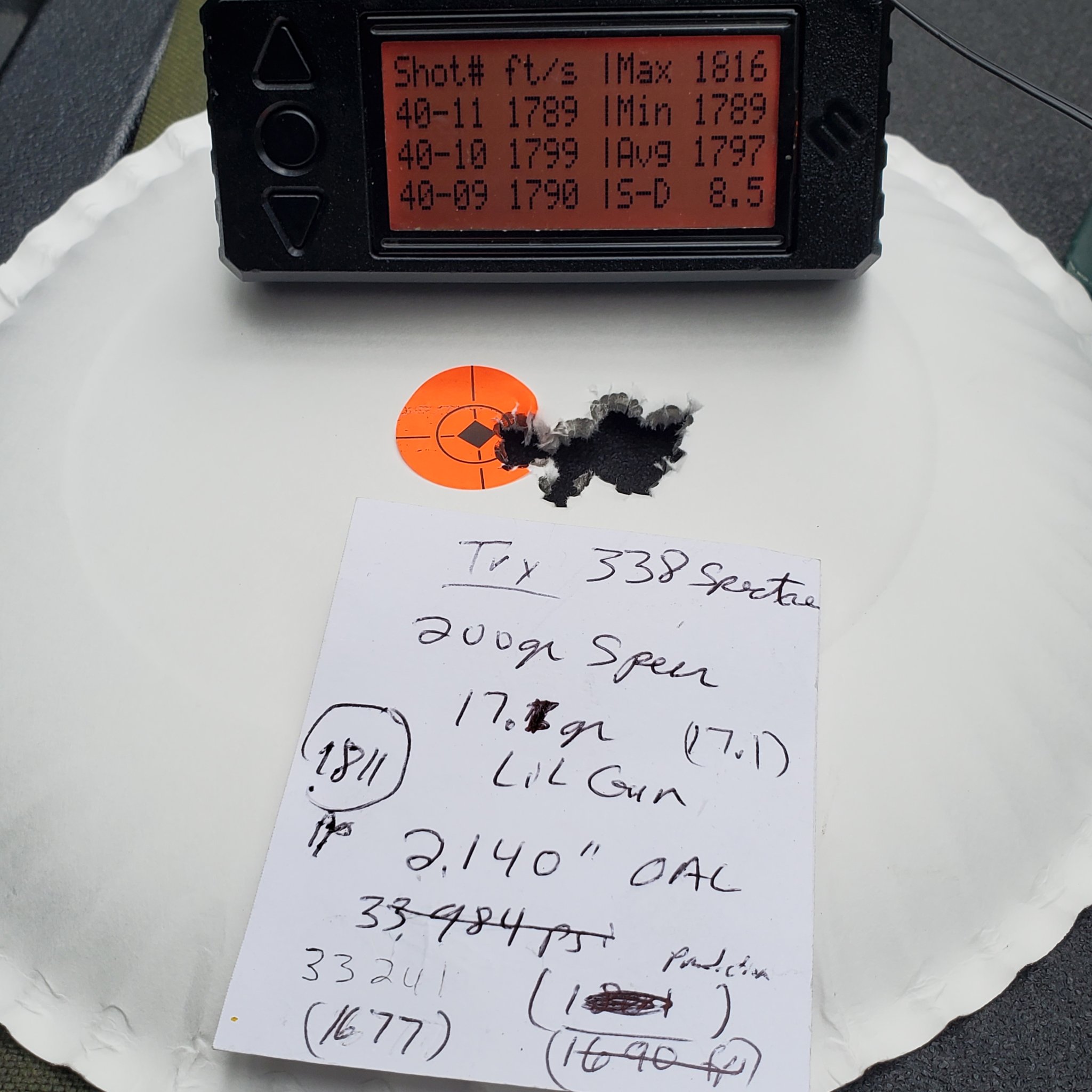

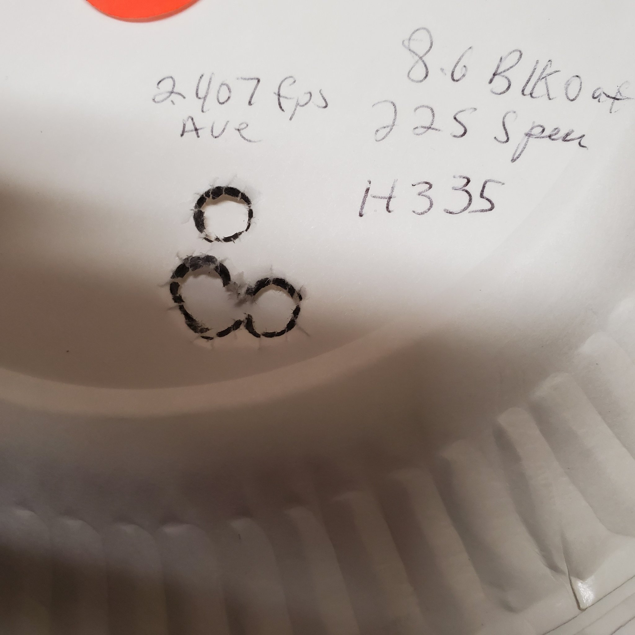

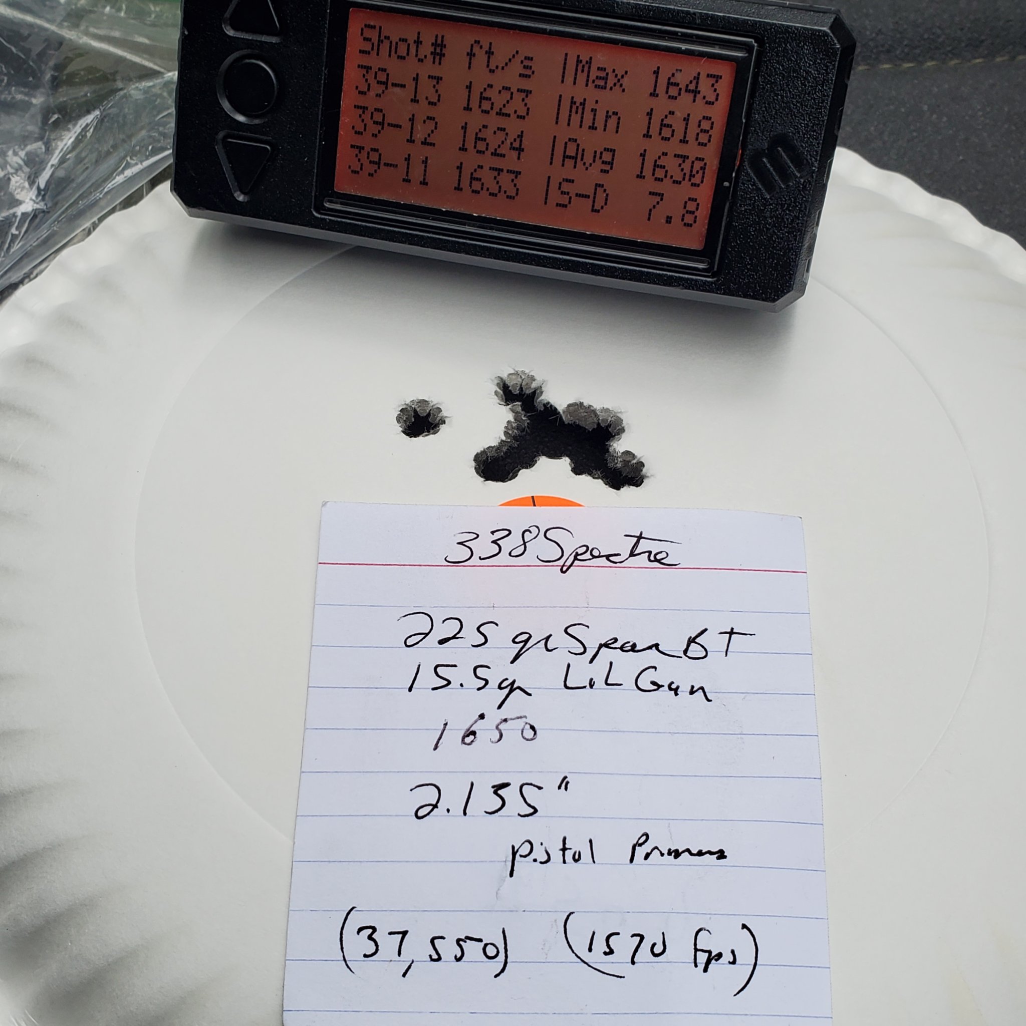

Got a chance before the storm to shoot the 338 Spectre with pistol primers, using QL predicted data.
The 338 Spectre is more limited with large pistol primers in pressure so I put some max pressure loads together with LP primers.
I am impressed with the tiny velocity spread of just about all supers, fired in an AR 15, And loaded on a Dillon progressive with a case activated powder measure drop...no weighing of each charge...and single didget S/Ds is excellent.
That can be attributed to the higher load density of the tiny case, and the predicted 100% burn rate by QL.
Also note a predicted load velocity by QL and the actual velocities measured....
In high pressure supers QL predicition velocity was lower then measured velocities.
But on sub loads QL predicted higher velocities, than actual measured velocities with same powder. The inverse happens.
I would attribute that to the change in pressure causes a change in how well the powder burns, and its burn rate, even if it's a hundred percent burnt at low pressure.
So with LilGun I have to take out maybe three tenths of a grain on supers and add maybe half to eight tenths grain on subs ...in this cartridge only. But it's probably True for other cartridges as well depending on pressures and fill percentage, making 5hings more unpredictable with large swings in fill percentage.
Lots of interesting things happen when comparing cartridges same caliber but too large a powder space in the cartridge for subs and some supers VS a smaller cartridge that utilized most of the space.
Kinda proving what we already know.

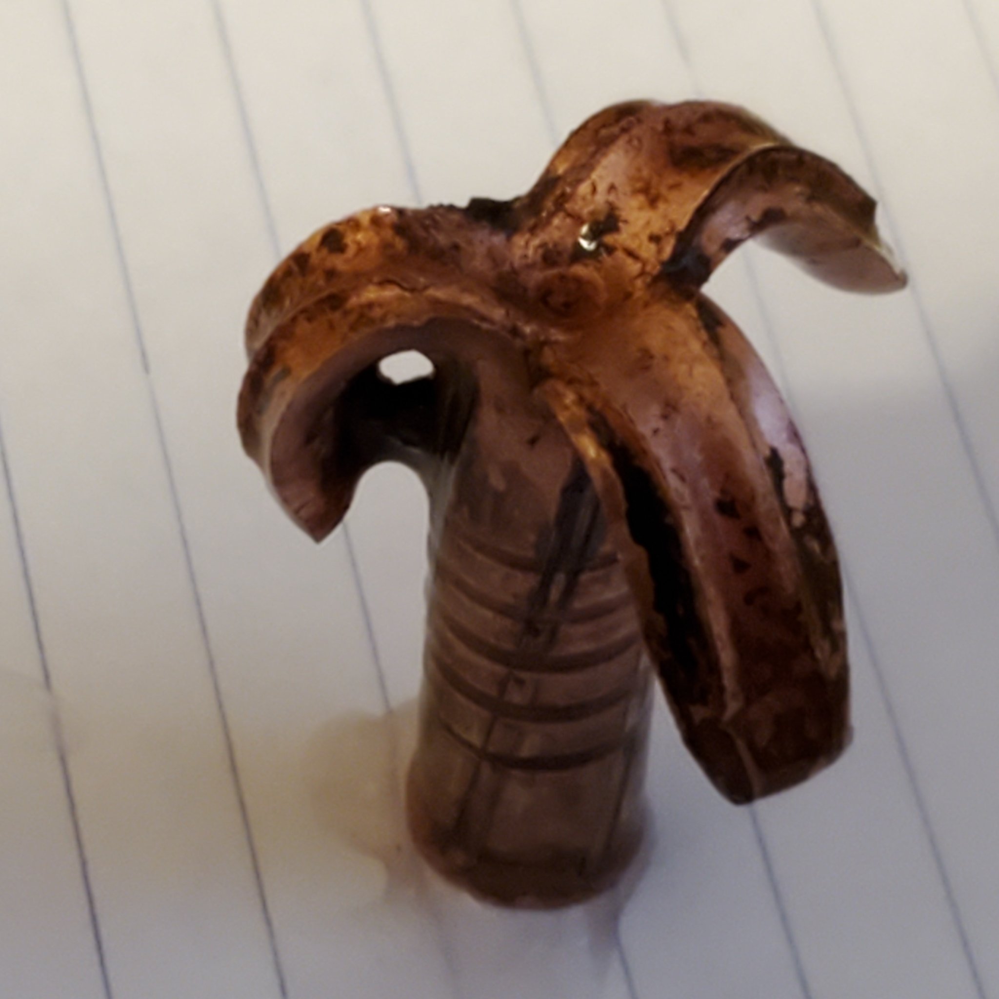

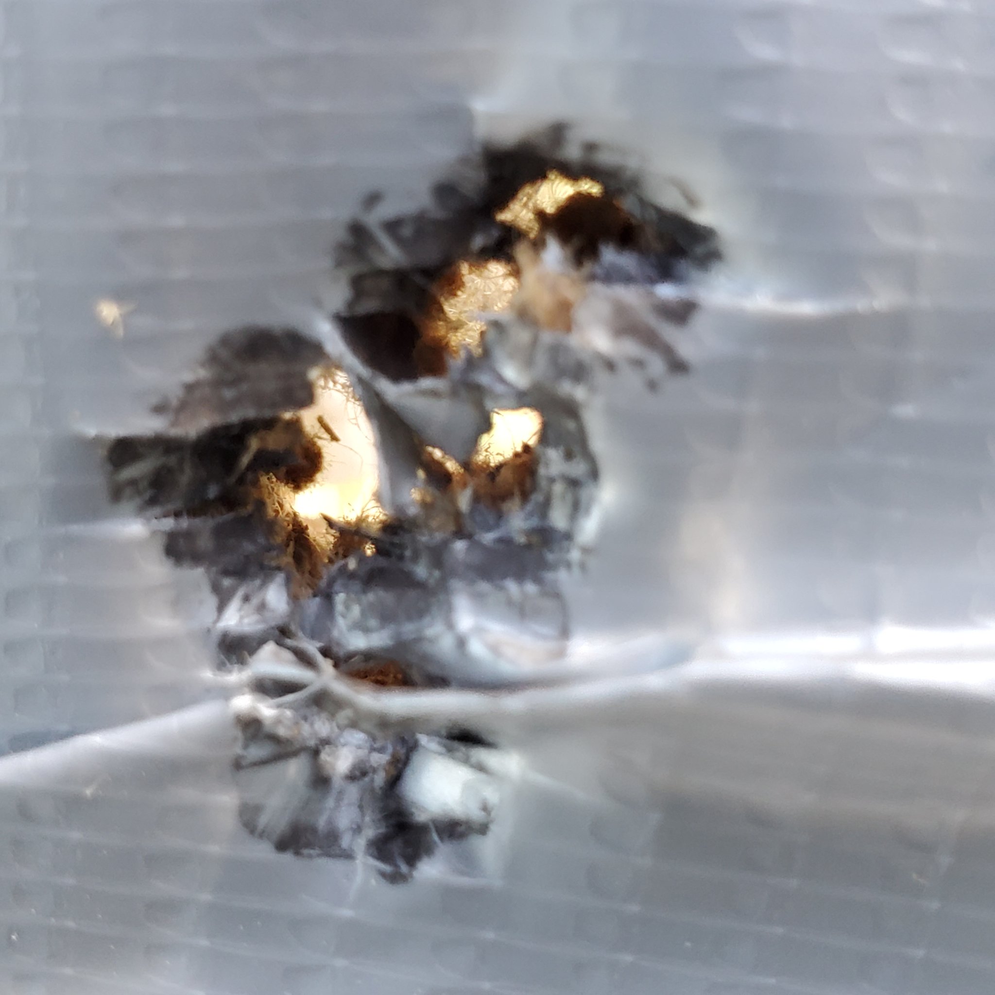

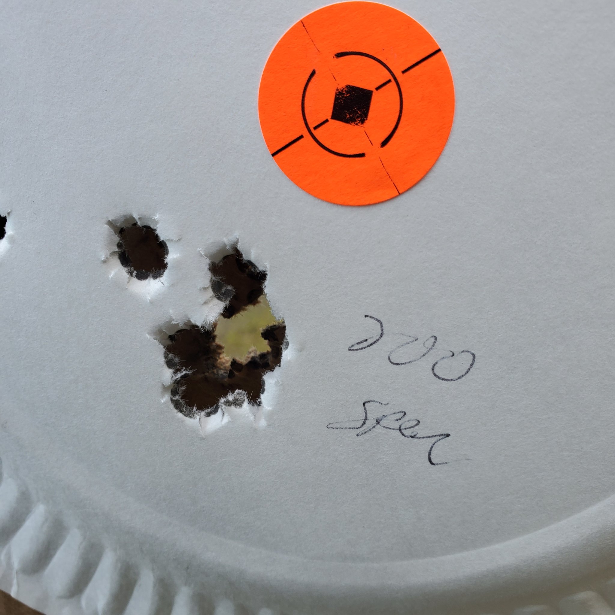

And last but not least a 300 gr Maker Rex specifically made for 6.5 twist 338 Spectre shot at 961 fps muzzle (a bit low from QL prediction) into a wet dirt bank void of rocks.
Yeah I know it's not ballistics gel, and I ain't gonna hunt with it...but the dirt bank had nice fine moist dirt...so why not try it.
It worked as it should in this medium and spun around almost backward at the end of the dirt wound channel penetration was good.
But you hunters will have to actually preform your own test to satisfy yourselves before going hunting...this is just me shooting stuff, and here is the results of those tests.
A fun day shooting...

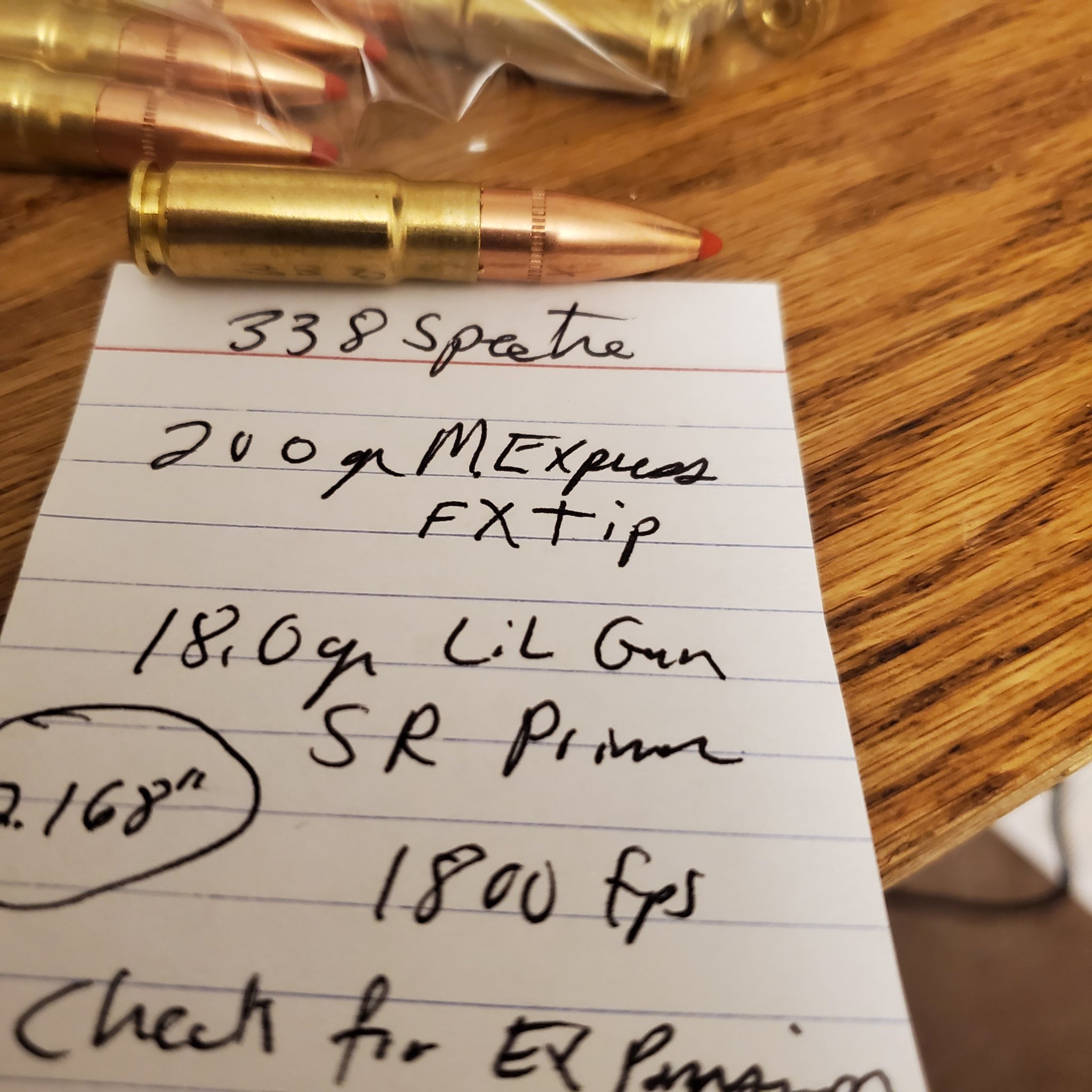

For those who want to try a more stable?...or maybe a different Maker Rex heavy bullet, the 300 gr 338 Spectre 6.5 twist is made for the 6.5 twist exclusively and ya get 50 bullets instead of 25 bullets in the box,...cheaper.
And a 305 gr, plus many others in the lighter grain weights..to try, but do pay attention to their recommendations as to what twist rate & velocity the bullet was actually designed for.

For subs only, for me, I've shooting the 338 Spectre, while waiting on tbe 338 ARC reamer, for some time in tbe AR 15.
The tiny 338 Spectre has been very accurate, & very consistent, single digit velocity S/Ds plus a lighter AR 15 platform, with its 6.5 T barrel shooting everything from 160 Barnes to 350 gr Maker.
The 350 gr is a lot of bullet for this tiny case and Maker makes a 300 gr that's better suited and specifically made for it plus their Super Expanding 165 gr at 2100 fps might give one extra desired range.
Plus Hornady the the very similar 338 ARC coming one of these days, I already have the cases.
This should be a very accurate sub gun for the light AR platform and short barrels.
They are 8 twist barels with their two loads a 307 gr sub, which should expand at sub velocities, can also be utilized in the 338 Spectre, 6.5 T. But the 3 T, who knows?
Hornady engineers laughed at the ridiculous 3 T on video, and went with 8 T, which highly irritated "one" person.
After spending a ton of time and money on the 338 sub/ super combo, it's not easy to do both with the best outcome of either...but the 6.5 twist is a huge plus.
I believe the best subs, are the small capacity cases, like the 338 ARC or 338 Spectre are the way to go for subsonic shooting.
The 338 Spectre that I have in AR 15 is an absolute blast, super accurate, shoot the eye out of a hog at 75 yards all ten rds.
I expect the same from the 338 ARC.
But neither is much of a super cartridge.
The 165 gr at 2100 fps that's supposed to expand at 900 fps may be the LR bullet for these tiny cases.

Just loaded some 200 gr Marlin 338 express flex tip bullets in the 338 Spectre, for testing they should be over the 1800 fps minimum muzzle velocity to expand..to see if they offer a good cheap hunting solution for smaller cases.
The smaller cases in the AR 15 are a ton of fun, if ya handload.

Is it safe to shoot .338 200gr Hornady FTX bullet in a 1:6.5 twist at sub-sonic velocities suppressed? I would be pushing this bullet at approx. 1,025 ~ 1,050 FPS.
I just loaded up some Hornady 338 Marlin Express FTX 200 gr bullets for 6.5 twist 338 Spectre. They should be around 1800 fps.
To test them out soon as the weather permits.
So 1050 fps should be no problem.
I shoot 6.5 twist now in both subsonic guns, no problem with shooting any bullet as fast as either caliber will shoot it in super mode.

Or 200 gr Speer at 2600 fps, pulled one but 7 or 8 shots under 1".
Or 225 gr Speer lead 2407 fps.
Cheap lead bullets under one inch and better.
That's a 6.5 twist barrel versatility, shoots everything well even the 350 Maker Rex.
