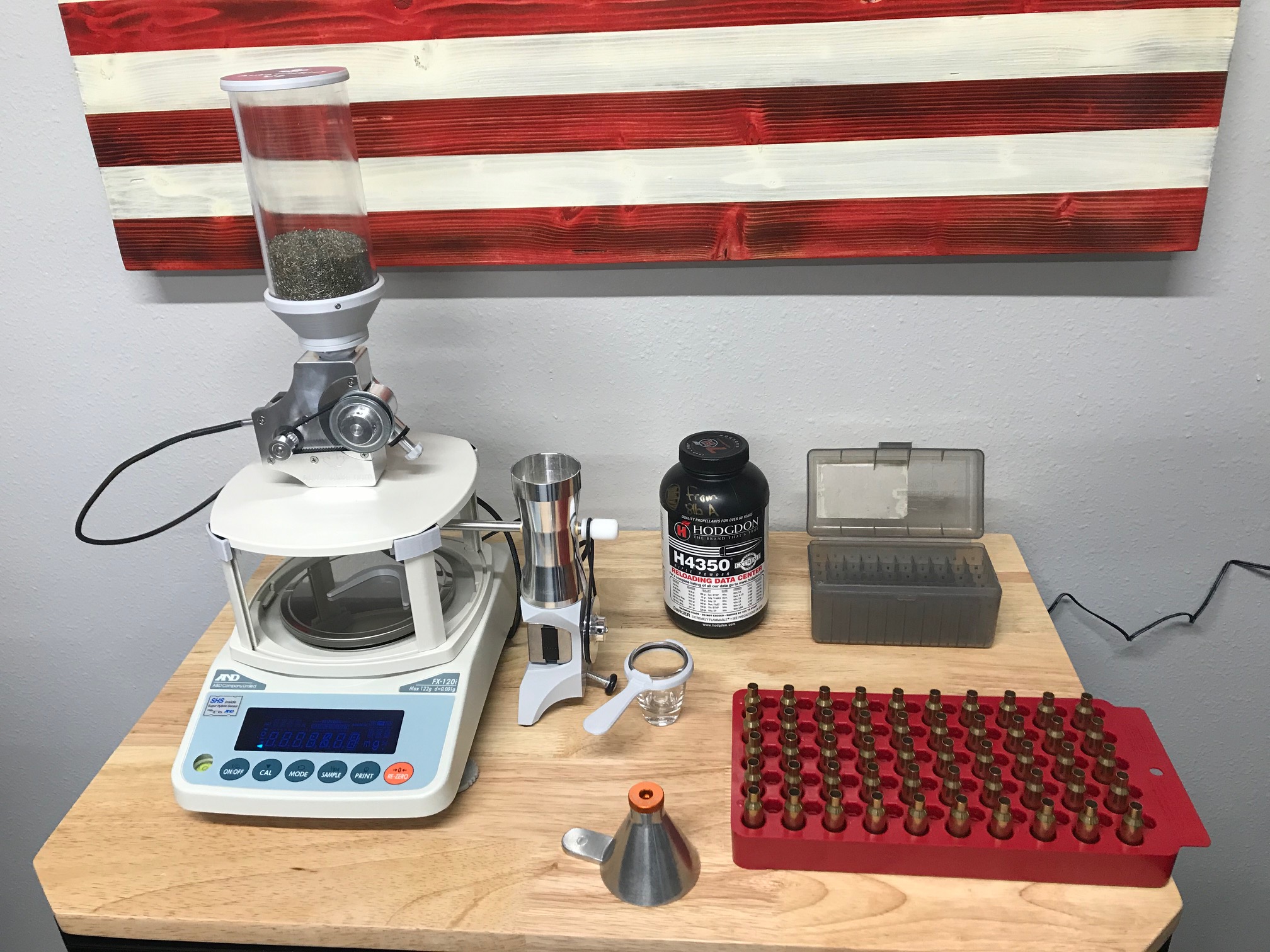

Update Nov 10th: I got everything setup and loaded my first 100 rounds this weekend. Everything worked great after some initial adjusting and tweaking. I plan to add the A419 clear top. I was throwing 41.1 grains of H4350 and was within the 0.02 grain tolerances on almost all but 2 or 3 of the 100 throws. I was able to charge 50 rounds in about 20 minutes, I think I was 35 minutes total to prime, charge and seat bullets for 50 rounds.
Nice looking setup. I'm curious about a cover also. I would recommend the area419 cup- no static.
