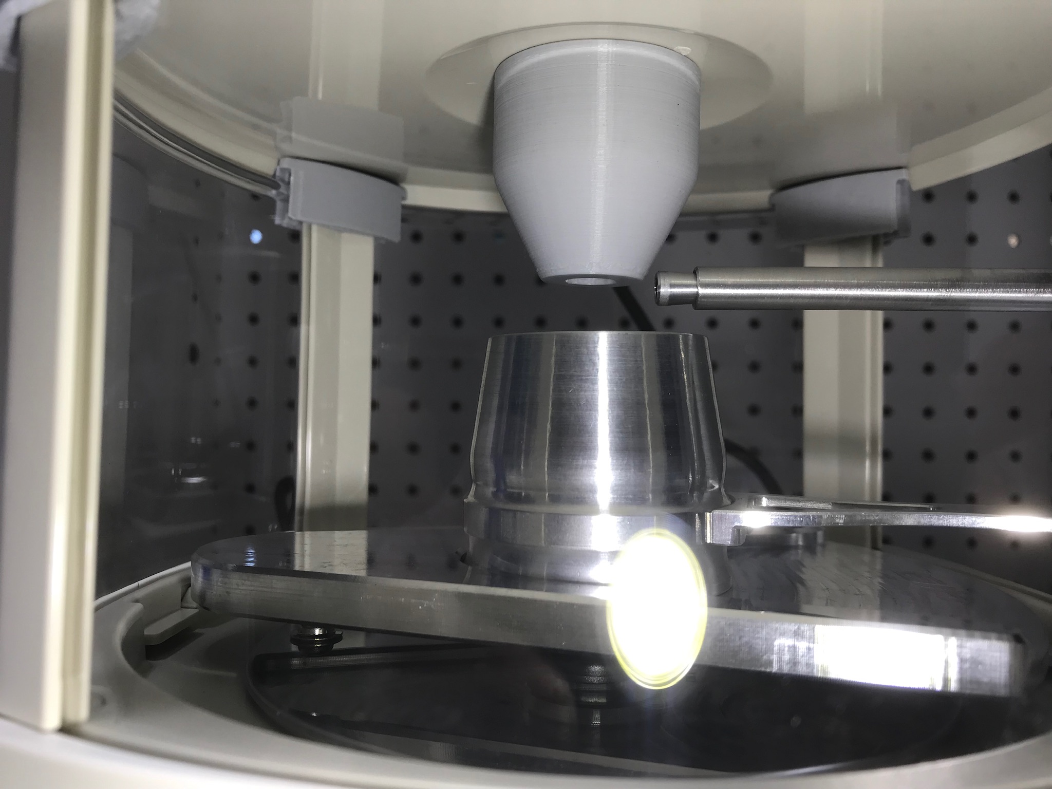

Cascade Hemi...what pan are you using with the scale, the stock pan? or the area 419? If your using a 419 pan, try loading with the stock pan.
Yes and that did cross my mind. I won't be able to get back to it for another week or two.

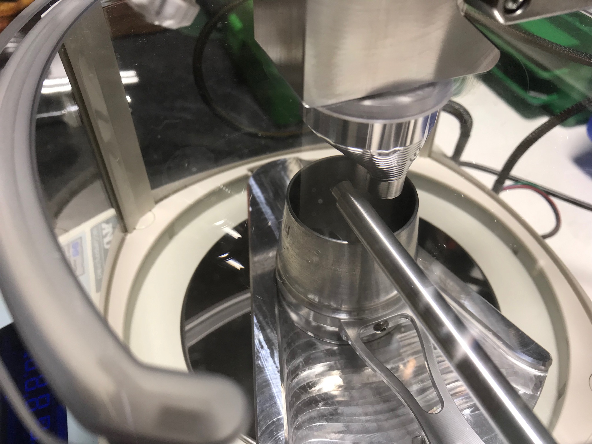

I had the same issue with the A419 hopper. I took a small file and worked on the corners of the auto throw where the hopper attaches. Keep checking the fit during the process. Now the A419 hopper fits like a glove.

My Area 419 housing is a little tight too, but not so much that it doesn't slide in. It was too loose on the V2 housing. No alterations needed on mine.
