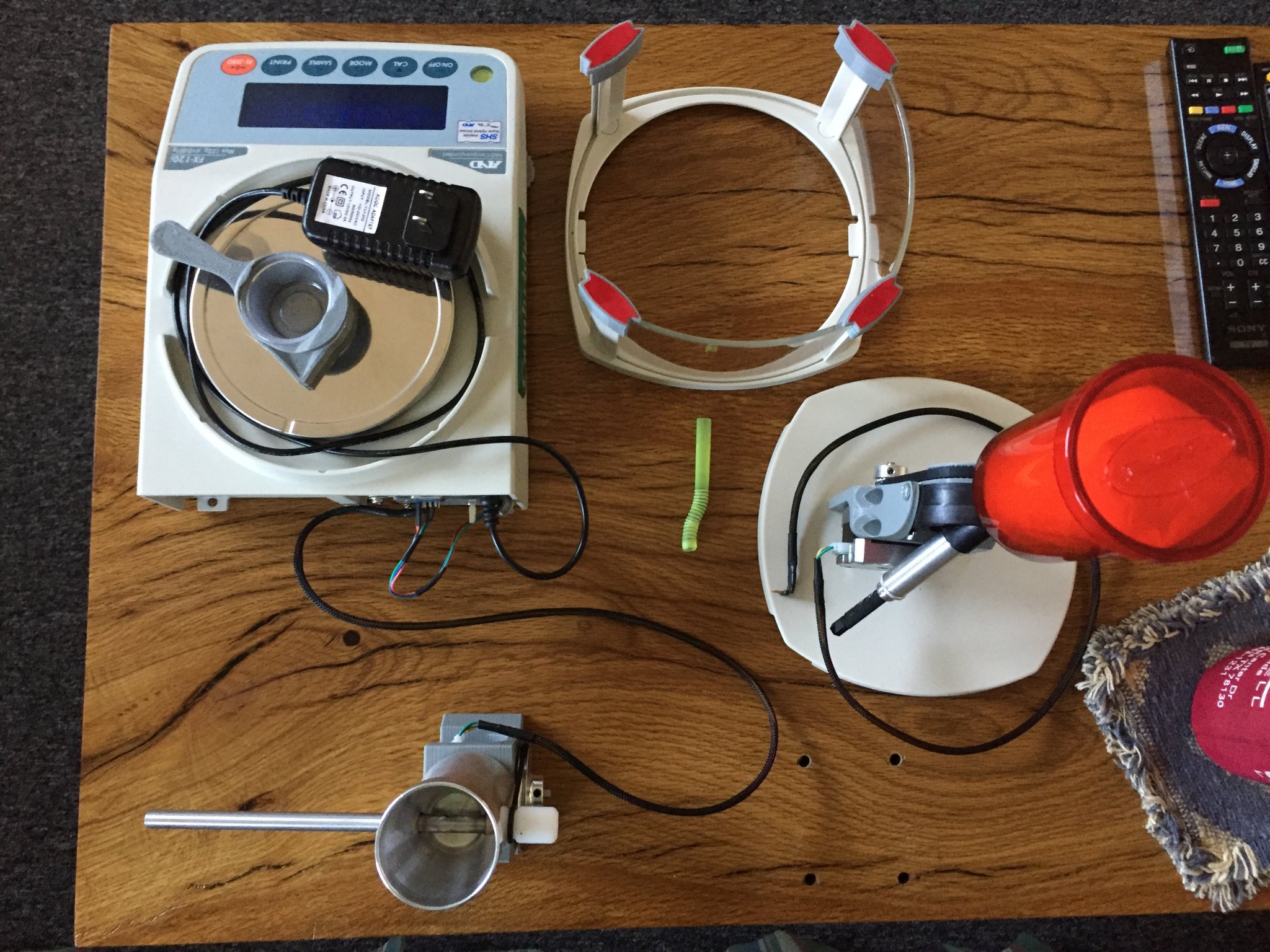

I broke it down into the pieces that require nothing to disassemble other than just lifting on and off. The trickler still pulls right out with an identical connector to what’s shown for the throw, I just left it connected for demonstrating location etc but if you’re thinking about storing it inside a cabinet or under a shelf I hope it helps

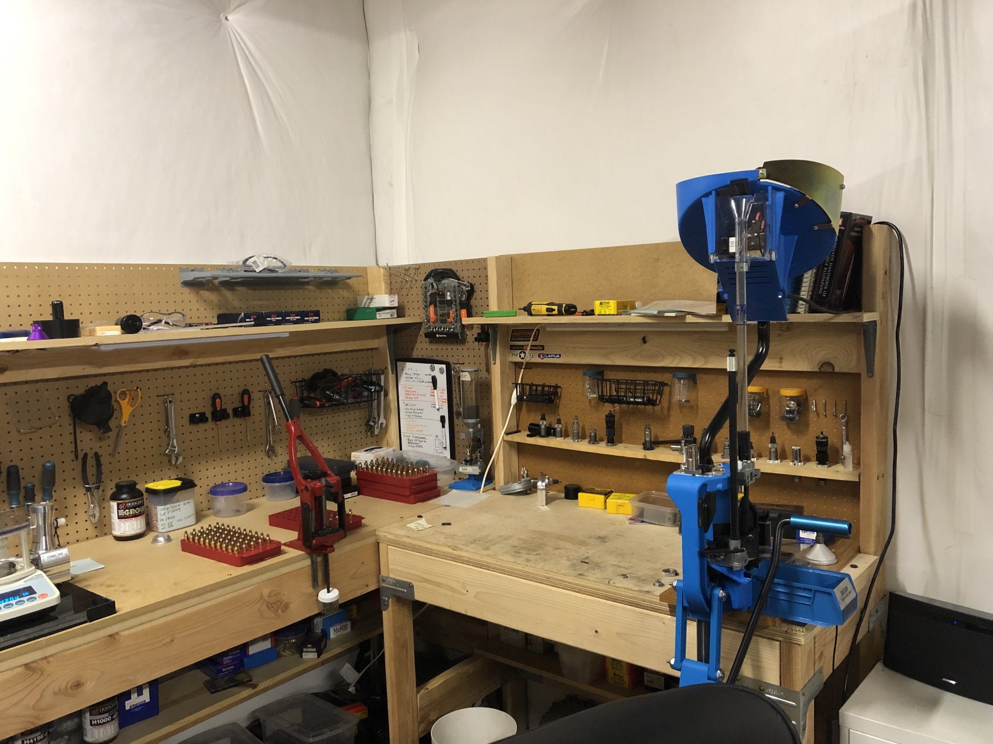

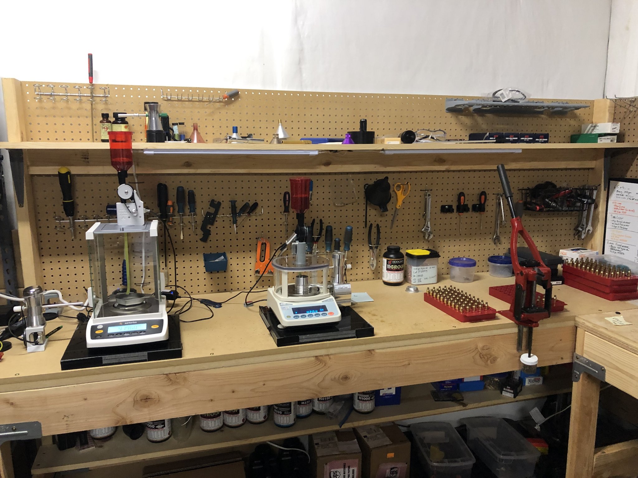

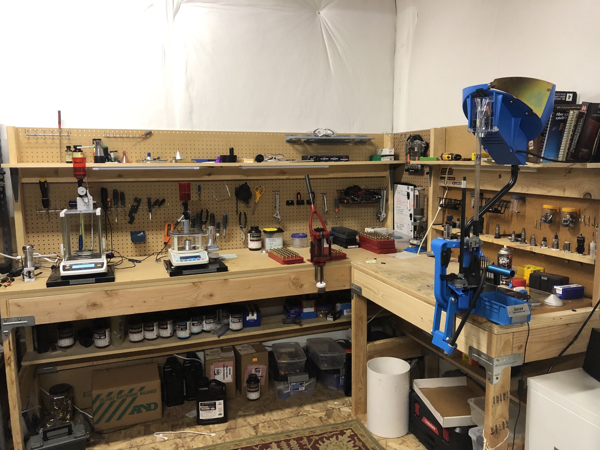

I just recently purchased my second setup with the area 419 upgrade.
this should really put a dent in the time I spend reloading for matches.
A double setup should outrun you by a fair amount! Take a pic of your bench when you get it setup so we can all admire it.
I will need to clean off the whole bench before I can take a pic of the area.
Here is a two year old pic
Very nice setup! We’re looking at new houses right now and my only two requirements are a three car garage and a large enough home office that I can work from home and have my guns and reloading bench all in the same room. Wife can pick whatever the hell else she wants. :ROFLMAO:

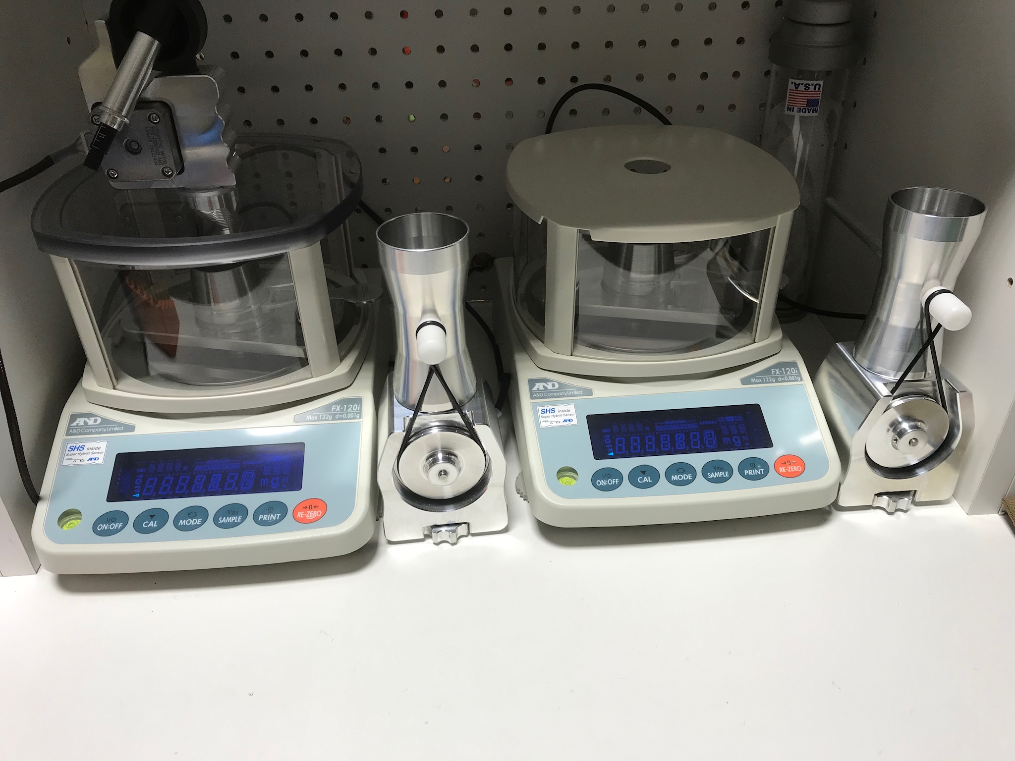

Here is my setup. I’m running two auto tricklers, one with a Sartorius Entris 64 and one with the A&D. I have them both mounted on a couple of marble tiles with foam between the tiles for vibration dampening. I run the Dillon off a separate bench to keep the vibrations from affecting the scales - which it doesn’t.
