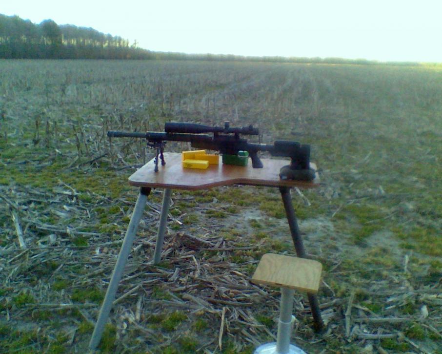

Thought I'd evaluate my new FTE brake that I purchased from a hide member. My past experience with muzzle brakes has been mixed with my main complaint being a POI shift of several mils. The crono worked great this time out and I can really see an improvement in Vel SD on my loads from using a chargemaster. 2650 168 smk 42.8 IMR 4895 Bartlien 22" MTU 11.25.
I shot Winchester, RP, LC, and FC in order to test some new dies and tooling.
This home made bench is a little shaky at 200 and I was shooting into the sun the entire afternoon. I'll fix that next time.
The first shot was the upper left so the POI shift was only a 1/4 mil. Made some scope adj's and tryed a group.
About 1.5" The FTE brake is very effective against recoil and I can start to se my follow thru.
All and all a good day.
Think I'll make a 0.2 mil target then it will work a 200 a little better.

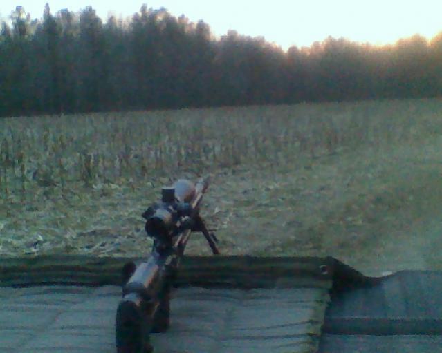

This week results. 250Yrds. Tryed using the back of the truck prone at 250yds. i think it was the lack of sun into the scope but everything seemed easier to see and clearer. Got a Varget load of 43.3 and 178amax/175smk running at 2610. It was getting dark and I wanted my Vortex PST in low light. All in all I'm impressed with the accuracy. I need an atlas bipod for sure.
