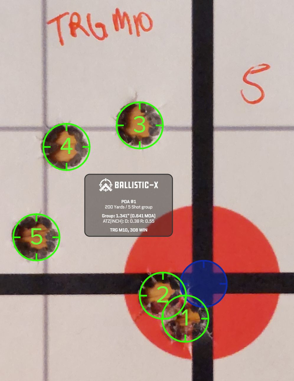

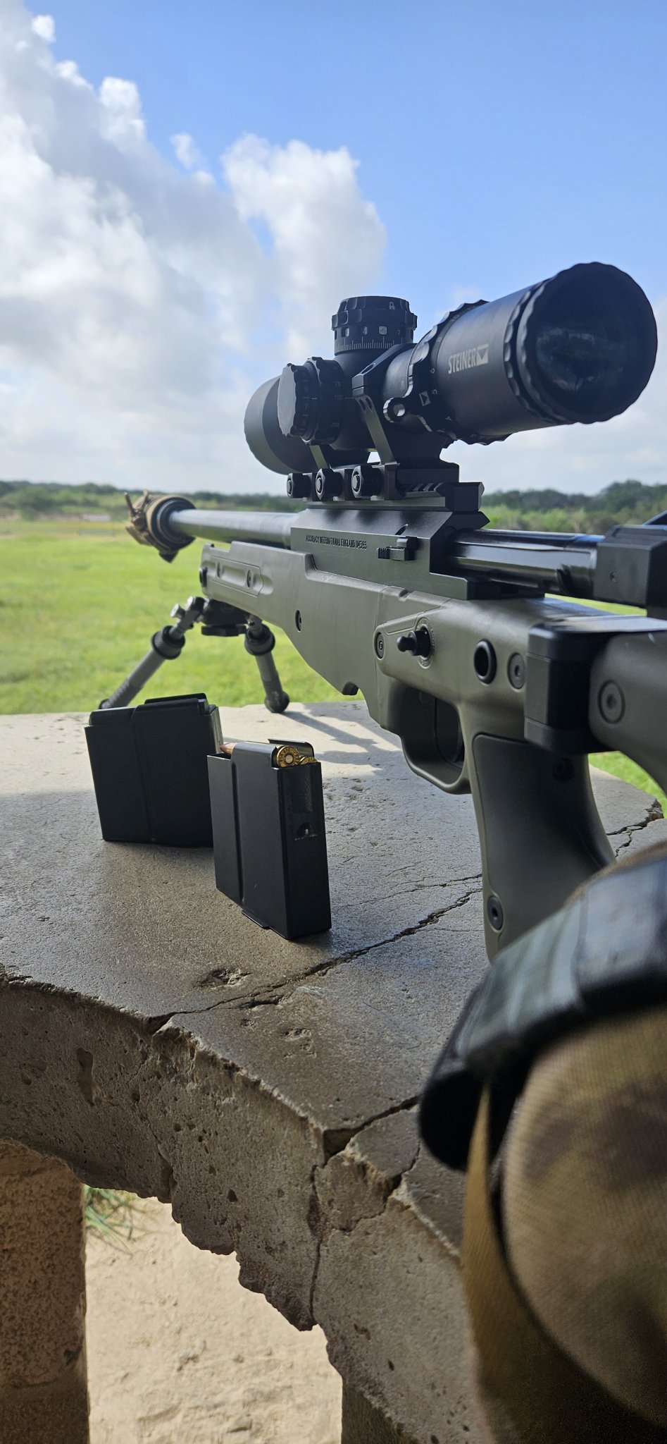

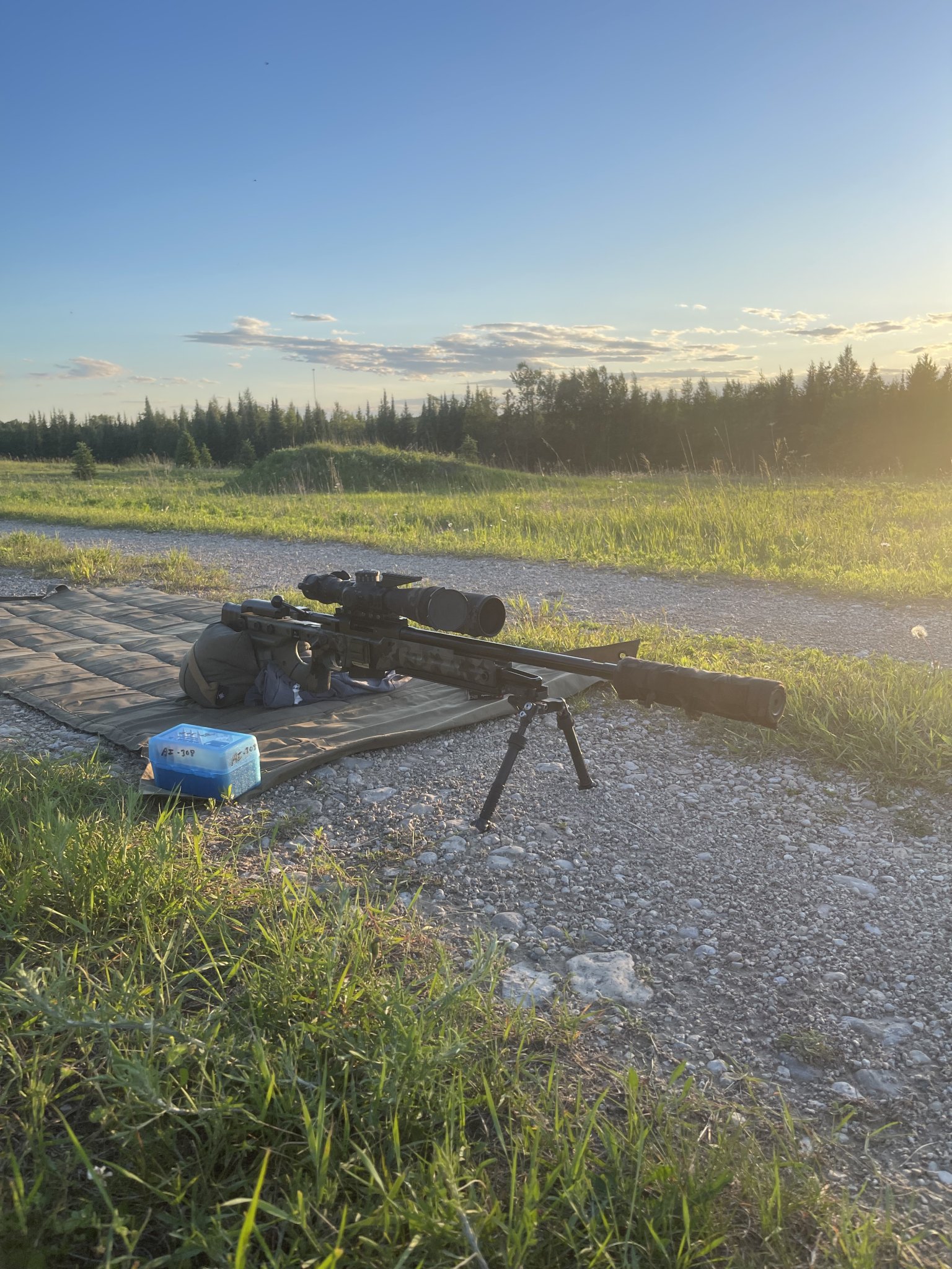

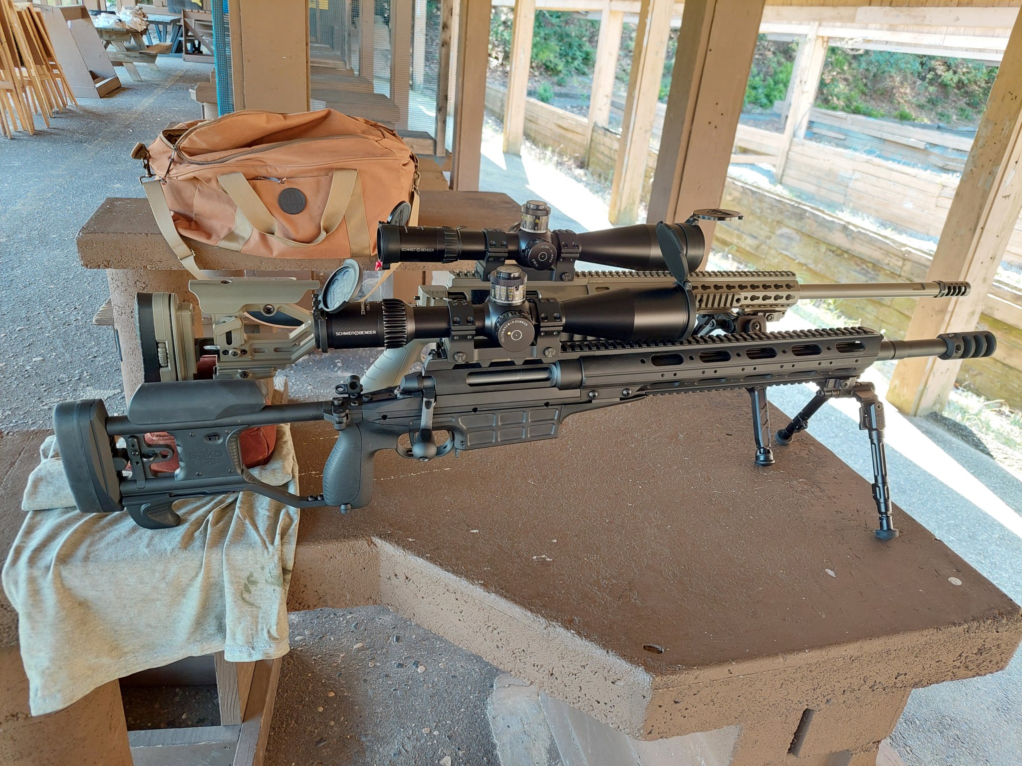

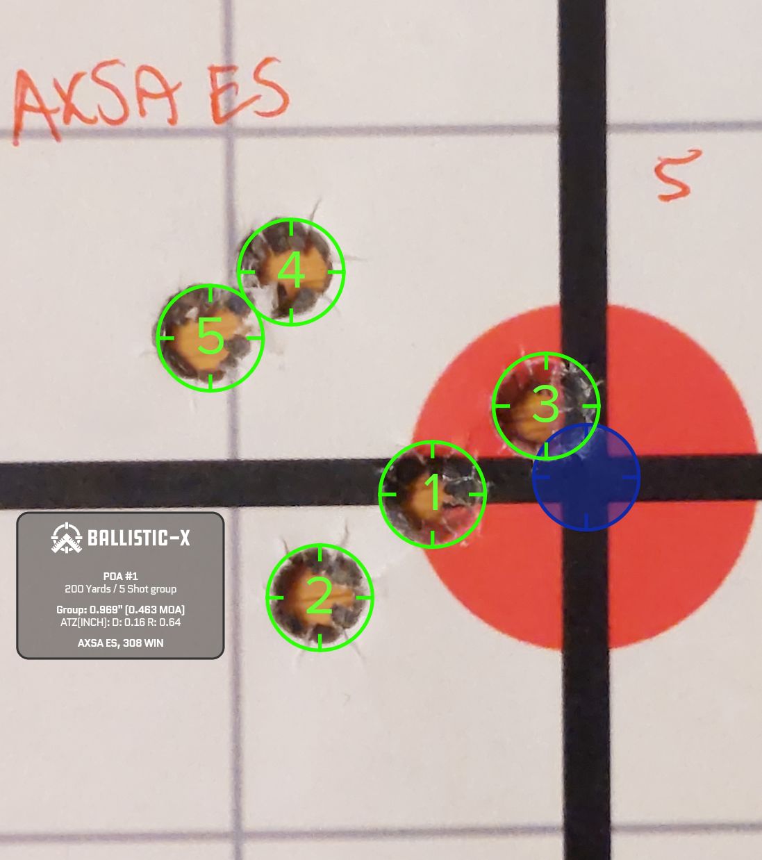

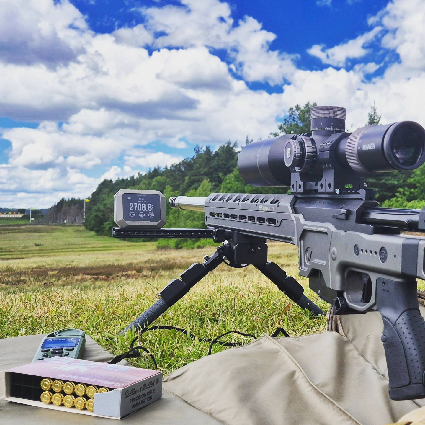

A little AI VS SAKO competition today. My bestest AXSA ES, how did that color go again @Krob95 ?

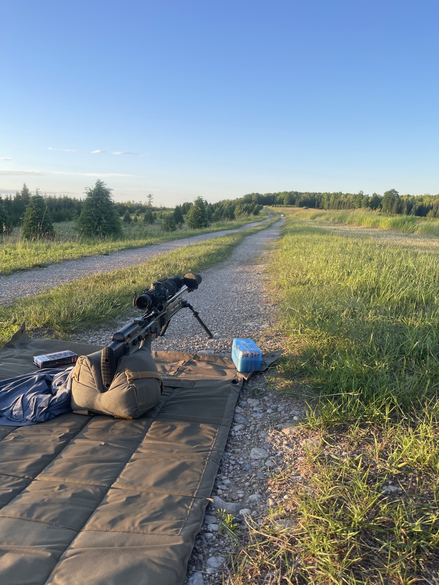

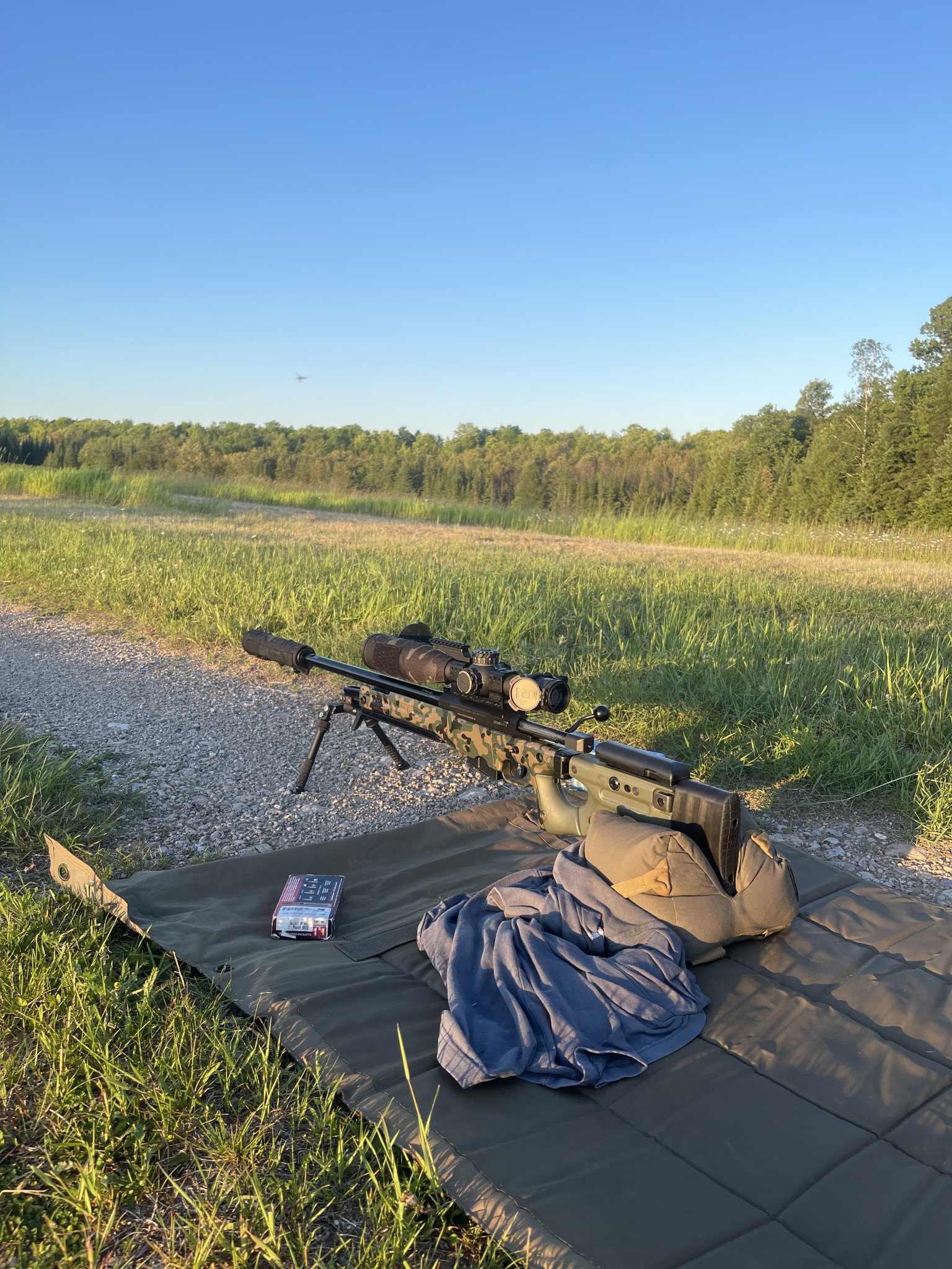

High winds and 200 yards.
The TRG with the shorter barrel didn't fair as well... though it only has 35 rounds through it.
How’re you liking the pmii 5-25 vs Tangent 5-25? Since you own both scopes. I’m deciding on a pmii 5-25. Or just get another Tangent for my next AI.

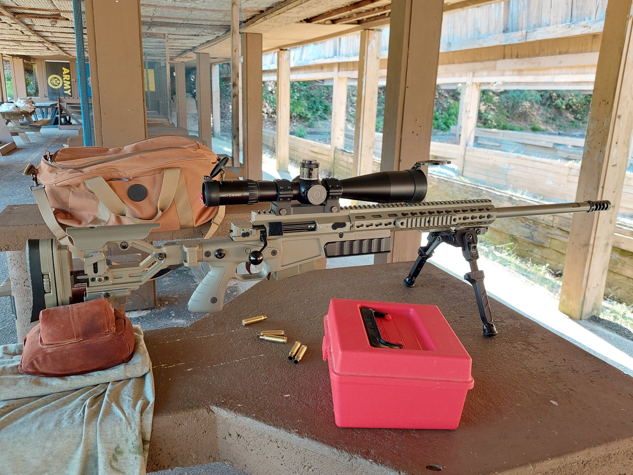

Where do you all get your Proof prefits?
It wasn't a prefit. Custom job done by JR Firearms in the UK.
I just put the same barrel on my AT. It is a hammer

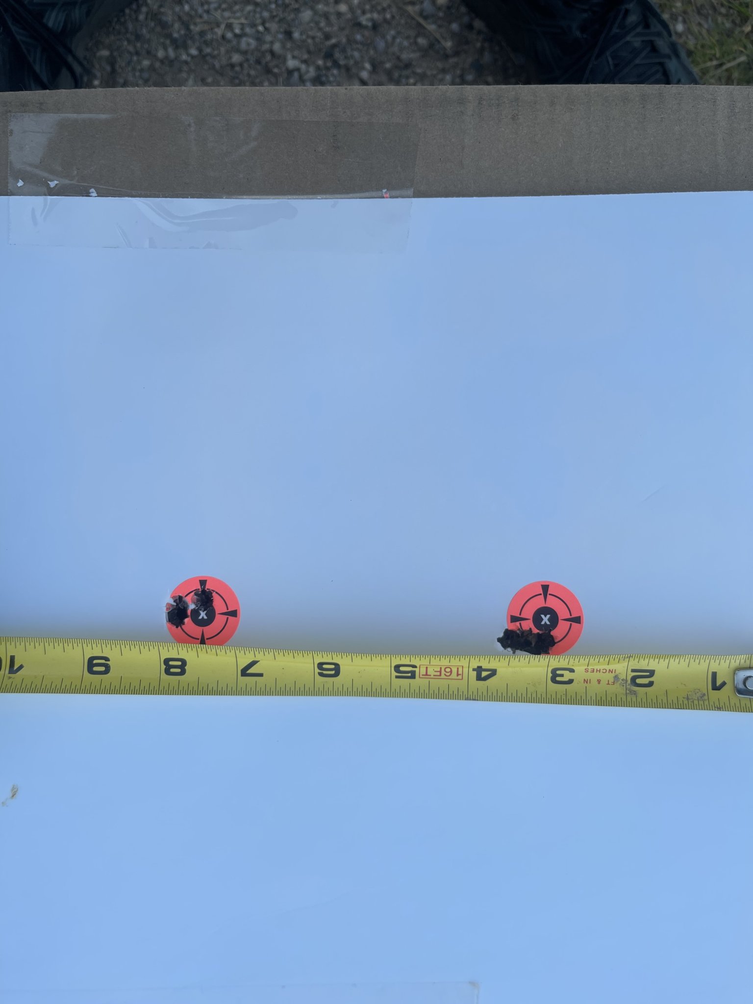

I've got an injured hand at the moment so controlling the rear bag has quite uncomfortable.. was still sub MOA at 900yds but nothing to shout about.
At 100yds it was .2 -.3 MOA groups all day... prior to my injury...

Comparing the s&b to tt (5x25), I'd take the TT for sure. But with the s&b 6x36 I was using yesterday on the TRG, I'd probably pick that over the TT 5x25. My old eyes need some higher magnification :)

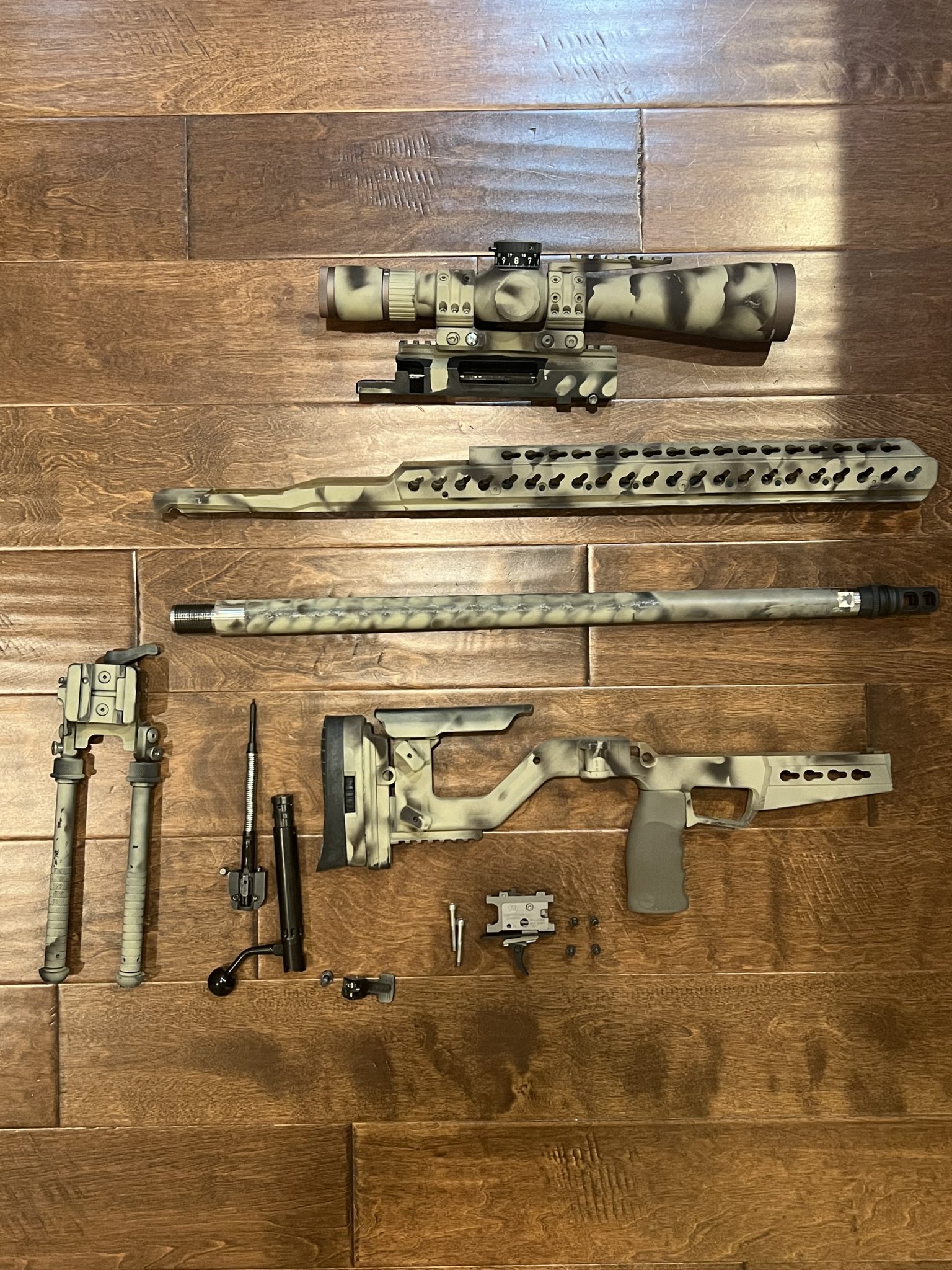

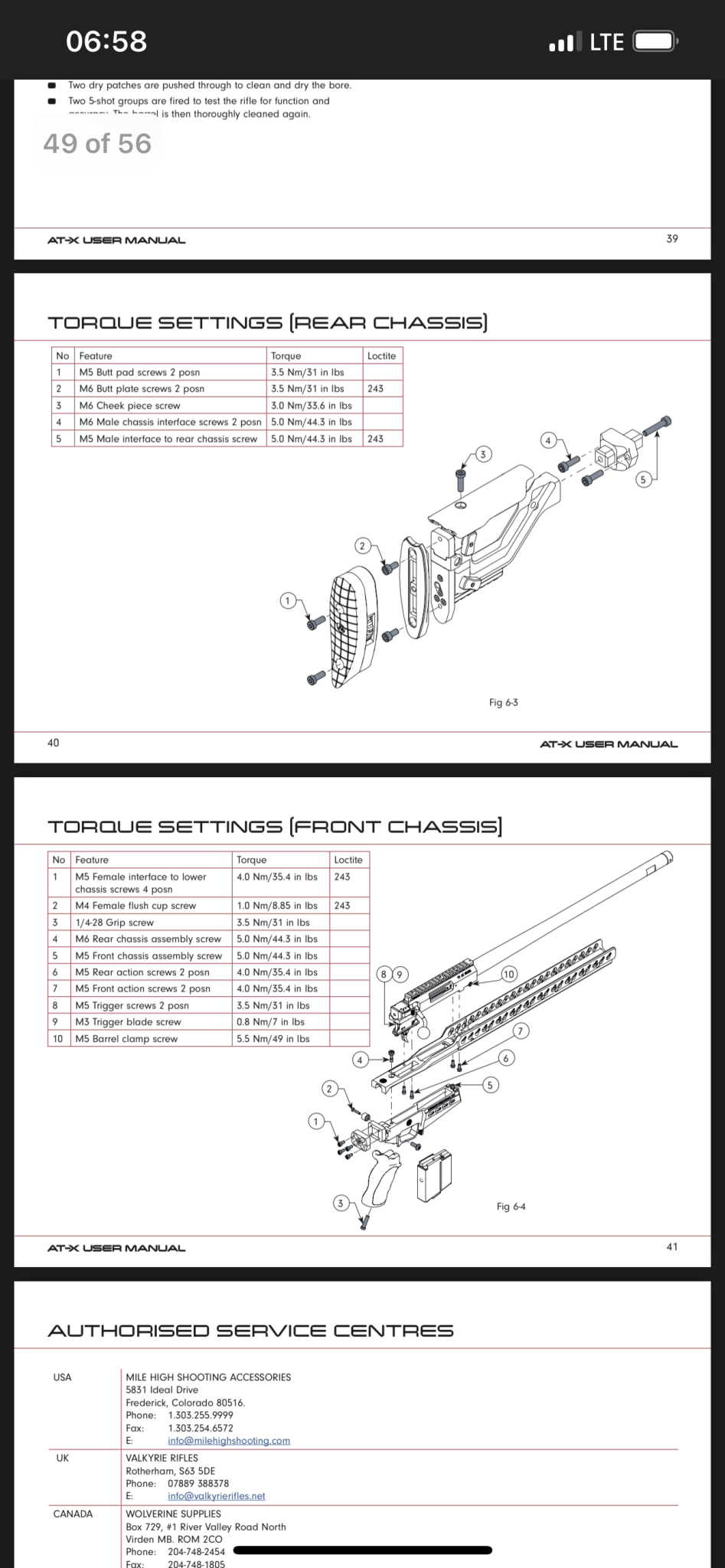

Has anyone with an ATX played with the action screw torque?
I plan on taking mine apart if i can find directions because the rear left screw was loosish and i never touched it before. I saw my proof barrel a tiny amount tilted to the left torqued to spec and went over all the bolts, that is when i found out one of the action screws was not torqued. It needs deep cleaning so i plan on taking it apart.

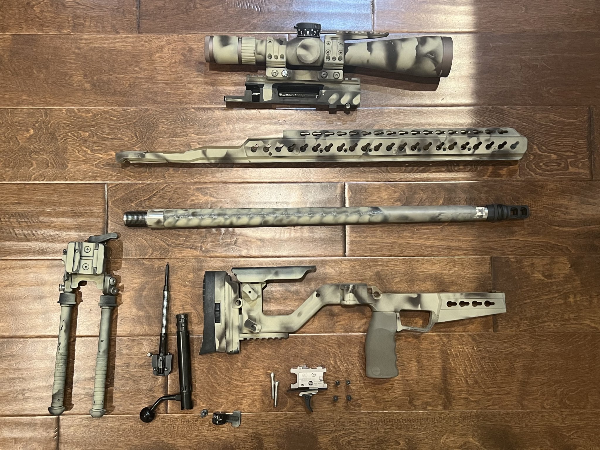

I was dm’ing Husky but here it is apart somewhat:
Remove barrel (not mandatory, makes it easier if you have a long handguard/nv bridge)
Remove rear chassis bolt.
Remove front chassis bolt
Remove the bolt behind the mag release
Remove the (whatever you call the hinge/sling thingy)
Rail/chassis comes off
Remove 2 trigger screws
Then remove the 4 action screws the action comes off
I just took mine apart and torqued it. The rear screws almost felt like they were glued in. Damn near gave up I was afraid to strip them. Torqued the action screws to 35 inch lbs per the manual
The screw behind the mag latch is just for the mag latch. Didn’t have to be removed to remove the action.

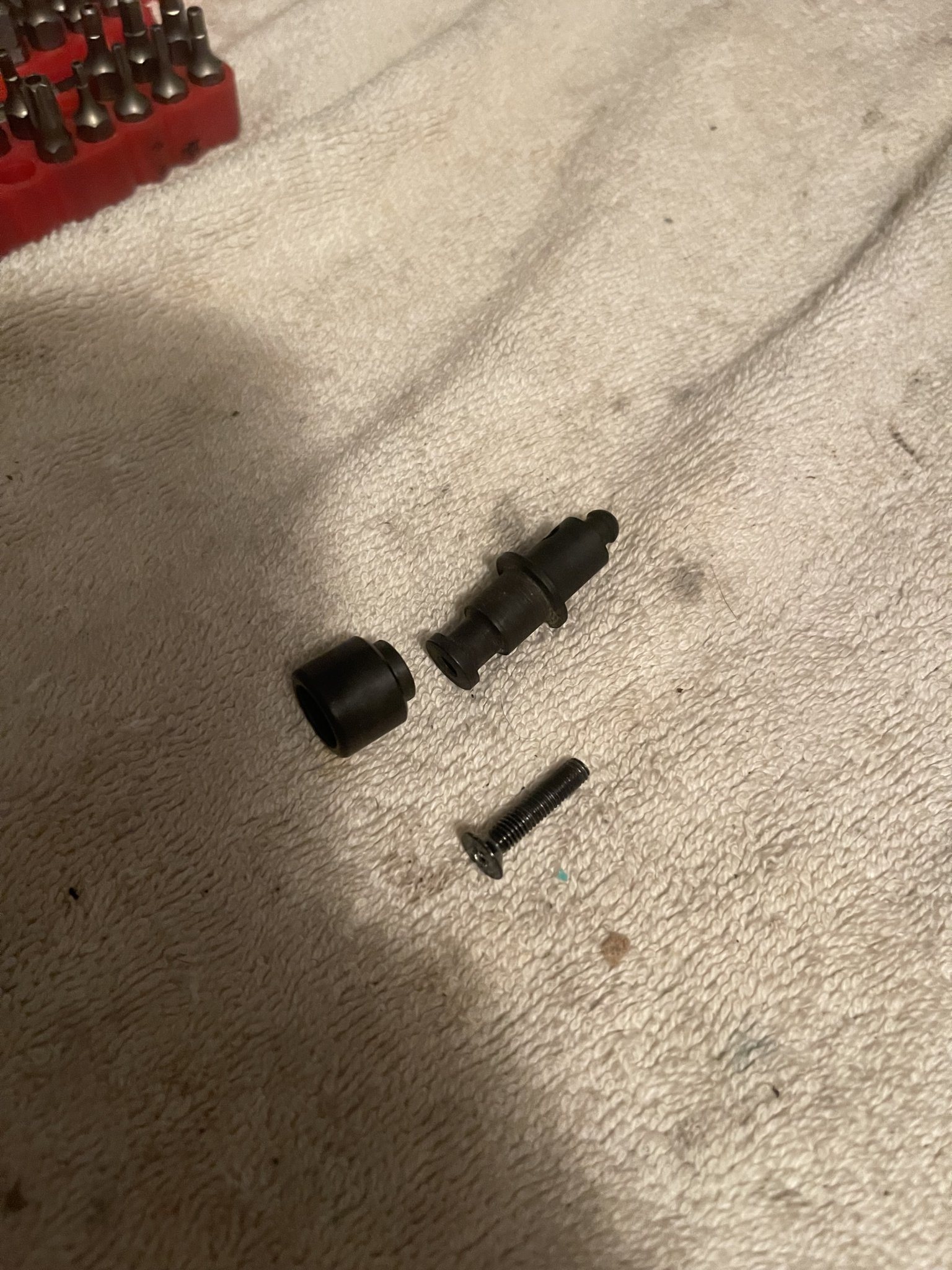

Also the sling stud/catch for the folder thing…ya you can remove or install that anytime. Doesn’t connect anything internal. Just that catch itself. It’s really easy to strip the head on….ask how I know 🥺 In my defense it definitely was not in there at 8 in lbs

The rear ones were really tight, and made good noise breaking loose. Front ones were hand tight.
I completely reversed that hinge thingy because it gets in the way of my hand and i don't rest my thumb on it. It is a mixture of parts from non hinge and hinge screws. Left side is the sling mount, right is flat bolt head.

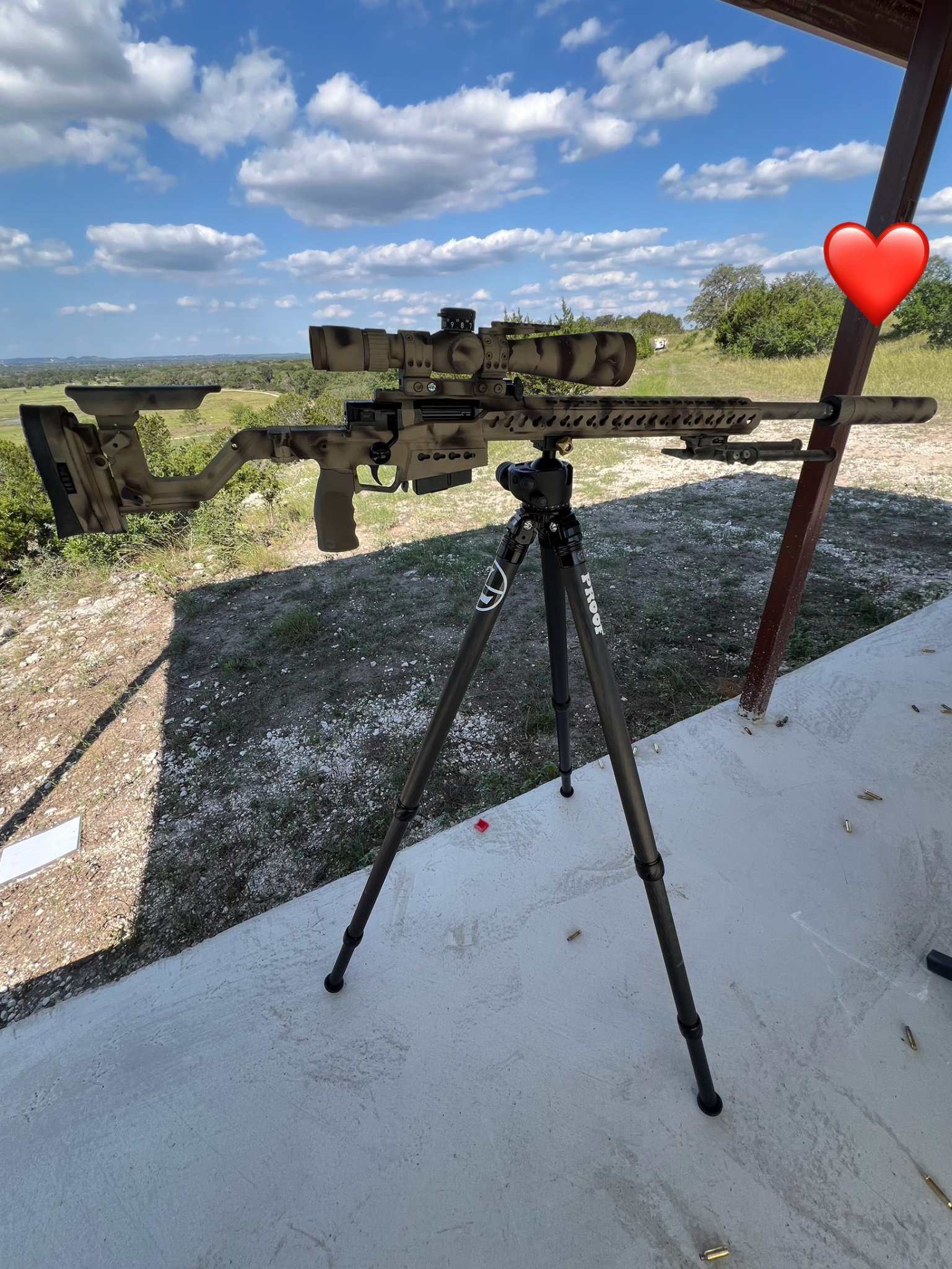

How did you do that paint pattern? I really dig that.
This past weekend was our monthly club match at Precision Rifle Queensland in sunny Australia. As always I was shooting my AT-X. This month had the 6 Creedmoor barrel spun on. Unfortunately, the wheels fell off for me in the last two stages and I ended up with 6th overall. When I got home and inspected the rifle, I realised the action was loose in the chassis. That would explain why the last two stages I couldn't hit much. It might be time to bond the action like my old AX.
Did you ever double check the torque when you first got the rifle ? Just curious.
