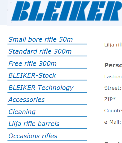

BTW, we, meaning Border, made most of Blieker's barrels before they started rolling their own. so there are some jewel cut rifle bleikers out there
Interesting. I thought Bleiker used Lilja? Thats whats on their site..
Pretty sure Grunig and Elmiger do cut rifling in-house tho.. and Id have to imagine their rifles are just as nice as Bleikers.. for some reason they dont seem to be as popular/prominent as Bleiker tho..
Maybe Bleiker got out of the bbl game, know they were working on getting into it just after I left Scotland. Grunig and Elminger a definite ex customer. Glad to see them trying to roll their own, maybe Geoff helped them out
