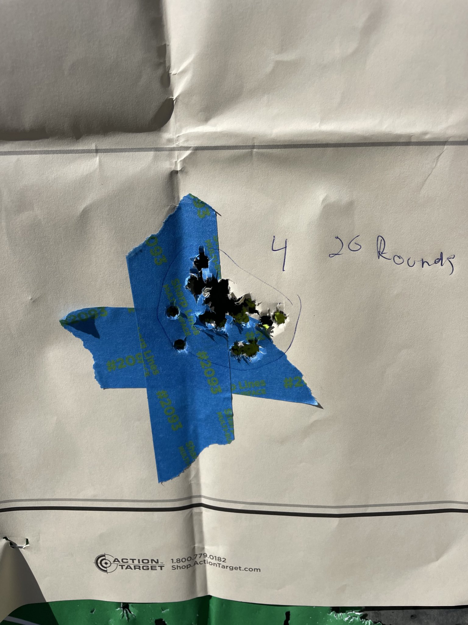

I recently picked up 400 of the 77gr OTM that was on sale for Easter. This was 20 at 100 from a brand new build with a 20” Kreiger barrel spun by CLE. This was shot at 8x with a Trjicon Credo 1-8x28.
Hopefully the SMK’s provide similar or better performance once I can get ahold of some. I was quite happy with how the OTMs performed.

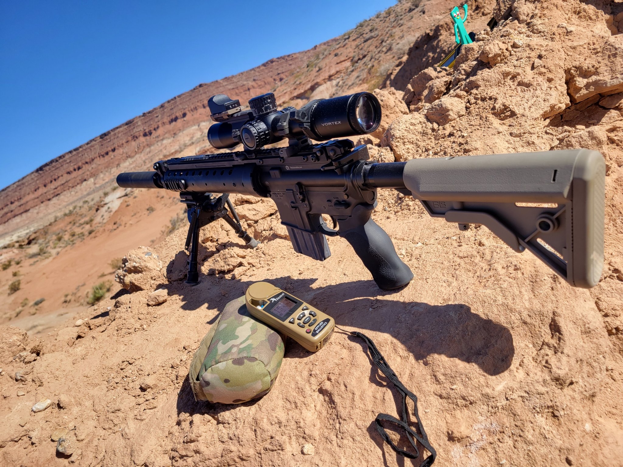

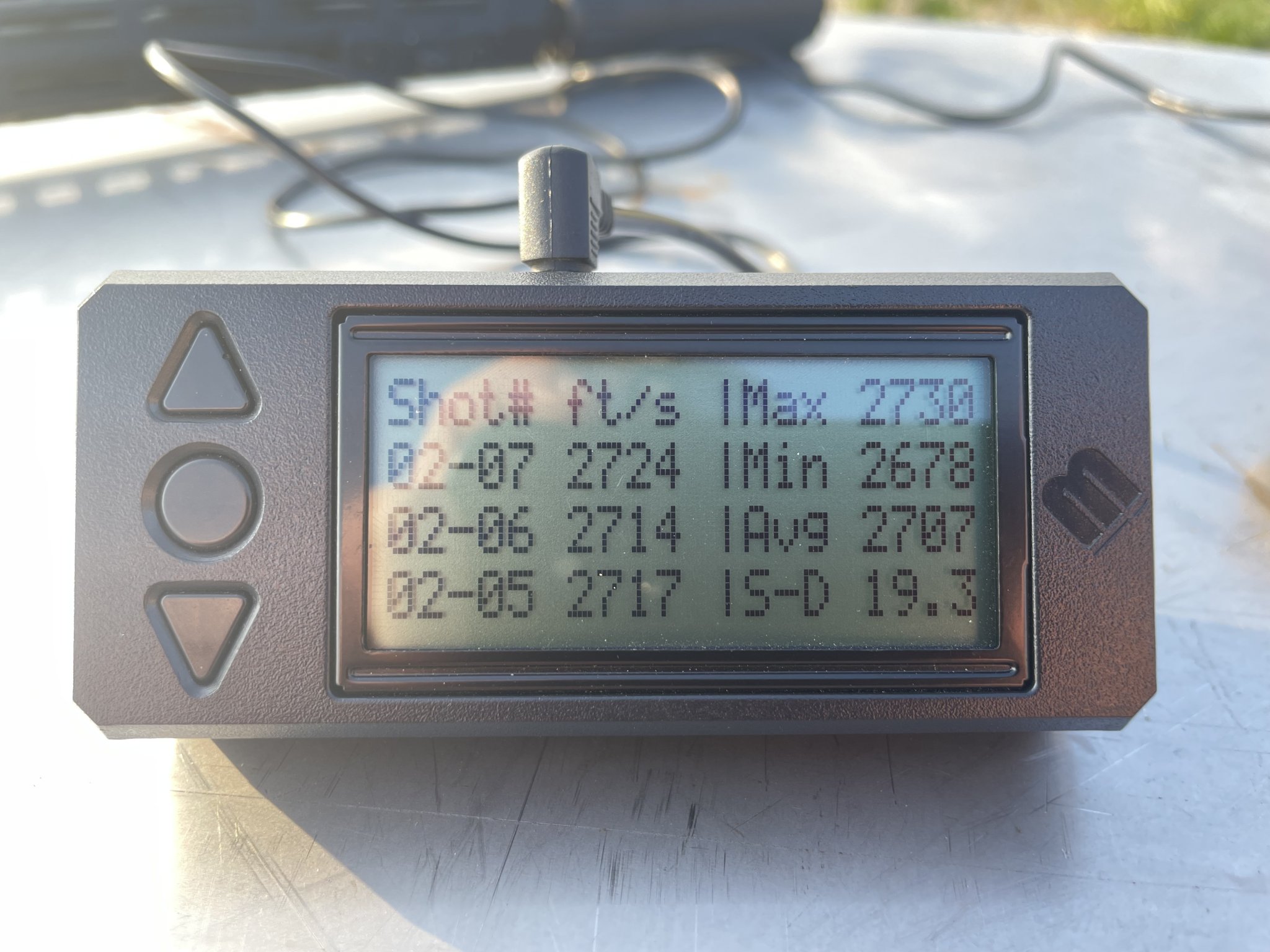

Took the 75gr out to the range with the mk12 Mod H. Grouped okay, need to go at it again today. First shot was 2915. Had to delete that one. Also had one blown primer. As i said if they can get the QC down it’s going to be hard to argue with for the time on the range and behind the gun. Surprised i was hitting 2700 with my 16”

So you just delete data from a string if it fails to meet your preconceived notions?
Yeah i would hope that is an oddity of the chrono or the load. 200fps over advertised seems a bit off. I’ll run another string today to see. Also it would surpassed my preconceived notions at that velocity not failed to meet.

Shoot a statistically significant string over the chronograph. The fact that you had a blown primer is a huge problem, particularly since this isn't the first report of blown primers for this company.
No doubt. Which is why i mentioned the fact. One data point that far out of the rest of the set one single time is spurious data. If it does it more than once, ok, time to look at it differently. But people throw extremes out of data sets all the time. I’ll run another 10-20 today and get a pic.

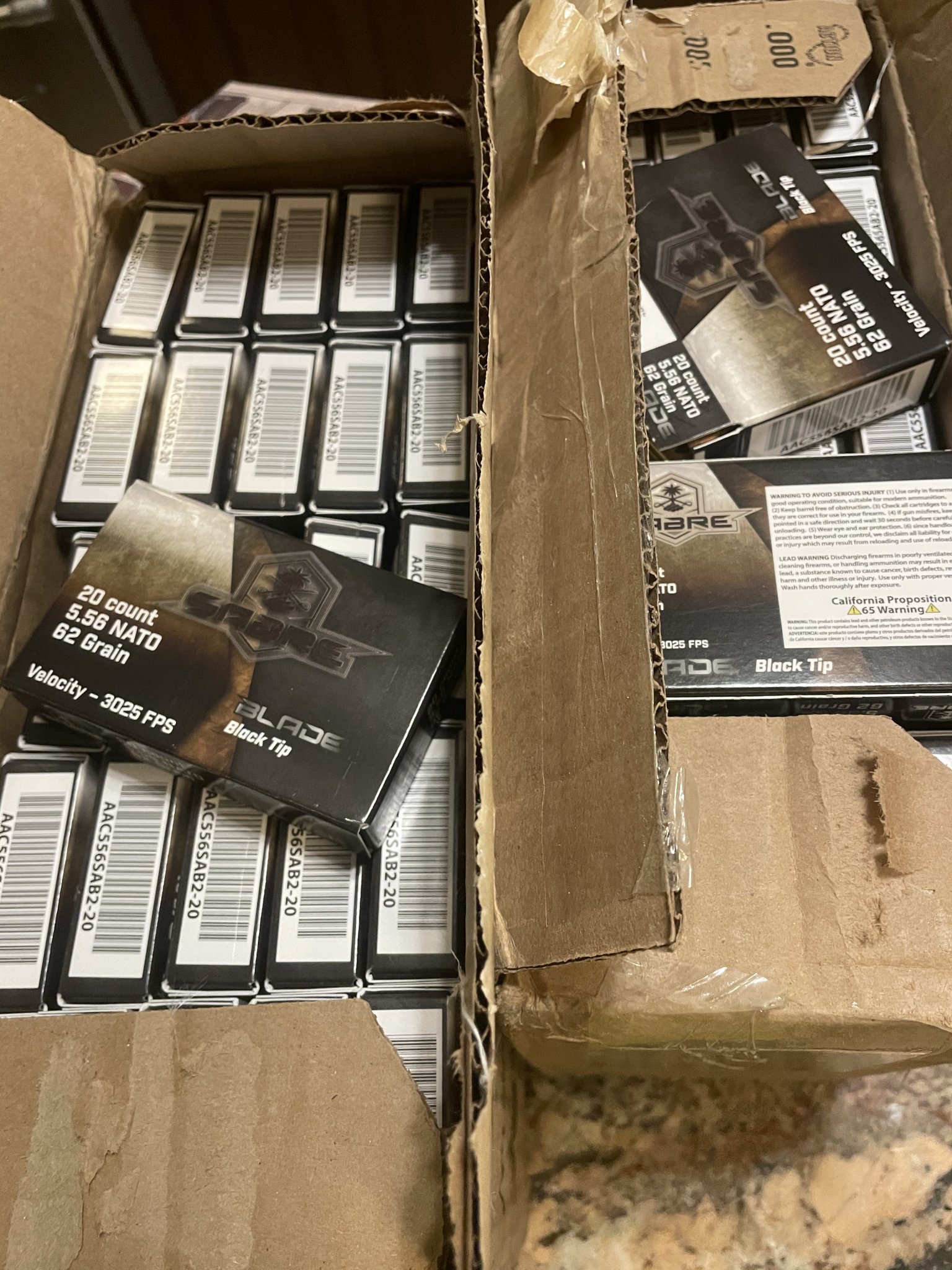

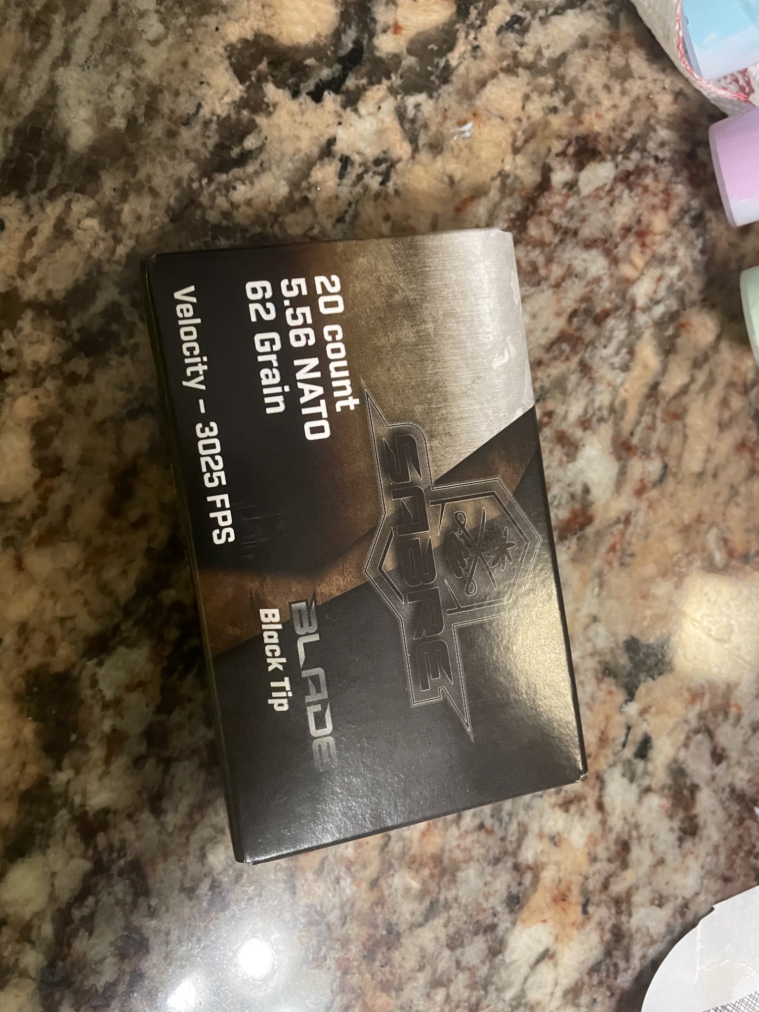

Anyone have info on their Sabre bullets? Looks like their version of a VMax that comes in 55, 62, and 77 gr. May be an interesting predator round too

What rail are you using? Nice rifle I have a similar using WOA barrel but still undecided on optic.
It's this complete upper receiver

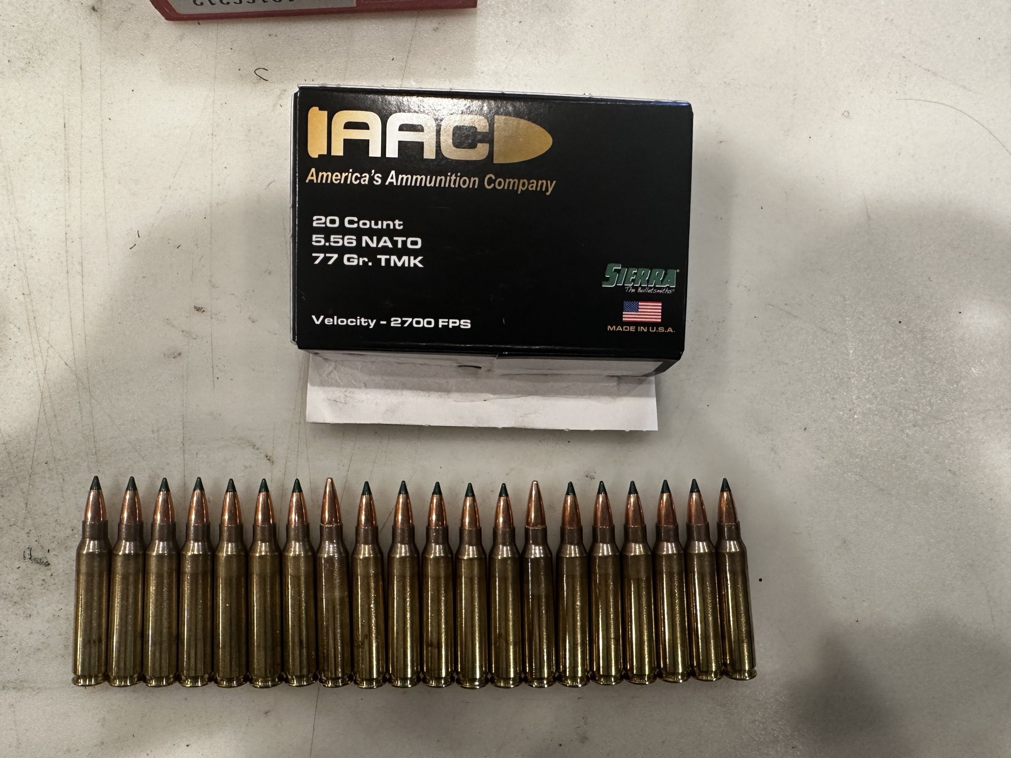

Got to shoot this ammo yesterday over a chrono and I'm still sorting out some accuracy items before making too much of a statement there.
20" RRA Predator Pursuit barrel threaded and suppressed over 11 shots of TMK ammo averaged 2754 fps with an ES of 128 and SD of 45. Not great, especially considering this ammo should be supersonic to over 950 yds at sea level (nearly 1k at my DA).
My only comment on accuracy is it was less consistent over the 11 shots than my reloaded 77 SMKs over TAC (which has been 1 to 1.5 MOA in other rifles). I had some of those reloads and they shot better too. My assumption is since the TMK is more sensitive to seating depth, they were not as forgiving as the SMKs.
Overall, I really hope AAC can get their QC dialed in but I'm not holding my breath. I'd guess they will find the most success with their in house OTMs or traditional SMKs since they should be more tolerant of varying seating depths. For me, I'm probably going to test their SMK / OTMs further and hope they get the TMKs figured out. Until then, the IMI stuff at less than $1 per round is probably going to be my go to
