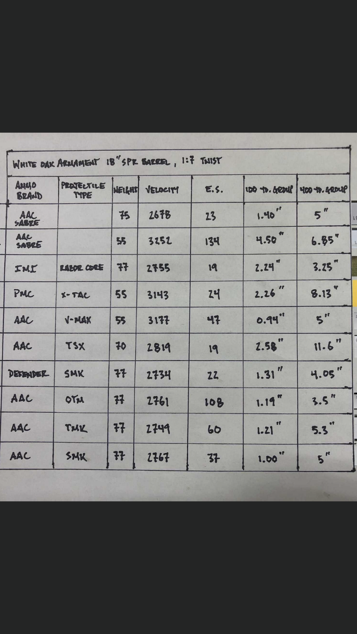

A friend and I went and tested several of the lower priced ammo flavors. AAC 77gr. SMK and 77gr. OTM were two of them we tried. We shot a 5 round group at 100 and 400 using an 18” and a 14.5”.
18” WOA SPR barrel
1:7 twist
18” 77 SMK 2767 FPS ES 37
100 yards: 1.00”
400 yards: 5”
18” 77 “Precision” OTM 2761 FPS ES 108
100 yards: 1.19”
400 yards: 3.5”

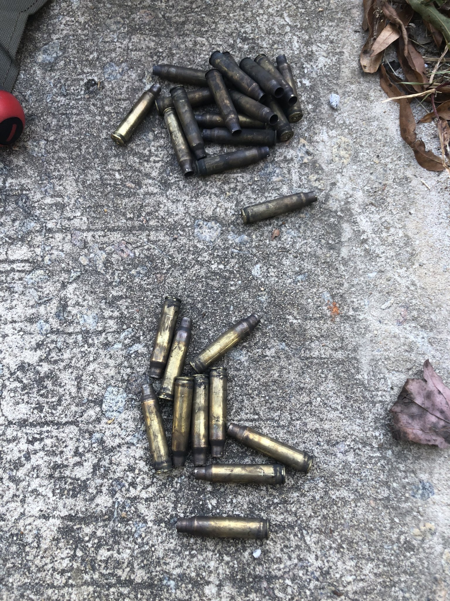

I will say this seems to be dirtier than other stuff. I shot some of it then followed up with some M193, all suppressed. The AAC brass i picked up was filthy while the Lake City brass was dirty but still brass colored. Will add that pic below as well.
I added the whole list of what we shot. The Precision OTM did surprisingly well for $11/box.
18” WOA SPR barrel
1:7 twist
100 yards: 1.00”
400 yards: 5”
100 yards: 1.19”
400 yards: 3.5”

Thank you for sharing all this great info.
Super interesting results 100yds vs 400yds.
And not doubting your results in the slightest, but any idea / speculation as to how the groups "improved" ( MOA wise ? ) at 400yds vs. 100yds for some of the various rounds fired ?
Or am I misunderstanding something ?
And wow... that is some filthy AAC brass. I still would like to know what powder AAC uses.

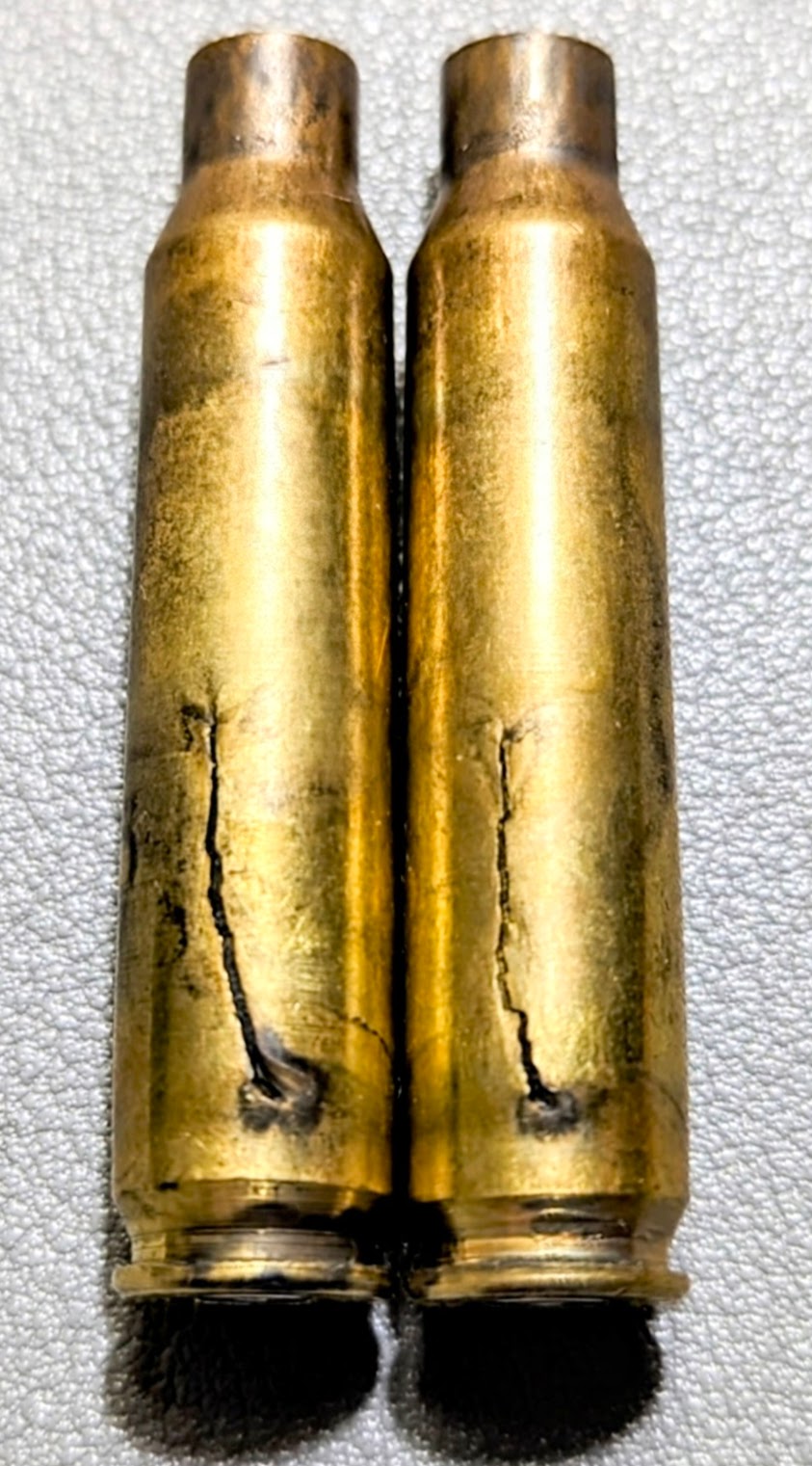

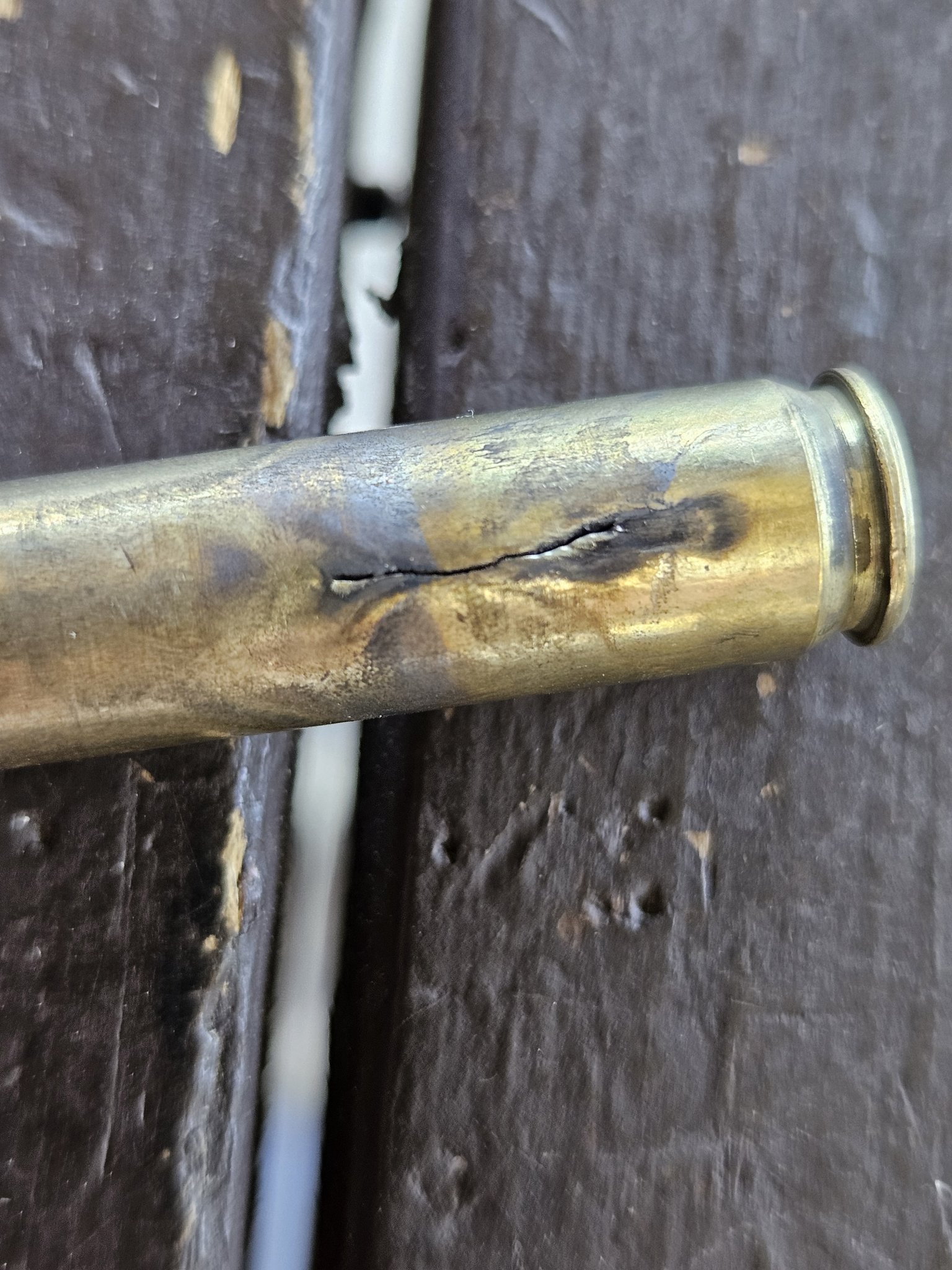

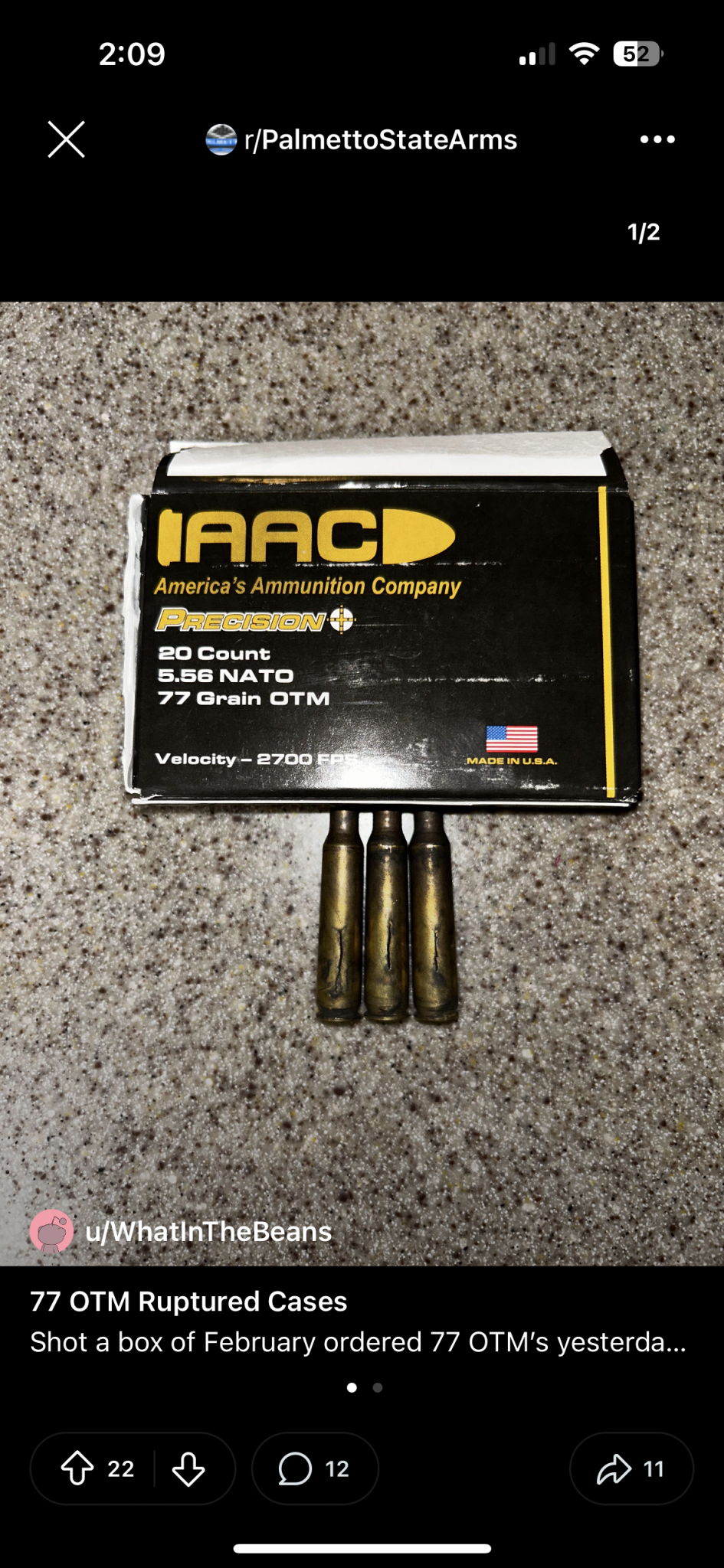

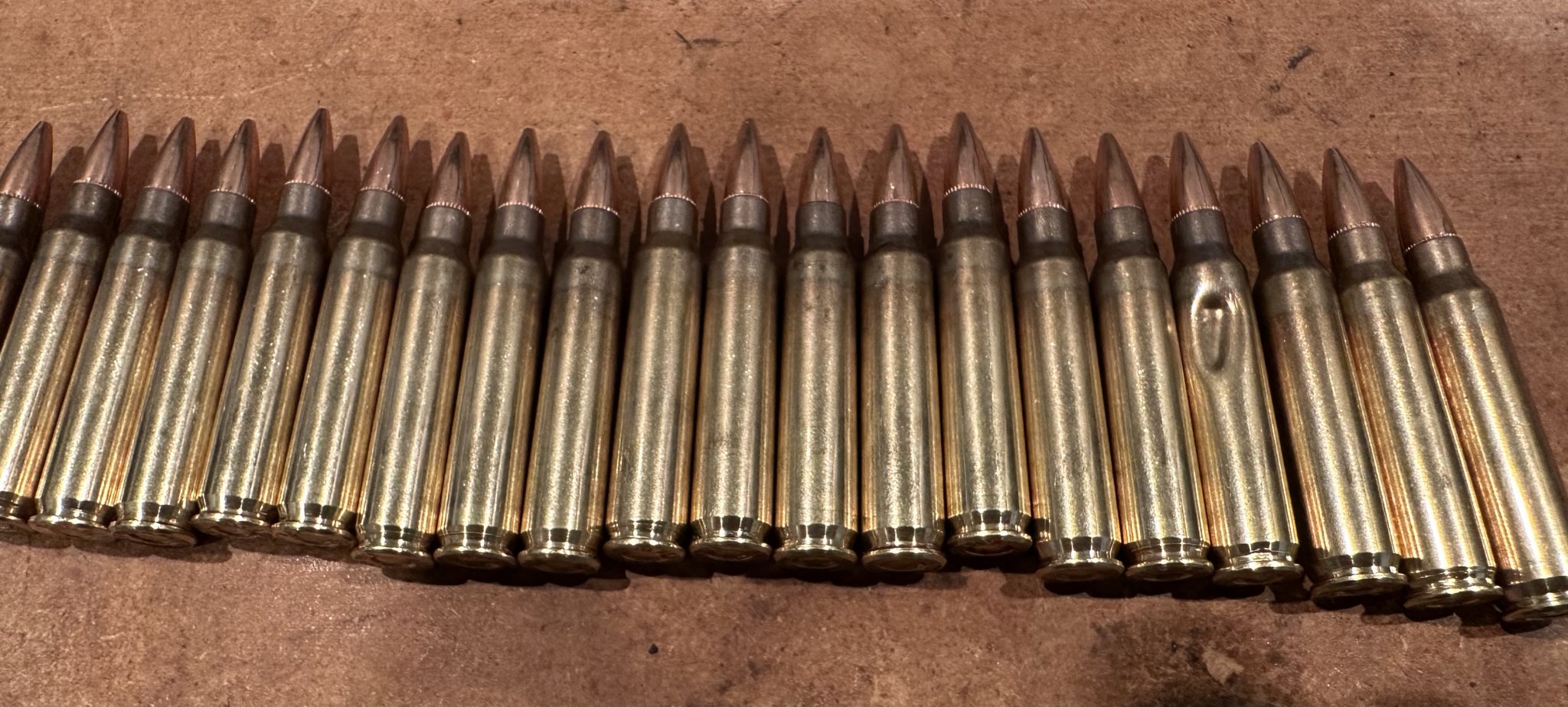

I don't have a chrony, but just had this case rupture with the 77gr OTM.
Bought on 11/21/23
Lot # SCL1CK131
In my bolt gun the 75gr has been the most consistent.
I keep having fliers with the 77 SMK.
The 77OTM has been good for the cost, but my rifle prefers the 75 for the same cost.
I have been shooting the 77 otm load quite a bit and it performs well for me. 600 is no trouble for it. Had 1 primer come out so far but cases are all good. Have heard from other people the lot they got was slow so might be some issues with lot to lot performance.
Makes a guy wonder if the brass is a bit on the brittle side. Wonder if the material supplier is sending material on the hard side and after working it it makes it out of spec and ruptures because it’s too hard and not pliable enough. Rockwell tester?
Just put some scotch tape over the split and load away with it. There was an arms room in the building I worked at when a contractor and when the contract was winding down one of the gunsmith’s brought in some split cases and a reloading setup and reloaded and fired the case 8 times and just laughed because it was fine. No they weren’t run over a chronograph or grouped but they were just shot into a snail with no ill effect to the bolt gun.
Yeah, my split case didn't even produce a flier in the group I was shooting.
No marks in the chamber.
I sent PSA an email, but havnt heard back yet.
It's odd it seems like it's always the 77OTM, not their other loads.
I saw some AAC 6.5CM ruptures also when searching.

Had a couple of case ruptures the other day shooting from a .223 Wylde bolt gun. It was actually was putting up a sub 3/4" 10 shot group until I realized what was going on.
It was the in -House 77 OTM? Do you remember about when you purchased it?
Mine was in a Wylde chamber bolt gun too, and no effect on the groups either so I would think weak brass, not over charges?

I contacted PSA via their website, but never got a reply about my case rupture with the 77OTM)

It's the 77 OTM...lot SCL1DC041. I have been buying it here and there and could not tell you when I got this specific lot. I noticed the first rupture when the case didn't eject because the pressure blew out the extractor (Savage action...they do that on events like this).
I thought it strange and put everything back together and threw my chrono on. Fired a few more rounds and got another one. I don't recall what the velocities were, but I remember not considering it that hot...I have loaded rounds that were hotter. Packed it up and called it a day.
Threw my borescope in the chamber and there were 3 burn marks/pitting, so I must of had a 3rd one and not even realized it. I am guessing the brass is just not that great????
Interesting you could see marks in your chamber. I could not decern anything really different in mine.
Its odd to me that all the ruptures I have seen online have been the 77OTM.
Wouldn't you think AAC is using the same brass (That they make apparently) on all their loads? :unsure:
PSA never answered my email, so I shot another box of the 77OTM today with no issue. Guess I'm just gonna keep shooting it. lol
I can't believe PSA makes different brass specific to certain 5.56 loads, It might just be a batch of "bad" brass.
Not trying to minimize the issue, just thinking out loud.
I have over the years seen fired brass like these from numerous manufacturers.
Sometimes a bad over-sized chamber can be a issue as well, one from a worn out reamer.
Reactions: iOdysseus
I have never seen new brass blow like that except in oversized chambers. If the chambers are correct I think the brass is just bad
Only time I see brass go like that is resized to many times or worked to much from using SB sizing die. I think AAC has a problem in brass making
