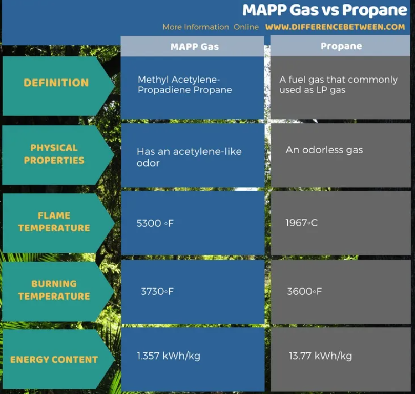

I have bought an AGS annealer
What gas is best to use annealing, I can get heaps of the yellow Mapp gas cans from work
MAPP and Map/Pro burn hotter than Propane.
Both will work, but I would add that when flame annealing you want to be very consistent and when things happen too fast the speed can make this more difficult. Giving yourself a little longer, means that any small error in time has a smaller affect on the results. YMMV
This is something that many people miss. Too many times people look for speed, but with that comes a loss of consistency. Except for timing, it is better to move the flame nozzles back and go for longer.

I will get some blue cans, I gave the MAPP gas that I have plenty of a try on old scrap brass attempting to find the correct timing, 4 to 5 seconds in the flame was not enough had zero glow and 700deg templaque had not reacted, 6 to 7 seconds resulted in a cherry red and was over done, I may have had the flame to close but I thought was good positioning
I understand the lower temp blue cans will give more time to get it right, I just wanted to try what I had freely available first
Thanks for the responses,
