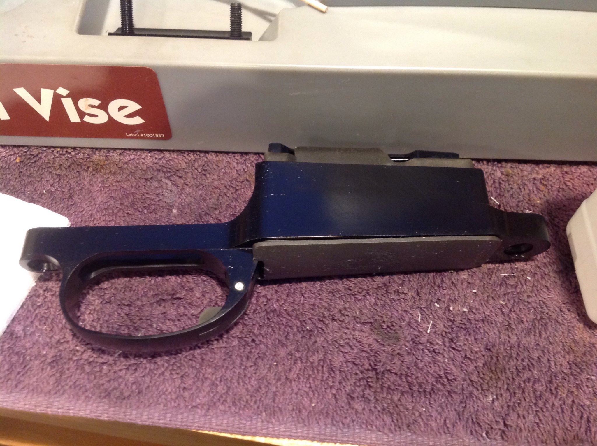

    I’ve had quite a few lowers done by Dave Montana @ Hunter Rifle Works. He does great work! Knocks it out fast and has really impressed with his ability to get the right shades of ano depending on the era. Of the build.

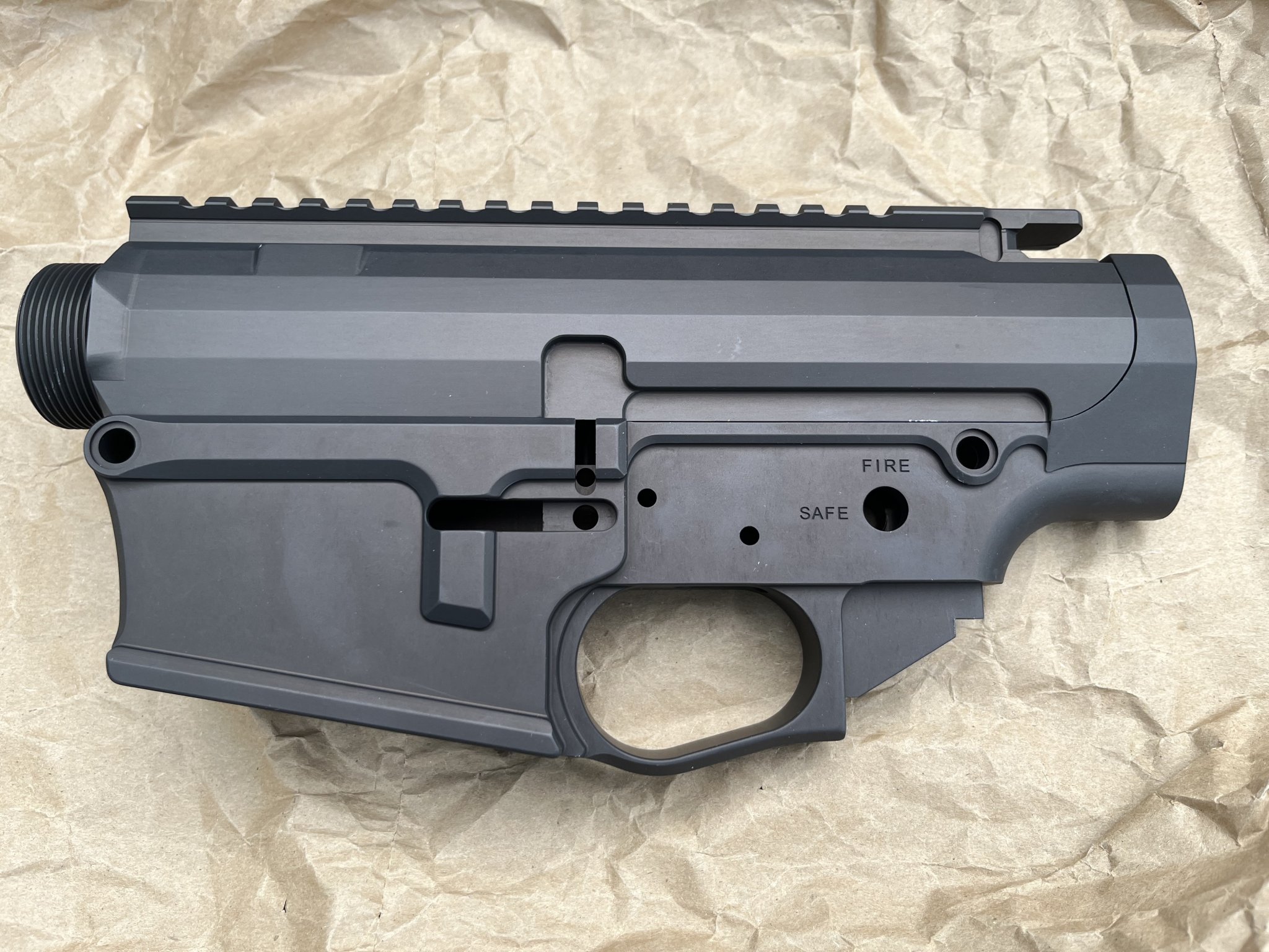

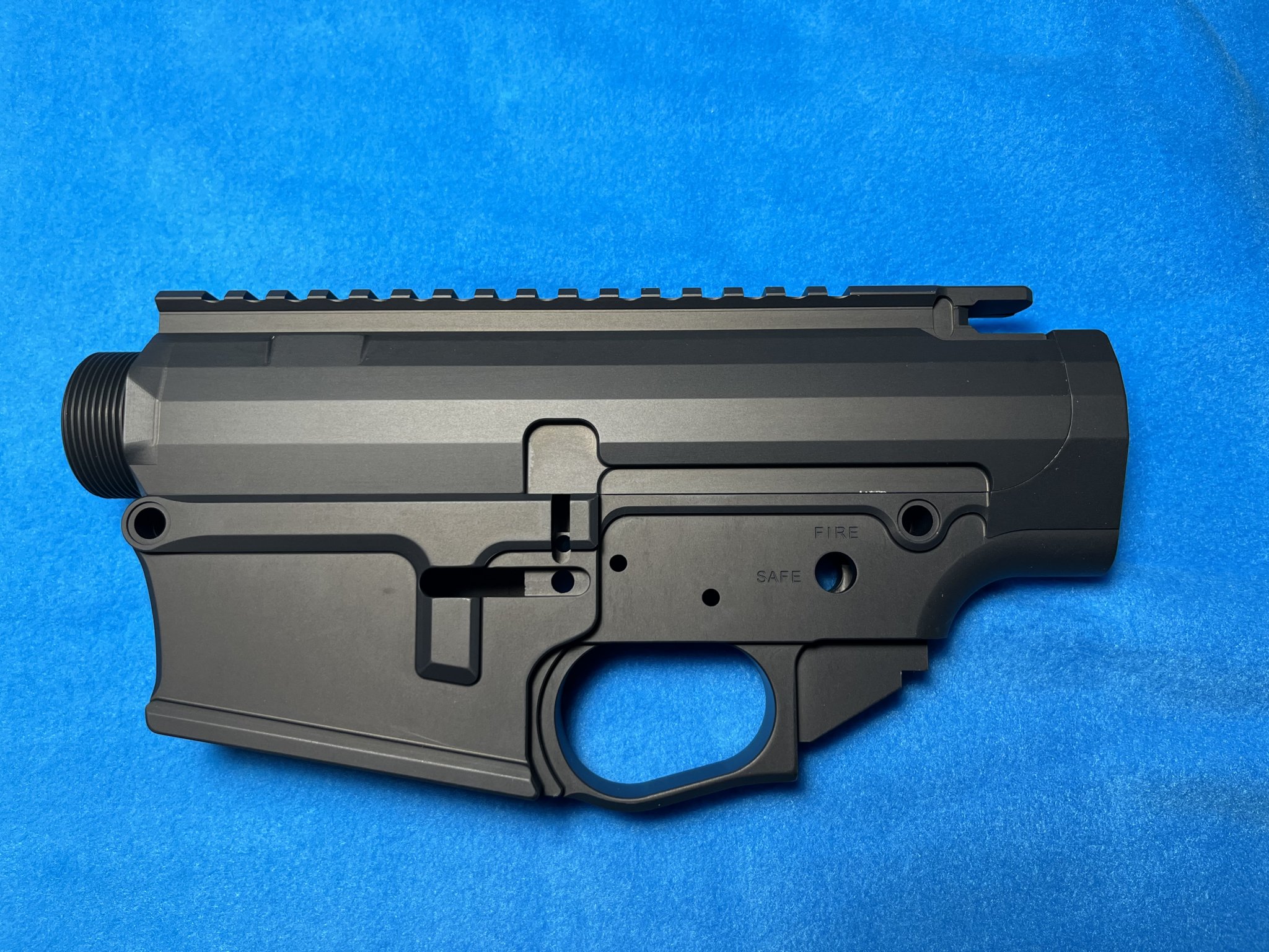

    On the receivers there is a slight greenish hue which I am actually okay with. The receivers were 7075. The KAC URX 3.1 is 6061 and doesn't have as much green hue. The receivers were machined billet and I sanded them some to get the machining marks out. The blasting that they did took out all the imperfections. I am very pleased with the results. I'll be busy this weekend putting them together. It has been a long process to get to this point. Hope this helps.
    AS SHIPPED
    RECEIVED

    UPDATE: The previous pictures I took were under incandescent lighting which showed a slight greenish hue. I just took a picture in natural lighting outside. It is not as black as I had hoped and it has a slight brownish/bronze hue. I will call them later today to see if anything can be done and provide another update. I don't necessarily mind the color, they are going to get beat up some anyway.
    I see the “brown” some….but probably only cause you have me looking for it.
    Reactions: DustBun

    I have not. I was going to use one of my silicone cleaning cloths on it today and see what it does, then I will try some oil. Thanks. Although they are not quite as black as my other rifles, they did come out good. Vegas Metal Finishing did a good job.

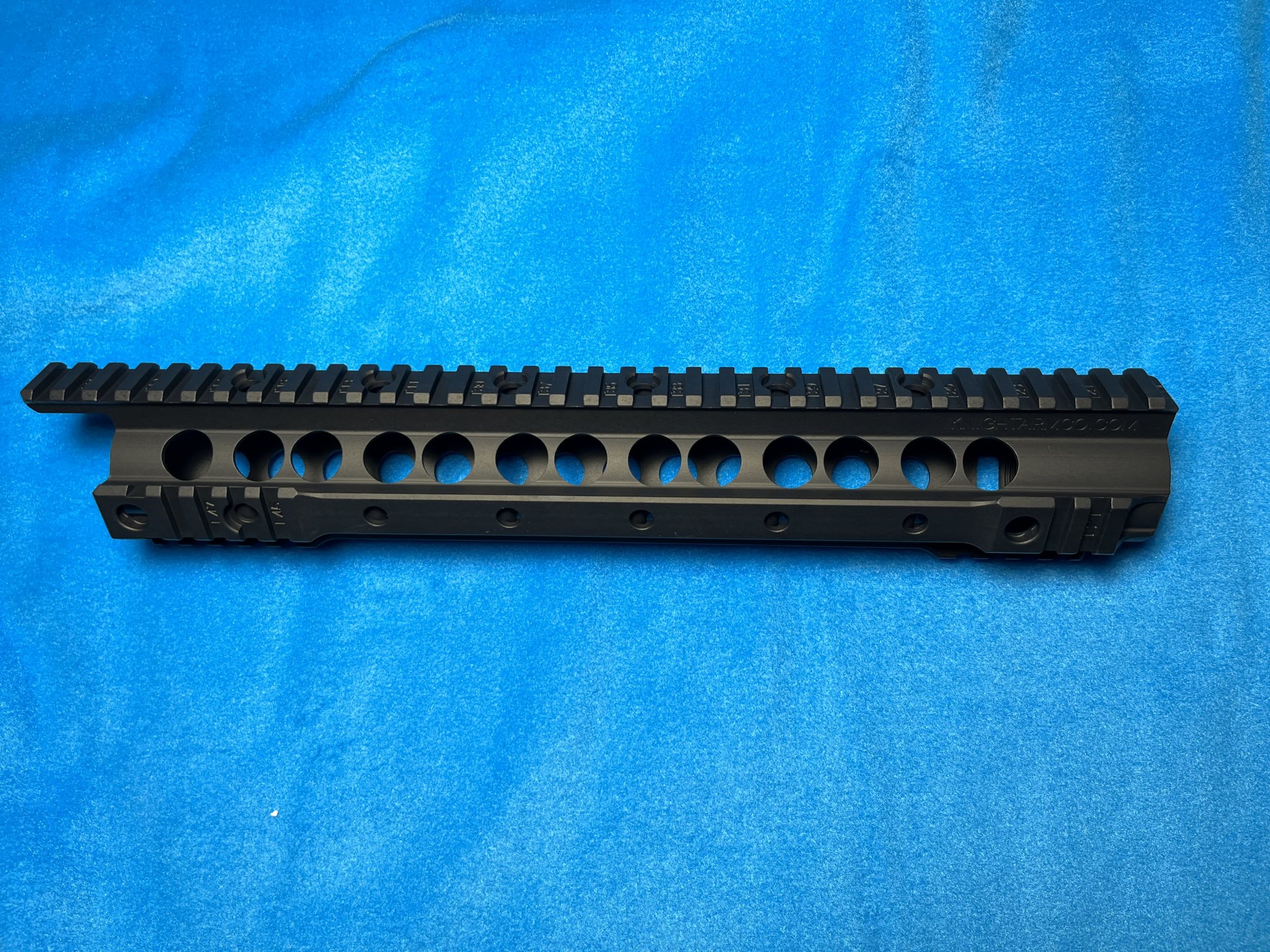

    Las Vegas Metal did right by me....

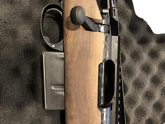

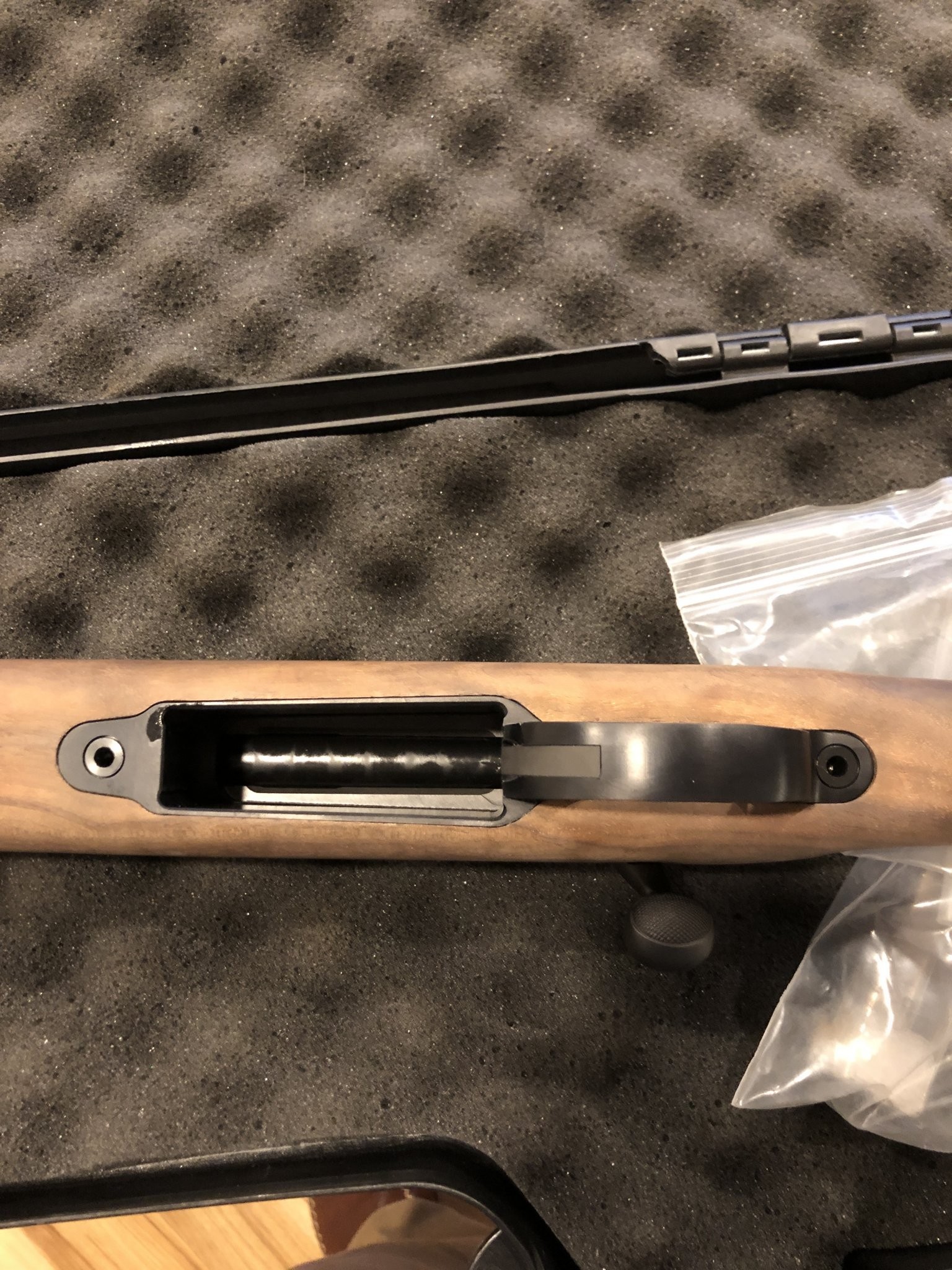

    A little shinier than I desired but not too far off from a 60s Remington look.
