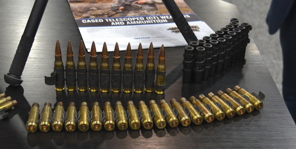

In regards to ammunition...It is 2 different types....Telescopic Case design and traditional case design but the numbers currently are:
6.8 projectile pushed at 3,500 fps from a 16" barrel.
"Cased Telescopic" in the right:
XM1186 on the left:

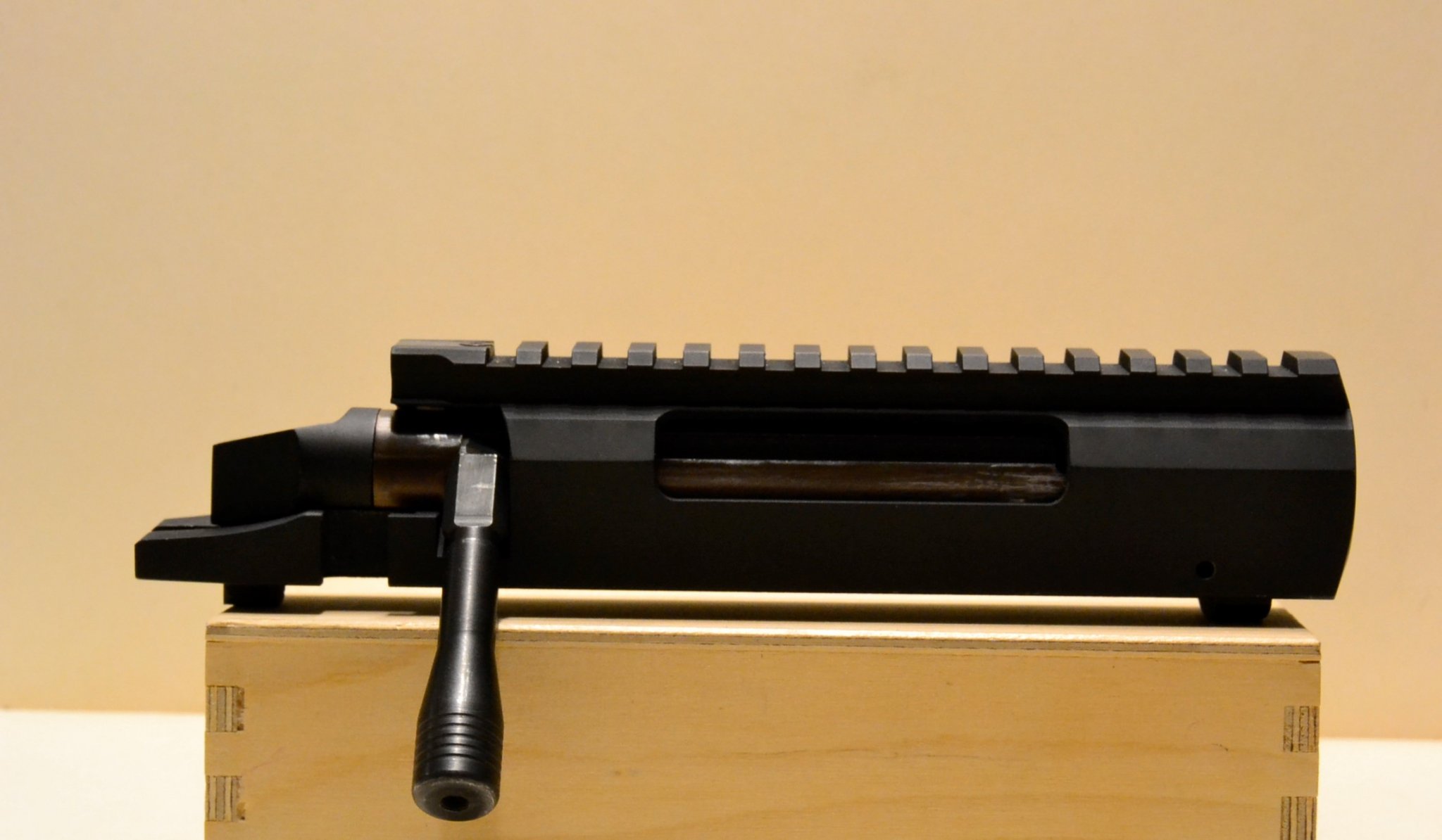

Also, 90,000psi loads? How is this accomplished? Are the case walls much thicker or/and made of something other than brass? Or is the propellant that is some type super high tech advanced stuff? Or is it the firearms themselves are designed in such a way to allow this?
I can't imagine a .338 Lapua Improved running 300(+)gr projos @ 80k+ PSI....much less a .375 Cheytac Imp. or .416 Barrett running one of the Cutting Edge heavy solids @ 80k+ PSI !! LOL like holy shit, that would a neva ben dun befo' game changah'!!

In regards to the high pressures....combination of weapon design and case design. Nothing really new with propellant(s), that is why the pressures have to be increased to get any advancement. Because propellant advancements are not happening fast enough.
There are a couple companies working on some 90-100k pressure bolt action weapon systems along with new high pressure capable bi-metal cartridge designs.
Just think of a 420gr projectile at 4k fps without damaging primer pockets or separating case heads.
I pressure tested a new receiver to about 152k a few weeks ago....brass cartridge case blew apart and locked the bolt but at 130k bolt functioned fine with not even a malfunction of extractor or ejectors.
XM1186 on the left:

There is a poly-cased, non-telescopic cartridge design submitted to the NGSW competition as well.
Could these rounds perhaps be primer-less cased? With ignition coming by way of some different new method?

FN has made 6.8 versions of that rifle (But with different alloys in key places to handle the pressures) and submitted in the NGSW program. They actually entered 2 different versions, a Mod 1 and Mod 2.
@vh20
Do you happen to know if that standard poly case ammunition functions in all the weapons submitted or just the weapon submitted by that ammunition manufacturer?
Of all the NGSW submissions the combo from that company seems to be relatively unspoken about but really could be a "sleeper" in the program and would be a big kick in teeth to FN, Textron, etc.
It is going to be interesting when the T&E Commands start ringing these prototypes out :)

BTW @THEIS - can you disclose how the gas guns were modded to handle such pressures?
And what action was it that you ran/blew the case in with no harm to the bolt or anything? IIRC PO Ackley literally tried to blow up the Arisaka and failed to do so.
What type of steel are they using in these high pressure actions?
Can you post a link or point us toward a company site?
Can we civvies expect this ammo to trickle down to us? If so, when?

So as to not speak directly into regards what FN or Textron have done to their weapons to handle the high pressure but typically you would need to tighten the tolerances between the bolt carrier lugs and the breech extension area, along with some more specialized alloys, heat treatments and RC those components to about 52.
Luckily a gas gun can be made to bleed pressures off really really fast but downside to that is the elevated pressure benefits ala increased MV are not as noticeable if running those same pressures in bolt gun. That is why the 6.8s in the testing are only running 3500fps with those pressures. Same pressures in bolt gun would probably be pushing closer to 3800fps.
Linked is some pressure testing I done last month on our new receiver. I am not ready to release company and information yet but will be ready to roll in about 3 weeks. We are finalizing some production processes first.
In regards to the high pressure ammo trickling down....receiver manufacturers would have to be willing to make changes on their end (which increases price) so their receivers do not break, malfunction or blow up.
