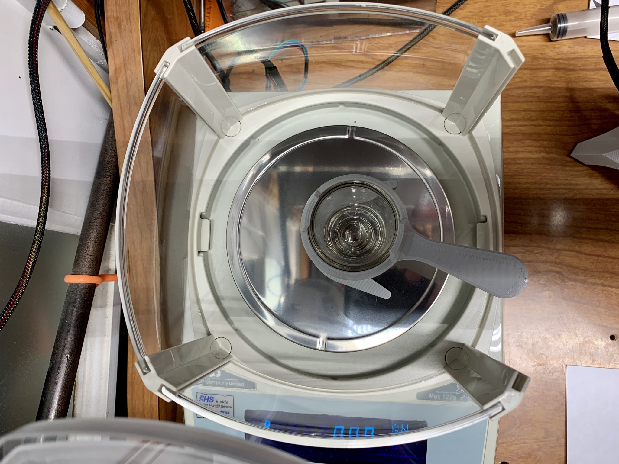

After loading for a couple of days, I am convinced the clear lid is a must have, especially when that one errant kernel manages to pop out of the cup and land on the platen. If you didn't have a clear lid, you would never see it and the rest of your drops would be off. 1 kernel isn't much, I know, but. Plus the rigidity it adds over the one that came with is a big factor for me.

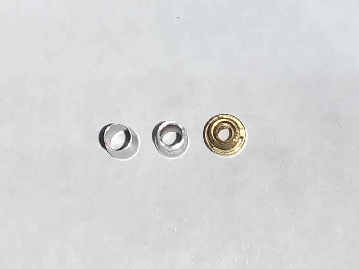

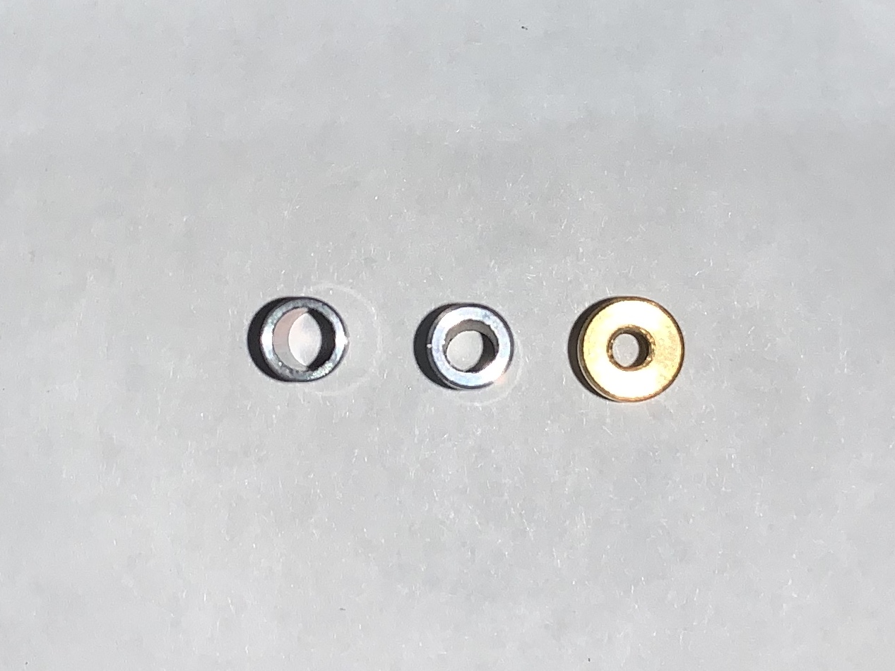

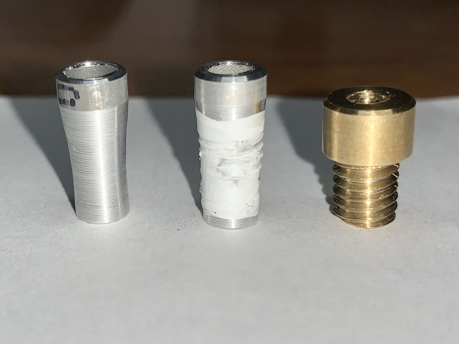

I received my eBay reducers today. I have three now. The first I bought is from Dan636 on here. It is the same one made of brass in Elfster's videos. Very well machined and threaded both inside and out. The ones from Ebay are not threaded and are smooth on the inside. , I wrapped them with teflon and they screwed right in. The Ebay reducer is a set of two different sizes both of which are bigger than the brass one. All three seem to be good to go.

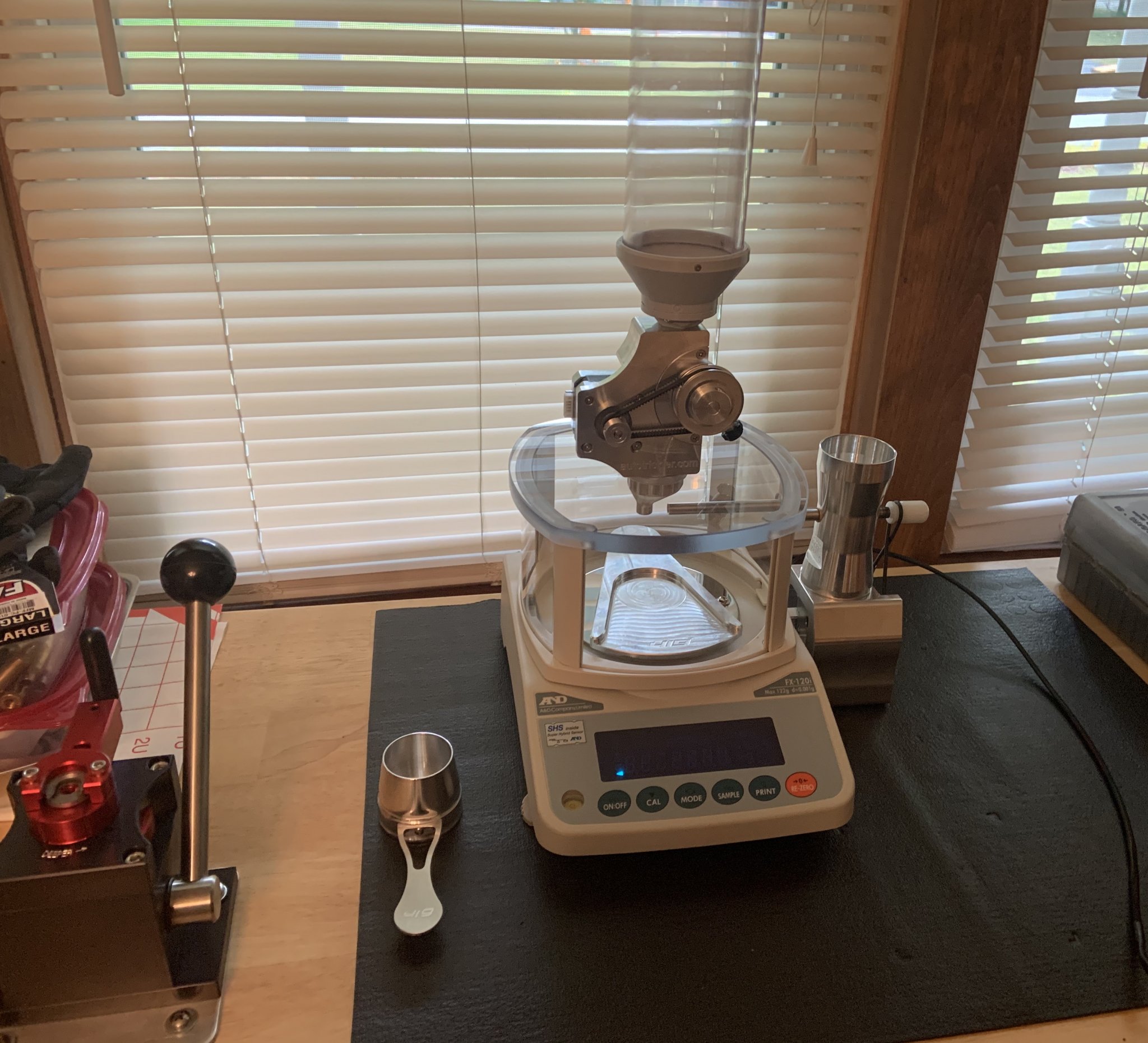

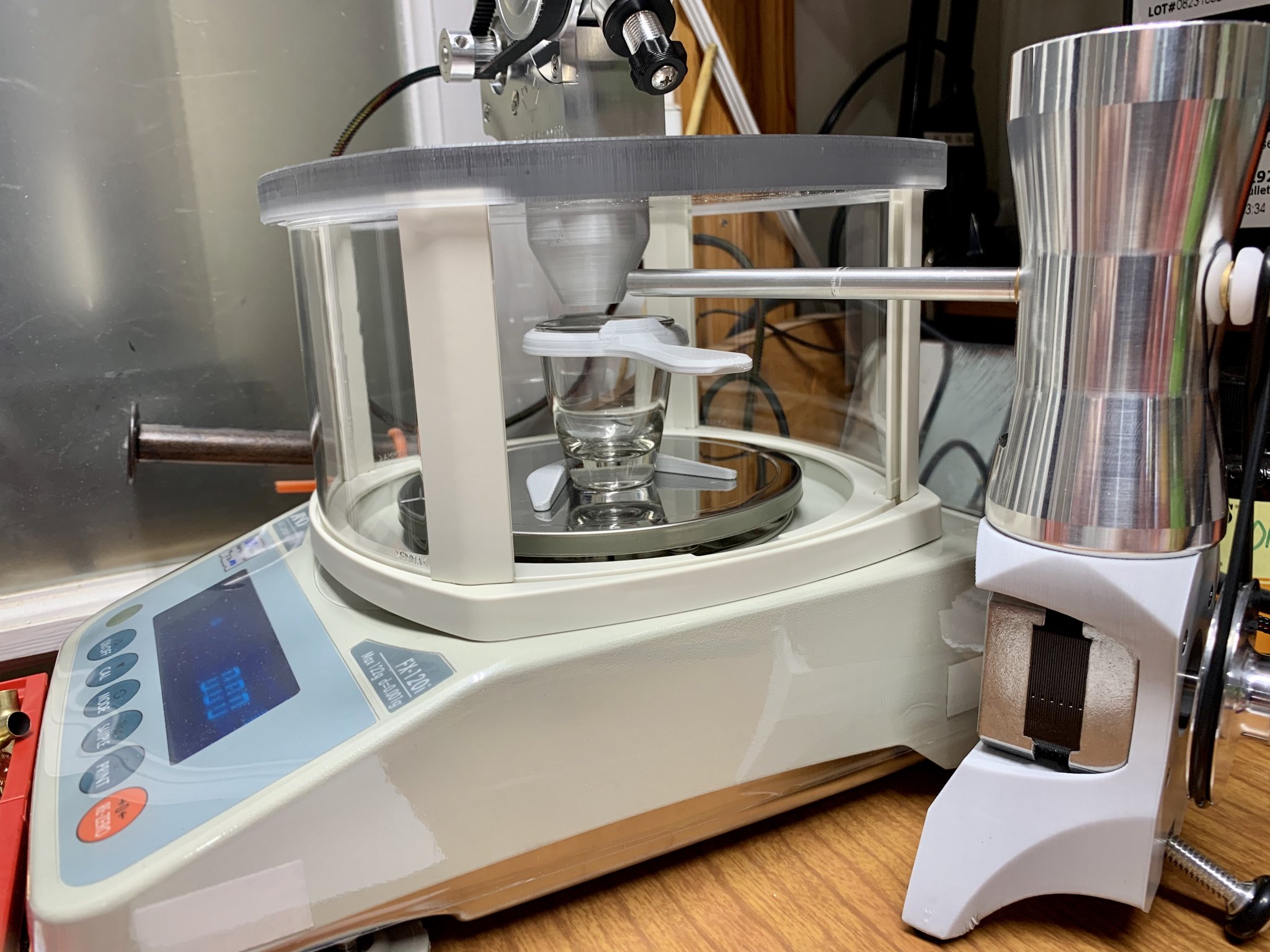

I also installed 3 panels as seen below, back, left and front. My setup sits on the far left of my bench and it made more sense to work from the right side. Eliminated all draft issues and so far I haven't bumped the trickler. In fact, it is a non-issue, I don't even think about it being there when I place the cup. The other thing I did was put the clear plastic cover back on the scale, that combined with the weight of the 419 lid made the top more stable.

What is the purpose of the Teflon? (I just got my reducers from ebay yesterday.)

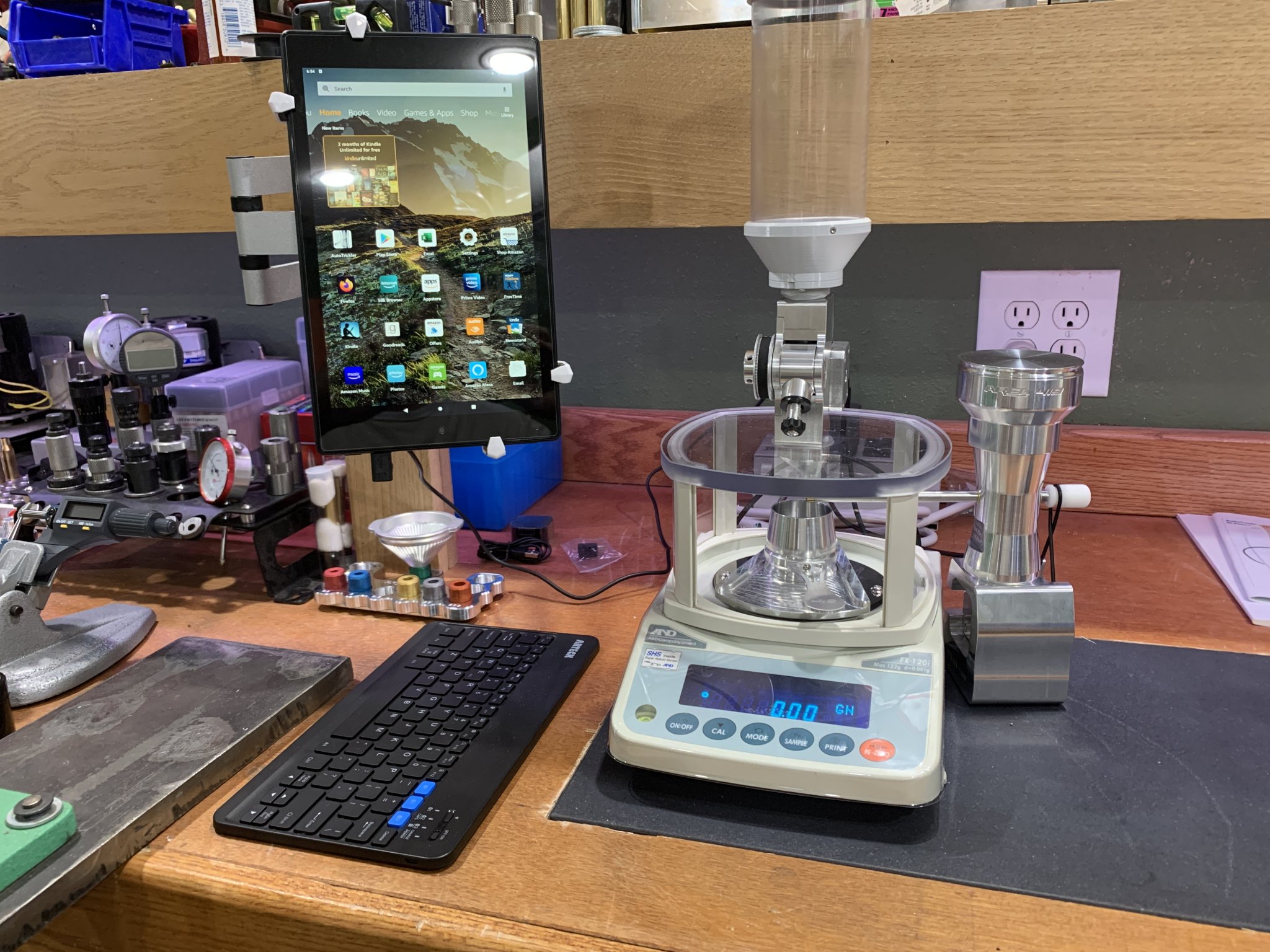

I got my setup today.
The reducers aren’t threaded and are slightly smaller than the id of the trickler tube. Adding the Teflon makes for instant threads. It was probably 3 to 4 wraps and then screw it in, but start with 2and work up. My tube was level and my slider was towards the + end and I could consistently watch the last 2 kernels drop in.

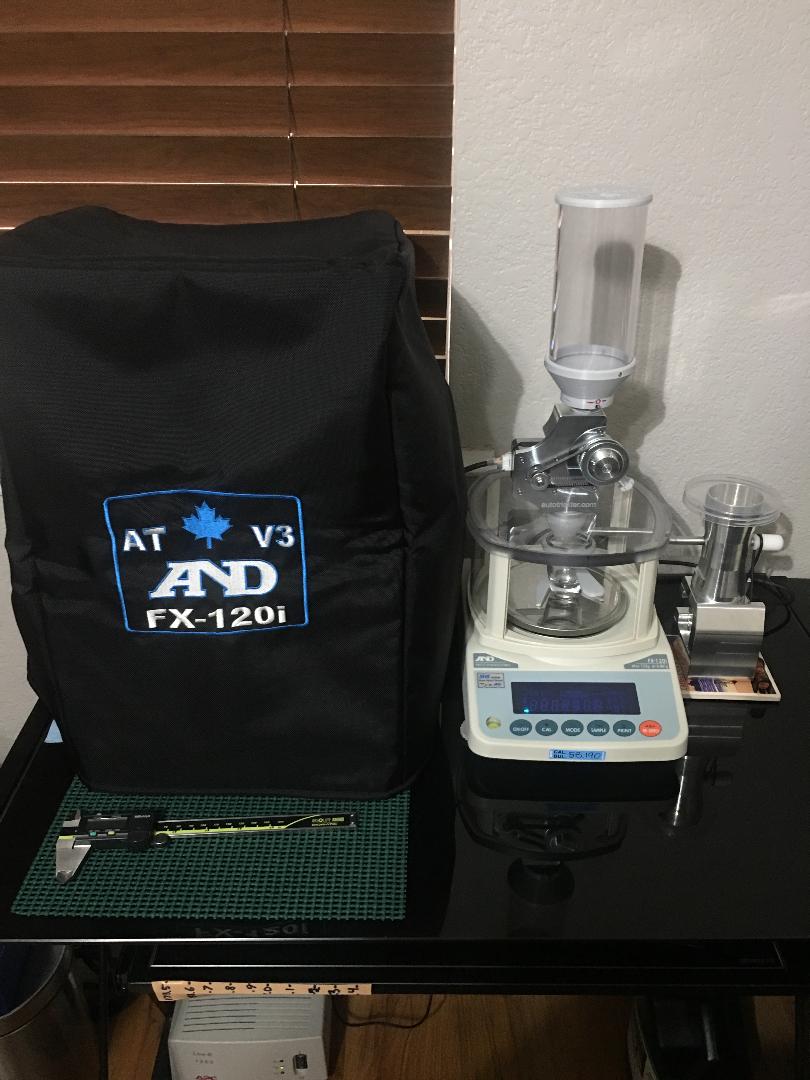

For anyone who is looking for a dust cover for their unit, I got linked up with a guy who makes his own. CE Products referred him and I'm incredibly happy with the quality of it. He usually does high end radio covers so is used to working with sensitive electronics. I can forward his contact info if you're interested.
(Not my pic, just one he sent to me. Mine looks identical though)

For those asking about the dust cover, here's the website: https://radiodustcovers.com/
I believe the price is the same as the 419, but with this you can have anything you want stitched into the cover. Just another option.
Thank you. I am very happy with my Area419 cover but these covers would be perfect for other items on the bench. Especially for those of us who have garage workspaces.
