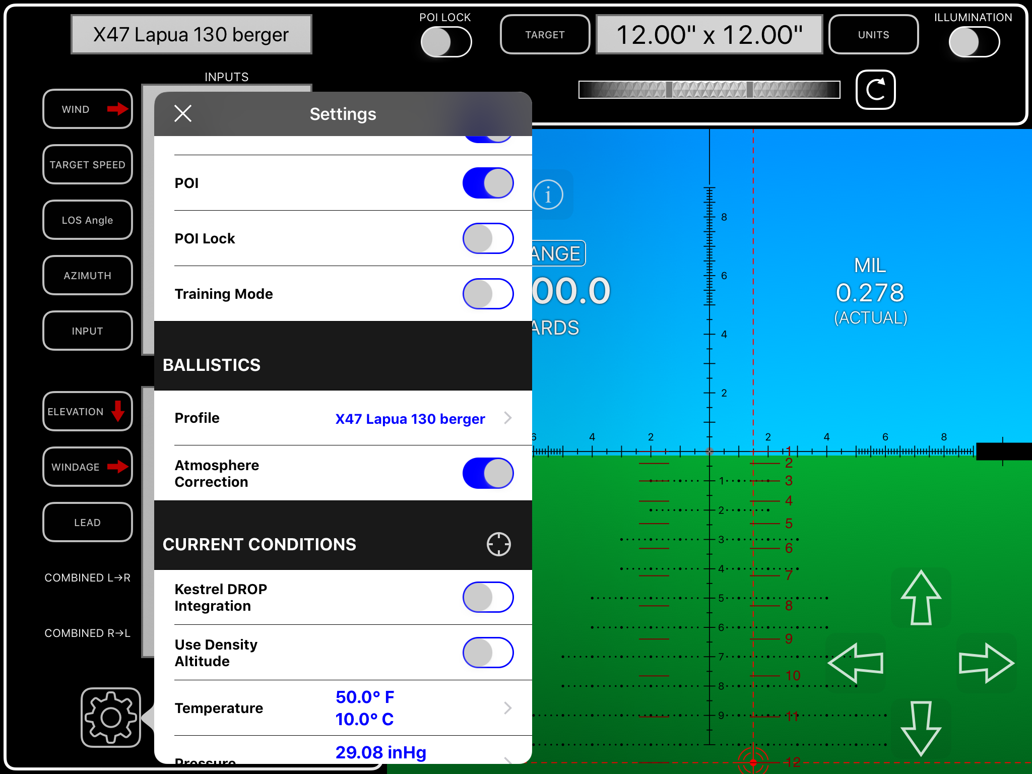

Actually it does have Kestrel Drop Integration
