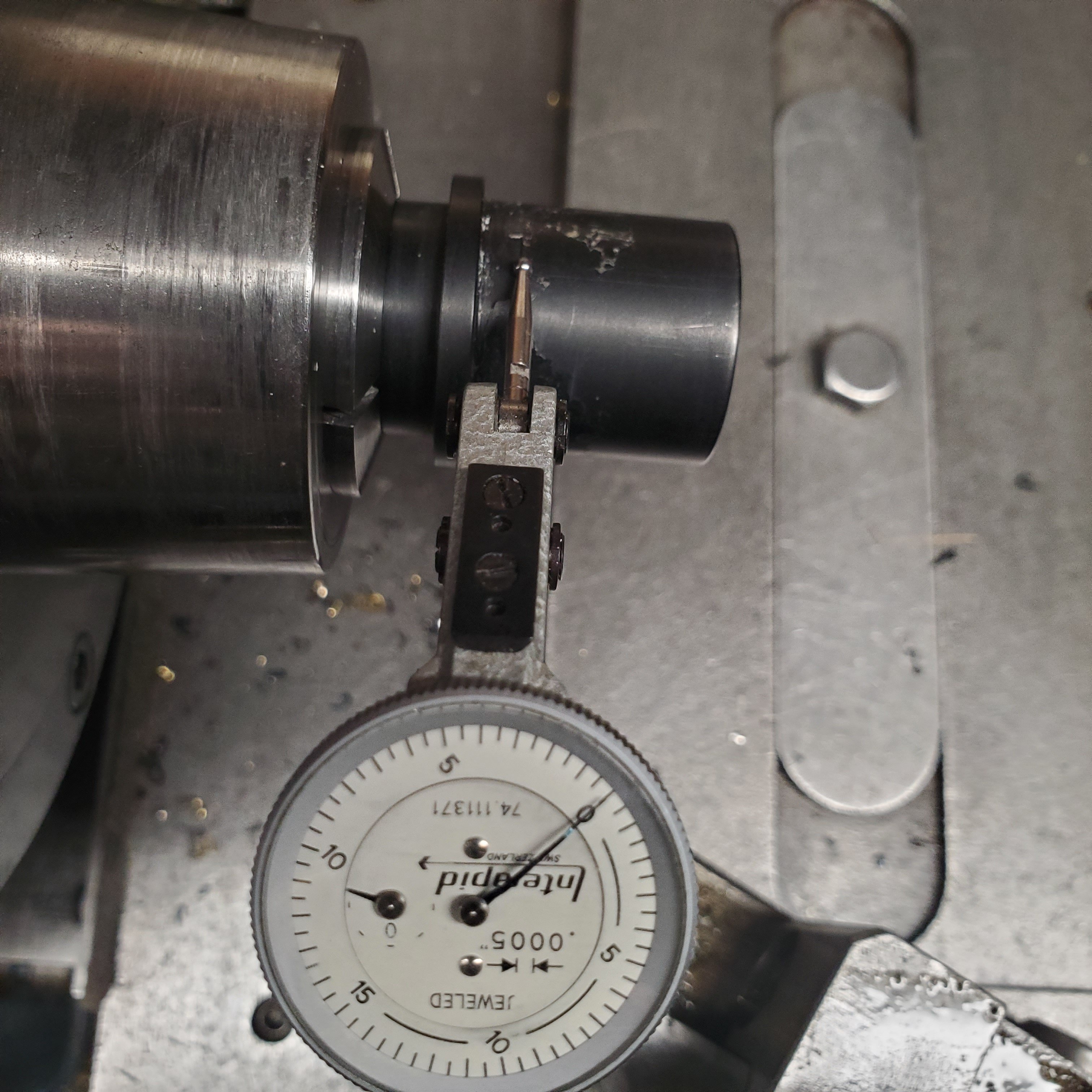

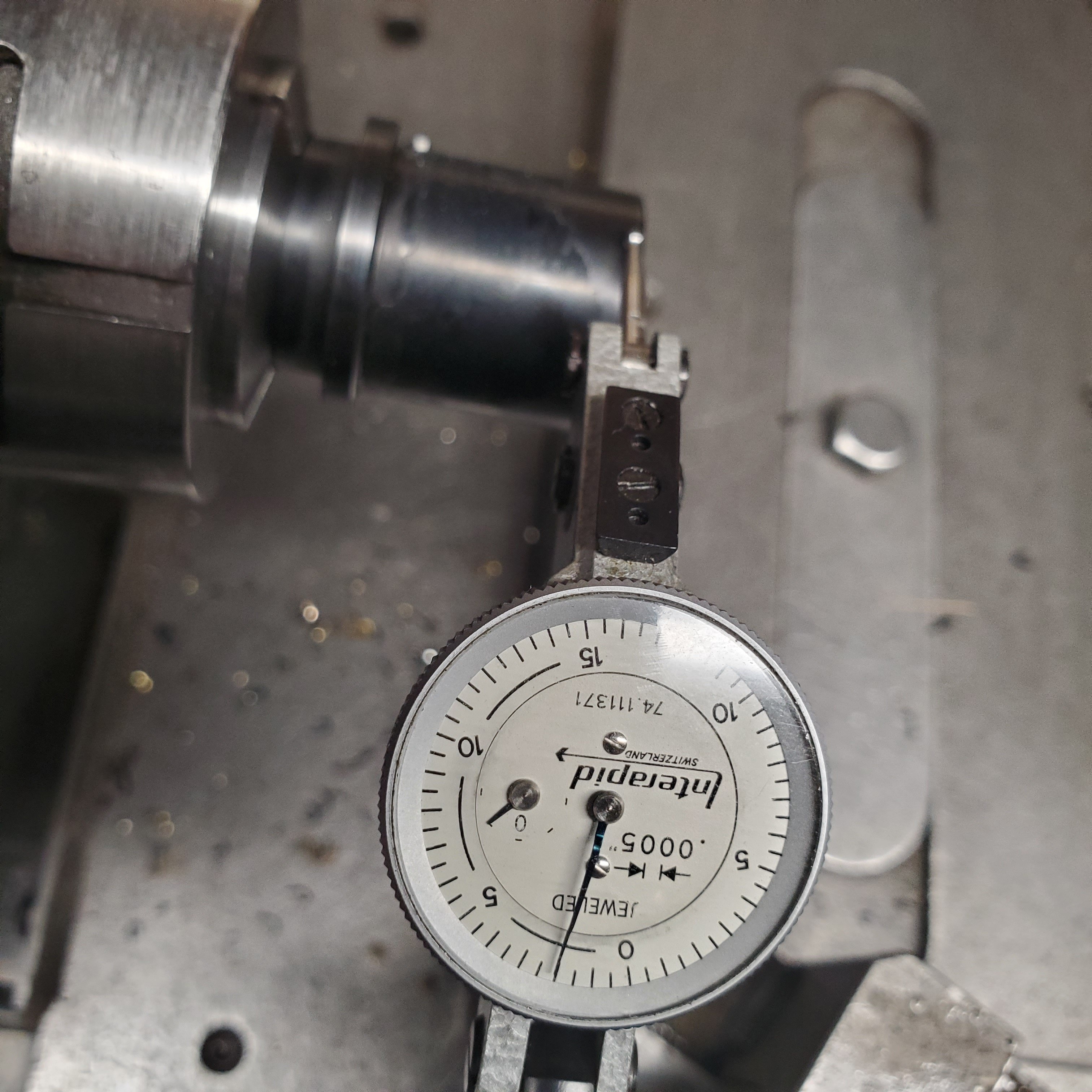

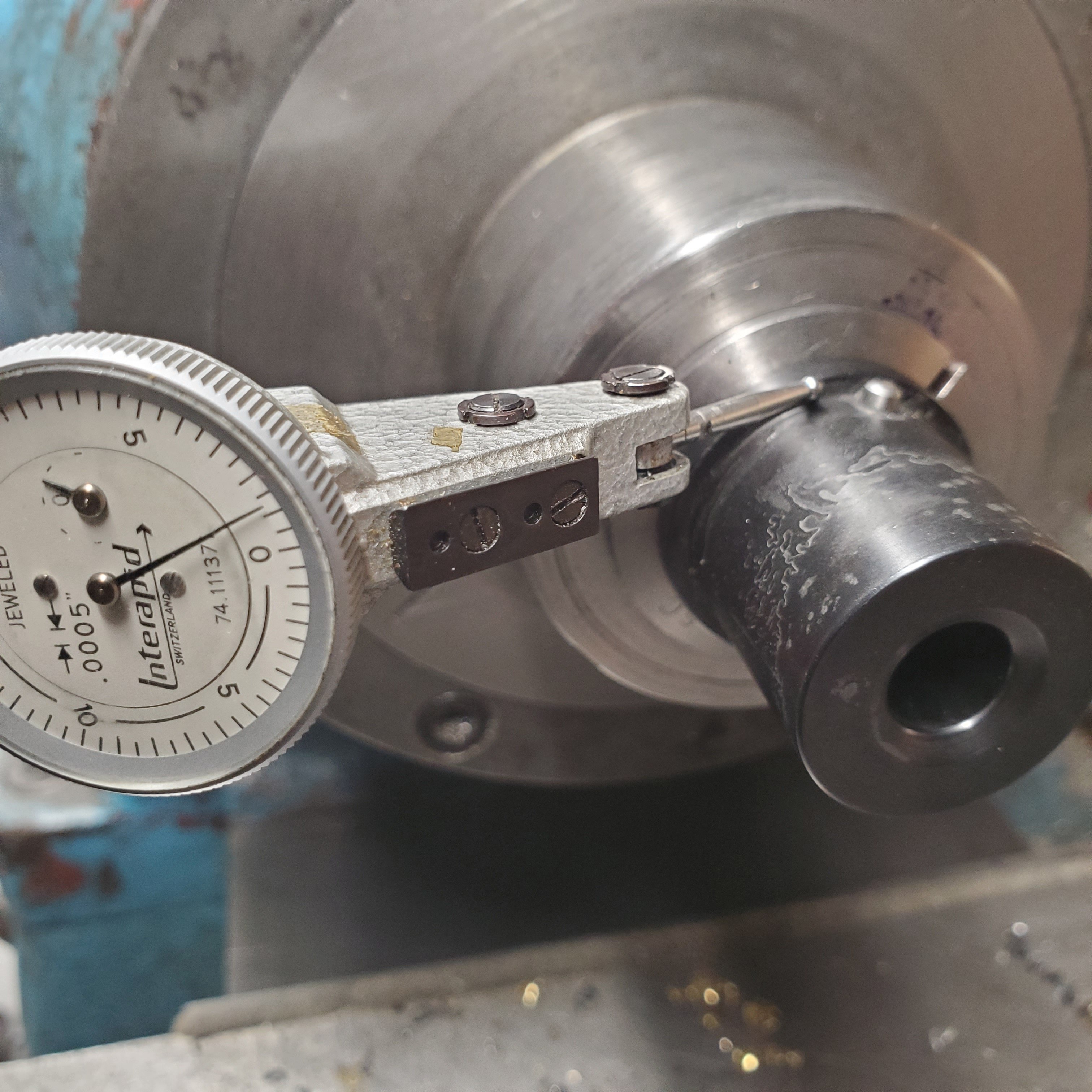

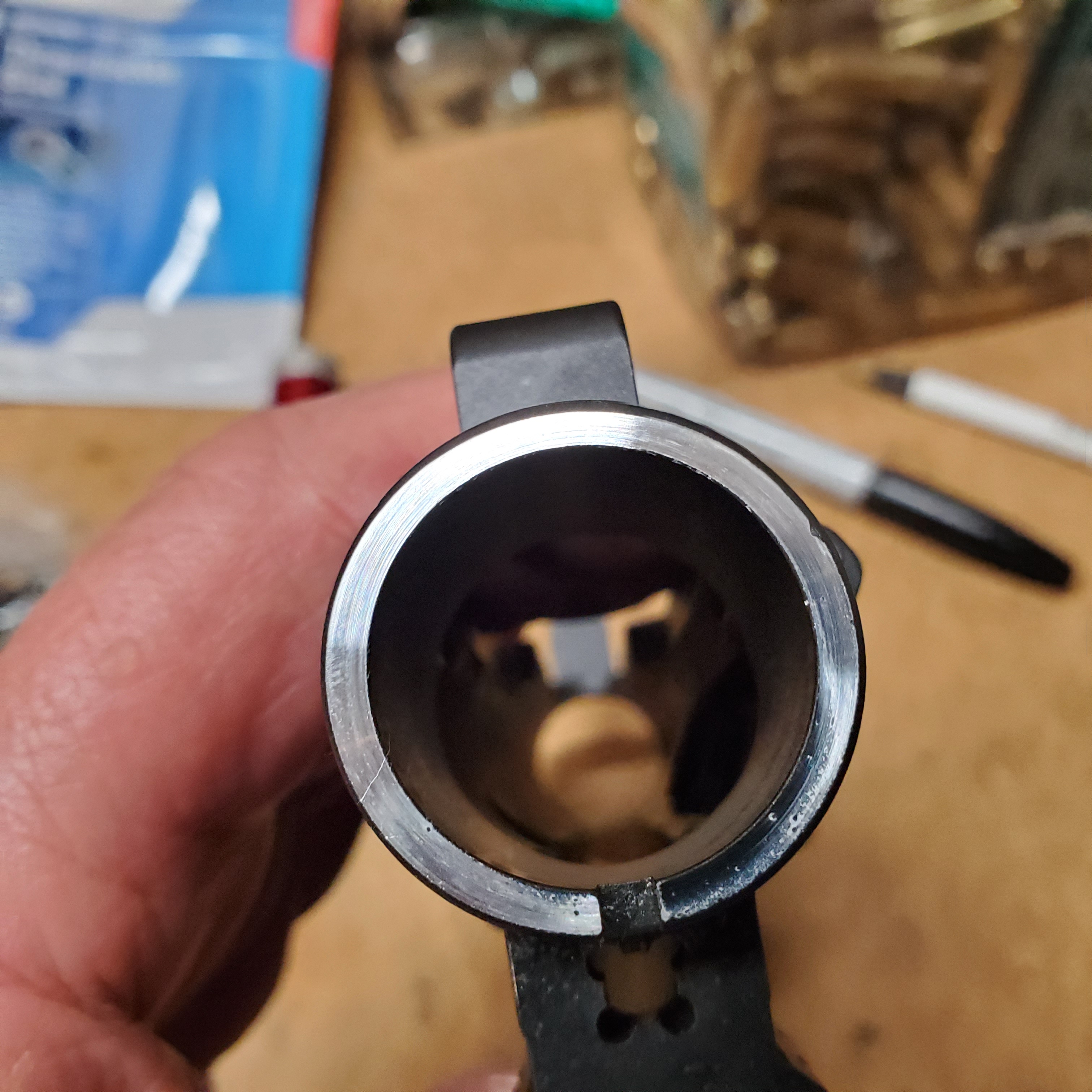

Factory installed barrel extension butted up against a supposed factory square shoulder.
Scrapped the glue off this pre installed barrel in one area to get a reading straight across the length of the extension
Its pretty close to zero- zero, and .0002" TIR on tbe barrel itself...
but the runout on the end of the barrel extension is .002" and the face around. 001". Imagine your 16" barrel is attached pointing down range at a slight angle.
Plus any reciever portion out of square, or the barrel nut itself.
And thats not all of the problems to address.
