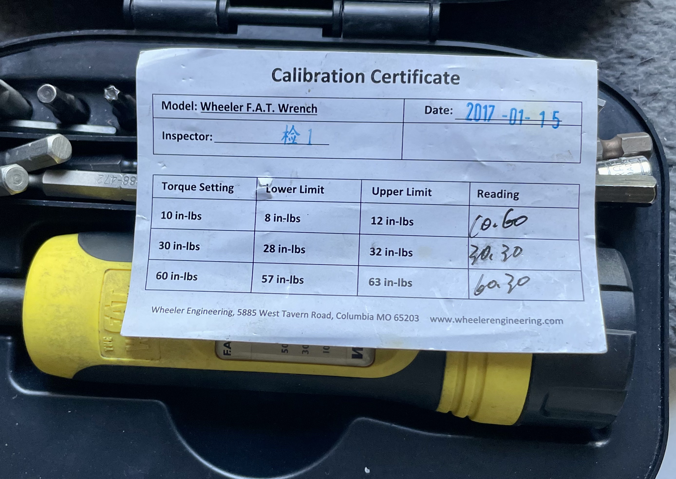

...if whatever doesn't come with an initial manufacturer cal, I wouldn't trust it...
Wheeler FAT wrench comes with a cert. At least mine did.
