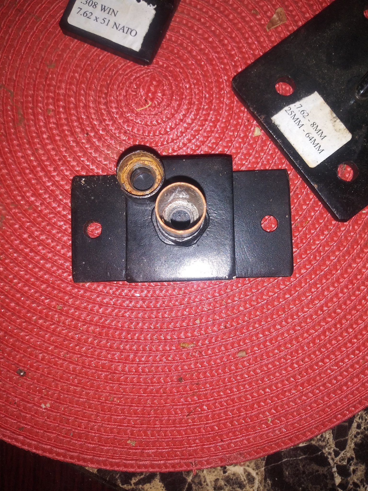

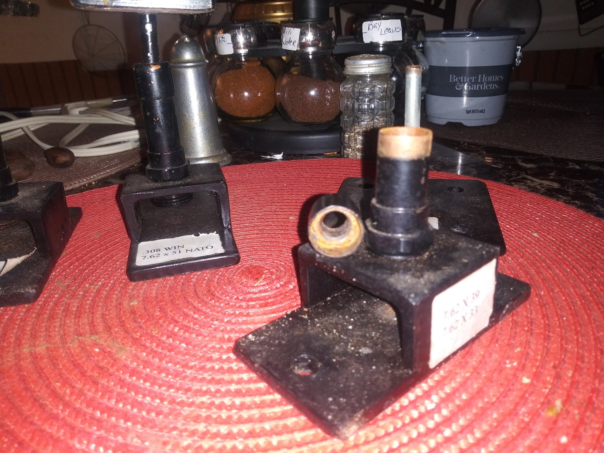

I finally dug and found the de-cappers I had purchased off eBay back in the K31 days, still haven't located the RCBS hook tool I had. I wanted to reload the GP11. Looking at them now they seem over-built, steel with 1/2" copper tube & fittings. I used one on a few cases, but had bought boxer brass to load. I also have most of 5K berdan primers stashed. Maybe time to start hitting some ranges to pickup spent casings, prep, prime, & sell!? Probably not...
I don't know if anyone has any interest, but may be open to trade, I don't think my post count is high enough to list them here?? But I wanted to share pics of what I had.
