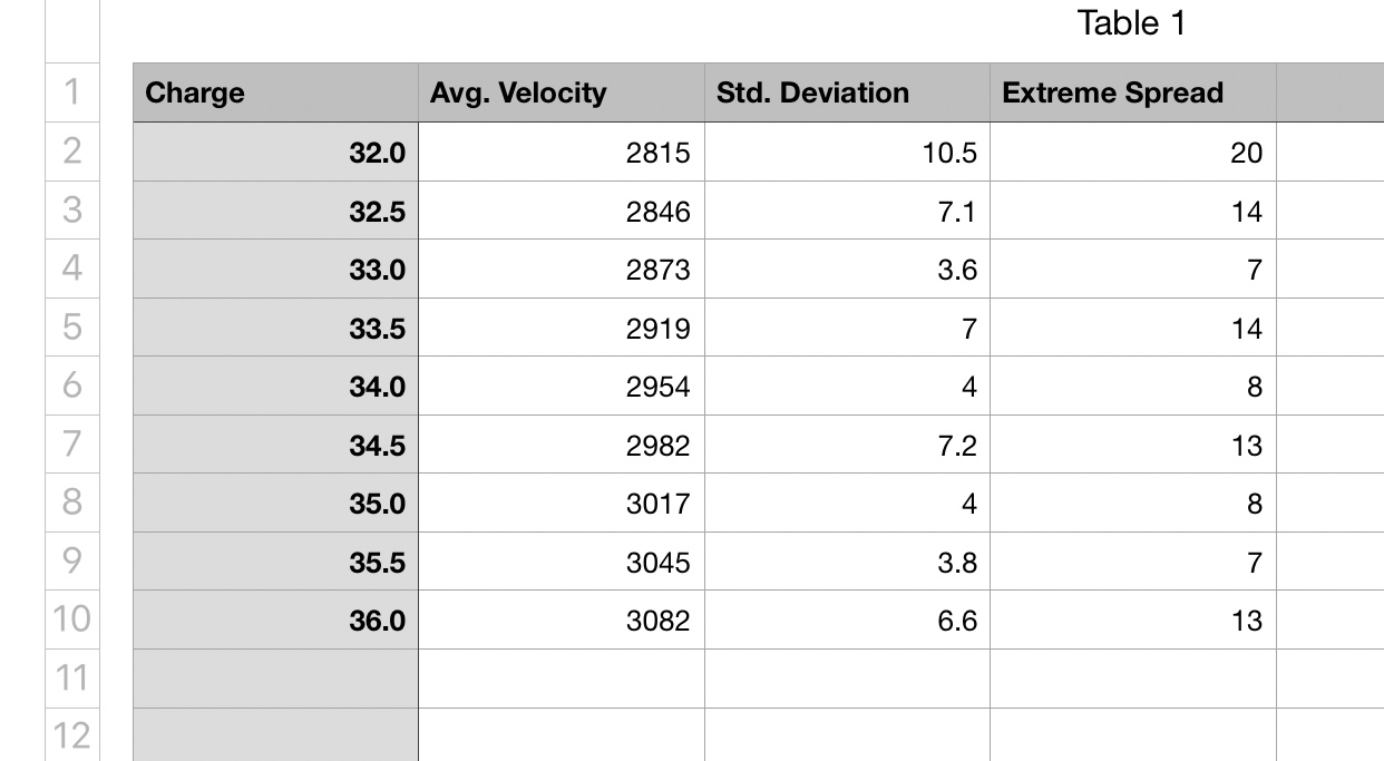

I just cleaned the wife's dasher at 220 rds and the throat has not moved a measurable amount using the Wheeler method to find the lands. She's running 32.0 gr Varget under a 105 at 2880, so not pushing it hard. Even then, there isn't a lot more wind to hold than my 243 AI and it was stupid easy to find a load that shot under 1/2 moa. If the barrel life is a lot longer, and there is less fussing with chasing the lands, etc., I may have my next barrel chambered in 6 Dasher. The only real drawback I can see is that a 115 DTAC going 3050 hits targets noticeably harder and is easier to spot misses with than the 105 at 2880. I even notice the 115 at 3050 is easier to spot misses with than the 105 at 3150 out of my 243AI when I switch back and forth.

that's not downloading a 6CM...that's not hotrodding it
factory Berger is a 105 at 2950 ish
33-42 grains is a wee bit more than 20% extra burning
lol, we doin math the same way?
33 divided by 42 equals .78XXX. 100% - 78% equals 22%
Now, i reserve the right to say, im pretty sure i passed my math classes simply b/c my teachers hated my guts and didnt want me another year. Math and people with ADHD and Dyslexia dont mix well. I.E. Me.
BRA/dasher uses 22% LESS than a 6CM.
the 6CM uses 27% MORE than a BRA/dasher
