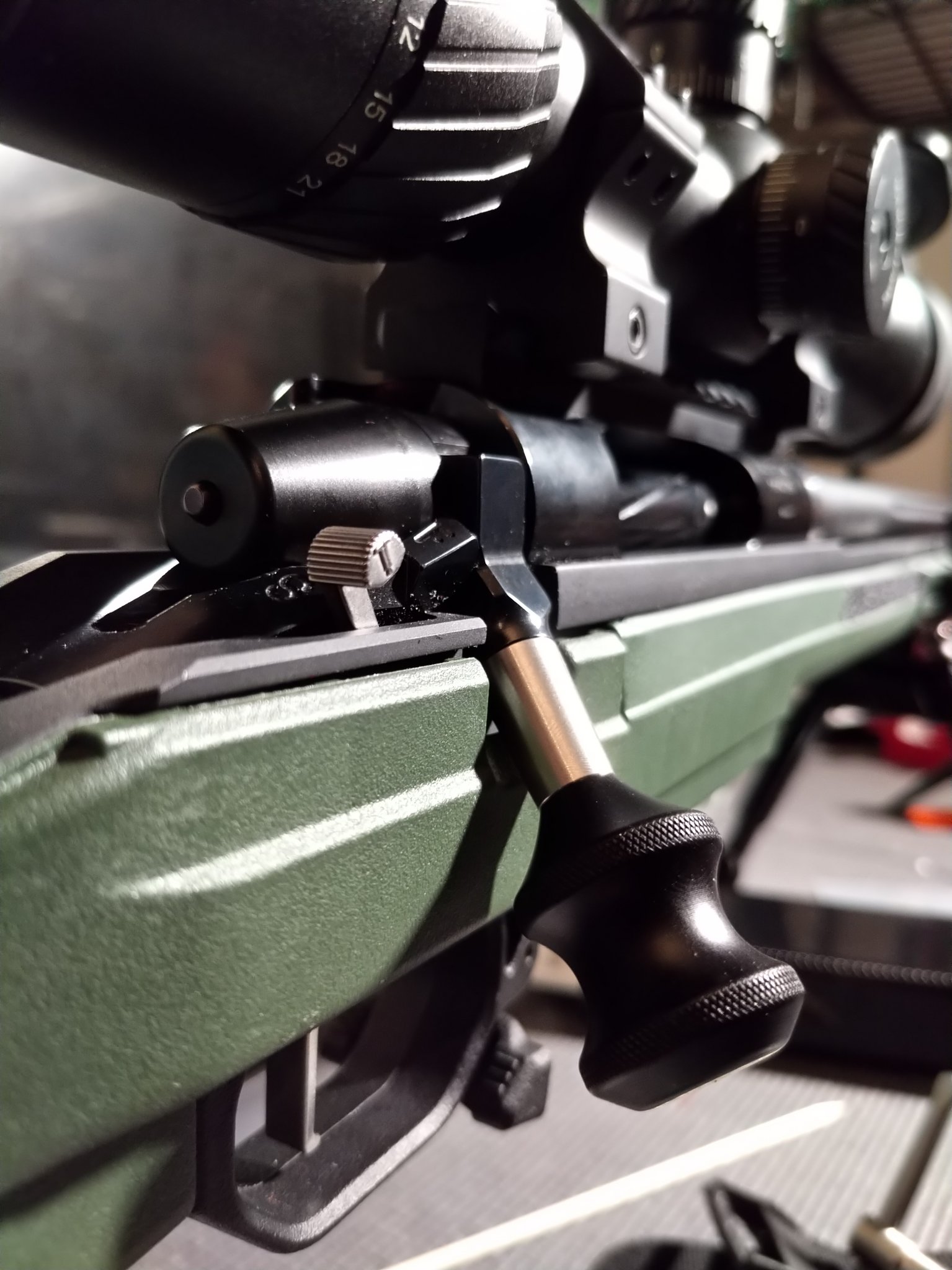

Check your cock on close, my Origin had .025”. A call to Big Horn and they sent a replacement for free. They are super easy to replace it takes less than 5 minutes. Now I have zero cock on close. This made a HUGE difference in bolt close effort.
And if you are running a Bix n Andy trigger get the low sear. That too made a difference.
It was great before but now mine is amazing and I don’t have a single round fired yet. I have cycled it about 150-200 times now and it keeps getting better.

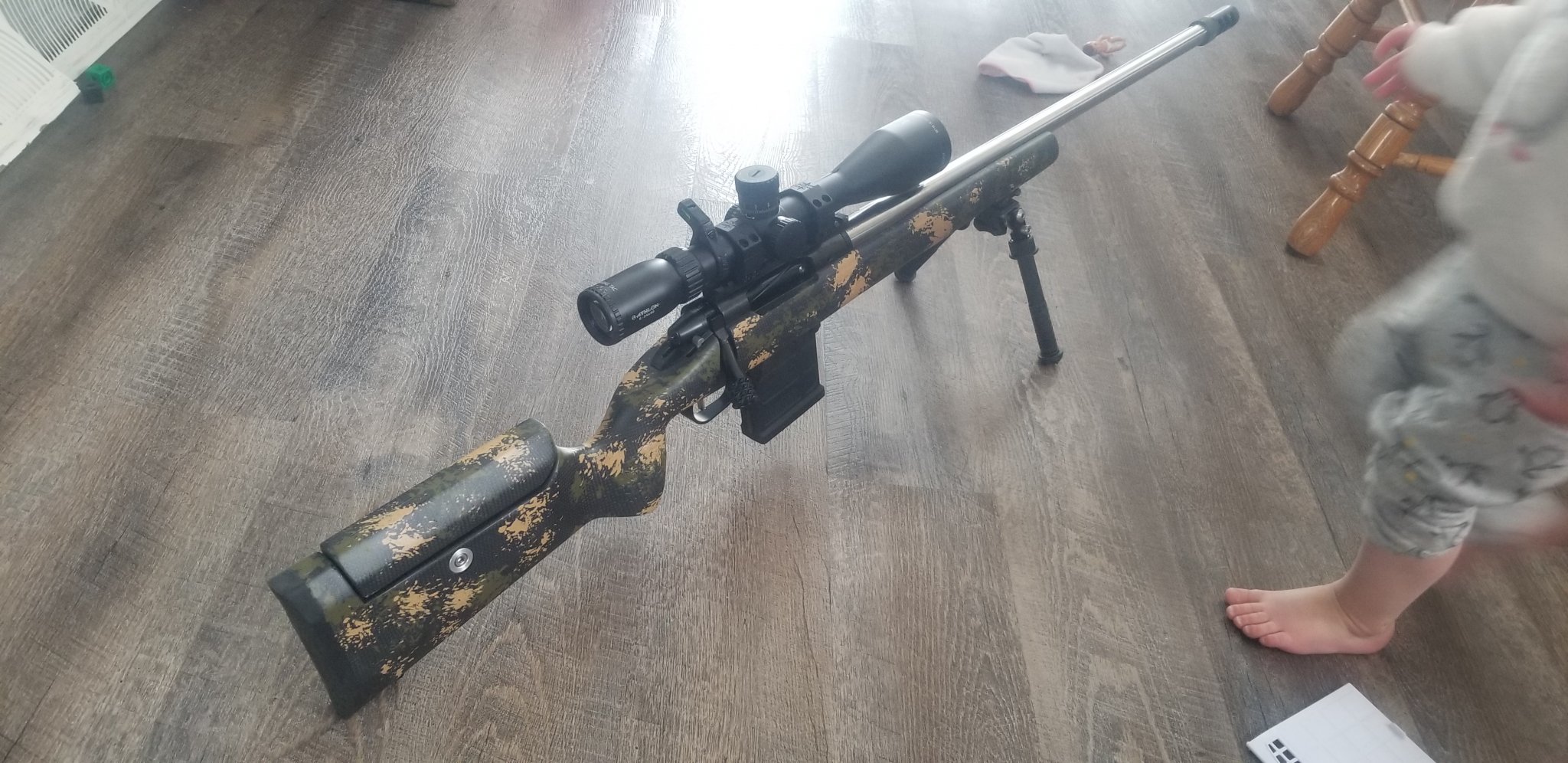

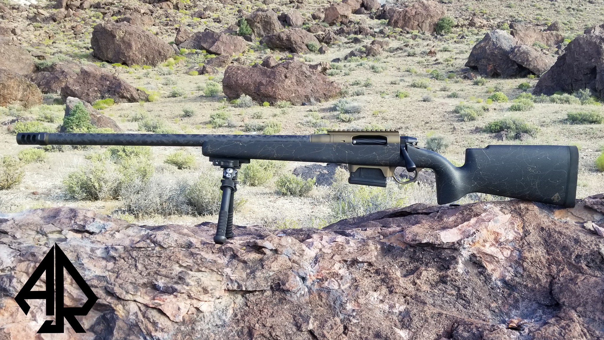

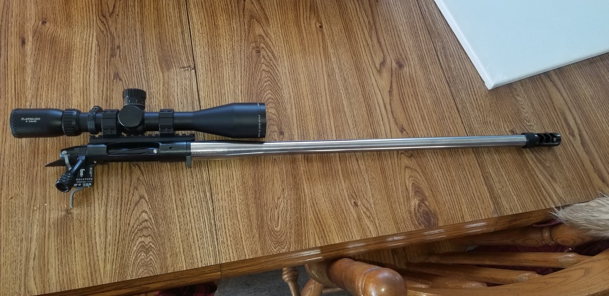

Should have posted mine a while ago, but this budget build started out around this time last year.
Bravo
TT special
Savage 308 barrel
Covenant7 3-21

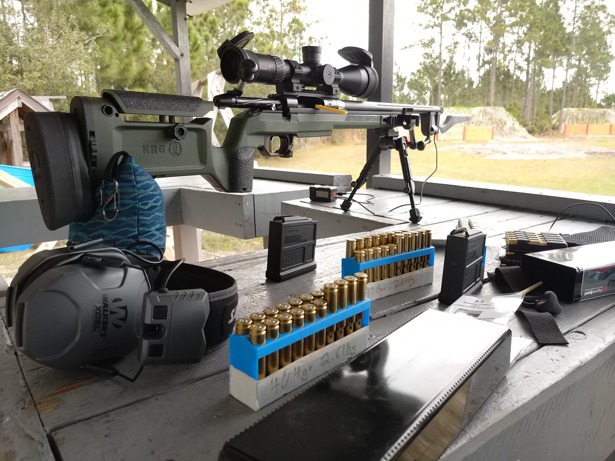

Factory loads have shot very well, but this was from my last range trip where I tested my first ever handloads and the Area419 bolt knob.
I really like it, its very comfortable and the raw and black fits too well with the color scheme I've got going on.

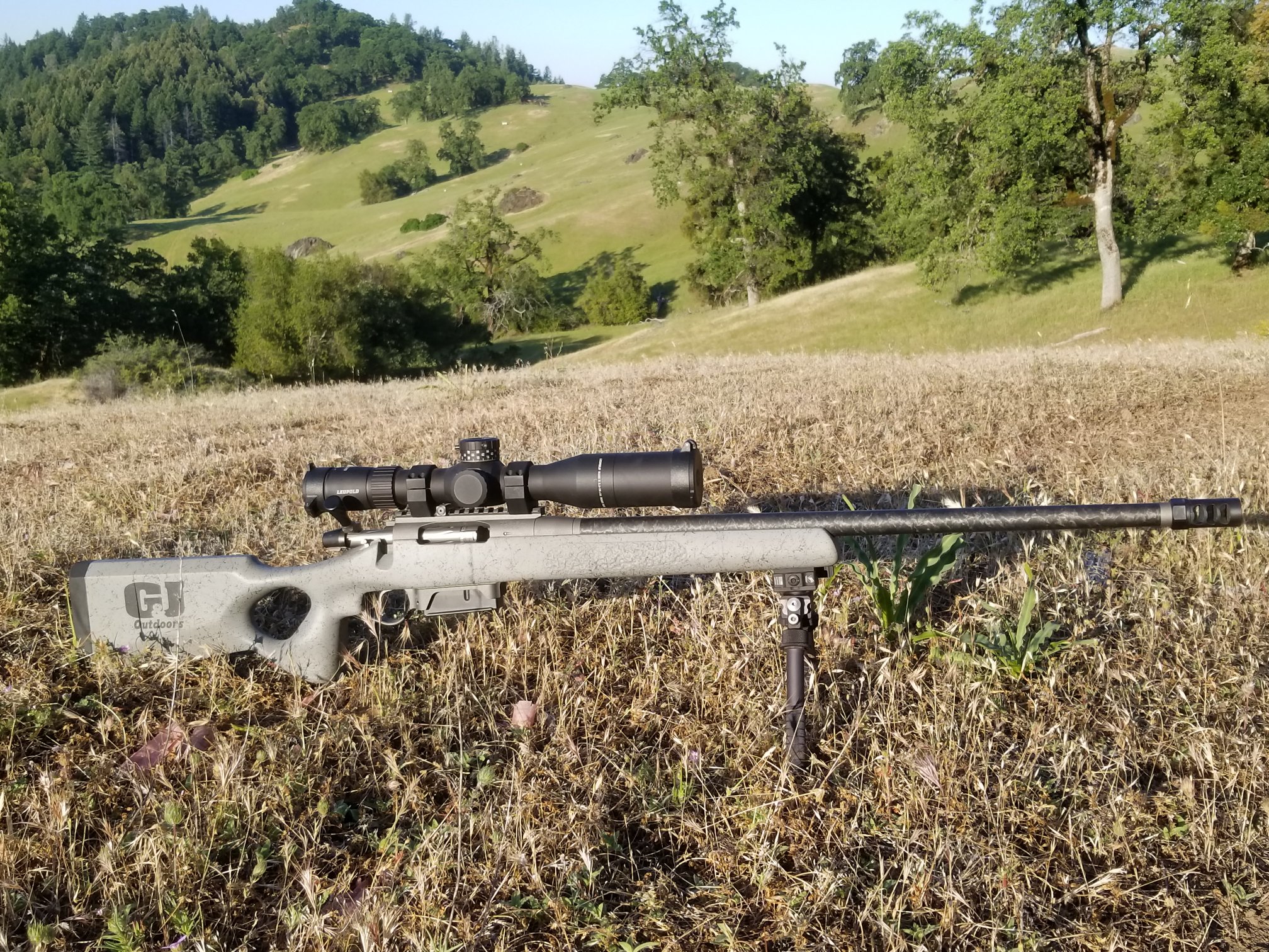

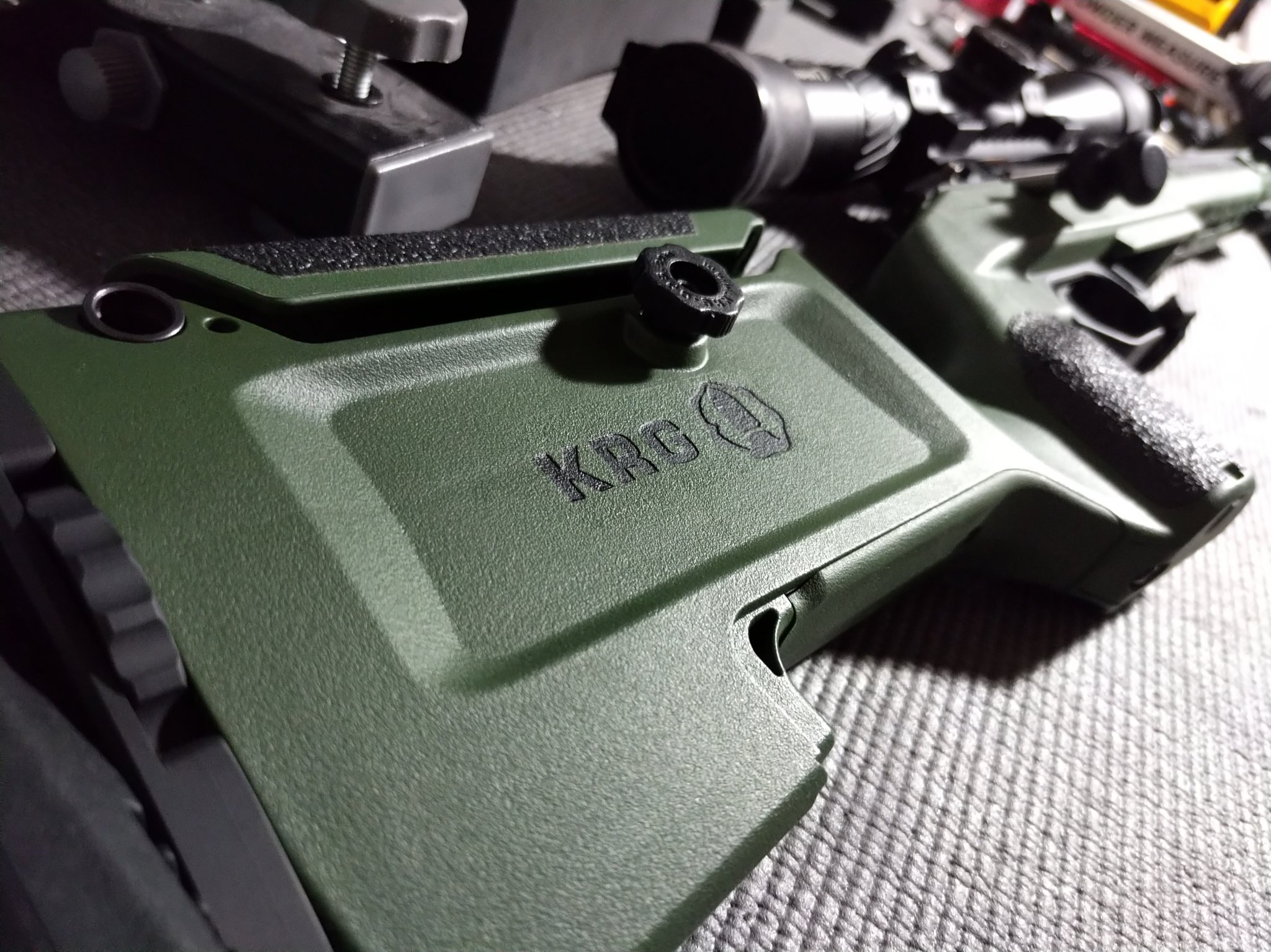

Ok, so this is the newest variant since my last post. My HS stock had some paint that chipped which p*ssed me off so I contacted them. To their credit they gave me a label immediately and even lengthened the ejection port for the origin action. I also had them paint it winter camo. They had it back to me in less than 2 weeks so not bad. Heres the new look hahaha:

What’s the deal with this? I guess I’m confused what the issue is. I’m honestly asking, not being a smart ass, troll, or whatever.
I could see a “feel” issue from it. My origin has a little cock on close and it’s not as smooth as any other custom action I’ve run but still worlds better than my 700 that LRI cerakoted. I’ve noticed it smooths out the faster I run it. But this is my first personal custom. I’ve run friends deviants, tl3’s, bat’s, AI’s, etc... I just sold a TRG, that was the smoothest thing I’ve run.
Just curious if there is any long term reliability issues with this, a feel thing, or something else I’m completely missing?

It's a feel thing. You can reduce the cock on close to make the action effortless to run. Definitely lighter to close than a 3 lug like AI's with their hard, last motion to engage the locking lugs and receiver abutments. That's the advantage of two lug actions. People argue about the feel all the time and I've learned they're usually arguing apples and oranges as they quantify the different parts of the bolt operation as smooth. The bolt on my AI and Tikka run smooth in the race way back and forth and people usually remark about this when they first try them, classifying the entire bolt operation as smooth. But the bolt lift is anything but light and smooth. A two lug will have a lighter lift and since their R700 clones ('ish) they'll usually have a little more play between the body and receiver. Which reduces the back and forth feel.
For a Bighorn action, you can reduce the hard action of closing the bolt which pretty much makes the entire operation of running the bolt light and "smooth" with the exception of the infamous binding debate. The drawback is that you're reducing the amount of firing pin drop and spring tension it has so you could get some light strikes. Both my TL3's have timed cocking pieces. One has the fluted firing pin and a heavier spring. The other is stock. Funny enough the one with the lightened firing pin and heavier spring began to have a few light strikes last year. Not directly after timing, but a couple of months later. And only on CCI primers and military ammo. My Origin is also timed and I haven't had any light strikes on it.
Thanks for the explanation. I’m going to look into timing mine with my BnA now. I was a little disappointed when I took delivery of my rig, honestly. I just figured I would have to shoot it in.
