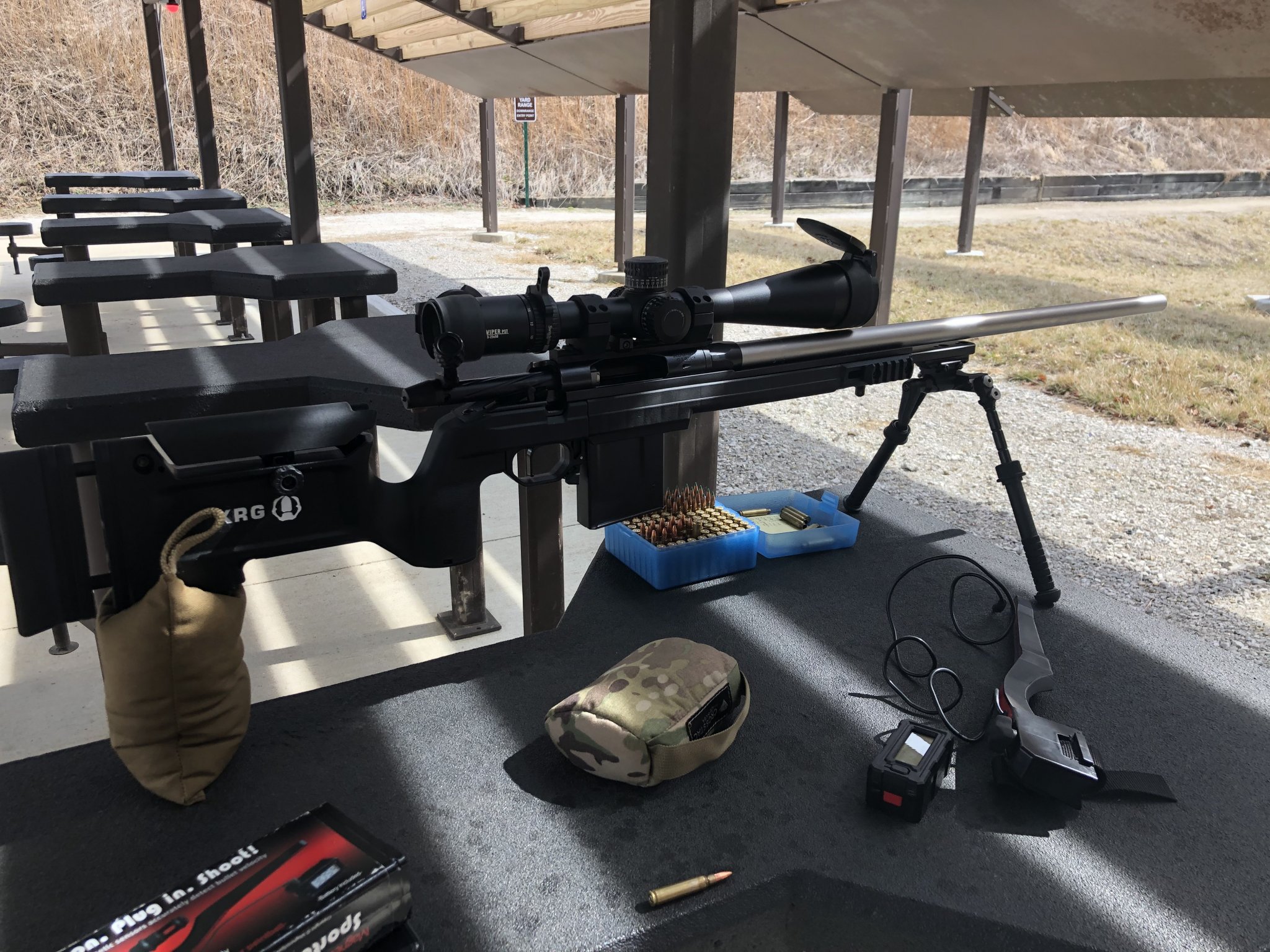

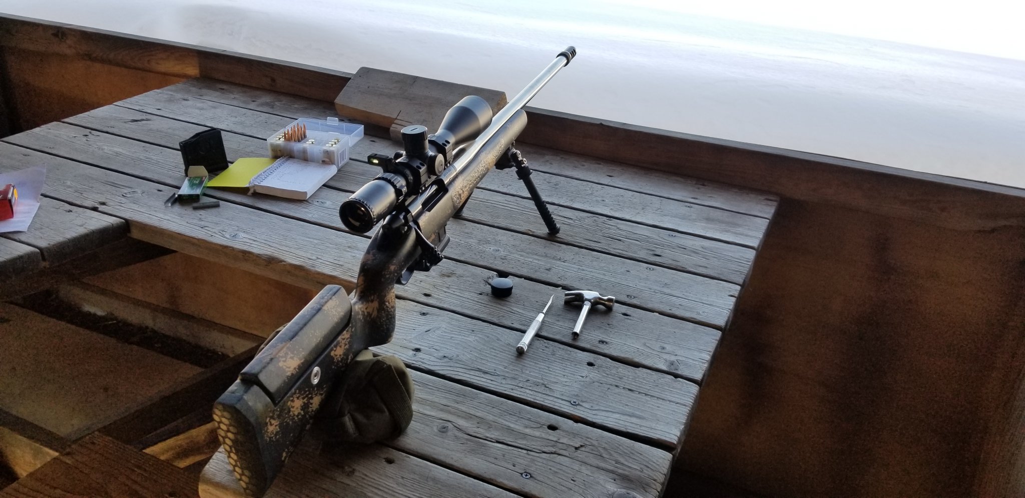

Those are rounds 30-35. .466" rifles a hammer. Just gotta keep going in charge weight. These were kinda slow.
Nope. Just need to gain some speed. 24" barrel and 6.5x47 might have set me back some. But if I can get these 144s to 2700+ I'll be happy
It’s possible, just might need to push it a little closer to the edge or see if the barrel picks up some speed

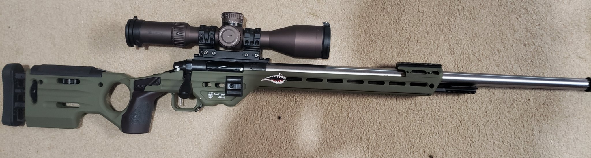

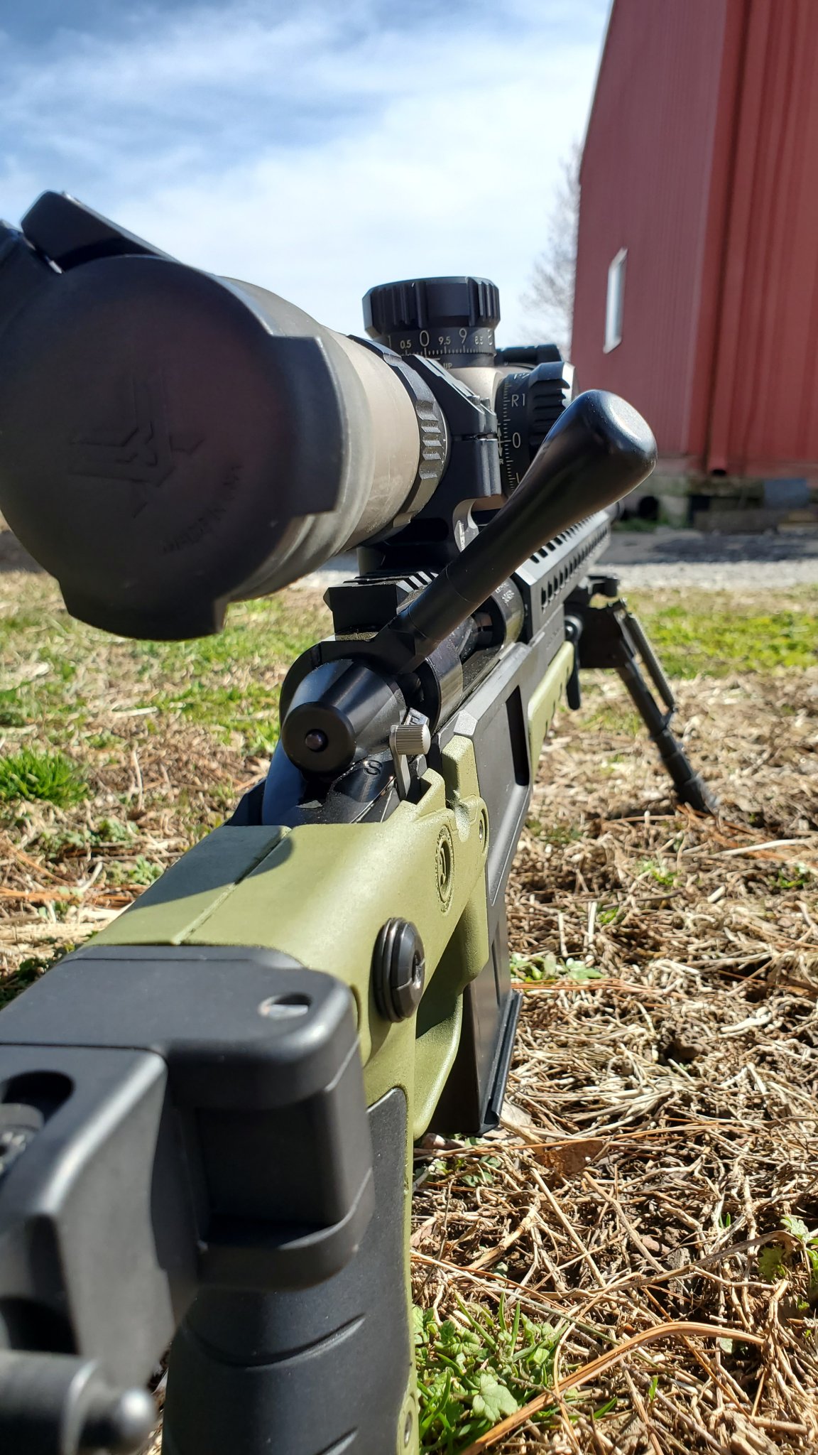

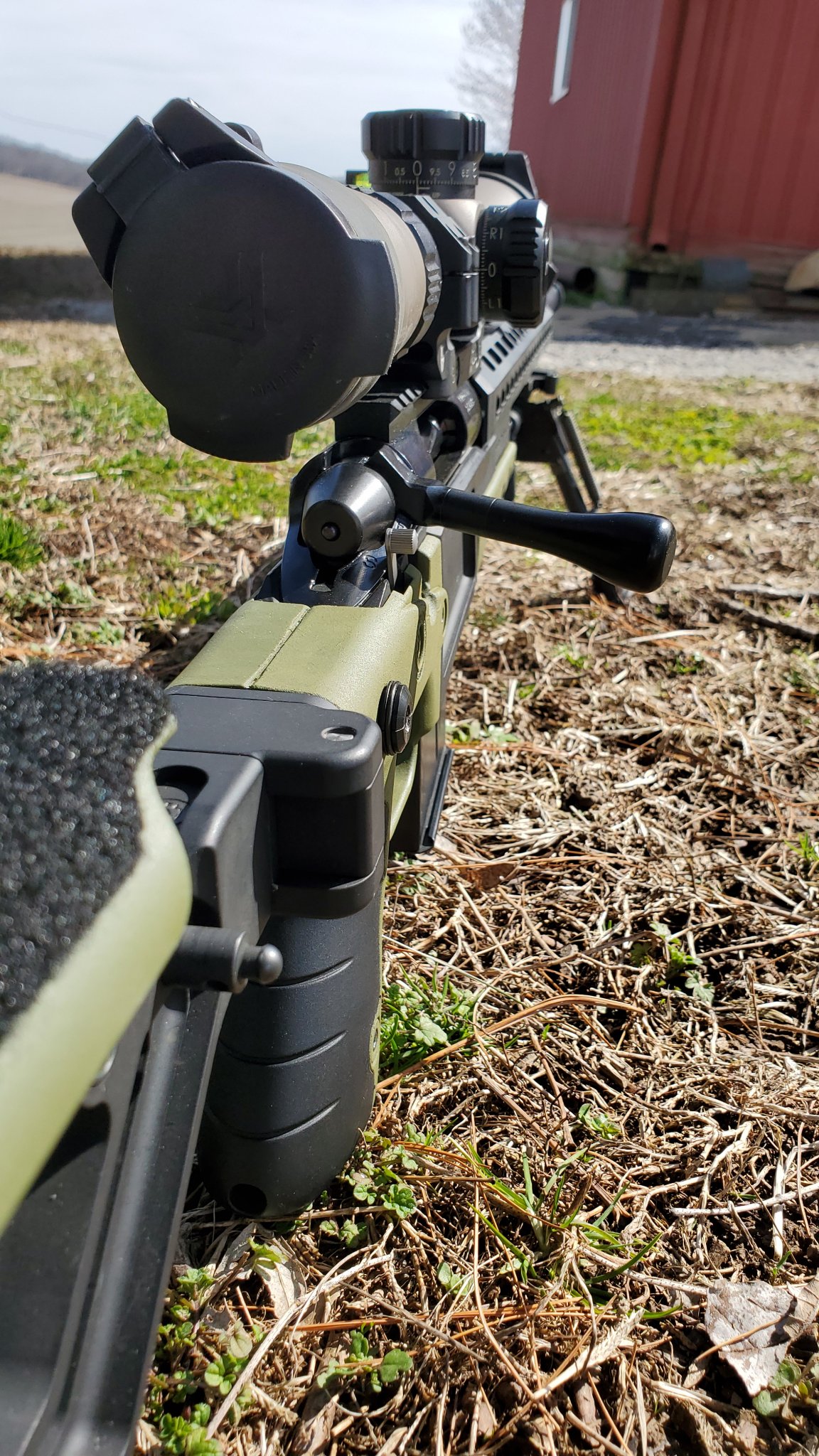

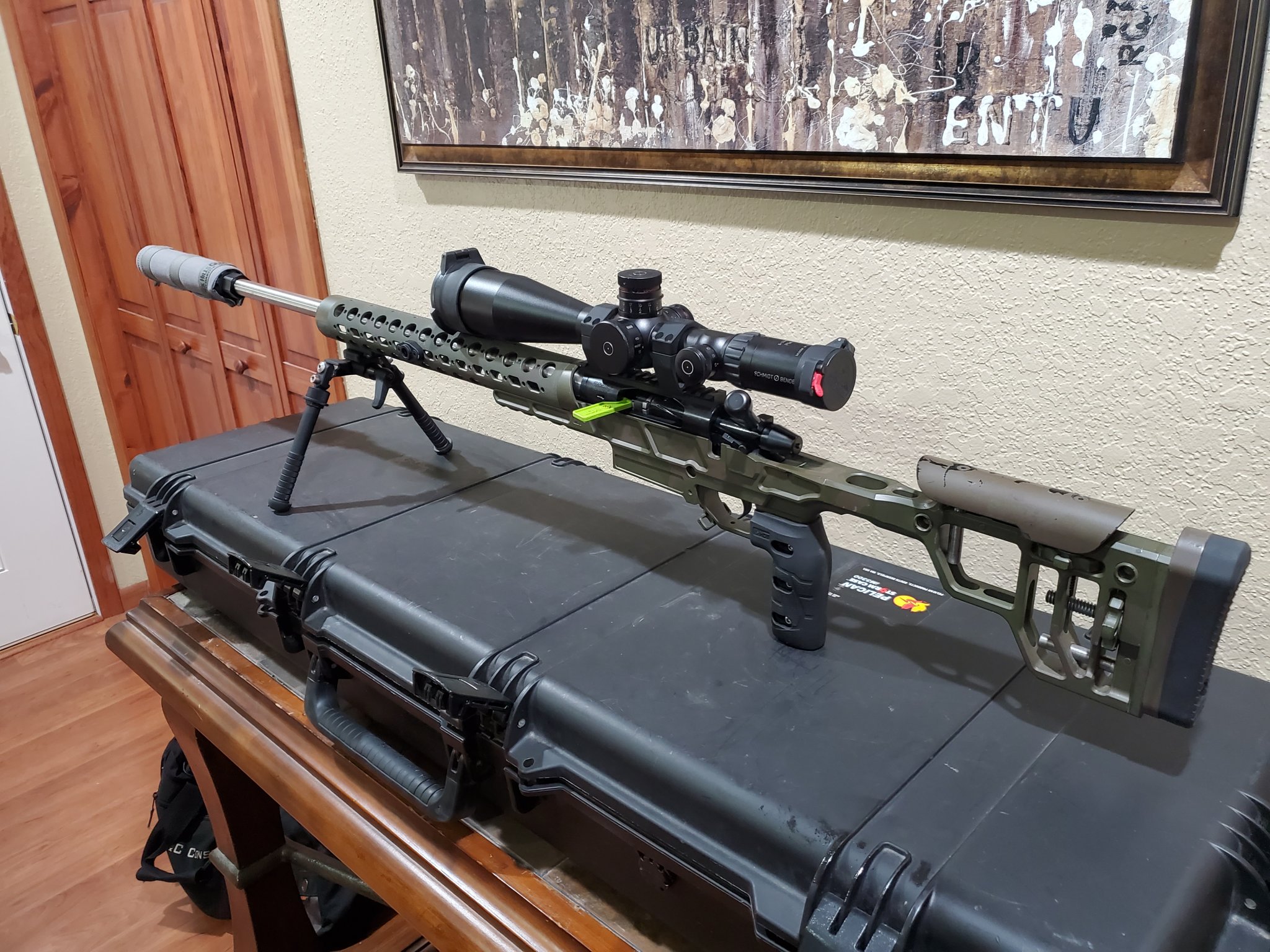

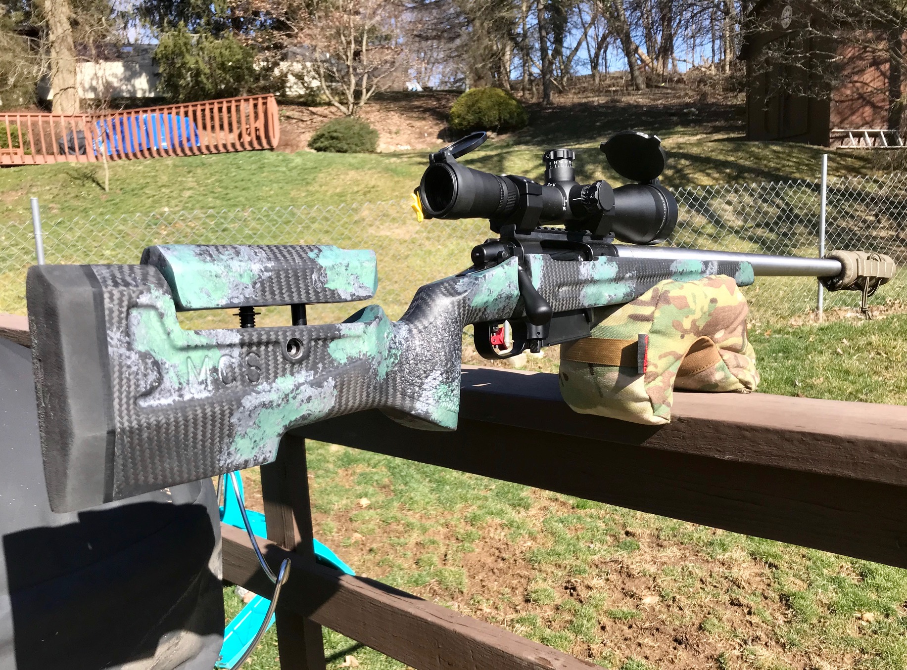

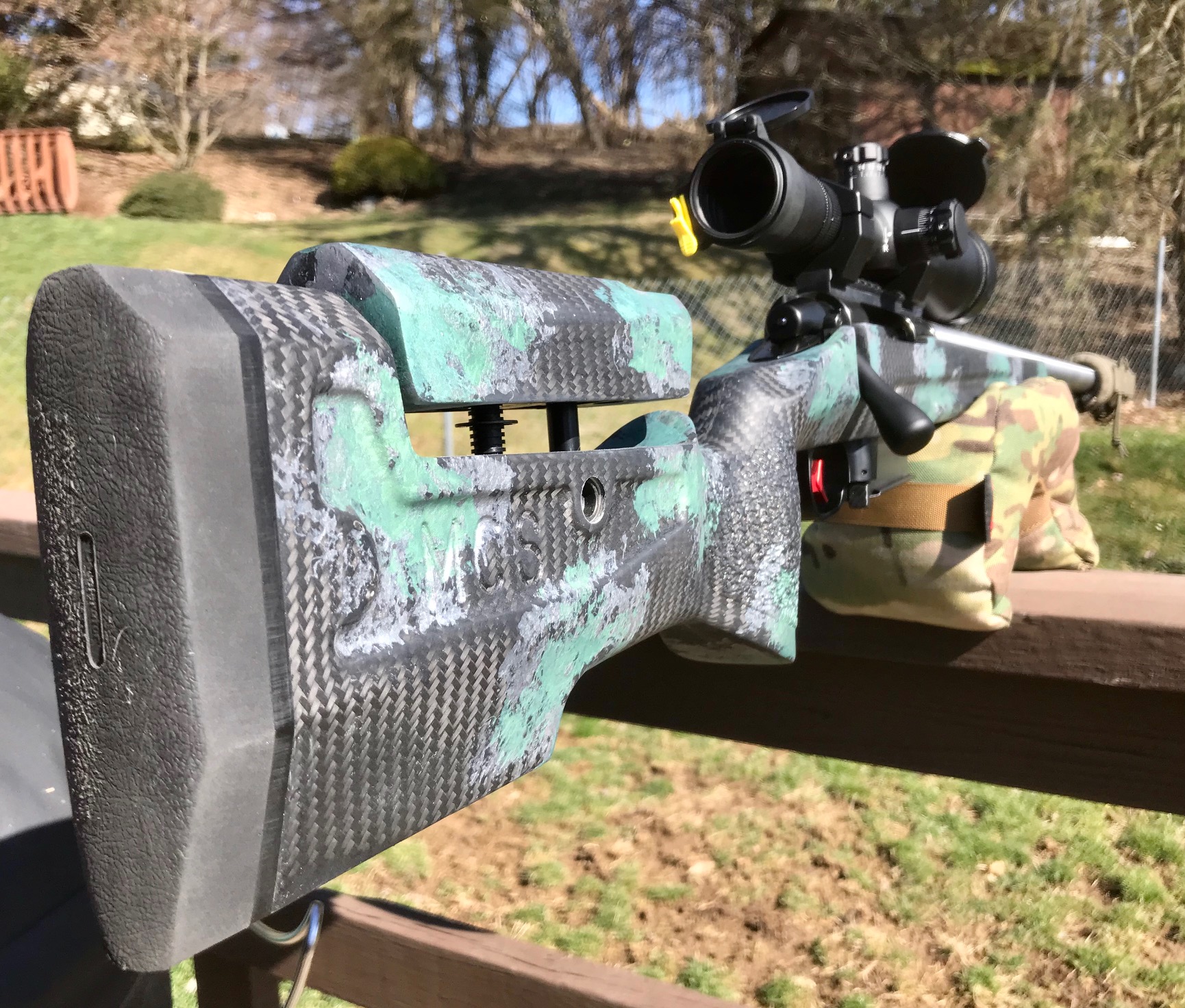

New origin sa in 6creed. Giessele 700 2 stage trigger, ax chassis, and 26" 8 twist criterion 6creedmoor barrel. Mpa 1.250 tall mount with xrs2 in it. Great action, cant say much bad about it. I didnt like the bolt handle length, it was kinda short and I was using longest knob they had. Dolomite, fellow hider, spun up a couple extensions for me and did a great job.
New origin sa in 6creed. Giessele 700 2 stage trigger, ax chassis, and 26" 8 twist criterion 6creedmoor barrel. Mpa 1.250 tall mount with xrs2 in it. Great action, cant say much bad about it. I didnt like the bolt handle length, it was kinda short and I was using longest knob they had. Dolomite, fellow hider, spun up a couple extensions for me and did a great job.View attachment 7265792View attachment 7265793View attachment 7265794View attachment 7265795
Do you know if he has any extra of those long bolt handles/extensions?
I'll text a link to this thread. He sent me a .5 and .75" extension, but I'll let him handle the supply/manufacture side, lol.

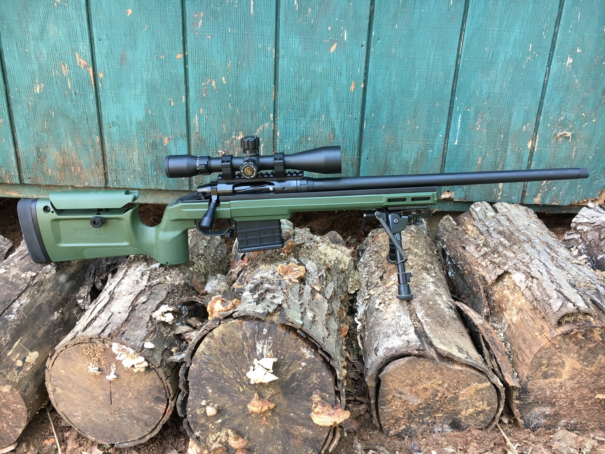

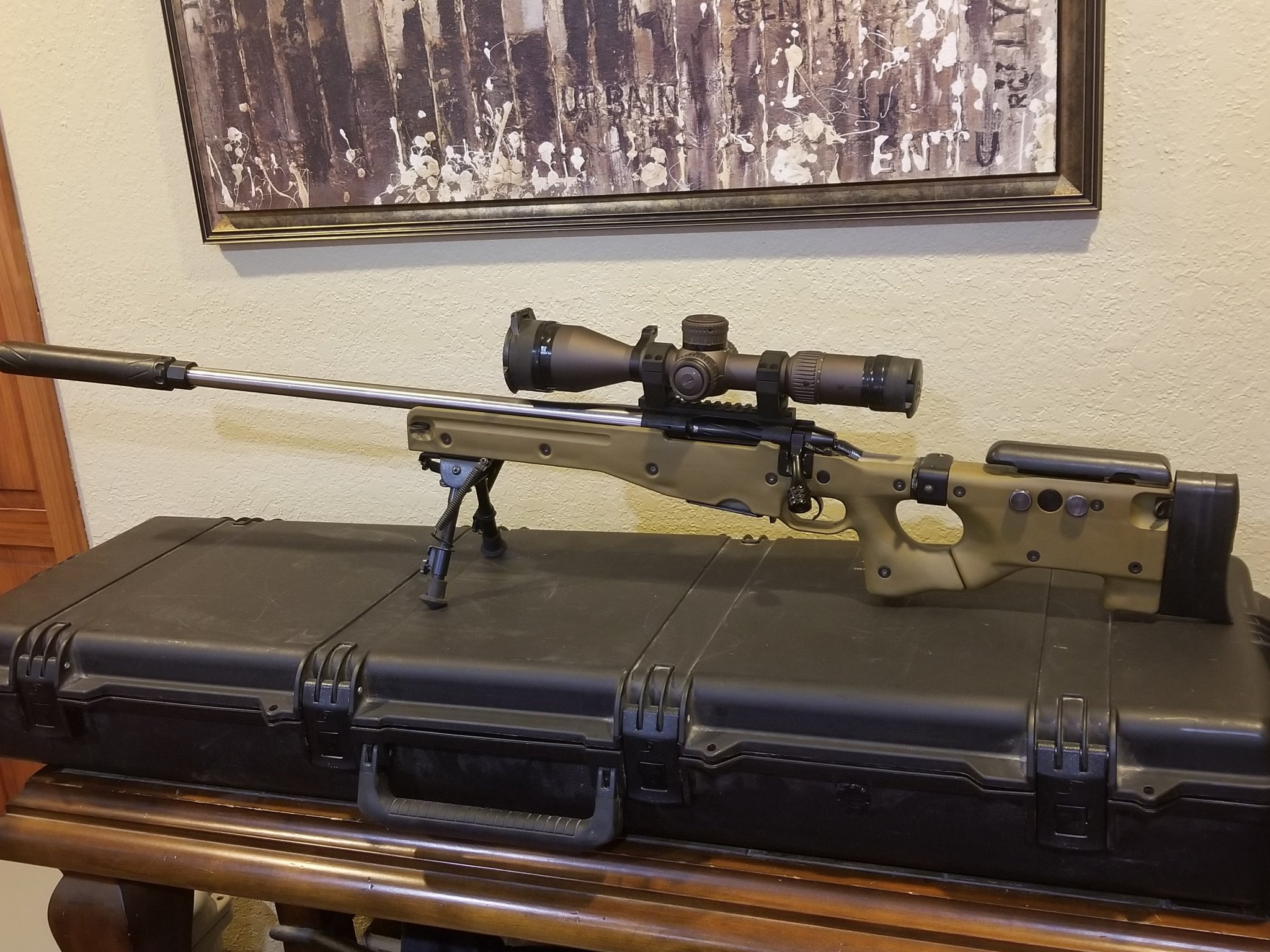

Well its assembled origin with 26in proof 6.5cm
Triggertech flat primary
area 419 hellfire
Have a vortex pst 6-24 going on it but need rings and to just decide on a dam stock or chassis been waiting for a stockies vg2 in bare carbon but thinking may go another route now or maybe an mpa matrix

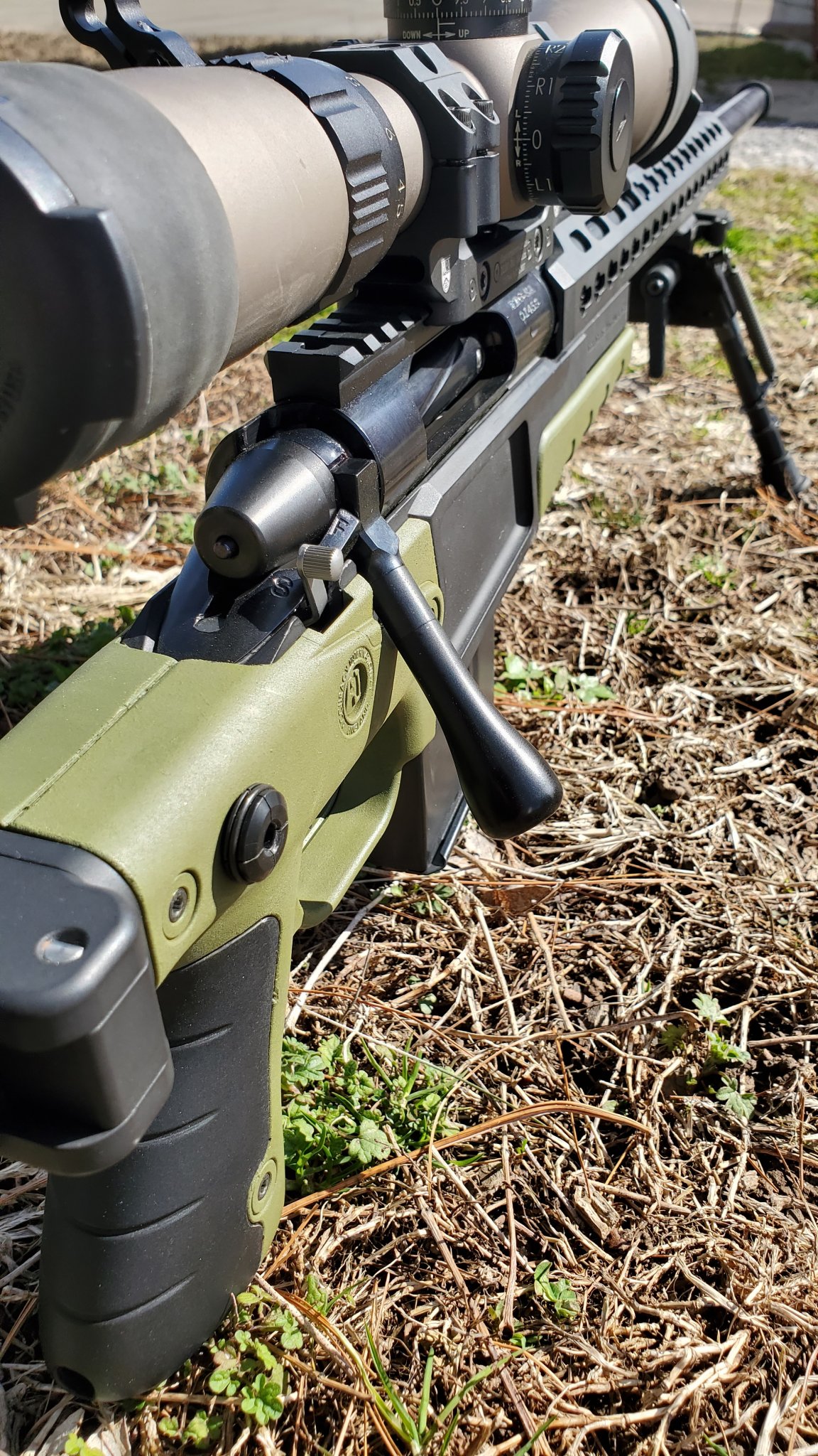

Here's my Dasher. It's in a PRS-1 with a 26" Proof Competition in 7.5" twist, Hawkins bottom metal, and a Timney Calvin Elite. It's borrowing the Mark IV off of another rifle for the time being. I'd like to get another Nightforce NX8 or an ATACR for it when funds allow. I'm really digging the construction and look of Foundations and think I might opt for one of them in the future instead of the PRS-1.

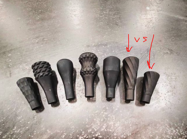

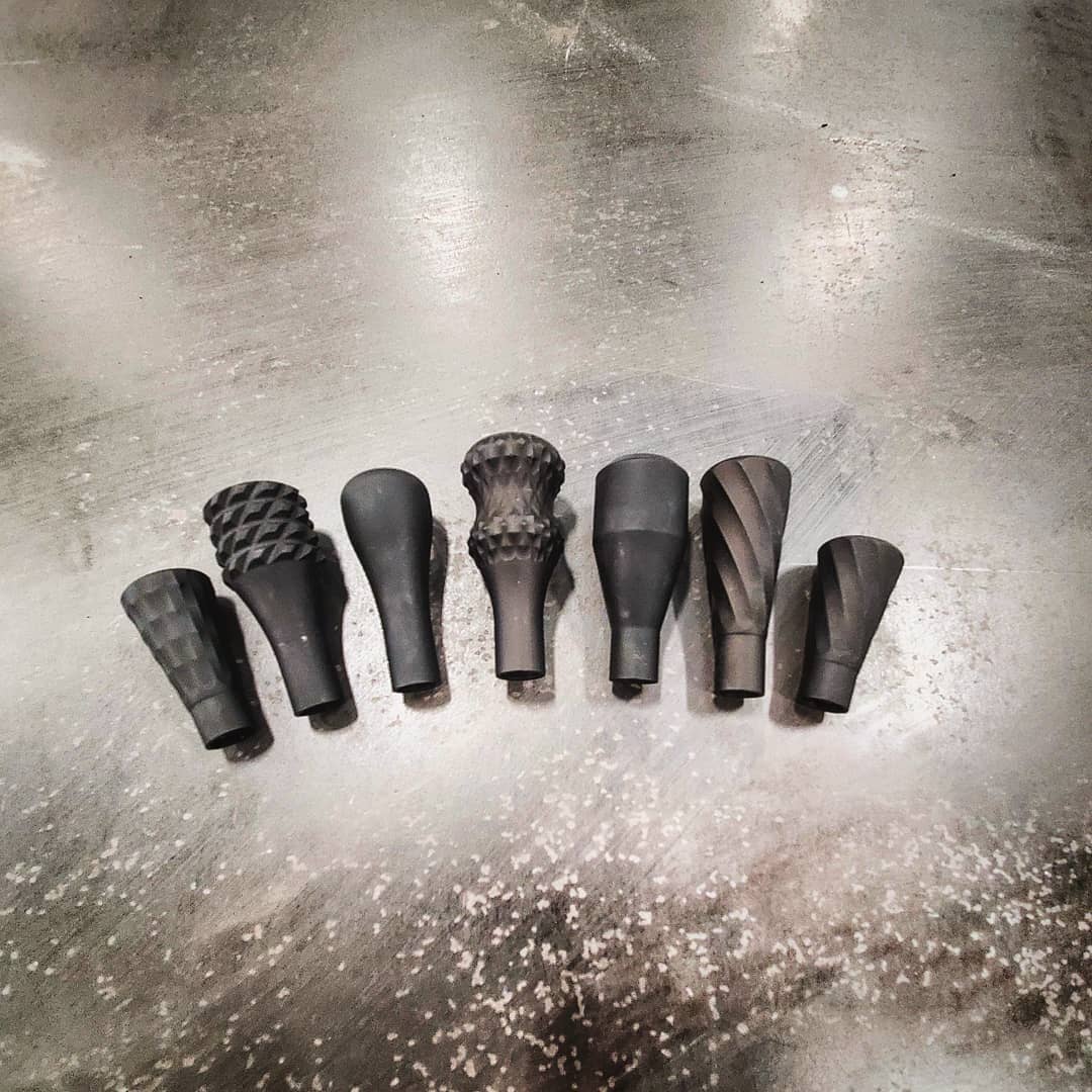

Just so everyone is aware, our Spiral Extended and Competition bolt knobs are longer than any of the original 5 and they are available through our website today.
Here's a picture to show the differences.

I find the smaller bolt knob size and 1/2" extension is perfect for keeping away from scope. Those knobs look nice, but with bigger knobs and maybe .25" longer, not sure theyd made a difference for me.

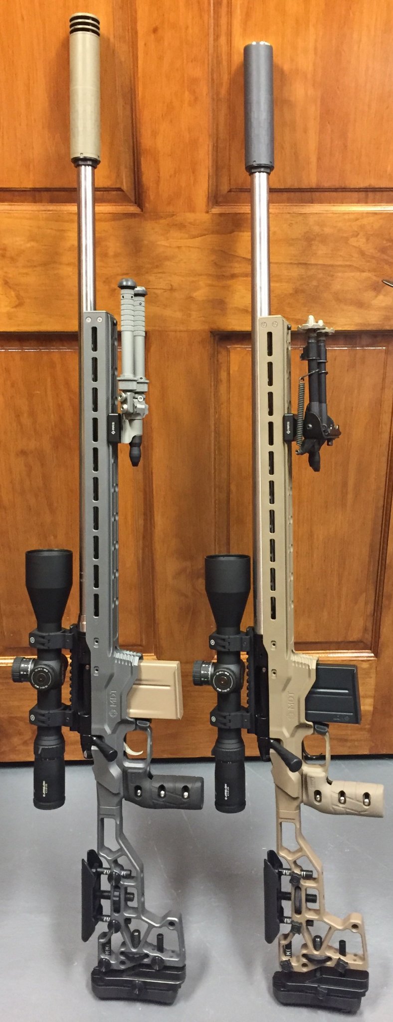

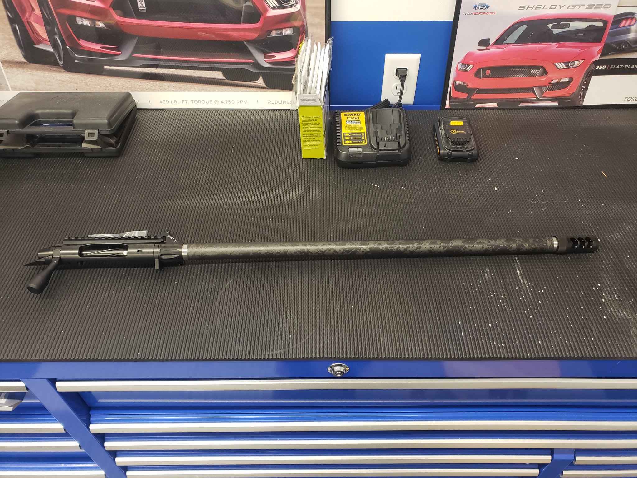

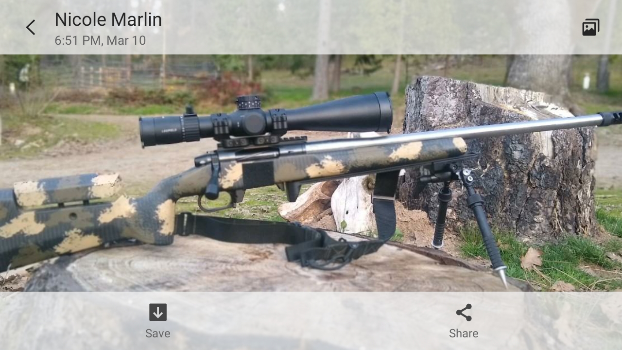

Bighorn orgin "oviasll
Pva 7 saum 24"
Manners t2a carbon fiber
Surgeon dbm
Hellfire 419
Leopold mk5 cch
Mpa mount
Atlas cal gen 11
Can't wait for Saturday

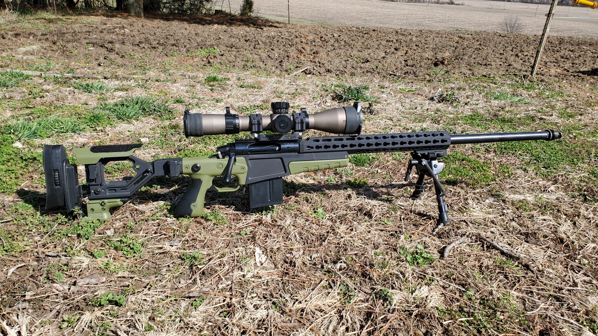

Origin with push feed bolt head
26" 1-8 CBI 223 Ackley
PVA barrel nut
TT Primary
CAL 2
Bravo
EBR-7C Viper
Went out to try out the new barrel and start fireforming brass. Wasn't dissapointed with 1/2" groups using cheap 50 gr Dogtown bullets I had sitting around just to get the barrel broke in and make some brass. After 75 quick rds through it and a deep clean I'm excited to see what it can do. Really liking the Origin and a big thanks to Ray for taking care of me.
