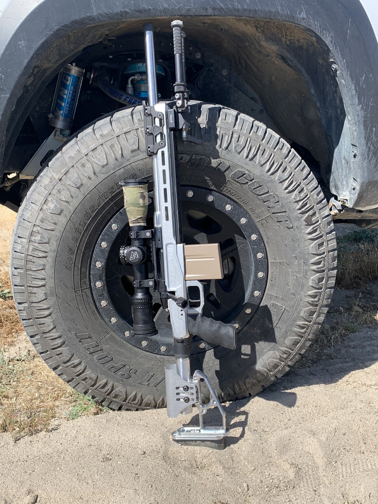

Bighorn is in my XLR Element chassis, still waiting on my barrel.

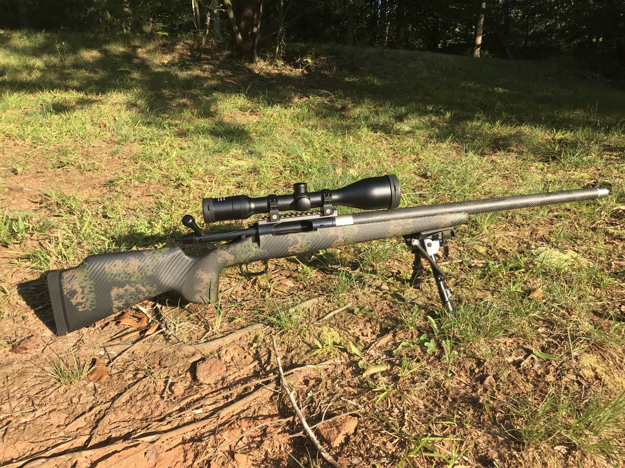

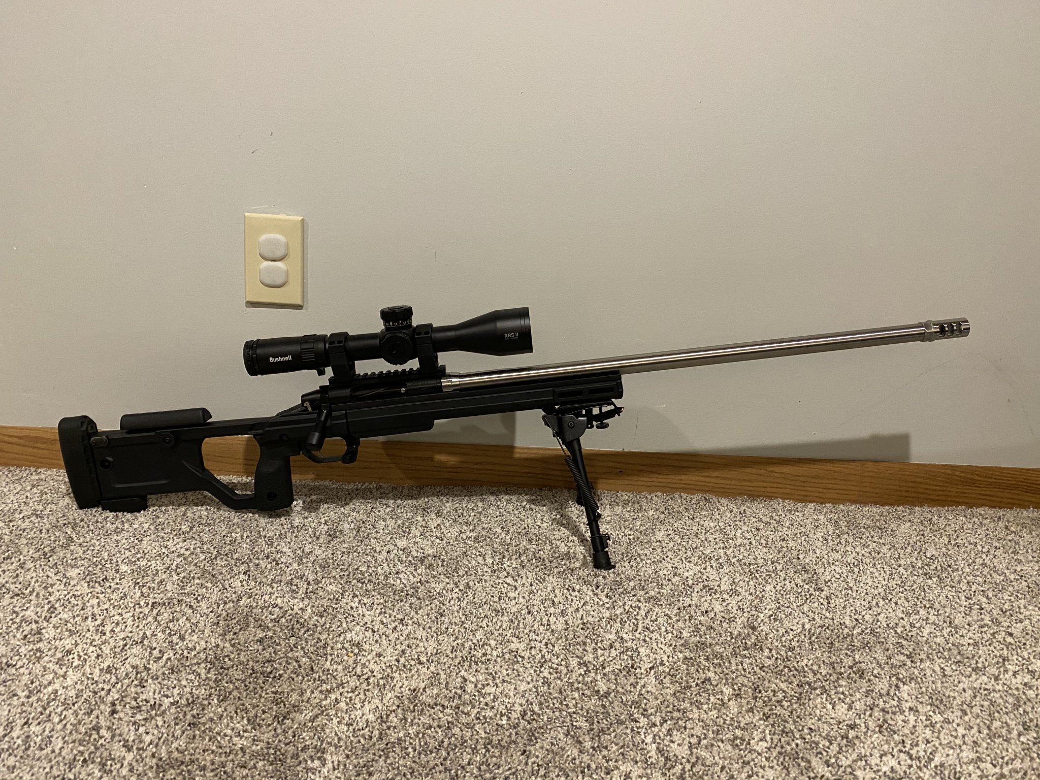

Just finished my "Budget" Build and can't wait to get it sighted in when the weather clears up!

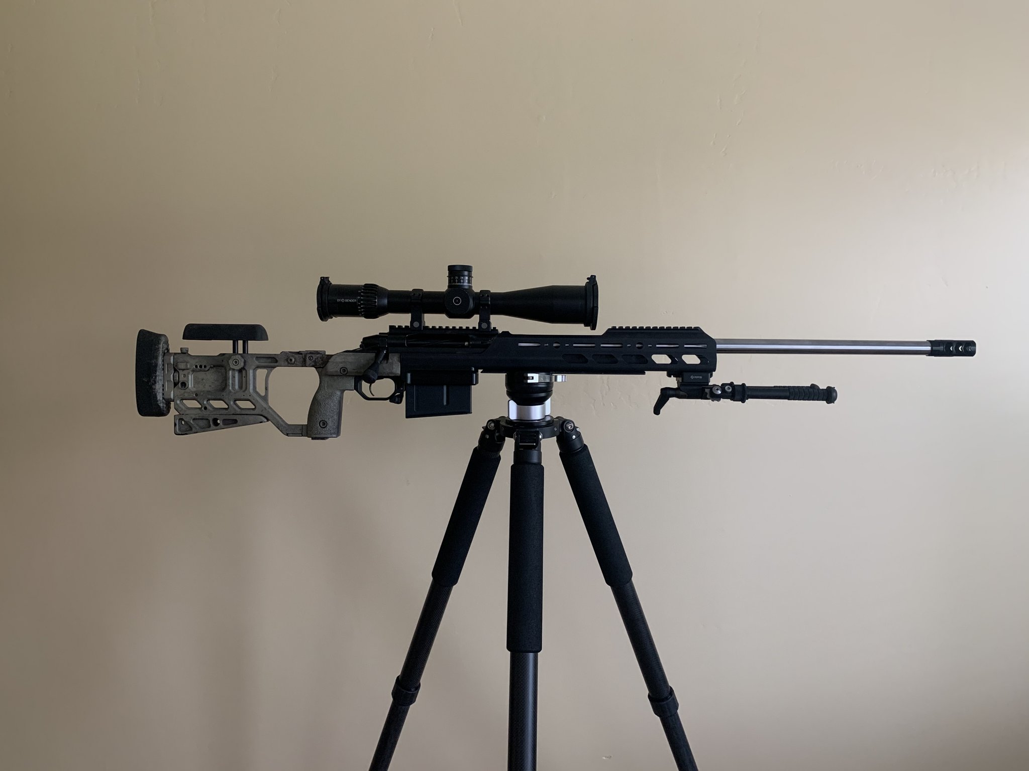

Origin Action
Triggertech Special
KRG Bravo
KRG Minimalist Spigot
Magpul Bipod
Criterion 26" 6.5CM / NSS Varmint Profile
Northland Barrel Nut
Area 419 Hellfire
Seekins Precision 34mm Rings
Bushnell Elite Tactical DMR 2 PRO

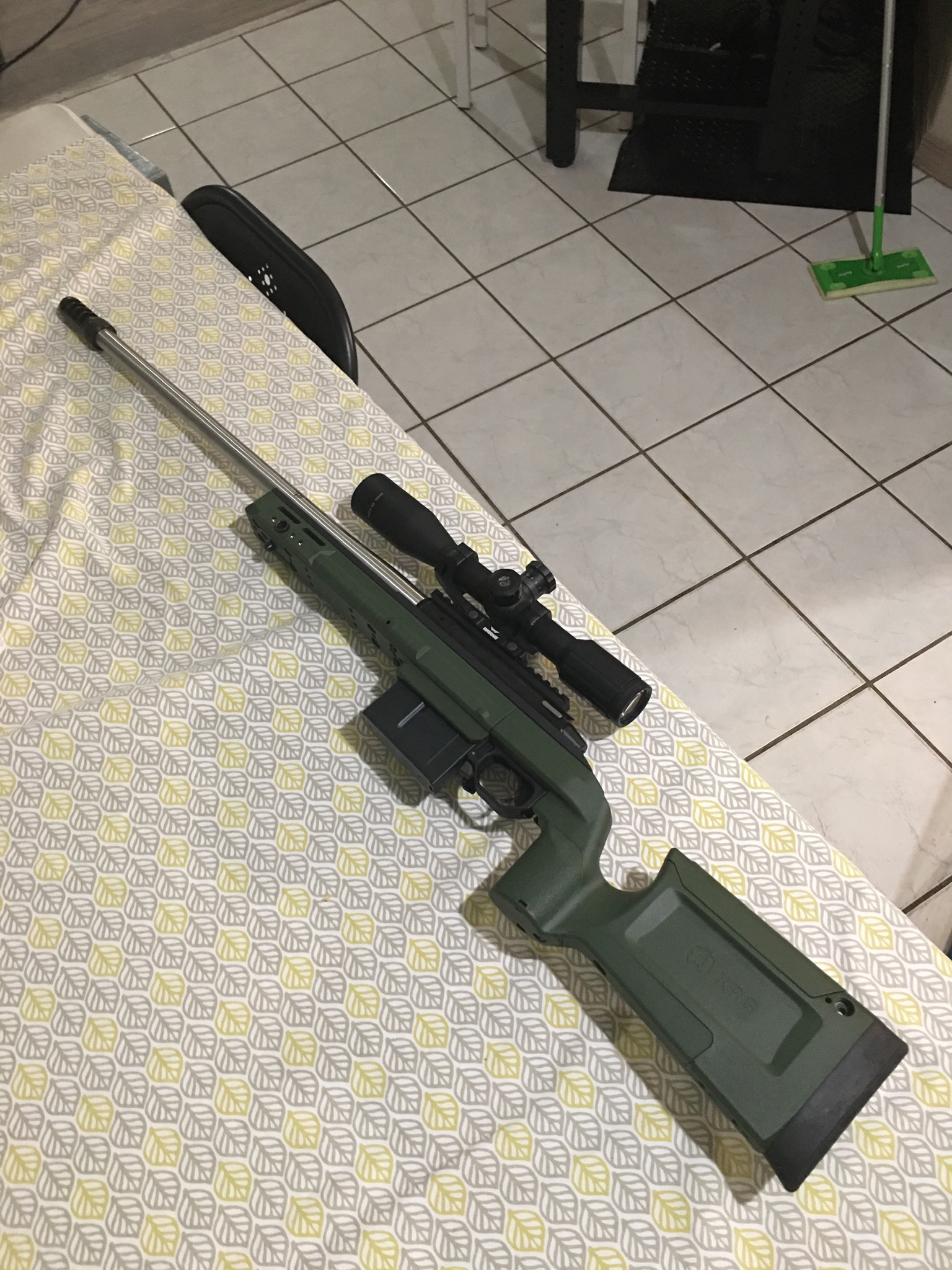

Im in love with this build so far.

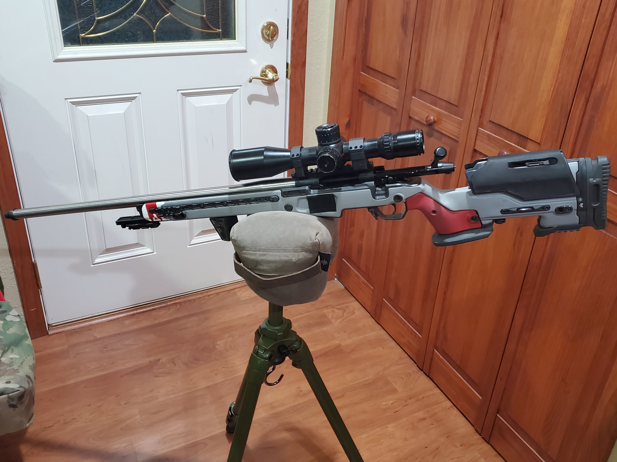

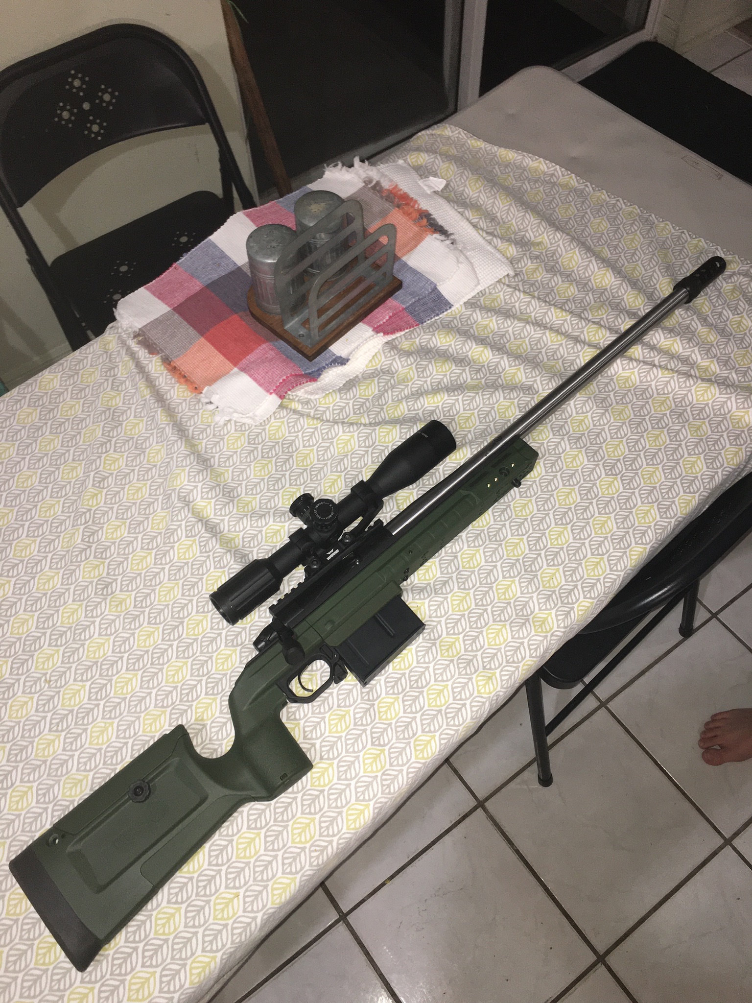

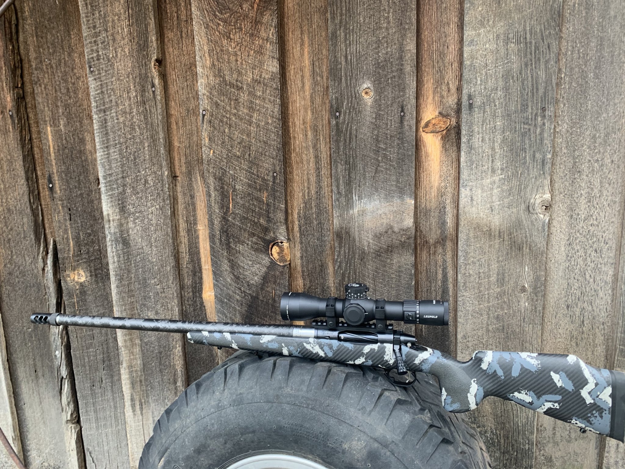

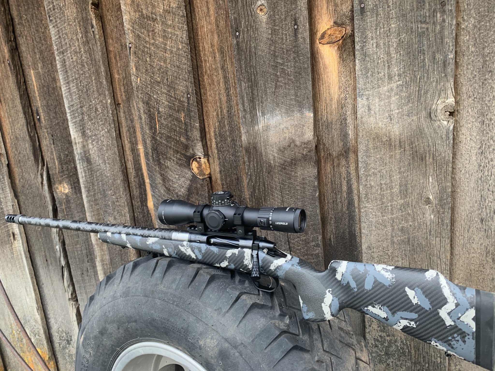

Finished this for my father yesterday:
Origin Action
TriggerTech Special
KRG X-Ray (need the spigot)
26in Shilen Stainless 6.5 Creedmoor with NSS barrel nut
APA Gen 2 Lil Bastard
Harris Bipod
Bushnell XRS II with Vortex Precision Rings (lower rings on order, used what I had on hand from another build).

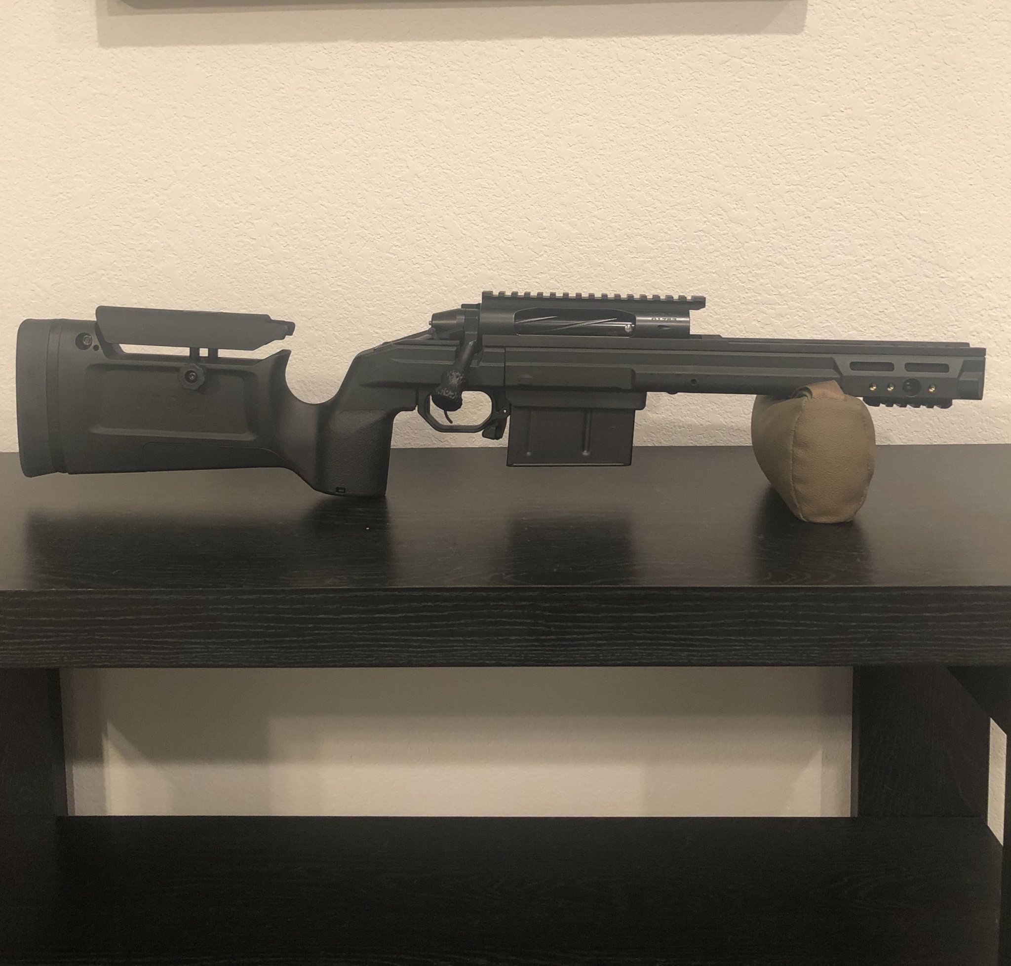

Mini chassis? And no ejection issues or bolt release issues?

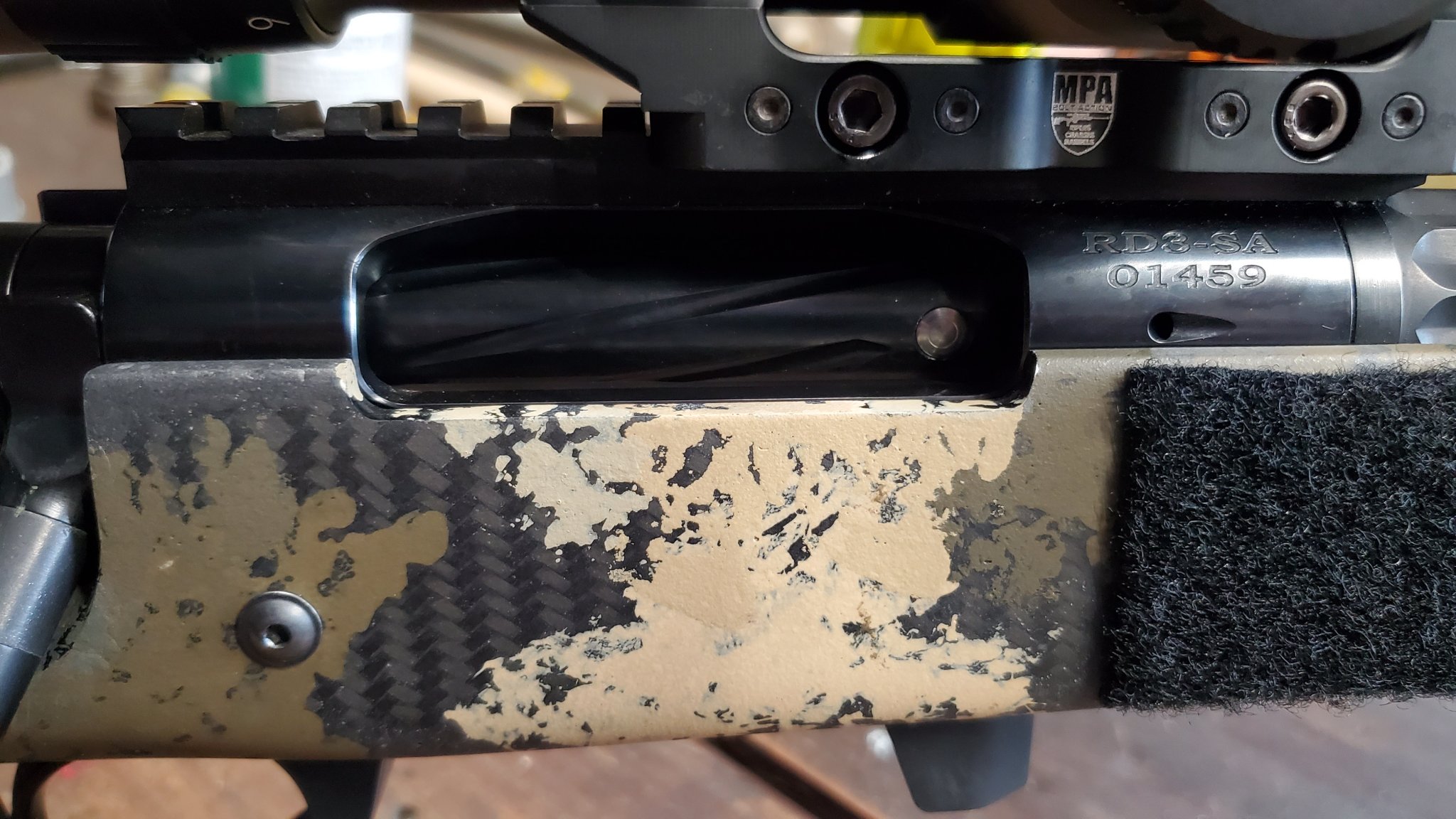

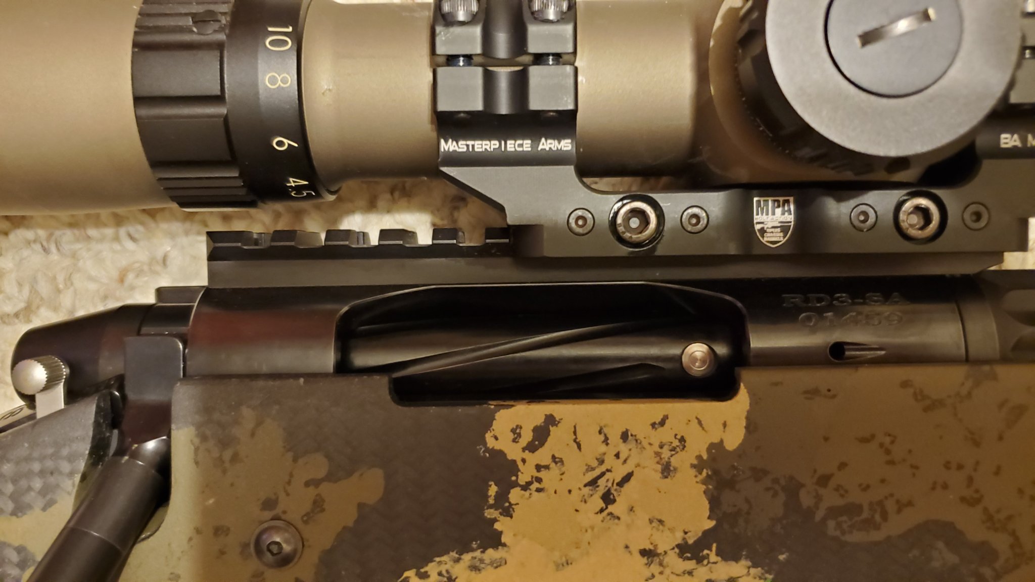

Origin in a t6a gen2 mini chassis, 700 ejection port inlet but came with a bolt release cut
After a little careful hand filing.
I was running a 6creed barrel on it, brass ejected cleanly but they did just glance across that 700 cut. Not enough to alter ejection pattern, but it bugged my ocd.
Reactions: Lunchbox27
This was in an ax chassis but recently moved to this t6a. Just finished putting the 3way adj butt plate on, haven't really adjusted yet other than pad height.

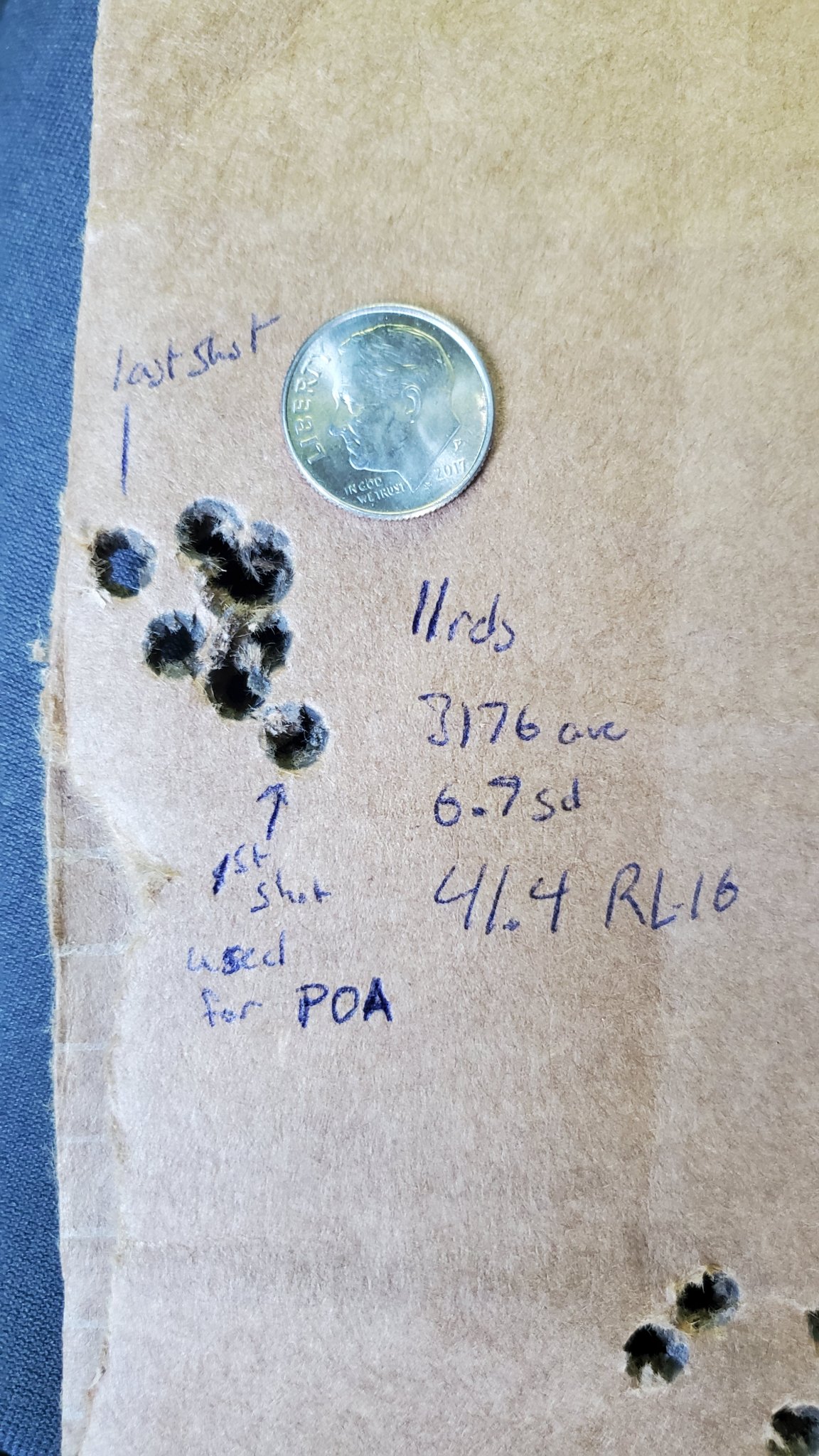

Barrel sped up and was testing some slower loads. Shot the old load that had sped up 50fps, but was out of poa on target. Put 1 rd for aiming point and shot 10 more, I can cover 9.5/10 bullet holes with a dime.

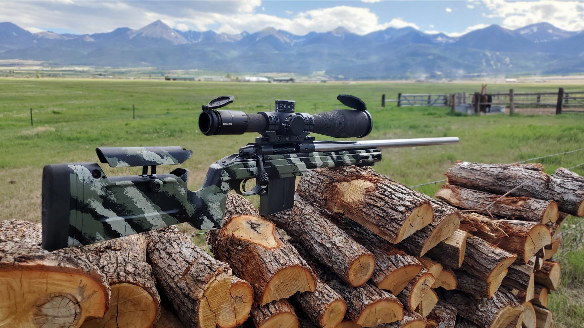

Finally got mine done
Big horn origin Short action
Trigger tech special
Hawkins bottom metal
Wyatts extended box mag
Leoupld mark 5 3.6 -18
Proof 24 carbon fiber
Area 419 hell fire
Mesa precision rifle stock
6.5PRC

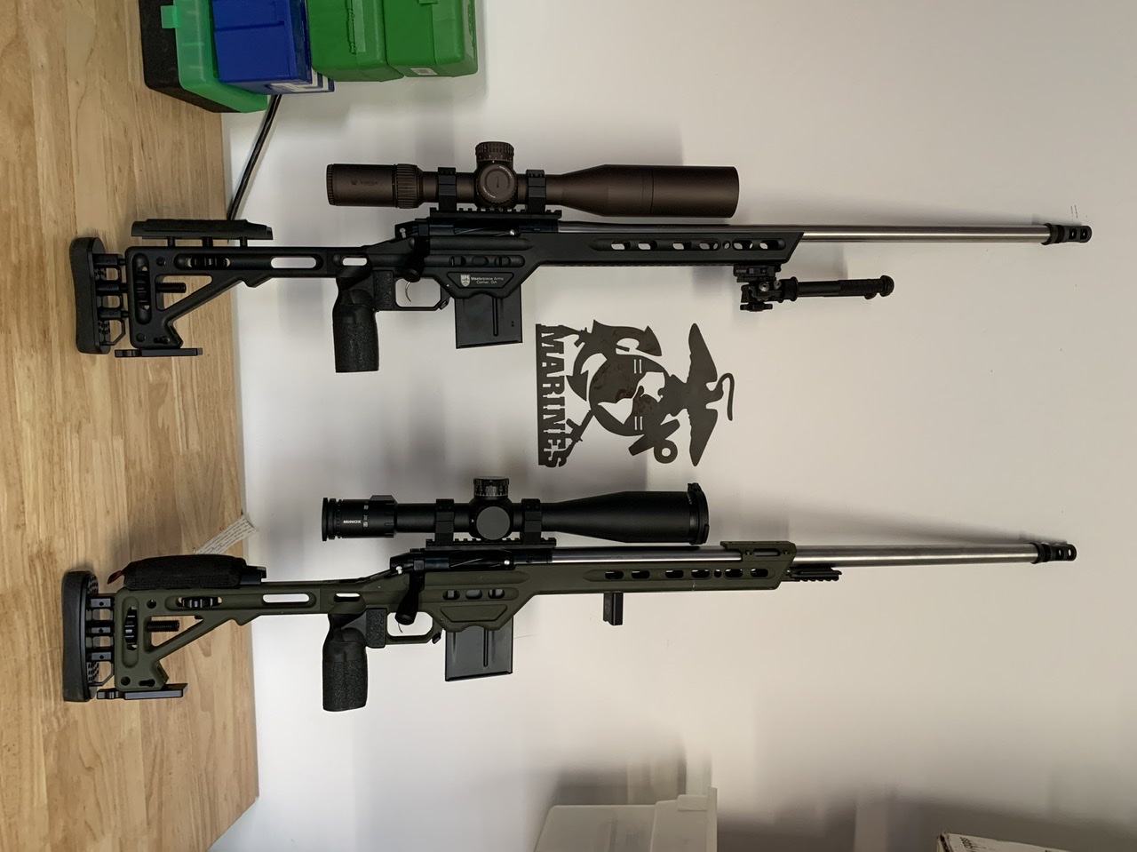

Ended up with my 2nd origin. Both rifles are pretty identical. I posted the 7saum before in black and now have the 25cm in green Don’t know why the photo is sideways. Probably going to get a 3rd and throw a 22” proof cf and a gunwerks clymr on it for a light hunting rifle.
mpa chassis
TT triggers
Minox on the green
Razor 2 on the black
Saum in black is rem varmint contour
25cm in green is m40 contour

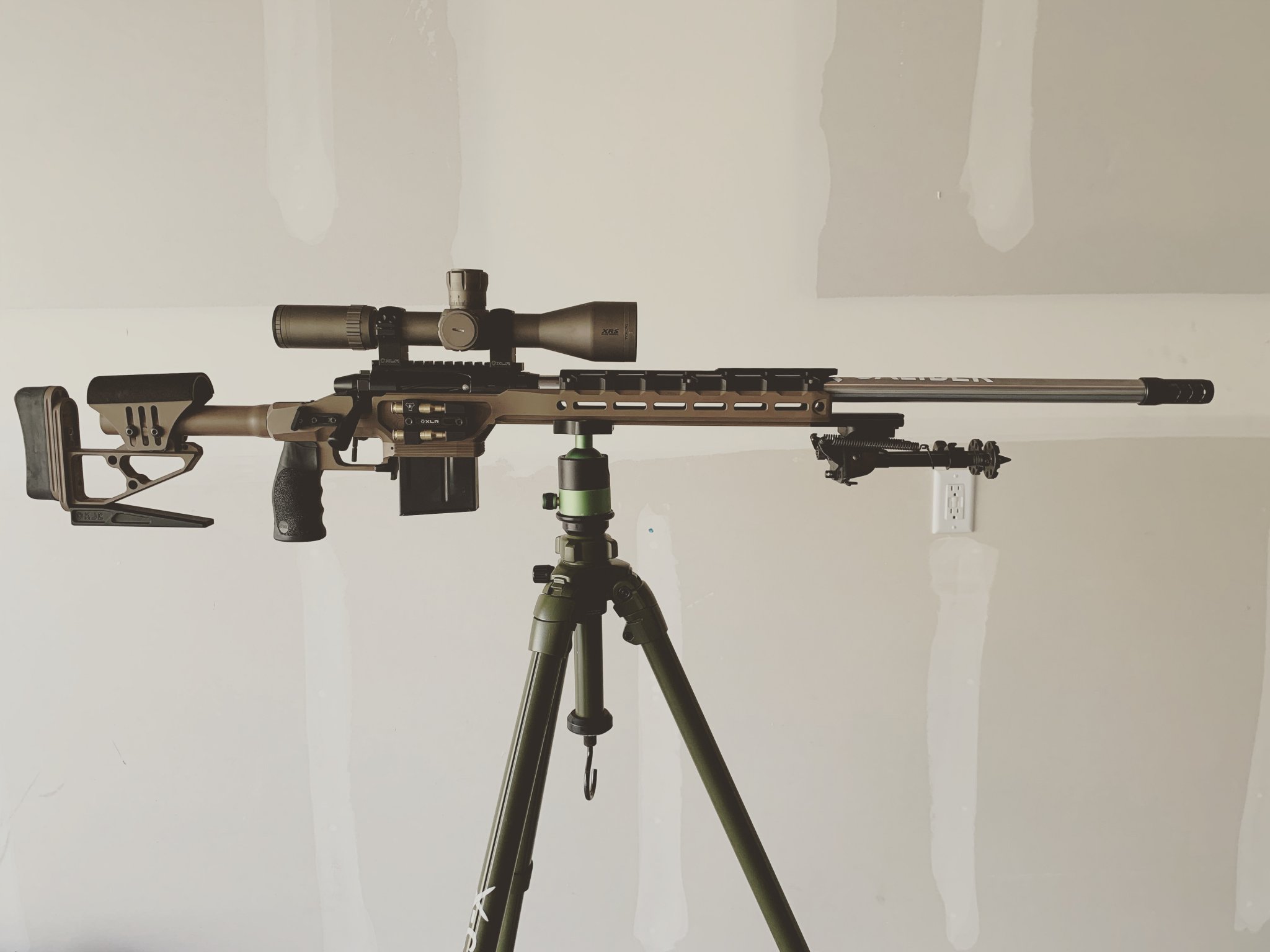

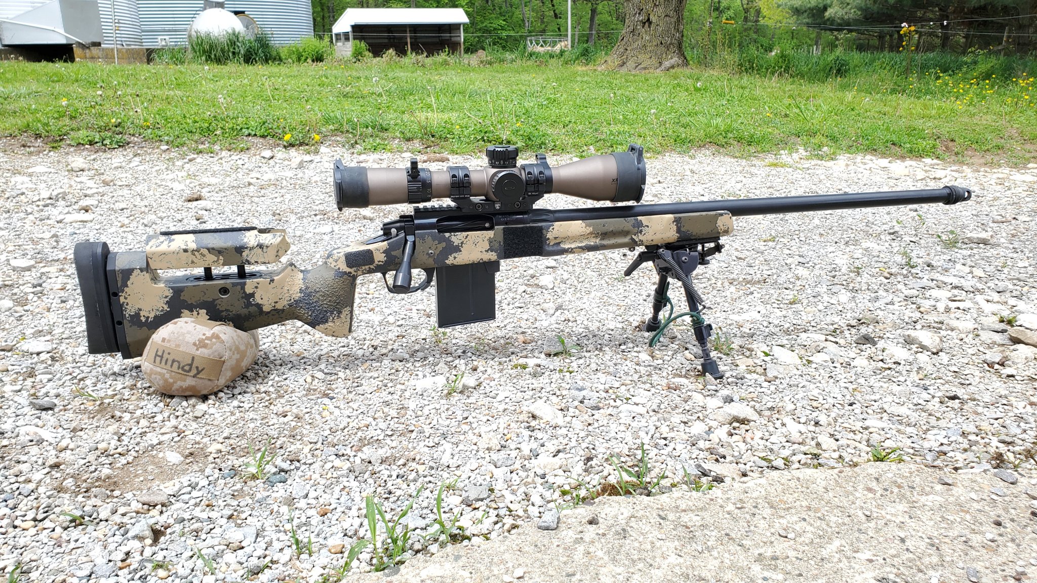

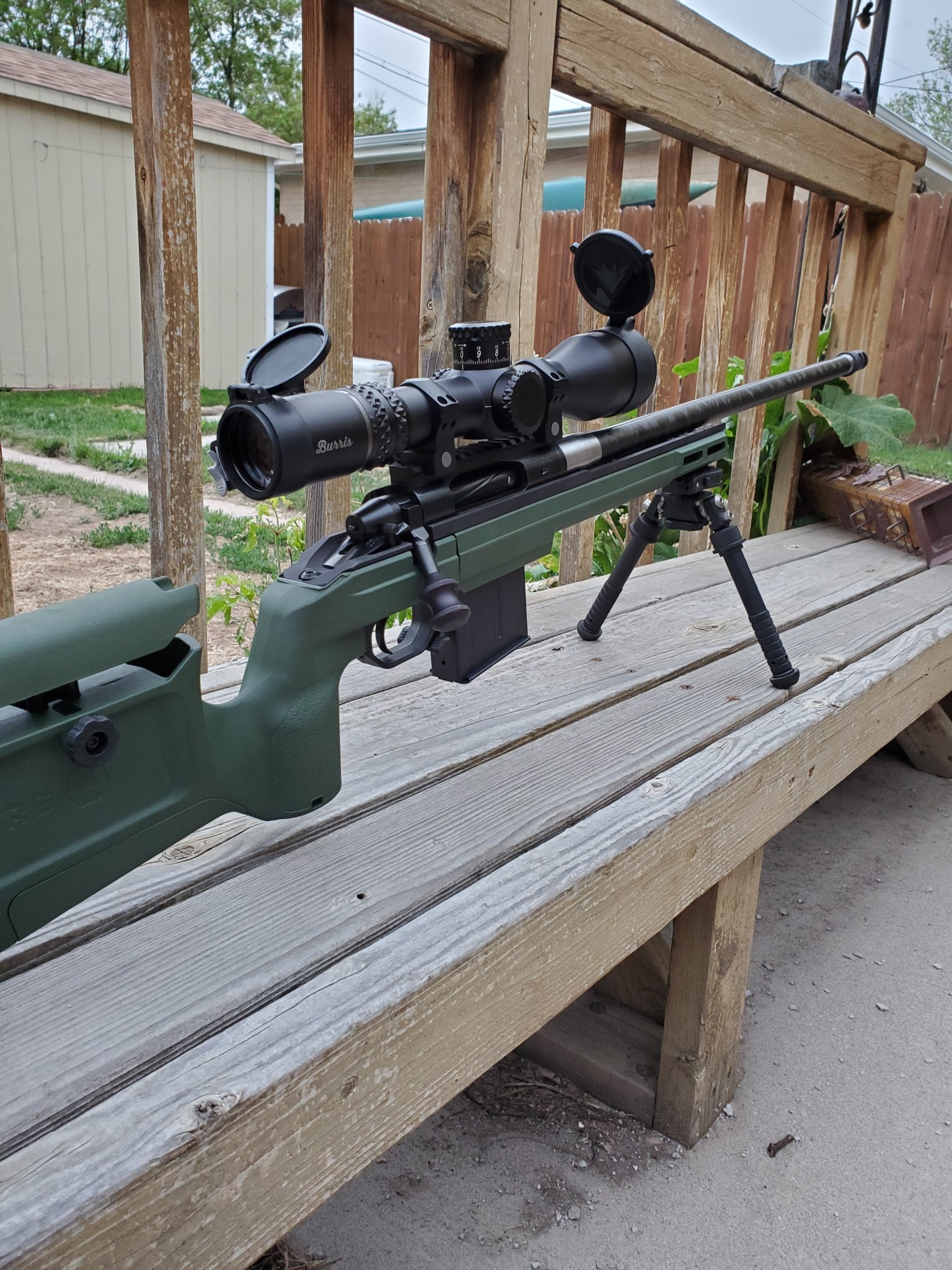

Switched my origin from my match rifle to my hunting rifle.
Orgin SA
6.5 prc built by fritz at black canyon customs
Triggertech special
Bartlein CFW remington varmint 1-7.5 twist
Krg bravo
Timed Thunderbeast brake
Burris xtr3 sc2 3.3-18x50
Nightforce rings medium 1"
Atlas bipod

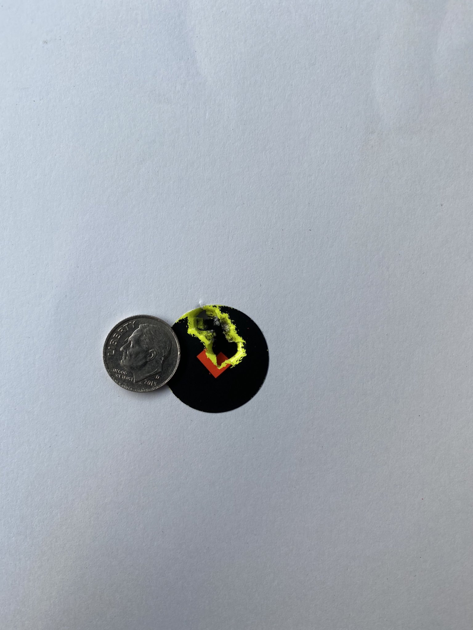

Got a 5 shot grouping of .3 moa this past week with it. Just need more practice now.
