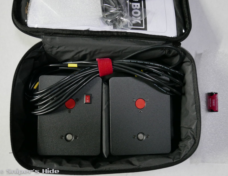

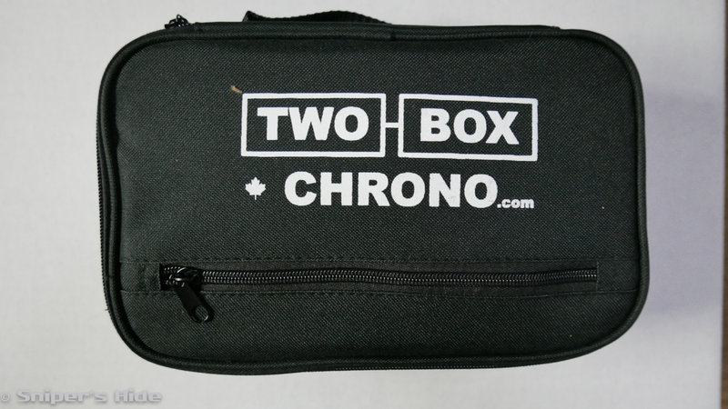

Two Box Chrono arrived today , will be out on Wednesday with it
Super small footprint which I like
I could not get a single reading out of the Two Box... Set it up according to the directions, nothing.
Maybe I was shooting two far, I had it exactly 11ft in front of the muzzle and lined up. But I was shooting out beyond 1000 yards so I am wondering if that had something to do with it.
I am gonna write them to see what I was doing wrong ?

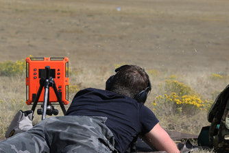

Triplebull, what tripod is that in your picture?
It's a small Manfrotto. I don't think they make that exact unit anymore but it's similar to this one:
https://www.bhphotovideo.com/c/prod...mkbfrc4_bhz_befree_compact_travel_carbon.html
You can rotate plugs on top of the legs to control the angle of the legs. In the photo, it is in the taller mode. Recently I moved to the broader angle setting to avoid wind knocking it over. The head I'm using is also Manfrotto:
https://www.bhphotovideo.com/c/product/1217460-REG/manfrotto_460mg_3d_magnesium_head.html
This rig was bought for doing photomontages in the back country to keep weight down as it's too flimsy for "real" work. But it's fine for the LR.

I can't help make the Labradar sturdier, but I can relate some things we do with cameras to make our tripod setups sturdier (vibration is a bitch, especially when we're talking about shooting with super-telephoto lenses at slow shutter speeds, or other very heavy rigs). Heavy is your friend - yeah, you have to hump it around. If it blows over in the slightest breeze, it's not useful, so there's a balance there. But... you can make a tripod heavier by simply hanging your bag on it. That's why you see tripods with hooks on the bottom of the center platform (I added one to my Gitzo tripod a decade ago for exactly this purpose).
Keeping it lower helps, too, but obviously there's only so much you can do.

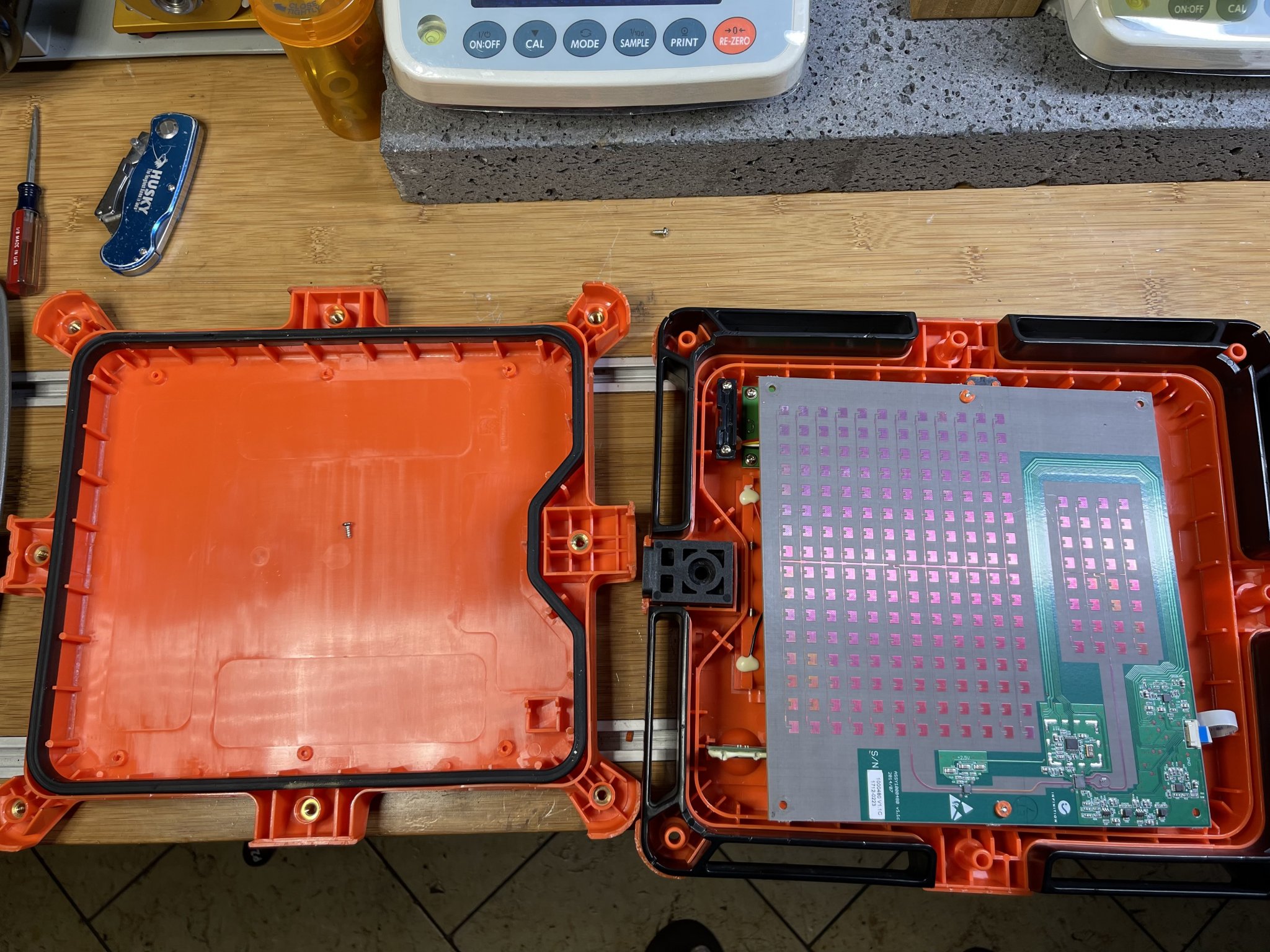

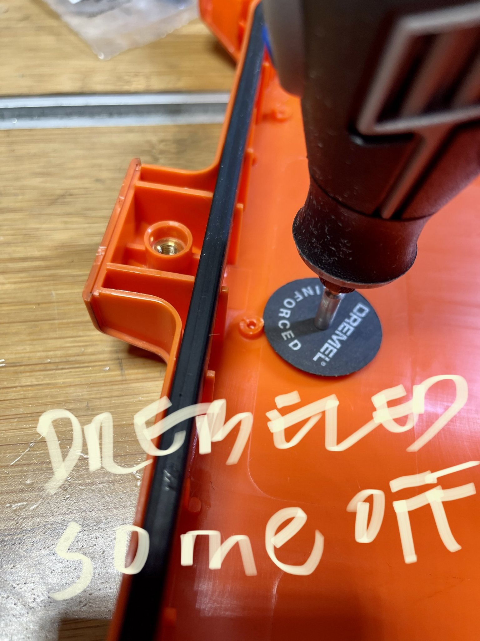

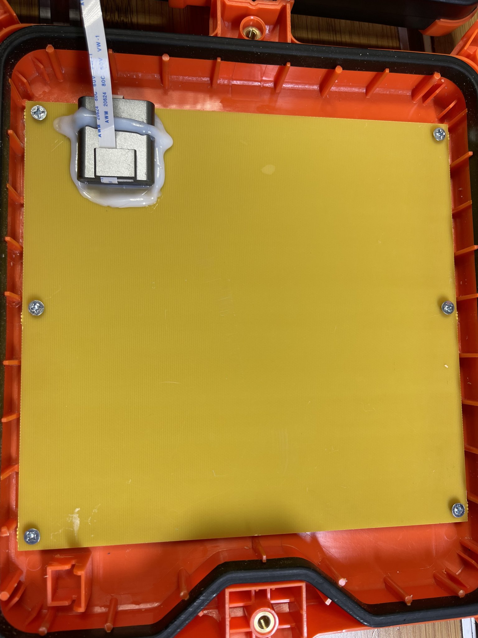

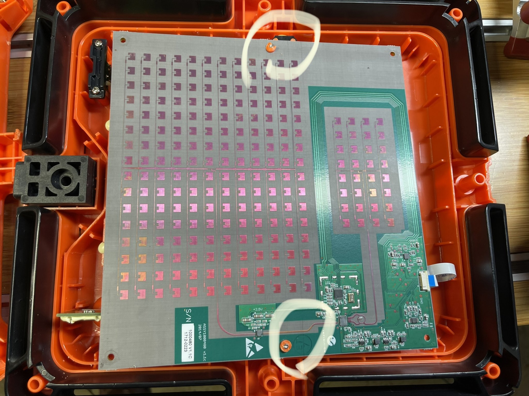

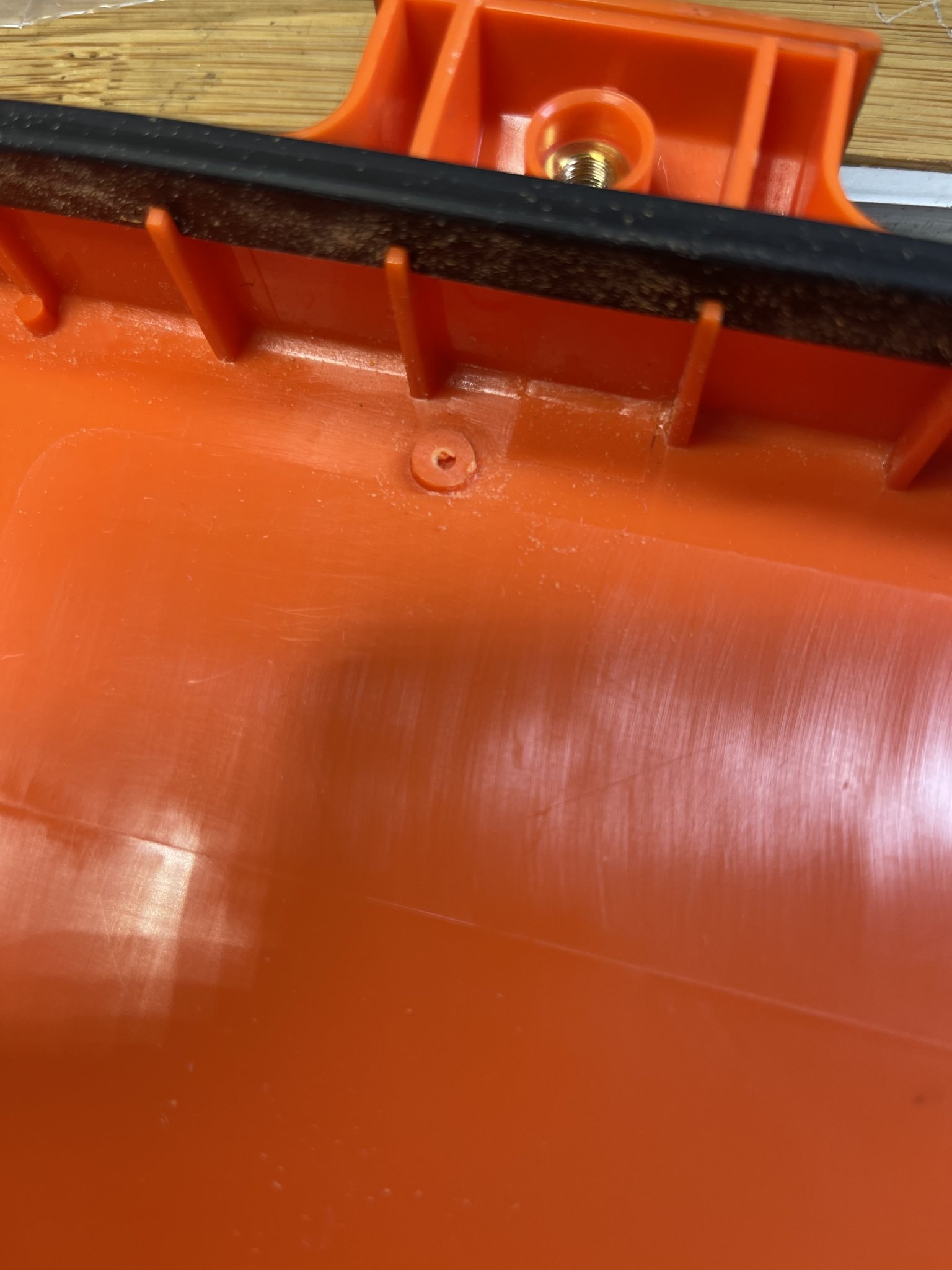

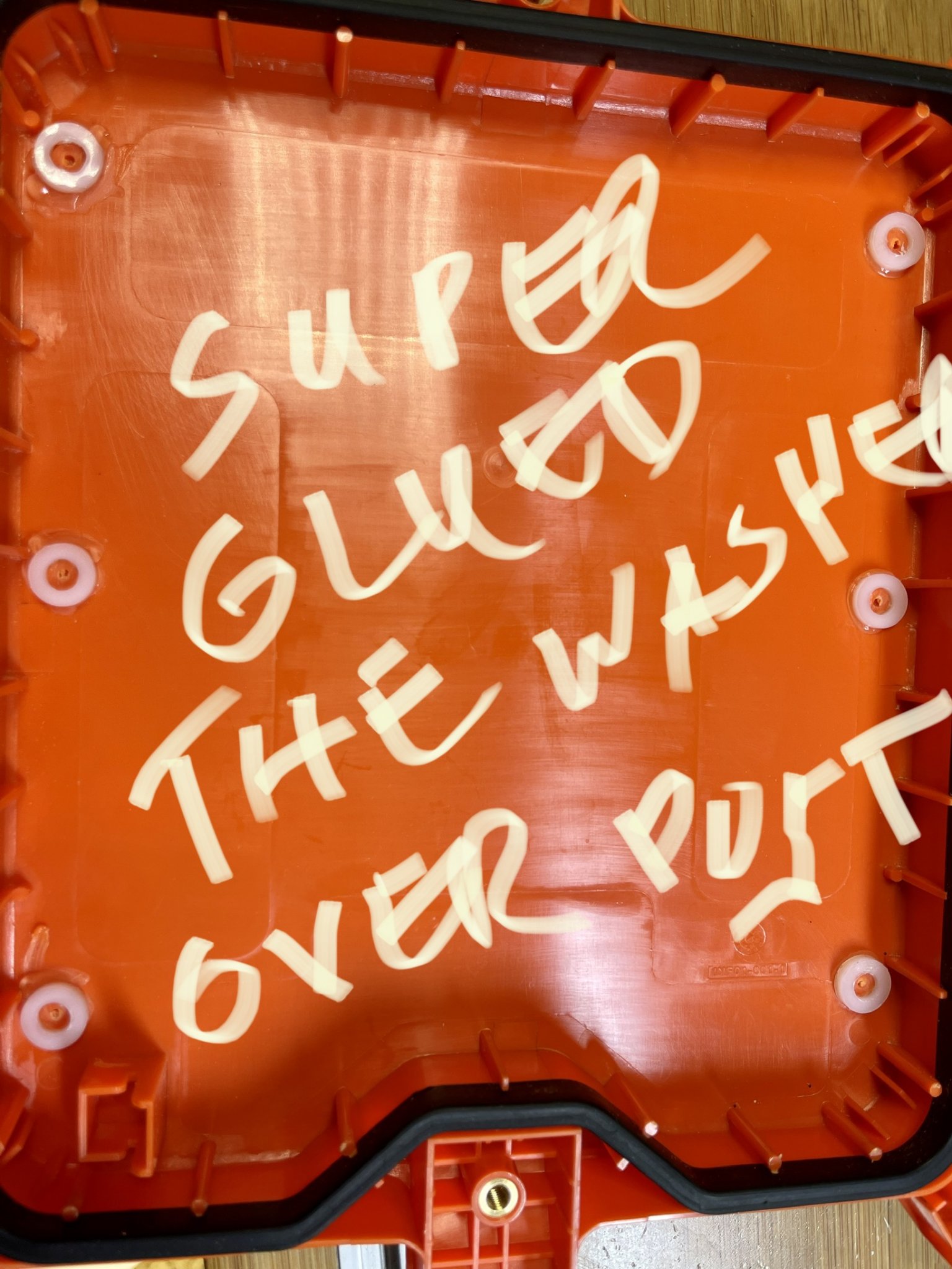

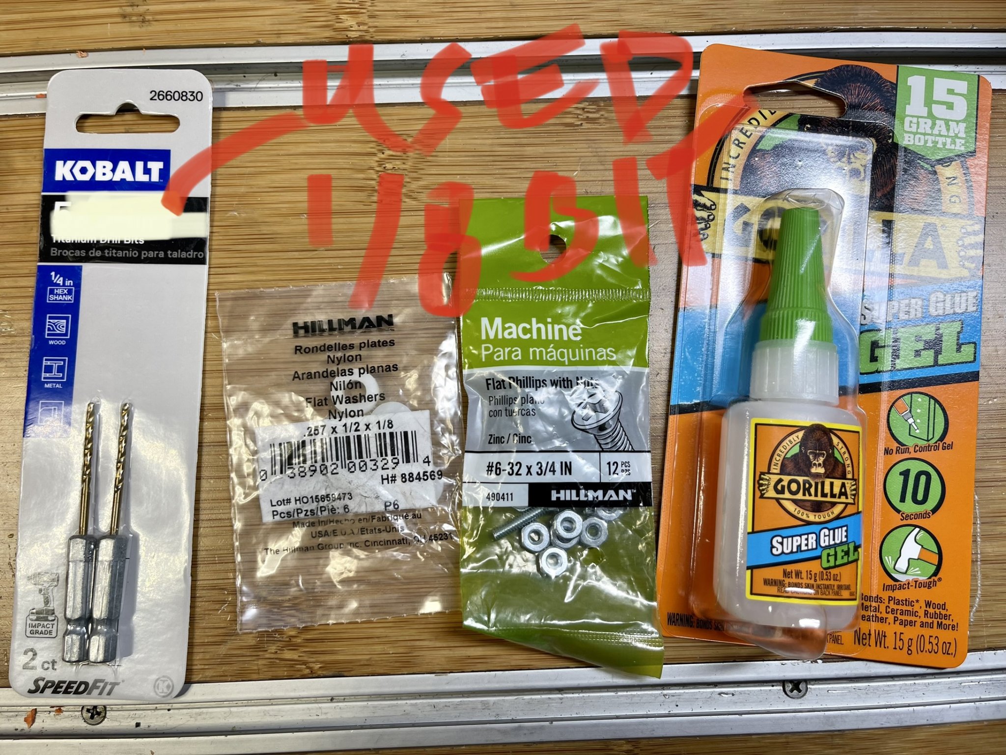

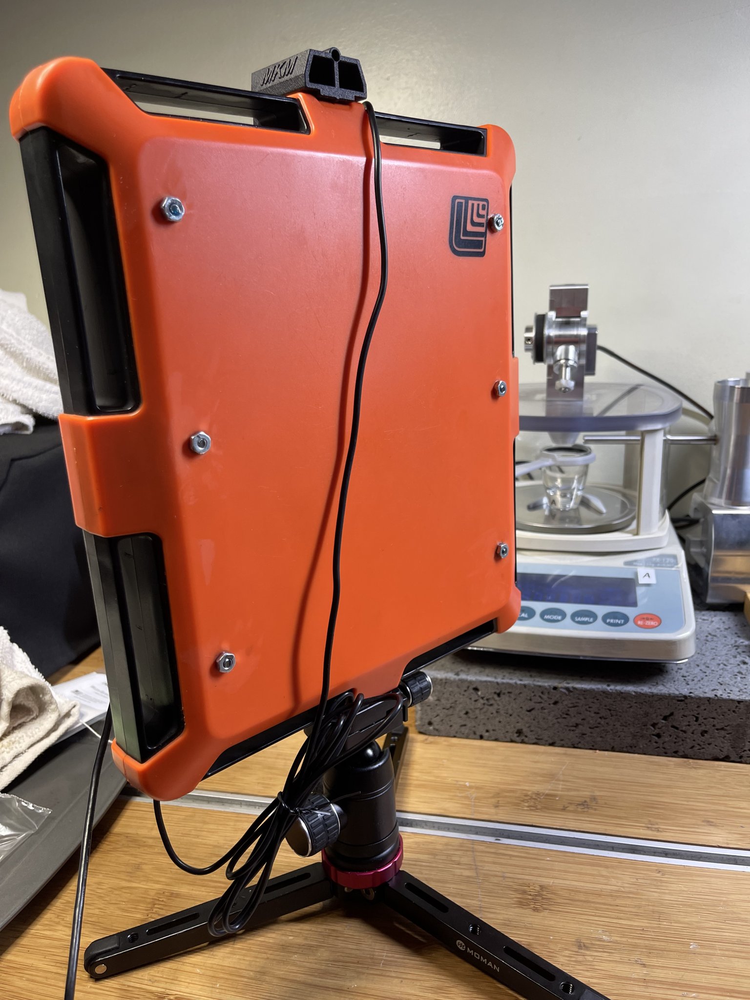

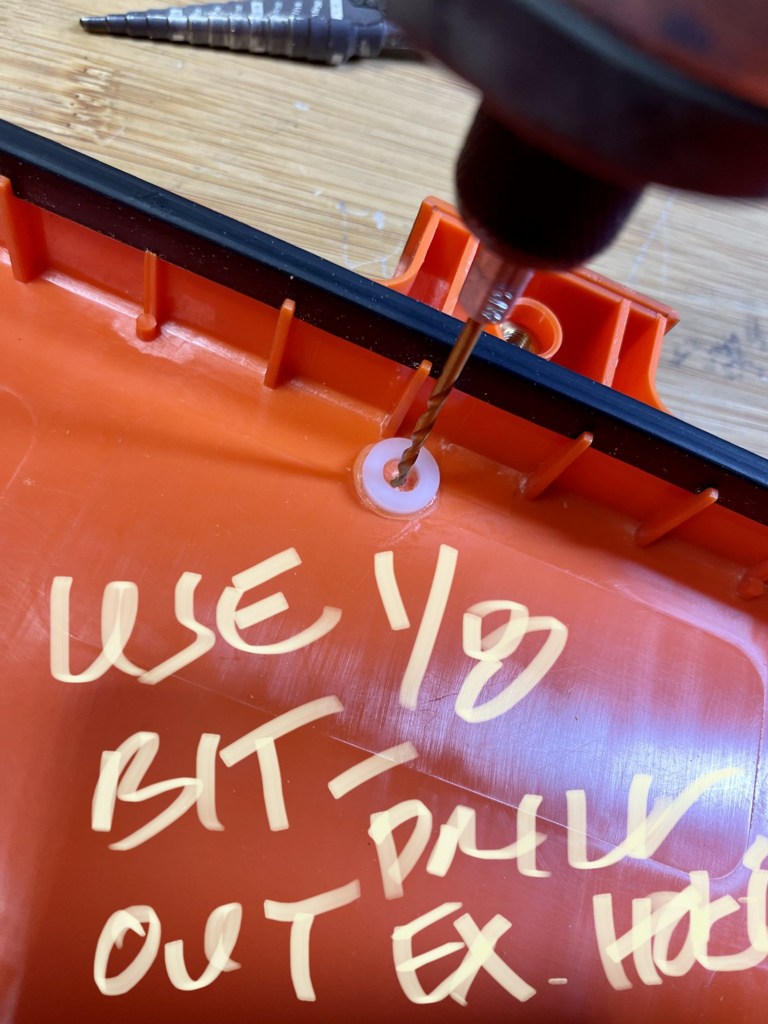

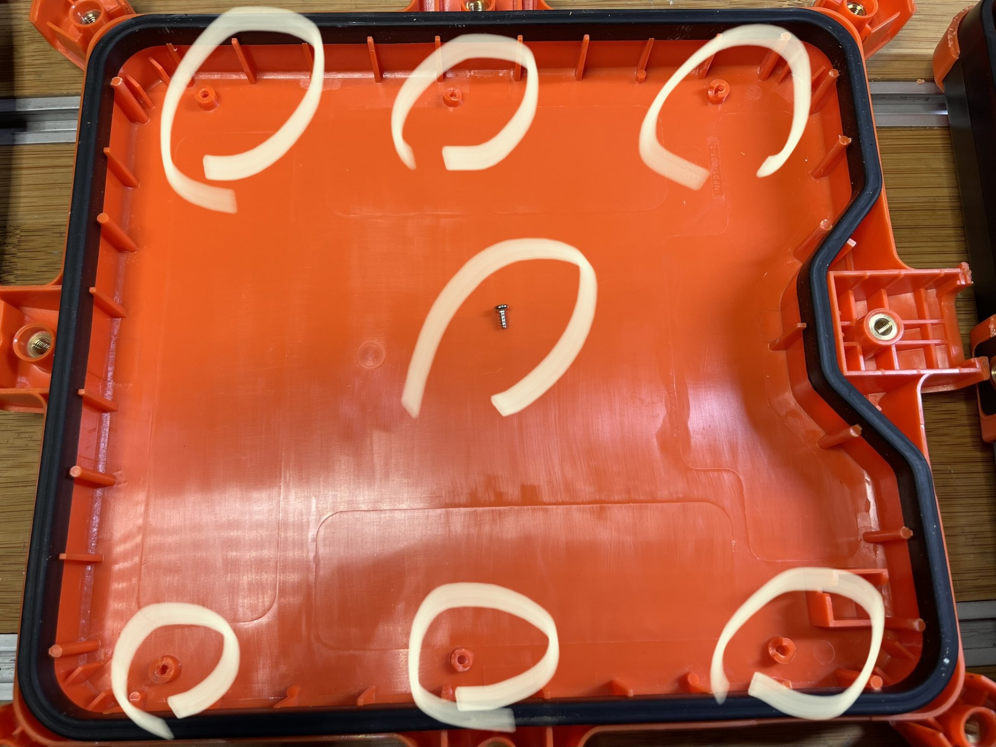

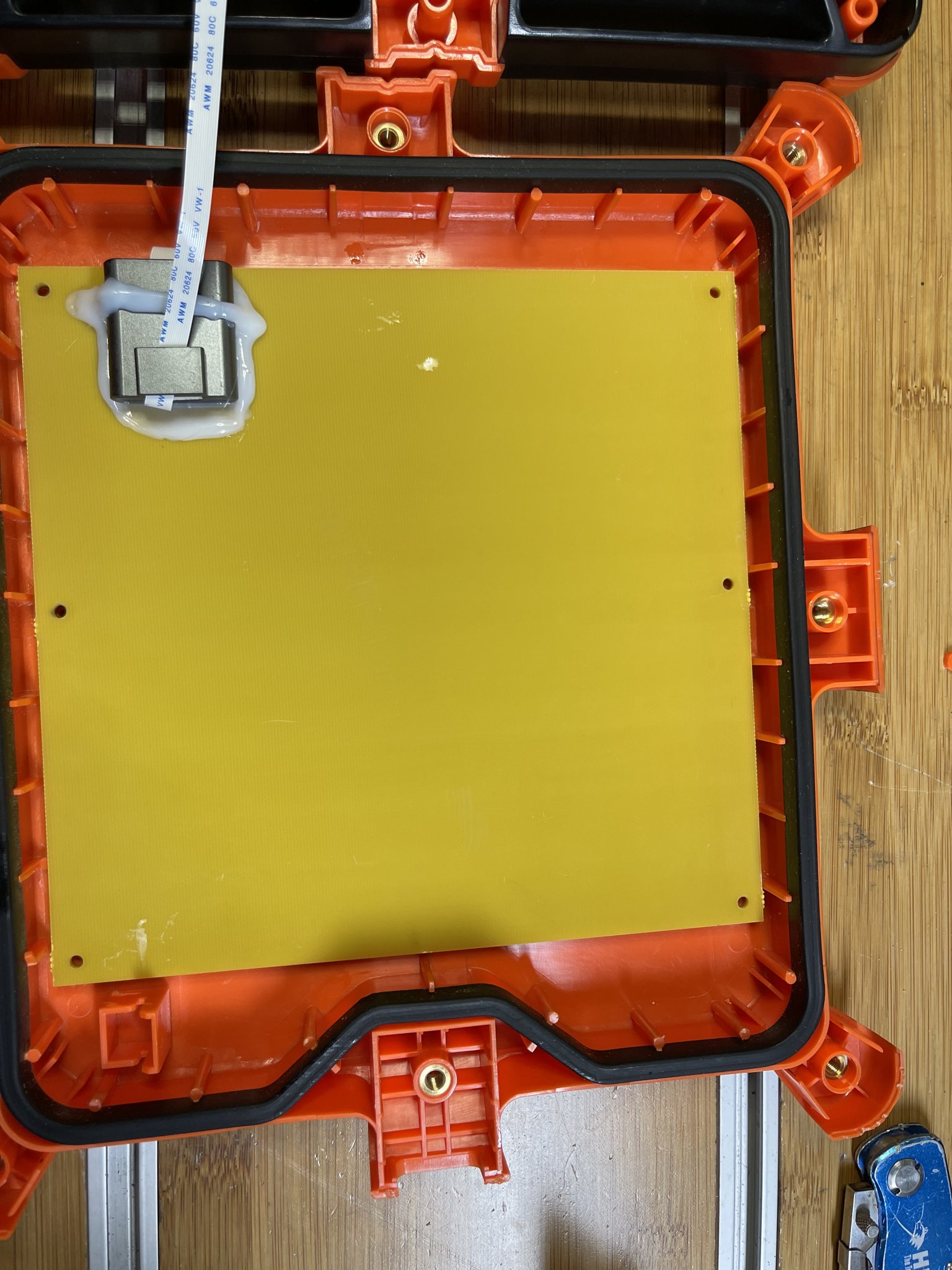

After six solid years with my LR, mines finally let go it’s guts last night while packing it in my range box. I was gonna say, fuck it, get another one. But then since it still turned on even with rattle, I decided to dissect it and see what I can do. Well….
IMG_0313.jpegIMG_0314.jpegIMG_0315.jpegIMG_0319.jpegIMG_0317.jpegIMG_0318.jpegIMG_0321.jpegIMG_0323.jpegIMG_0324.jpegIMG_0325.jpegIMG_0326.jpegIMG_0330.jpeg
And it still worked after that.
View attachment 8174090View attachment 8174091View attachment 8174092View attachment 8174093View attachment 8174094View attachment 8174095View attachment 8174096View attachment 8174097View attachment 8174098View attachment 8174099View attachment 8174100View attachment 8174101
That’s good work right there! A quality repair after my own heart.
I’ll be sending mines to you for repair lol nice fix
