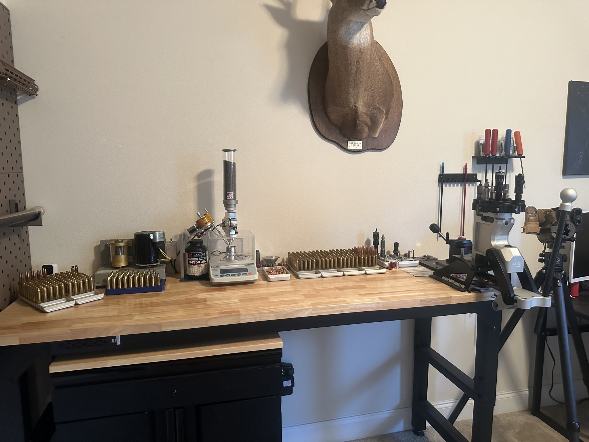

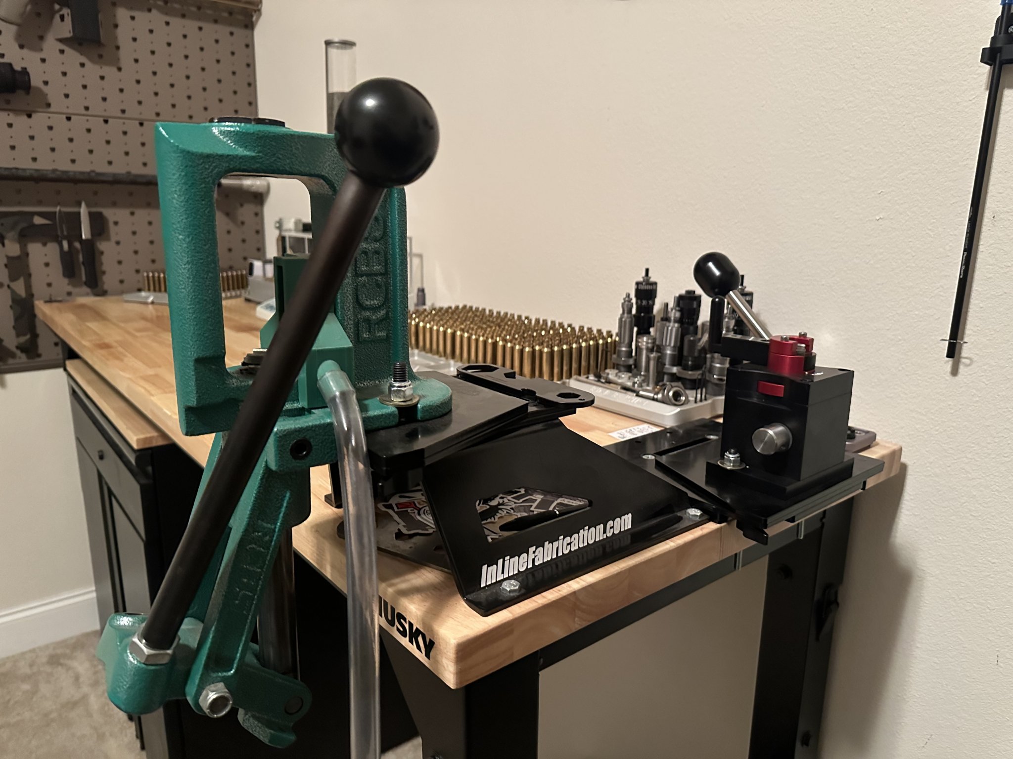

Waiting on one more for my zero currently.

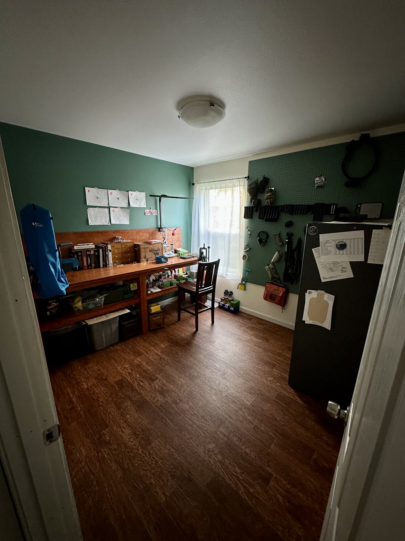

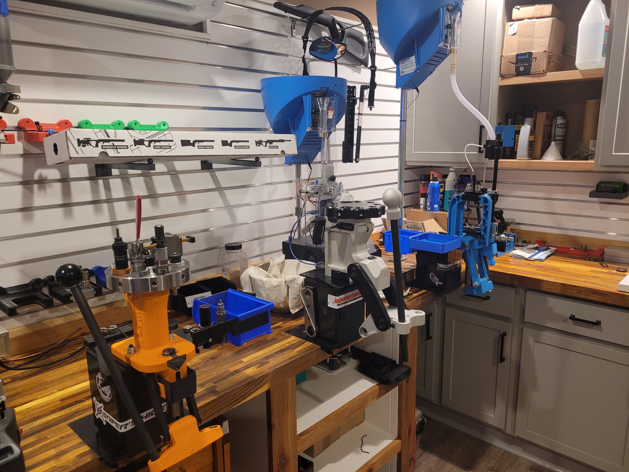

I am sort of embarrassed to show mine after how neat everyone else's is, but I know where things are, and it is organized for how my brain works. I just put in the second bench with 650. Finally have one setup for large and small primers, lot easier to reload and not be changing between them. I wish I didn't have to have all my electrical running off of one outlet through two surge protectors, but I don't know what else to do. Need better lighting, and to change the placement of them.
This bench is the third I built, and is really stable, just wish it was longer.
Fourth and last bench I built. Canabalized wood from my second bench for some of it. And it has the new (to me) second of my 650s. Just got done trimming a couple thousand pieces of 556 on it. Love the Dillon rt1500!
I get to claim the small excuse of a basement at the new house, so things will be rearranged. Inline fab has been a life saver for pretty much everything I could ask for up to this point. However, I started 3d printing my own toolhead holders because 20 bucks each stacks up quickly.

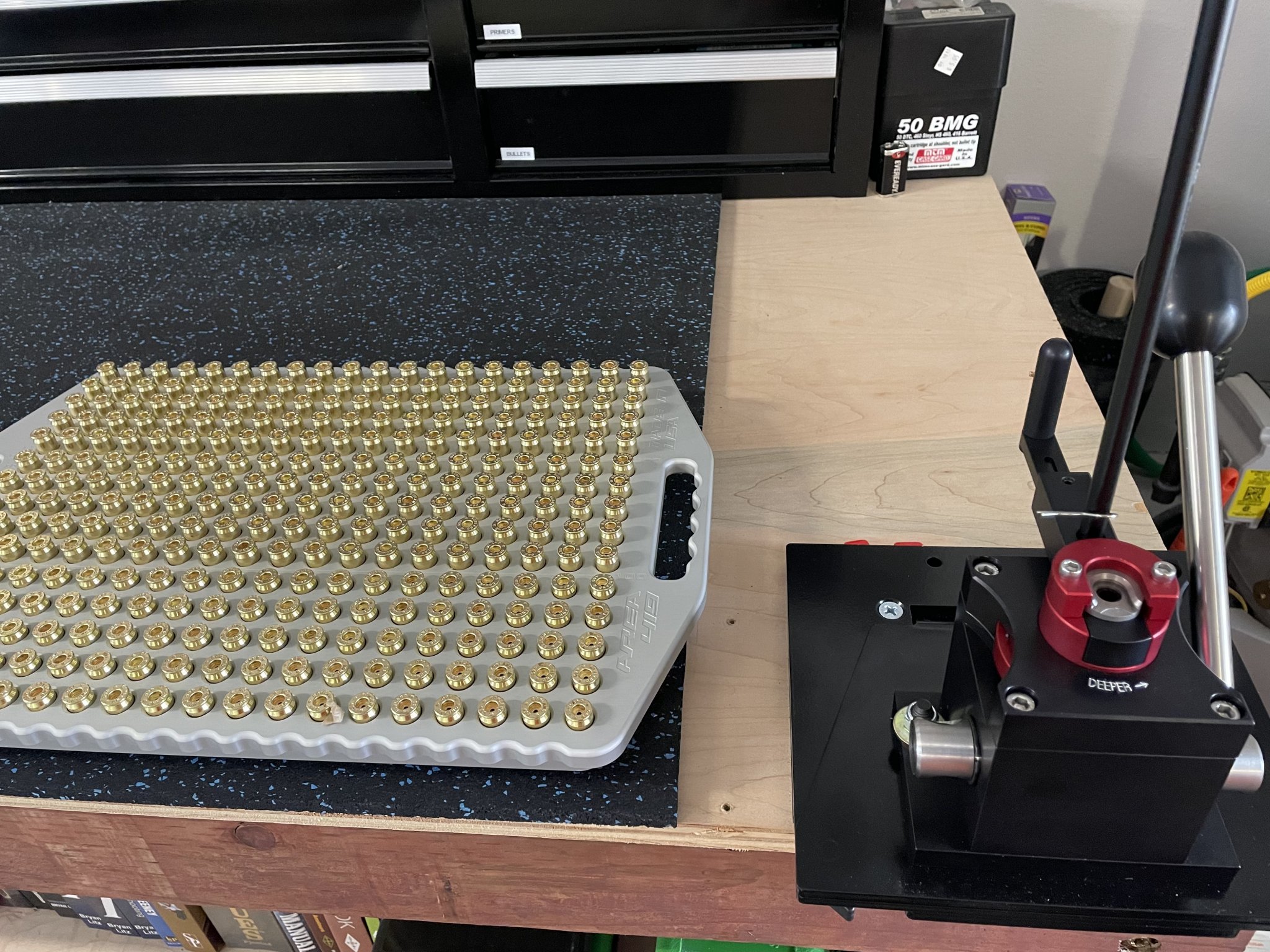

I would guess a primer seater. I forget the make. (Edit: Primalrights as noted above) Ridiculously priced as I recall lol ($675)
It is a primer. It is expensive. It is worth it in my book compared to handheld options out there.

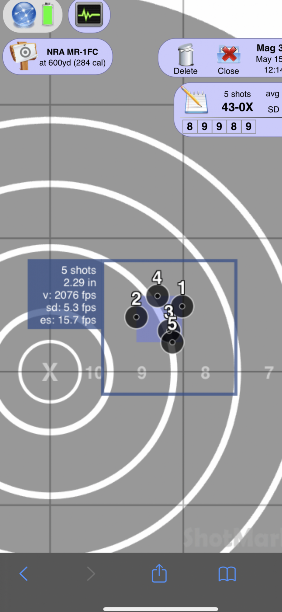

Do you shoot 3 round groups, 5 round or 30 round or what? Just curious.

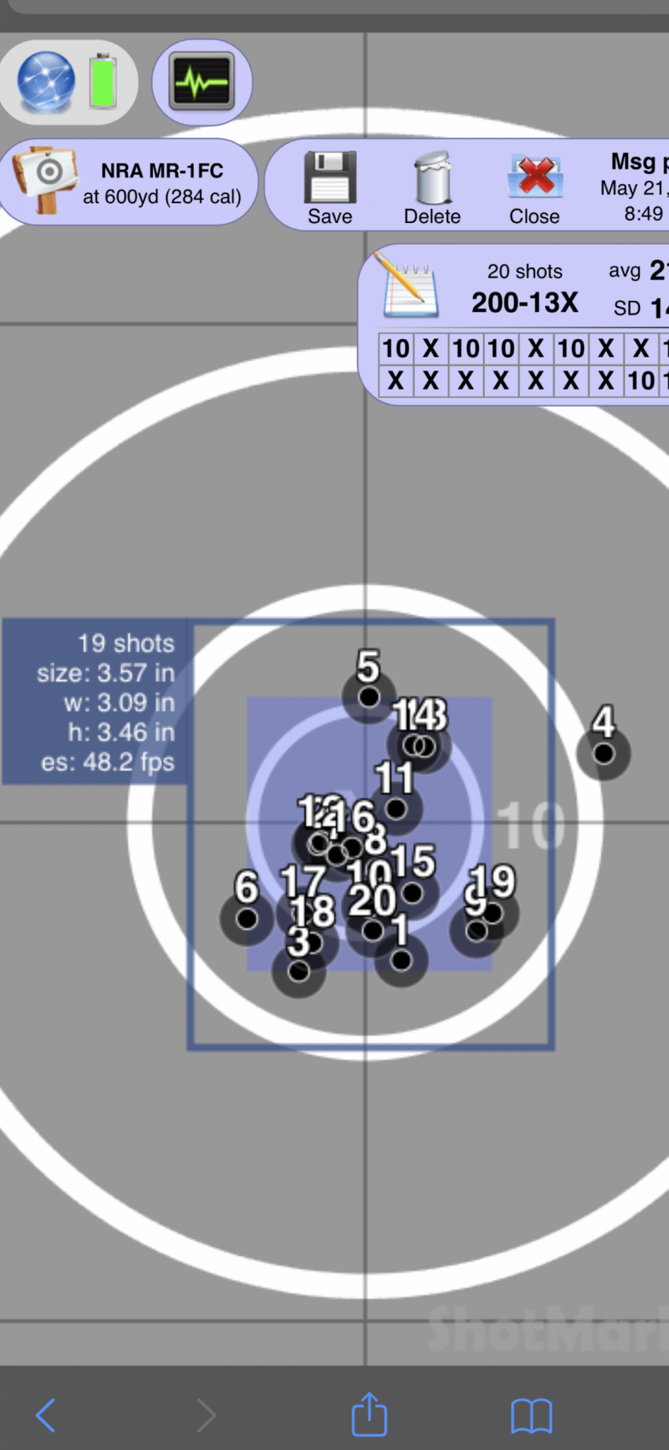

I’m gonna jump in on this one. I shoot three shot groups. LOTS of three shot groups. Minimum of 5 three shot groups but at least 7 three shot groups per individual test in a test session. Seen far too many large groups ruined by a flyer that could or could not be a shooter error. However large number is smaller groups shows a pattern. As said, I would rather have 7 groups with one bad and the rest very good, than one 20 shot group with a flyer or two of an inch or more out, making the test results seem false.
However, I have seen tests where on group went into one hole but the others were as wide as an inch or more. It works both ways. It’s not the number of shots, it’s the number of Groups. Need to look for a pattern, not a hole.
So to make this clear, a ladder tests of five loads takes a minimum of 75 shots but a better average can be found with 105 shots. Find a decent load and then throw the paper away and start banging steel. Its a lot more fun.

Sorry from the potato pics. Built this 10 years ago. 580lb steel work table with 8” square tube steel legs. Had to move it on metal tracks in the house to get it through. Used a winch to lower it down the stairs. Had to use an engine lift to get it in the air. Best work bench I’ve ever had. When you install pins or need to pound on something, the pins just.....go in.
I always wanted a U-shaped work space.
