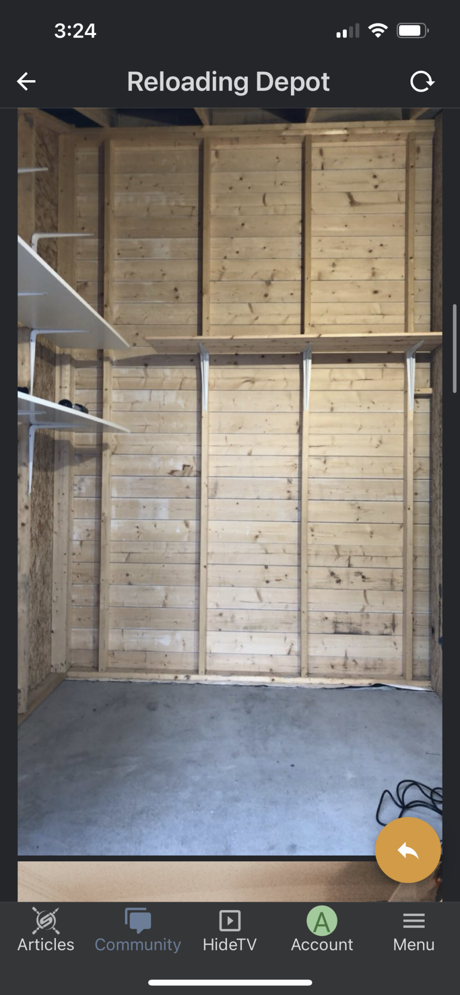

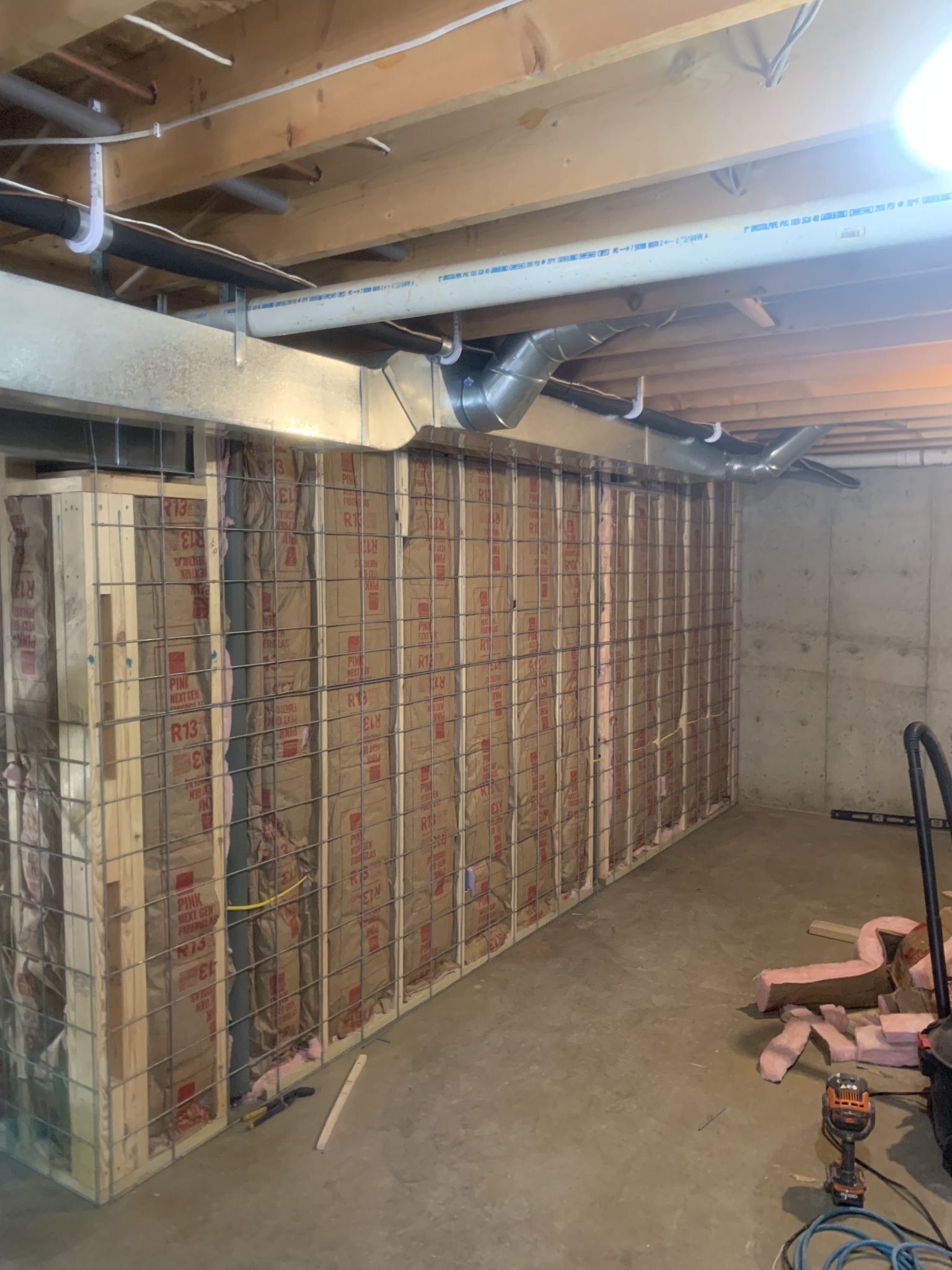

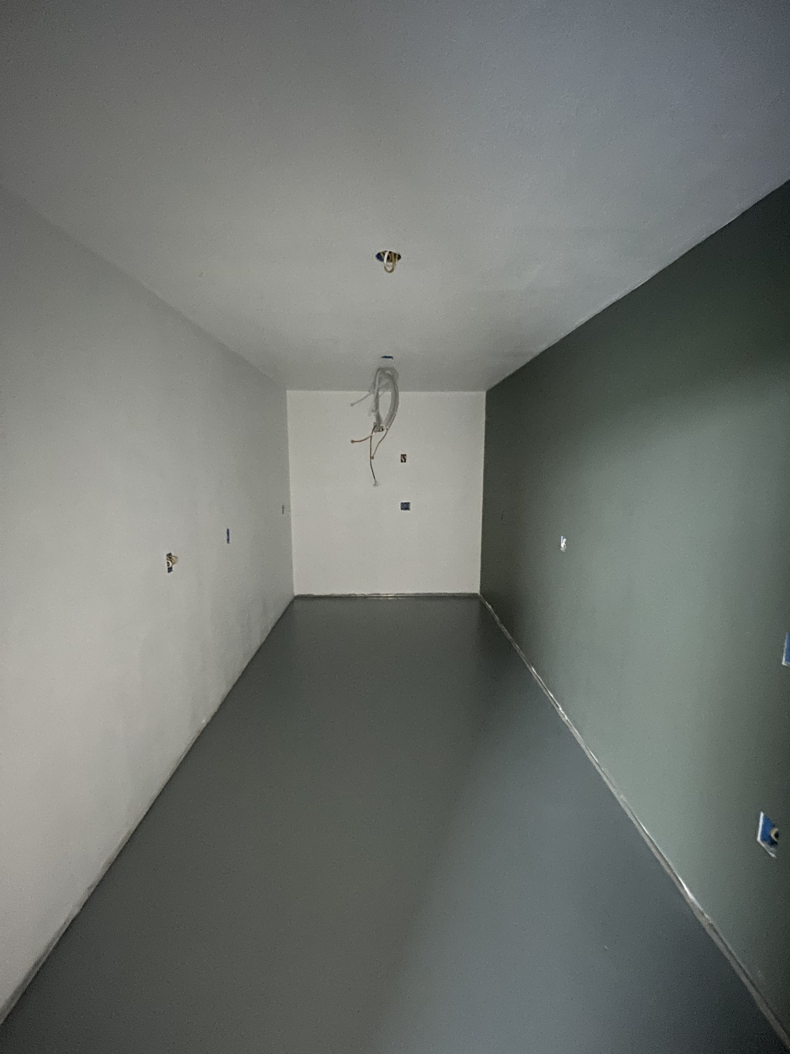

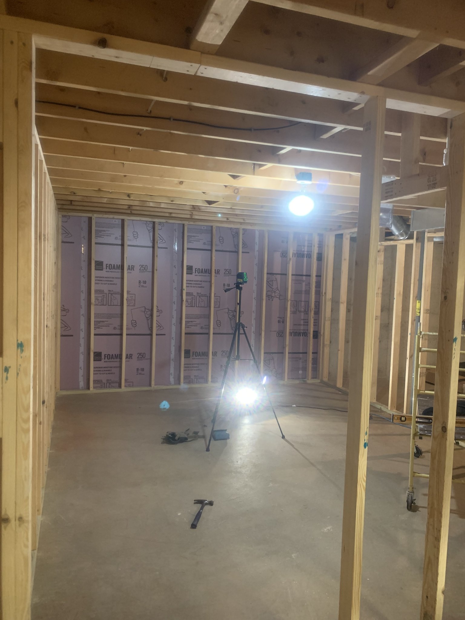

Between the rain, work, and preparing for a baby in the next few weeks. I made some more progress.
Epoxied the floor, painted the walls, buying trim and 2x4s tomorrow. Time to start the long bench on the right wall for reloading and a 6’-8’ bench on the left for gun stuff.
Don’t mind all the crap on the “roof”, I needed it all off the floor
Doesn’t seem like it, but that’s 2 days worth of work by yourself.

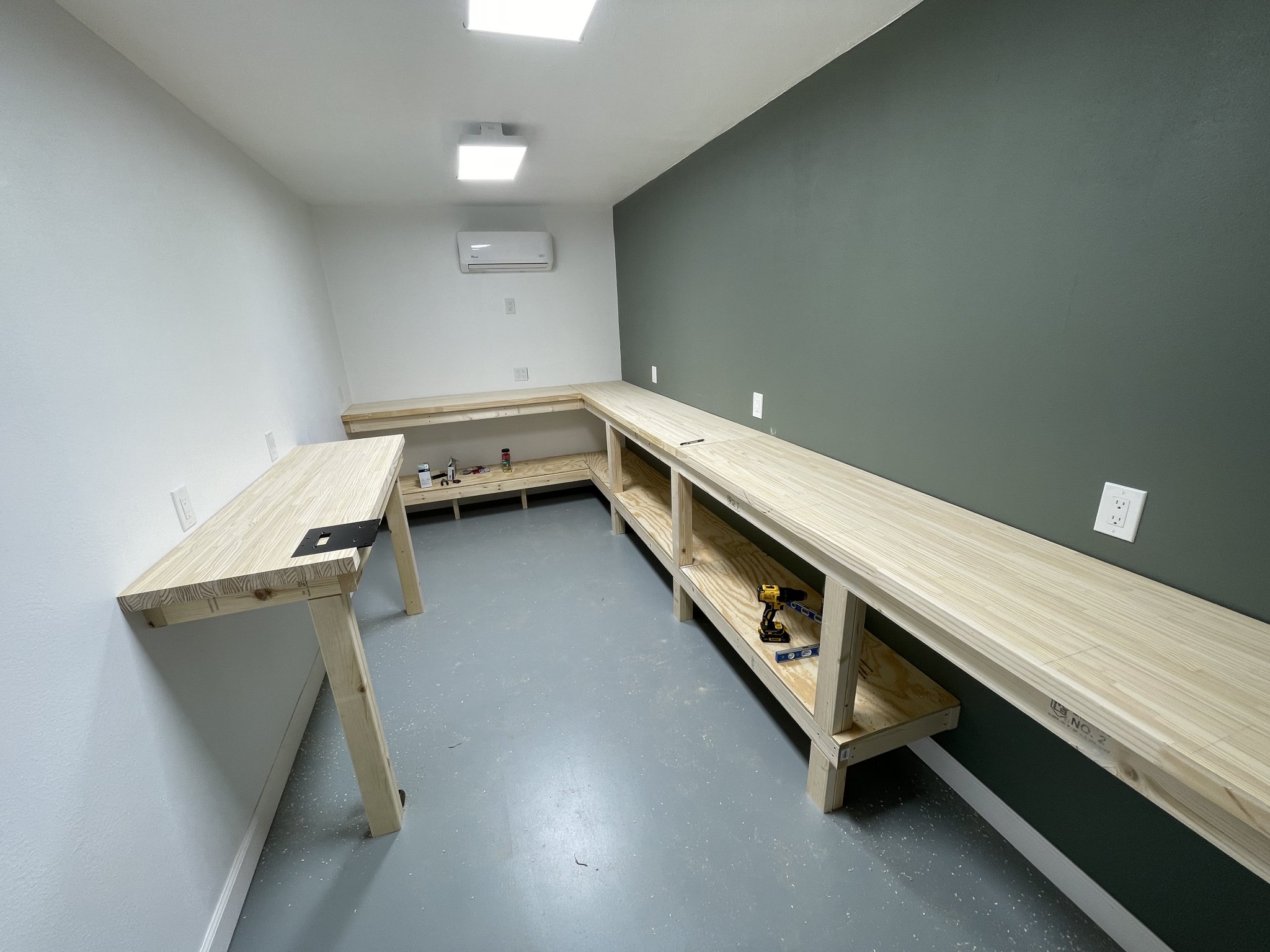

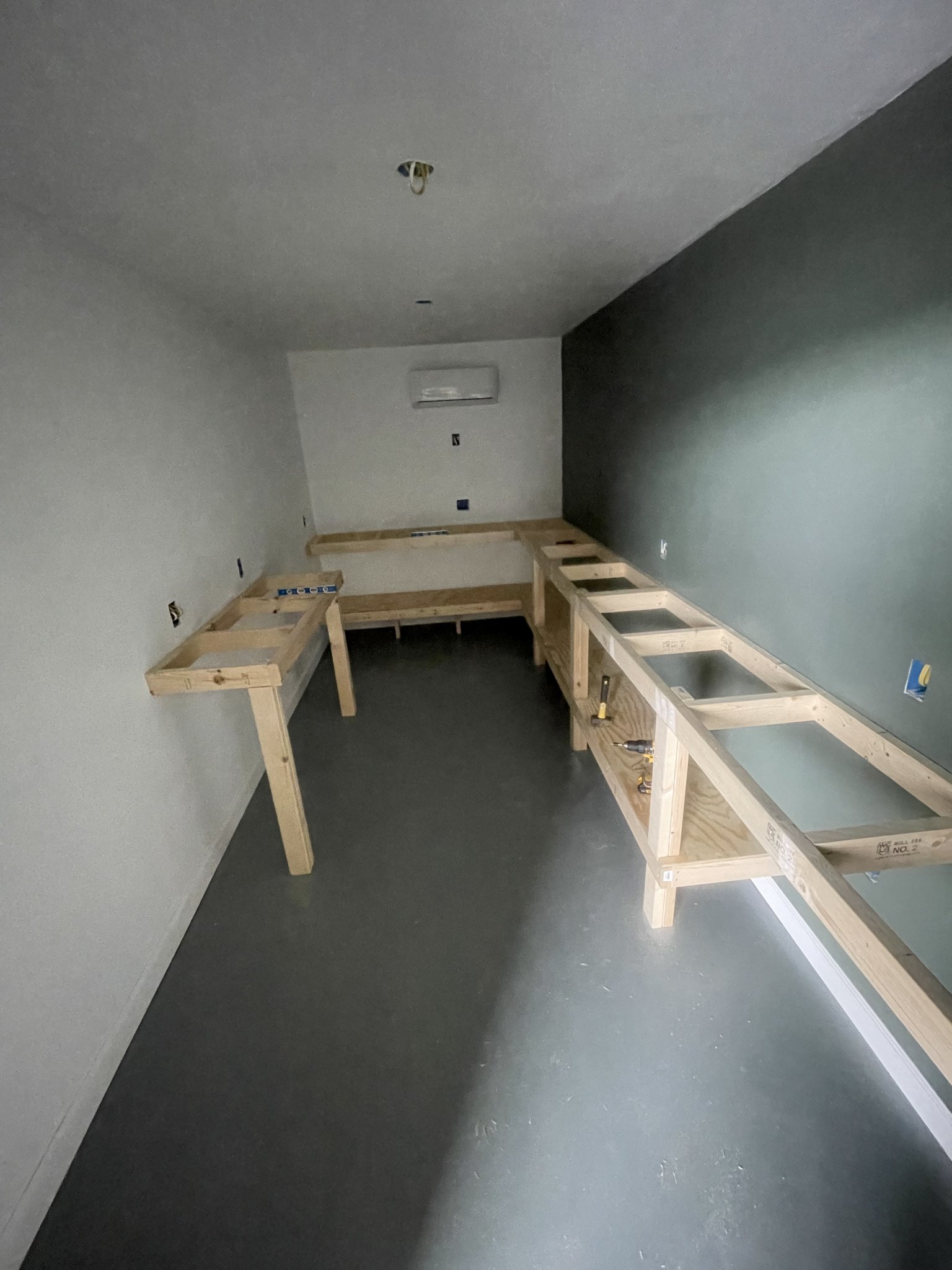

My plan is the 5’ long bench to the right will hole the vise and be for “gun smithing”. 16’ long bench to the right will be presses and other loading tools. The back wall will hold brass prep.
I was going to reuse my 3/4” birch for the tops, but I went ahead and paid up for butcher block. I’m going 20-20.5” wide bench tops, that’s a 1-1.5” overhang, I’m not sure yet.
Now to build a big shelving unit for powder, primers, and whatever other crap will find its way in there. And put up my wall control panels for even more junk holding

Ah! I see HVAC in the last pic. Glad to see you added that.
Reactions: Bbracken667
looks nice how wide is it?
It is 8'x16'
Oh absolutely, Louisiana isn't nice during the summer. Also needed the dehumidifier in the unit. The heat will more than likely never be used, but I am hoping these mini splits are as nice as people claim
I think an 1 1/2 " over hang is OK if you considered how much overhang is needed for presses and the vice particularly the vice
I use Inline Fab quick change mounts. I planned my bench frames 19" wide, 20" wide butcher block, then the inline overhangs 1.25-1.5"
Still unsure if I want to router out for my flush mounts. On my "gun smith" bench I will because I don't want it to ever be in the way.
While building the last frame, I thought what if I cut the butcher block to 1.5"? Either way my mounts will be over the outside of the frame, and I will add another 2x4 from front to back wherever the presses end up on the bench.
What is the height to the top of the butcher block, the height of the bottom of the 2X4 from from the floor, and on what are you going to sit while reloading?
The overall height will be 39.5-40” I don’t remember off the top of my head. I have shop stools, this way I can sit and it’s still comfortable or I can stand and work still
Perfect. I am all about comfort when reloading etc lol I sit in a computer chair and have my table desk height. Having a comfy height to stand as an option is excellent.

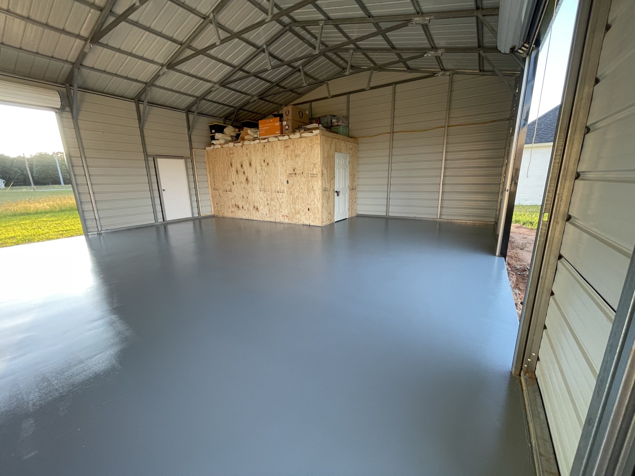

Had a thought yesterday while looking for an escaped primer how are you finishing the floor? If I were to redo my room I would put bulkheads around all furniture to prevent small objects from going under tables . I would also paint the floor a contrasting color to allow things like primers and powder kernels, little parts etc to show up easily. Off hand bright white comes to mind. I might consider redoing that in my room.
I gave mine routed for 3 presses. If you have any questions or concerns that I can help with just let me know. I struggled with doing it or not vs tracks or not too.
Will do! There is really no reason I shouldn't, either way I have to drill the holes through the top for mounting. So even if I try to reuse the tops years and years from now, it will have holes in the top, routing wouldn't hurt anything else.
I used an industrial epoxy from work. We only had a grey or black. I would have liked a lighter color, BUT at least with the epoxy, nothing will stain like bare concrete, and the color is not as dark as it looks. Once Entergy finally pulls their wire to the shop, Ill be able to have lights installed.
Yeah, I sort of did my tops so that the middle section( where all 3 of the routed out plates go), could be replaced and refinished a little easier if I ever wanted to repurpose that space with all the cabinets and a lot of good office space.
The fact is, if you are building a reloading room, do it how you think it will work best for you, not for what the future may hold. No one builds a reloading room like that if they aren't really into it so make it like you want it. If you don't, you won't be happy when it's done

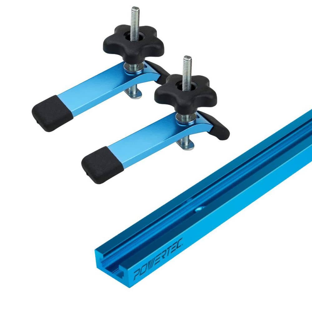

What is that metal bracket thing most of you have that allows the press to slide back & forth or side to side on the table?
I want to include they on my table and want to know where I can find them or what they're called.
Guys, I've been buying components and gear for years whenever I found a good deal. It's finally that time when I'm just about ready to start reloading with all that I have.
It's T slot tracks I think that you're talking about. You can get many different ones ect but that's what they are
Reactions: stello1001
Can you install them in 3/4" plywood, or does it have to be butcher block wood?
You can but you'd have to have something under the plywood. Also, plywood can be difficult to route out cleanly and may splinter the veneer unless you've got good sharp bits and go at the right speed and a good powerful router so, that definitely wouldn't be my preferred surface to install t slot track into but it definitely can be done

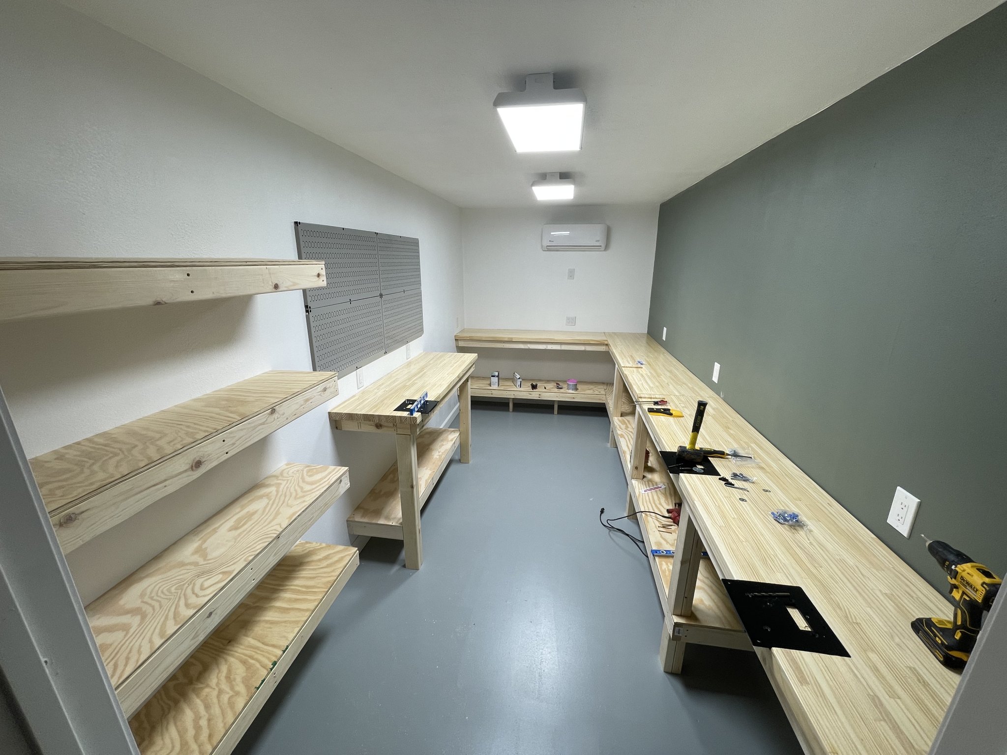

I finally finished my 4th bench in my reloading room which is a dedicated gun building bench. Just needs to be stained and cleared but that will have to wait till spring when I can leave the windows open.
1. Dillon XL650 bench
2. Co-Ax / Chargemaster bolt rifle bench
3. Roch Chucker depriming and brass prep bench
4. Gun building/cleaning bench
I went with Inline Fabrications Ultramount with Quick Change baseplate system. Its an amazing setup!! I have 5 baseplates with different tools mounted on each. They have a huge drop down of pre made plates for all kinds to tools, trimmers, presses, vises, etc. Waiting on a second shipment from them with my wall mounting system. Also have a nice sturdy old dinning room table as kind of a 5th bench for whatever I need it for.

Baby boy is here. So not much progress for a little bit. But I was able to get all the QD mounts routered in flush, 5 coats of poly on all the bench tops, some wall control mounted, and shelving installed. Still gotta add a few braces to the shelves, but mostly waiting for entergy to pull the new service to the shop so I can have the AC charged and I can start moving in

This looks great! What did you use to cut your tabletops only just a little in order to get a flush fitment with those QD mounts?

I used a small trim router. I measured from the edge of the base/guard on the router to the cutting edge of the blade, added that to the dimensions of the area to be cutout, and made a jig to clamp down in place. Then set the depth to 7/16” and let the saw dust fly!
If you need pictures or more info on it just message me. I can send you better details on how I did it
