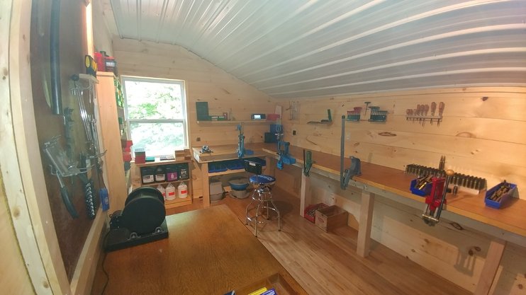

Since most of my images in the earlier posts disappeared.... here are some 'memories' of how this looked like when it started!

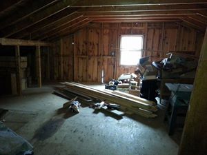

Starting in late January with barn attic place full of crap. Uninsulated.
fetch
Framing in a couple of curtain walls by early Feb.
[IMG2=JSON]{"alt":"null","data-align":"none","data-size":"full","src":"https:\/\/www.snipershide.com\/shooting\/filedata\/fetch?photoid=6683170"}[/IMG2]

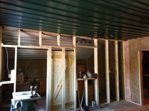

More walls, furring, window frames, etc.
fetch

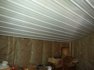

Putting in the ceilings (used outdoor tin, pre-painted) as my ceilings. Worked out fantastic. Great industrial loo, no sheetrocking, no taping No dust. Note the pocket door.
All insulated.
fetch

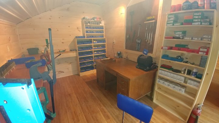

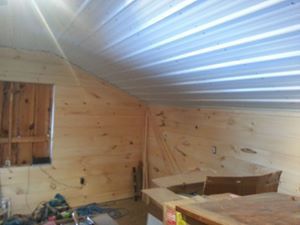

Here is the reloading side, white ceiling. Insulation all up. furred out the original 2 x 4's to 2 x 6 to get a really good level of insulation in.
fetch

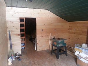

Number 2 pine barnboard on all the walls. Looks great and smells fantastic. Left it unfinished. It will mellow into a golden brown over time.
fetch

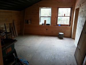

All the windows framed and starting to put them in during early May. Need to finish the floor in this side. Bamboo from Lumber Liquidators. Nice stuff!
fetch
Last window about to go in (frame built, just have to cut out exterior wall.
fetch

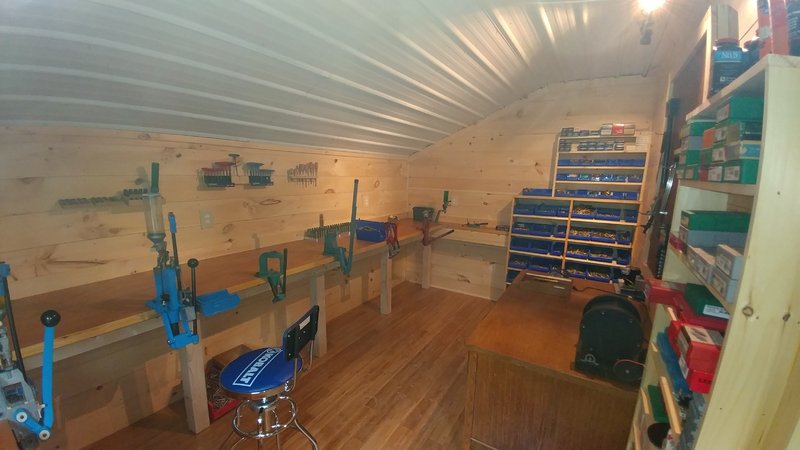

From here it was just a couple of weekends to build all the shelves and benches. And another weekend (Memorial Day weekend) to move all the reloading stuff in and bolt it all in place.
One of the best investments was a whole pile of Acro bins. Bought cheap off eBay. You can't have enough of them! Bought a bunch of different sizes and they are just fantastic!
I'll post some pictures next weekend now that it is 'in use.' Including some of the more interesting little tools I use.
Cheers,
Sirhr

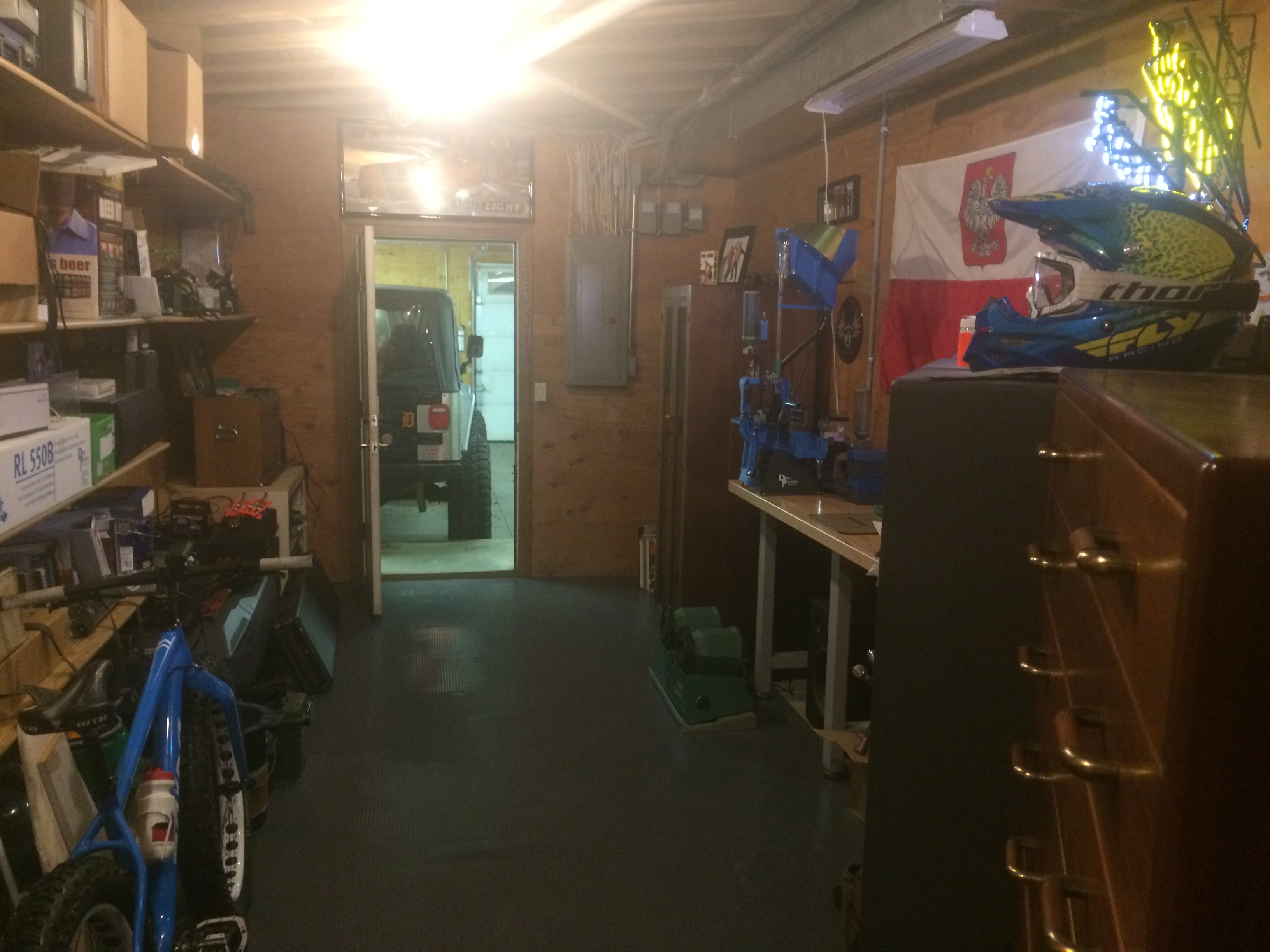

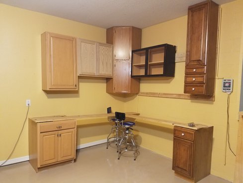

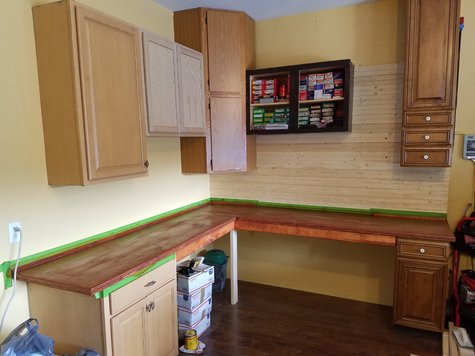

Here's the direction mine went.
I've always built mine attached to the walls also.

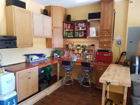

A pile of free mixed cabinets and some clearance flooring.
Ended up using doubled up 3/4" luan for the tops and tongue & groove for the right side wall.
Never did take a finished pic of it
Final attempt at the correct pic. Still a few things to do, but it is operational.
Needs permanent lighting, floor trim and paint the cabinets so they somewhat match.

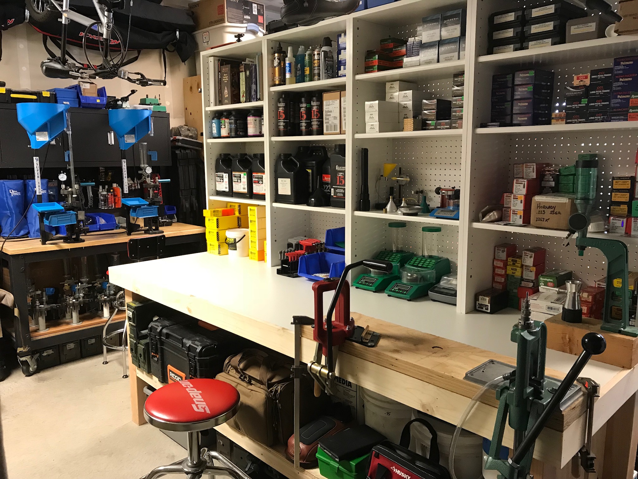

Finally finished with the bench build. Finally. lol. Added a secondary bench that I bought at Harbor Freight. Installed my little pancake compressor in one side. Left the other side for storage of the Frankford tumbler and drier. Also installed the HF power strip on the back of the top. I put the last coat of paint on the gun room yesterday and got everything moved in and arranged. Guess there are no excuses now. lol...
Amazon. I love the thing. Very bright and super adjustable. The clamp on mount that came with it was fine but my OCD forced me to make the little white oak mount for it so it could be in the center.

thanks. I’m using a clamp on gooseneck which isn’t very versatile. I just ordered a light like yours and also a byb e476. One of these will pull reloading duty and the other for the drafting/craft table of the Mrs.
Absolutely beautiful work! I am jelus.

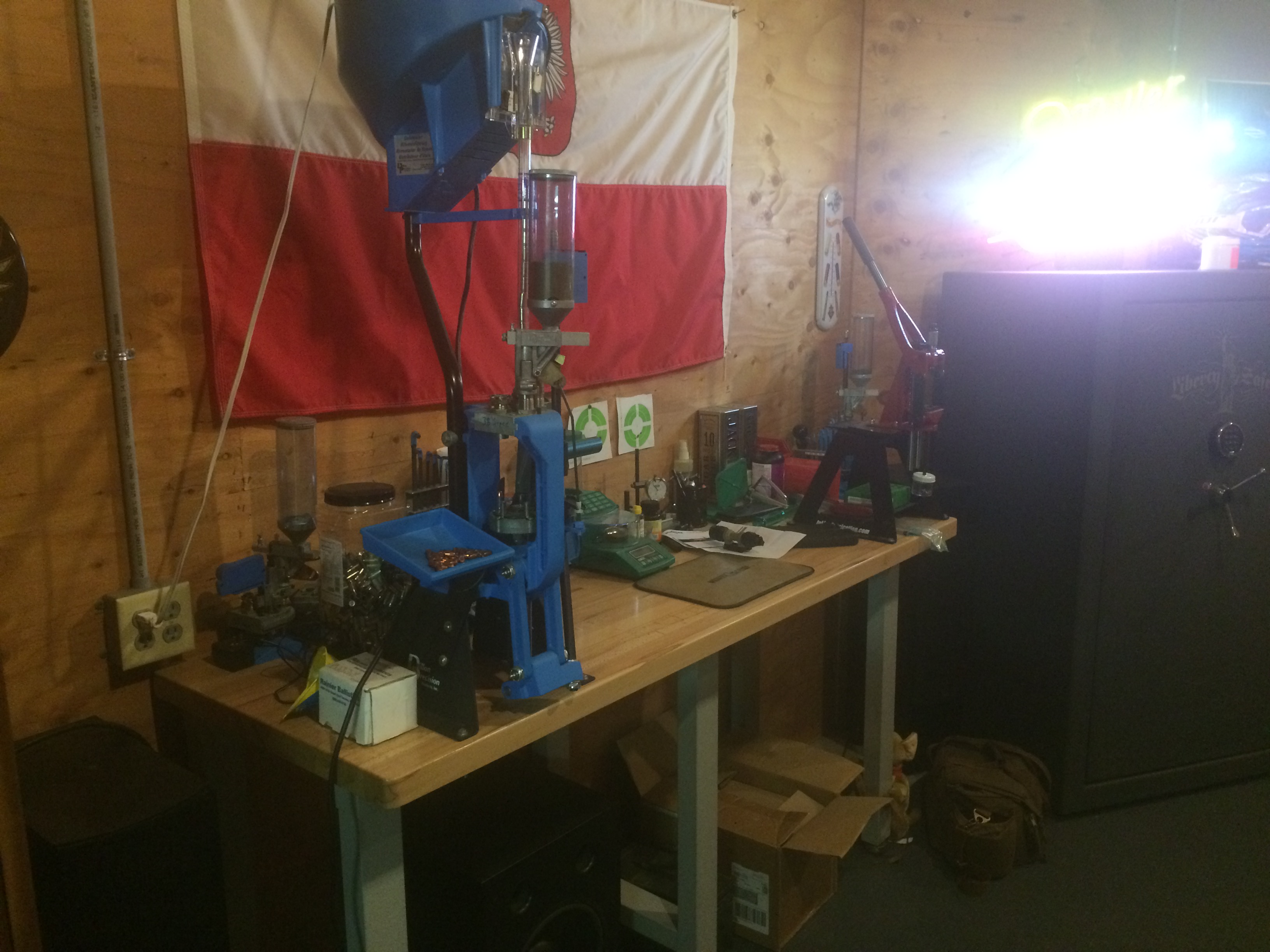

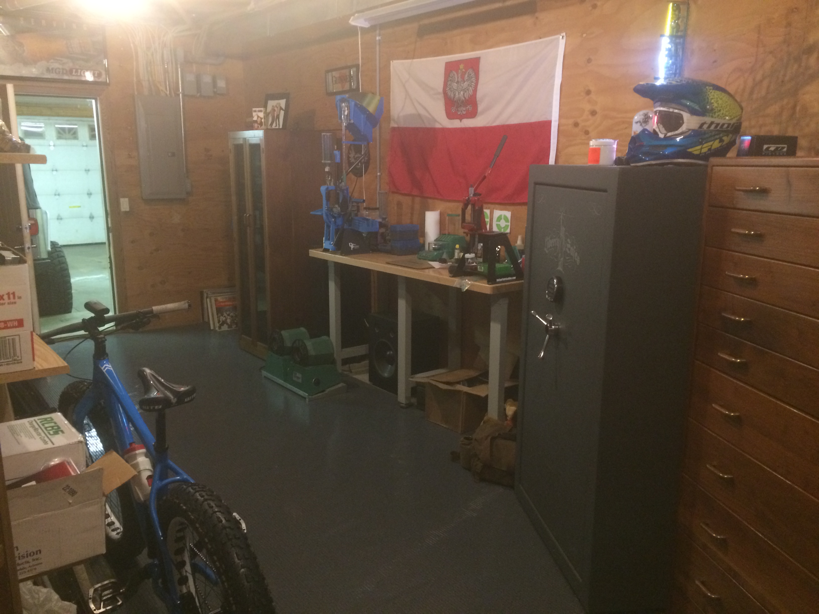

Wow! I thought I had some serious coin invested in reloading...... Very sweet setup, I'm impressed!
One of these days Im so gonna have to do a clean up an snap a few pics to show off my lil hidey hole
