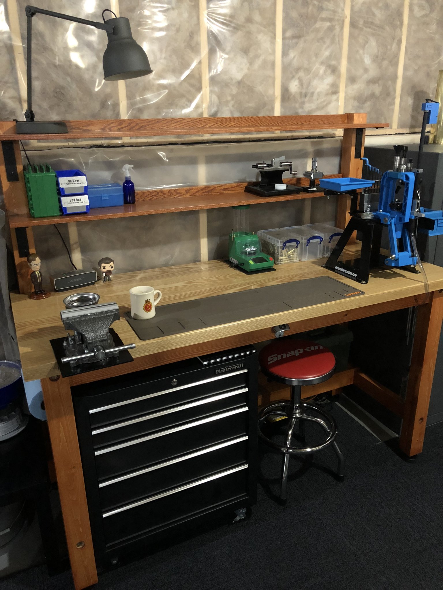

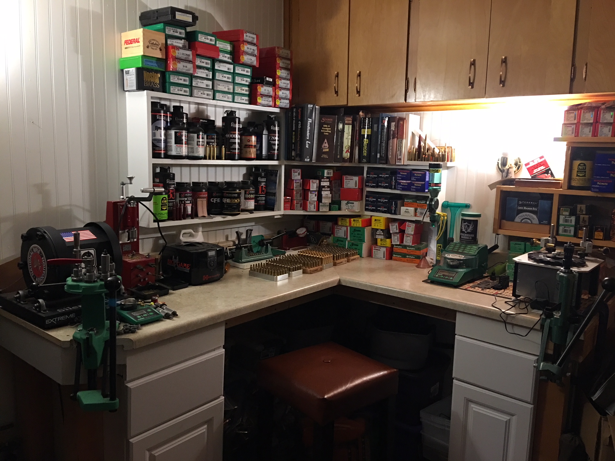

A few years back I finished my basement after spending more than a few years designing my reloading room in my head.
36 total feet of bench. Two rows of outlets. One above the bench and one below. If a machine requires electricity, that cord is run through the bench top and into the outlet below to keep clutter down to a dull roar. In the 1050s, the spent primers also go through the benchtop and into a can below.
The cabinets were heavily reinforced to allow bullets to be stored and to make them more rigid and stable.
36 total feet of bench. Two rows of outlets. One above the bench and one below. If a machine requires electricity, that cord is run through the bench top and into the outlet below to keep clutter down to a dull roar. In the 1050s, the spend primers also go through the benchtop and into a can below.
Incredible set up!! Very, very nice. Even a Prometheus!

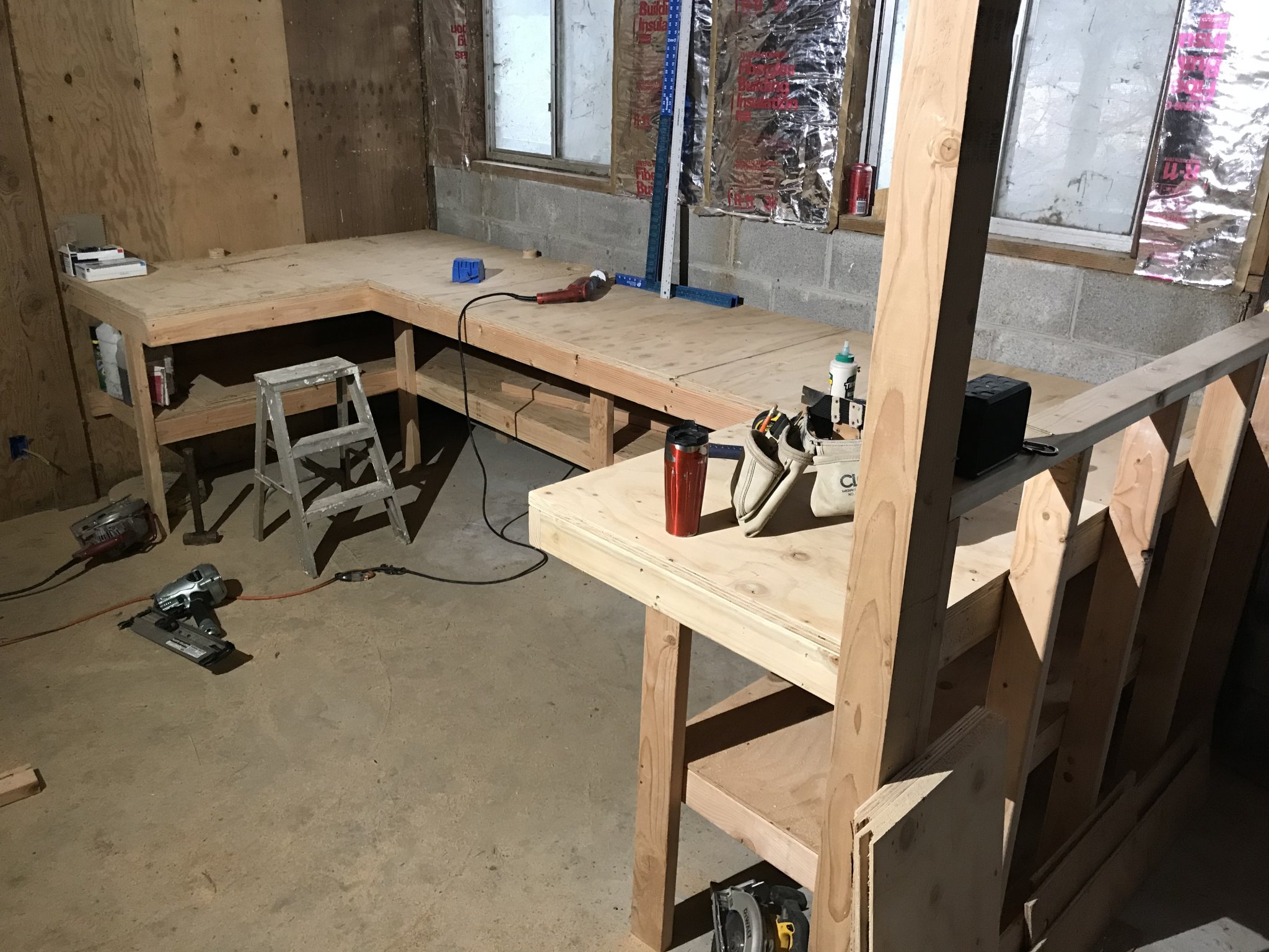

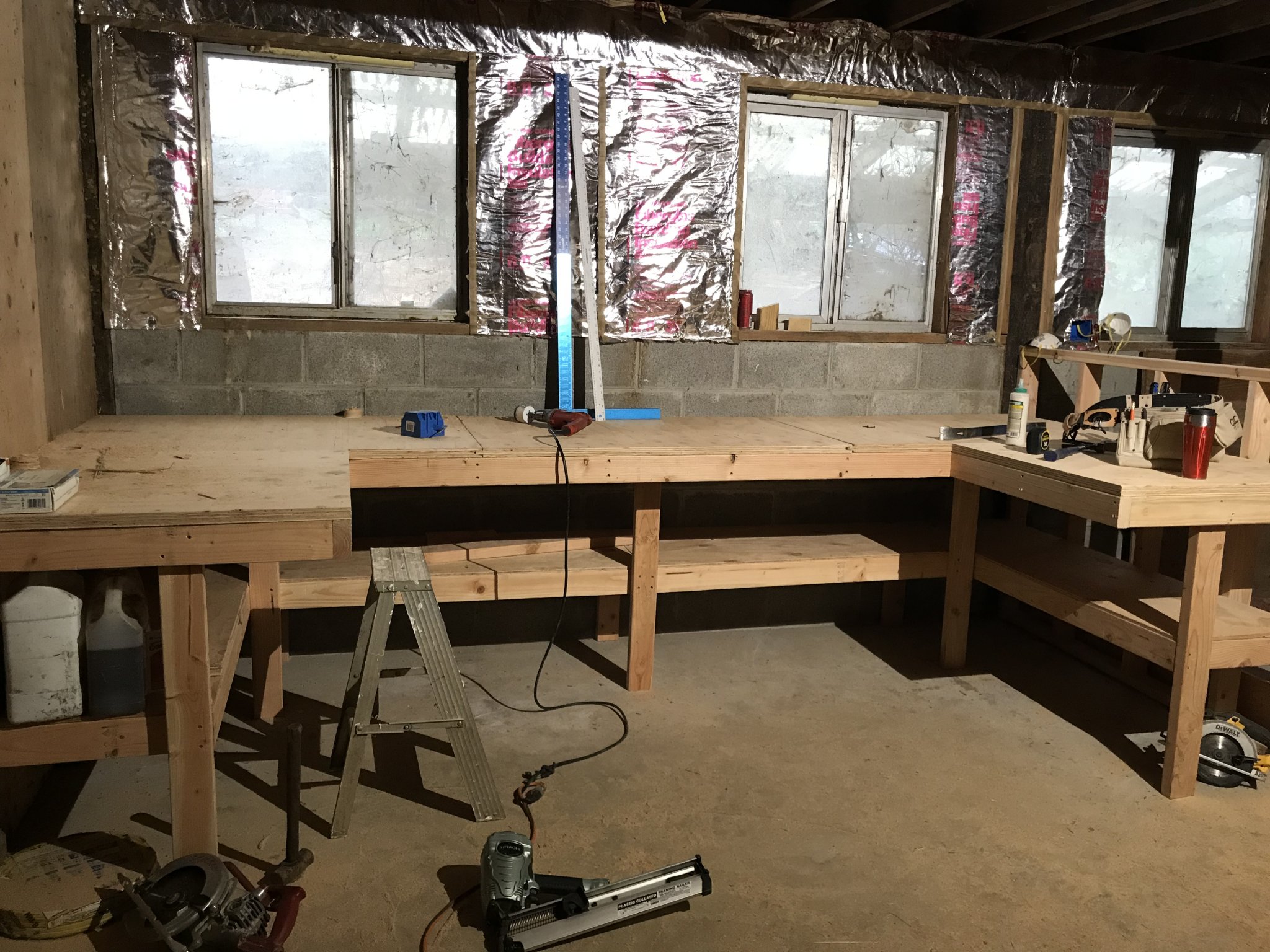

So I’m in the middle of building my new reloading room. Still need to finish up wiring and the do insulation and drywall ect. For bench tops I was thinking maybe concrete. Like the kitchen concrete counters. Can put color in them ect and a sealer . What you guys think ?

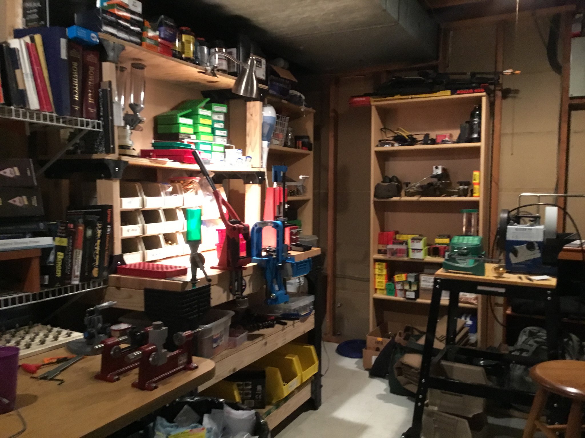

I have hoarded thousands of pounds of reloading components and gear.
More stuff will not make you happier, but buying more stuff always seems to offer hope of more happiness.

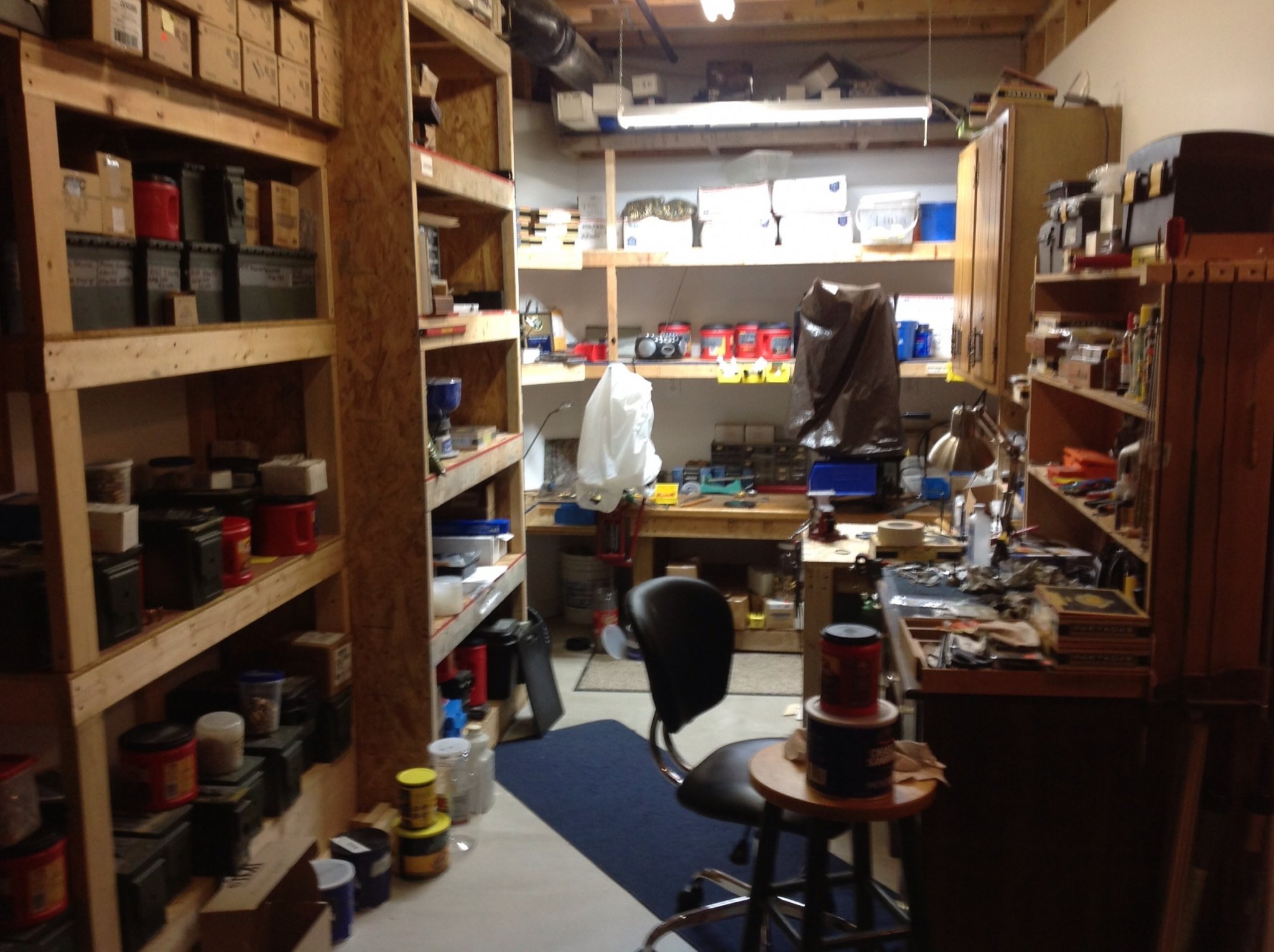

My reloading room is packed with stuff to the ceiling on 3 sides, and to the level of the windows on the 4th.
I have a mobile reloading setup that is in my camper or alongside my computer.
The reloading room is a storage area for a lot of presses, bullets, brass, and dies.
Exception: For cartridge conversion I have to work in the reloading room.

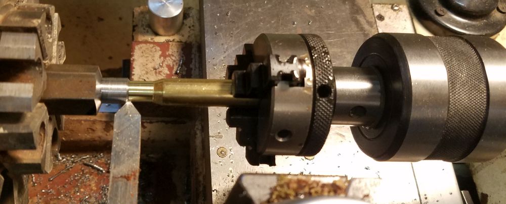

Exception: For turning necks, I have to go into the shop for the big lathe.

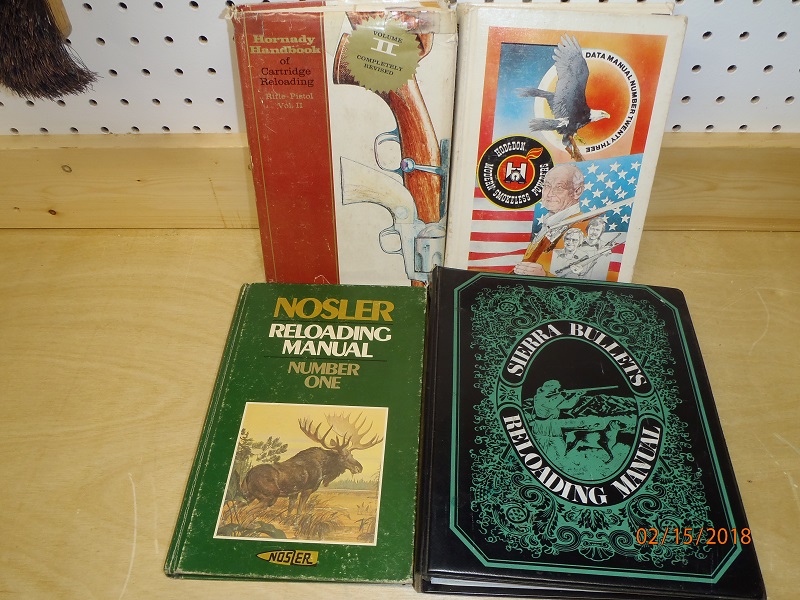

During the move, I found these gems. Aging myself...
Nosler #1, Sierra #1, Hornady #2, Hogdon #23 ($4.95). All bought new between 1974-78. I have Hornady #1 somewhere, my first loading book. Might have lent it out to somebody.
I use concrete countertops in most of my house builds, yes you can dye them or stain them but they still need to be sealed. I wouldn’t recommend them for a loading bench though because it’s going to be difficult to mount anything to them. Also the concrete tends to warp slightly as it sets up and could create problems on a loading bench.
Reactions: M1A1Abrams
Roger that.

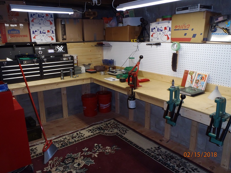

Is half inch plywood on top of a 2x4 frame a strong enough top?
Yeah, just make the 2x4s closer so there isnt as much of a space between each that the wood has to span. I would double that top up myself as plywood is cheap enough. If your top is expensive ply then and money is tight throw a cheap layer underneath and run a trim piece around the edge if appearances matter.
Or you could ensure that you have your mount holes go straight through 2x4s and just use longer bolts to make it up the difference in height. The press mounting is what you want rigid, the rest of it can flex a bit.
My 2x4's are 24" on center, the plywood is good quality but I repurposed it from some old shelves so it has some age. I was thinking of doubling it up, but didnt want to go buy plywood if i didn't have too. Im going to cover it with some cheap peel and stick flooring.

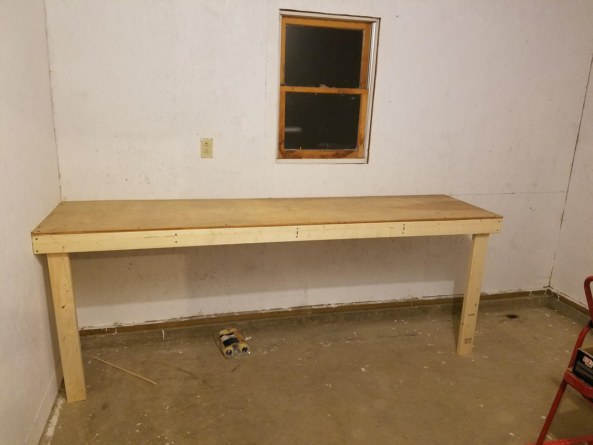

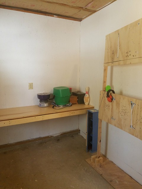

This is the start, the bench will wrap around onto that right wall, my next day off.
May I make a few suggestions?
You have wide open space between the support 2X's on either end, this is good for leg room. However, with 24" OC spacing, your bench may show some flex where you mount your press. Put another 2X in between the space where you are going to mount the press. Then, run two 45 degree cantilevers from the wall up to the bottom side of the bench, attach to bench studs. This will add a lot of rigidity to the bench. I can post a photo if you wish.
Doubling the thickness of the top is money well spent. If you were to choose not to, 1/4" birch floor underlayment is cheap and looks good. I finished my top with tung oil, drys fast and is easy to re-apply when it gets scuffed up. In the past I've had poor results with the peel and stick tiles.
Doubling the two support studs is also an option. You've an good start, keep posting. I enjoy watching a work in progress.

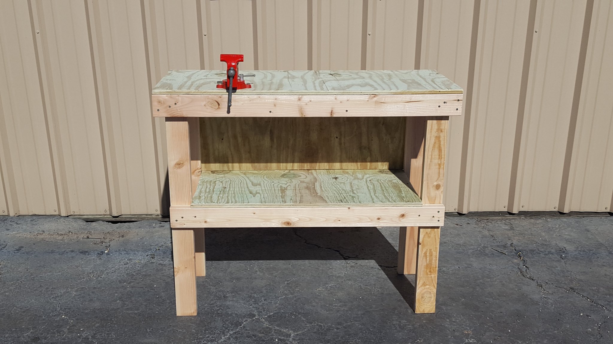

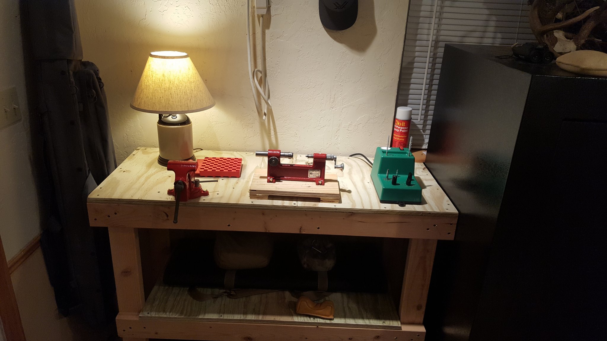

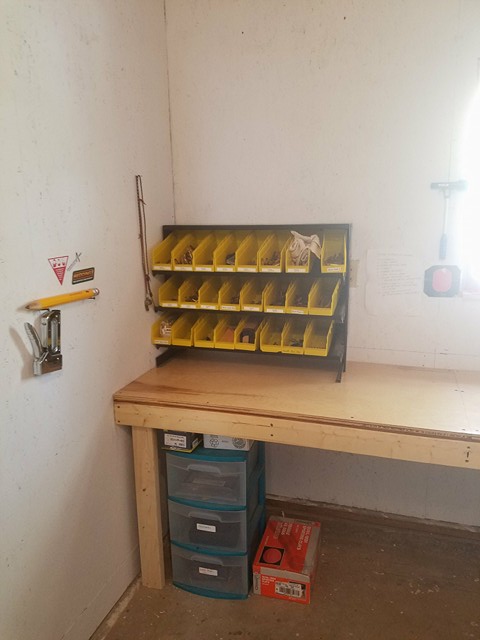

Here is a pic of a second bench I put together the other day. I had the lumber laying around so I figures this would be perfect for case prep. It also gets the case prep stuff off of my main bench and frees up more room for the A&D FX-120i with auto throw on my main bench. It's working great so far.
I used 2X4s for the frame and 3/4" ply for the top/shelf. I also laminated an extra sheet of plywood on the back for extra strength.
I will see what I have left for 2x on the angled mounts once I get the wrap around finished.

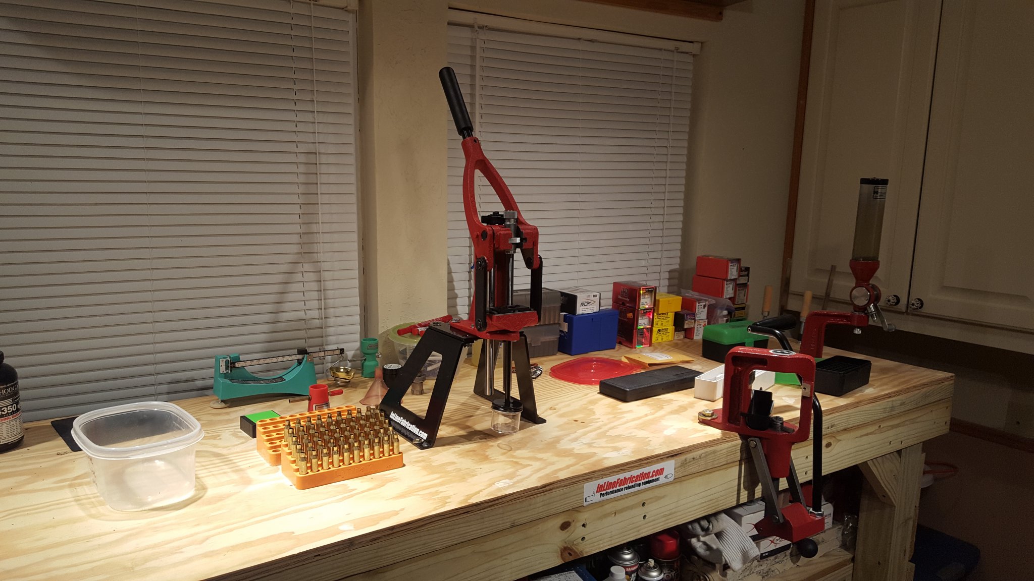

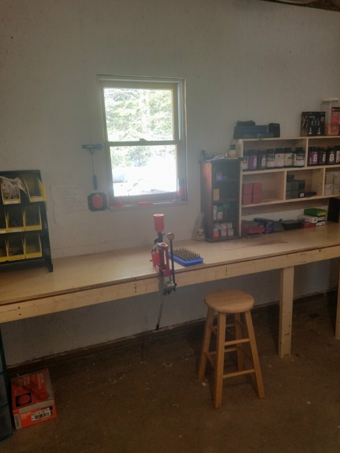

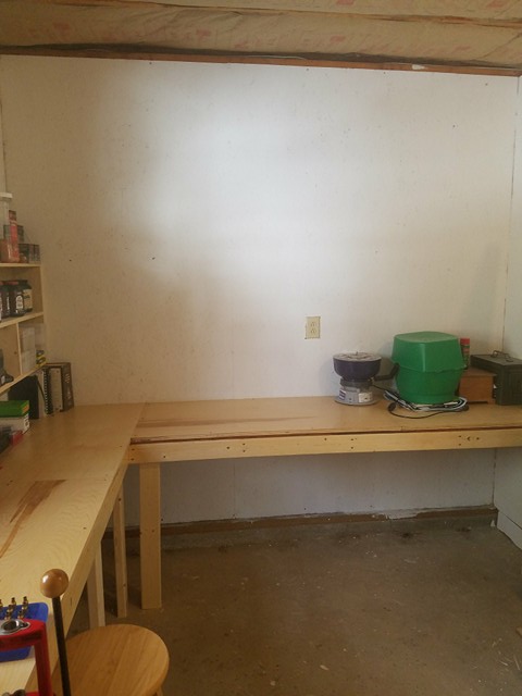

Reloading bench complete! Started this project in October, and slowly plugged away at it. Finally got some decent weather, so I seized the opportunity and finished up the shelves.
Shelves do bow a little, so need to figure out a way to sturdy them up a bit, but otherwise she’s as sturdy as I can hope for.

Take the shelf backs off and use a solid sheet that runs top to bottom and side to side. It will tie the shelves together and put the wight on the table top. Plus it will keep you from knocking taller stuff off behind the bench.
