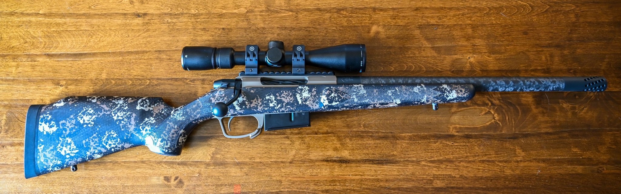

450 blank arrived. I chambered it, had it cerakoted, and this is the result. 450 Bushmaster for Ohio whitetail.
I expect it to shoot great when we do get to shoot it.

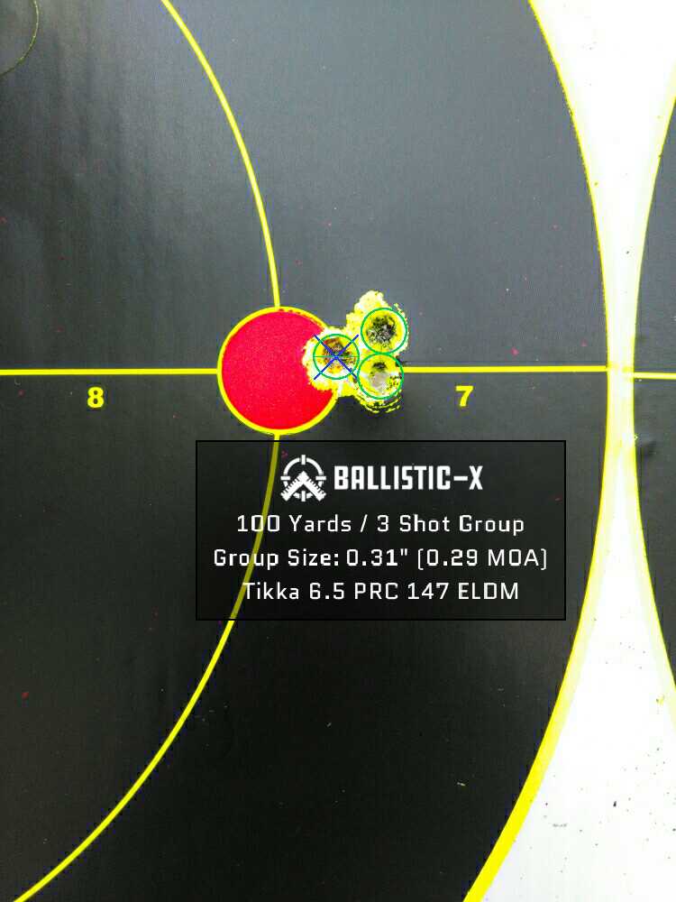

Got my PRC put together last week and went to the range yesterday with some factory 147's.
It shows promise and hopefully it'll get better after a few more boxes down the pipe.
Didn't chrono so maybe next time I'll get some numbers to show.
Head spacing was right on the money.
It took exactly 15 weeks to get it..
100 yrds
200 yrds

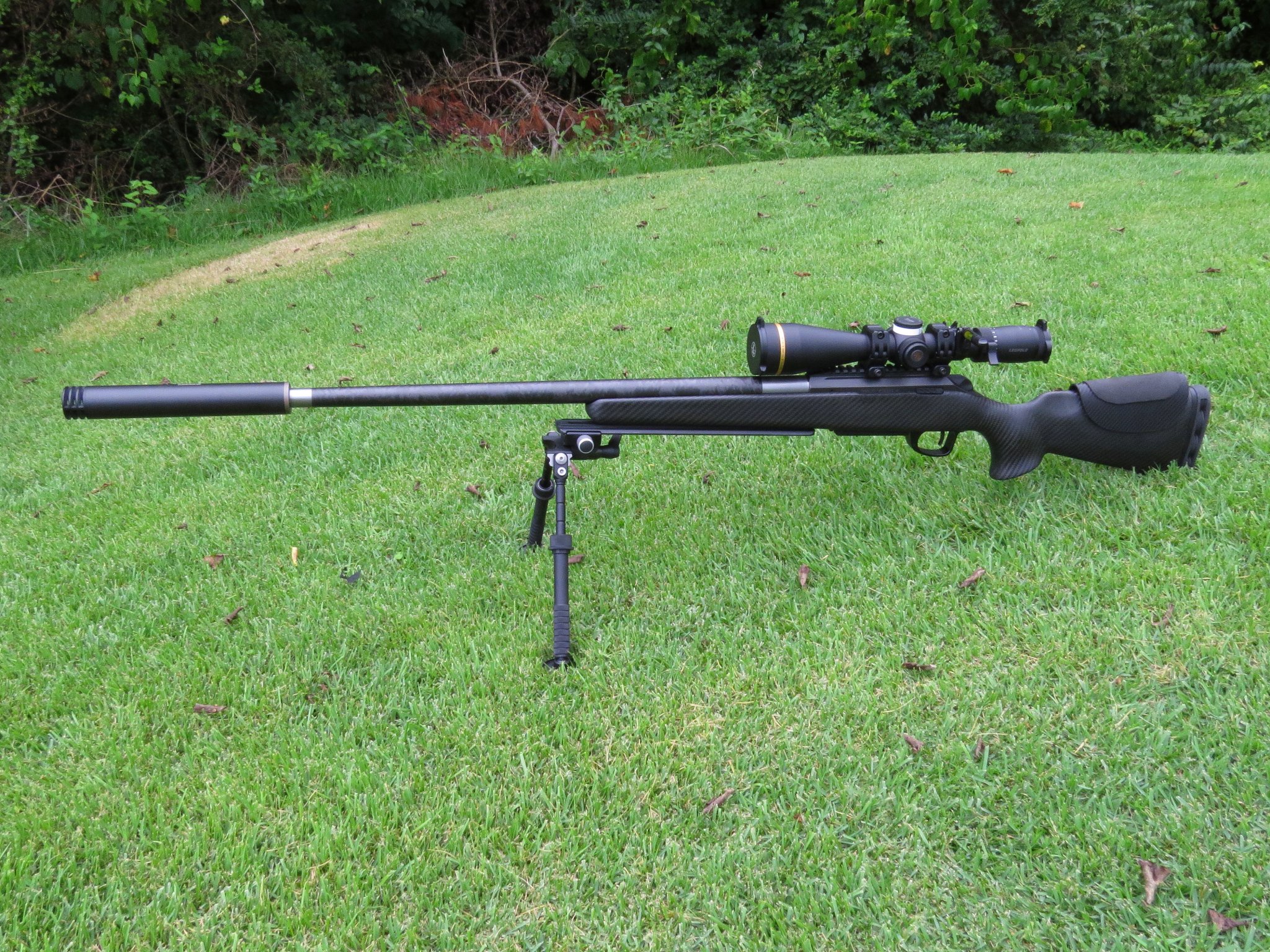

I ordered my barrel on 28 May and it shipped 1 Oct. It was a custom profile which caused some delay, but I wasn't in a rush. The barreled action is now finished and on its way back to me from Jim See. I made a vid comparing the weights of CarbonSix and an identical steel barrel. I'll make vids after it's all put together and load development.
